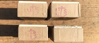

I pulled this out to take a couple photos... was considering unloading some stuff on ebay.... and I just noticed the little anchor thingie with "U S" on either side ... which appears to be STAMPED on the inside of the lid with a RUBBER STAMP. I never noticed it before.

A set supplied to the US Navy. Welcome back!

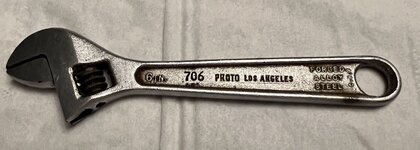

The Proto LA wrench can't be earlier than 1950. As for the Plomb MFD. wrenches, notice that the largest (3050) and smallest (3018) are full pebbles and don't have the electroplating rack burn marks. We don't know exactly when Plomb started using that rack, but some full pebble "MADE" wrenches show up with the marks, and they filed for the patent in December 1947. So, the 3050 and 3018 full pebbles are older than that, and much older than the others. It's possible those two were held over in unsold surplus for a few years, then combined with later production pebble field wrenches, but I would say highly unlikely. That was a time of massive growth for Plomb.

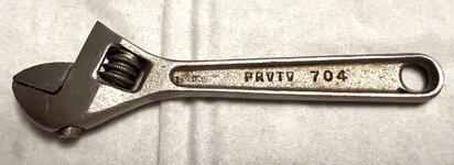

We've talked about the JPD adjustables many times before. When they were forged is indisputable. When they were stamped is not.
I have the same catalog on my hard drive, Don, down-loaded from the old TA years ago. That copy has a PL in the back. (Still not sure why all the old TA cats aren't on IA/ITCL, but that's another story.) Not sure what you mean by "conventional," but the only difference between Catalog 4820 and Catalog 4922-M is removing the Plomb Tool Company name from the flying lady logo on page 2. Plomb Tool Company appears on the bottom of the page instead. It also appears on the back cover. Catalog 4820 had already separated the names on the covers, every page, and the back cover. The only place Proto and Plomb Tool Co appear together in Cat 4820 is the flying lady logo and that's the only change from 4820 to 4922-M. Note that all the tool pages are identical and that none of the images of any tools have any markings, which is also true for a copy of Cat 4922-M that @Catfishdan owns with a PL dated March 1950.
Here is the 100% fact-based timeline from the tail end of my research and analysis, which can be found fully documented and discussed here.
- In March 1947 Plumb sued Plomb in an L.A. Federal district court and won; Plomb had a year (or until March 1948) to stop using its name as a trademark.
- On February 2, 1948, Plomb applied for a ‘PRVTV’ TM. The TM application was only for paper (catalogs, ads, tags, packaging, decals, etc).
(Note: AA completely misses this detail and uses this 'first use' date for the dual-marked tools, the erroneous source of a cascading system of flawed logic on their part.)
- On July 13, 1948, Plomb was awarded the ‘PRVTV’ TM, approved only for paper.
- In October 1948, Plomb started running ads consistent with their on-paper-only 'PRVTV' TM application, consistent also with Cat 4820.
- On November 16, 1948, Plumb sued Plomb again for contempt, and the court ordered Plomb to comply with the previous March 1947 order, and to pay Plumb any profits it made during the year after March 1948 (the date it was supposed to have complied by).
- In December 1948, Plomb closed down their plant to re-tool for a solution to the November 16, 1948 contempt lawsuit that Morris Pendleton called a temporary expedient estimated to cost $130,000.
- On December 14, 1948, Plomb applied for a ‘PROTO’ TM that it intended to use on paper and tools.
- In early January 1949, Plomb re-opened.
- Plumb immediately sued again. On January 13, 1949, Plomb lost, again, and Plomb was given until March 1950 to fully comply with the previous March 1947 court order to cease and desist using “Plomb” as a trademark.
- Throughout 1949 Plomb embarks on a massive advertising and merchandising education and conversion blitz introducing ‘PROTO Tools’.
Without telling anyone else what to think (i.e., form your own positions and interpretations...), I think it's fairly obvious.
Plomb completely ignored the first suit for nearly a whole year. A month before their March 1948 deadline, they applied for a TM for Prvtv, added it to their catalog, and started plastering it on decals and packages etc - note, everything except the tools themselves. A weak and hasty attempt to mollify Plumb. It didn't work. They shut down their plant over the holidays, reopened in 1949 with the expedient solution. What else could it be except the dual-marked tools?! Plumb and the courts were not impressed. They were given another year (until March 1950) to fully comply. While they were making and selling the dual-branded tools, they fully re-tooled across their plants to remove ‘Plomb’ completely, and that was Proto only LA.

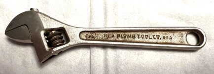

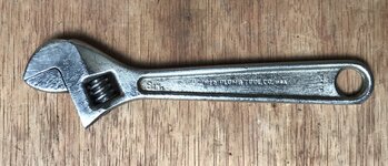

Interestingly, my only dual marked 4 inch has what looks like the same code. I’ve always wondered about the second digit being a month.

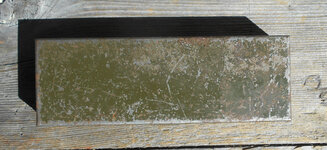

I picked up one of these boxes a couple weeks ago. It's the first I've come across. There's red underneath the black paint and green underneath that. No dividers in the tray, but there is a hole for the oil can spout to poke through.
I saw the red paint and thought maybe Plomb, but then saw the green and figured it must be a military box. Seeing Don's box suggested that the green may have been Plomb paint, but the sticker on mine is larger than Don's and doesn't have the arched top. So, maybe it is a military box that someone put a bumper sticker on; unless Plomb used a variety of stickers and had trays without dividers.
They are nice heavy boxes.
