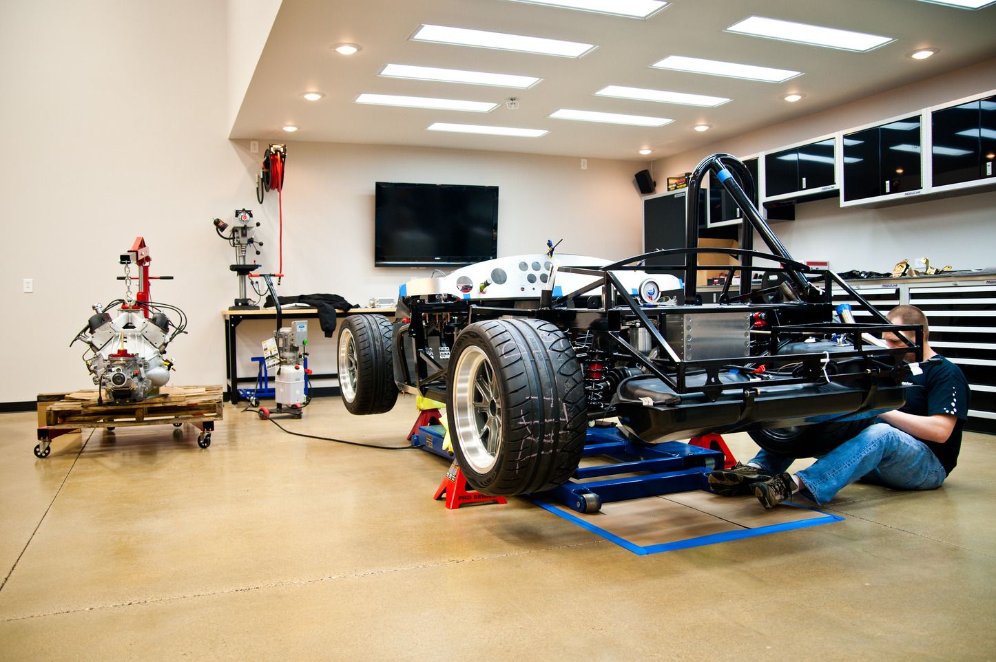

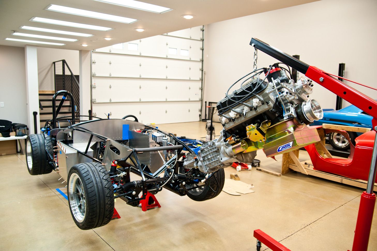

Final pics below.. top is right after the build and the bottom two are of the 'completed' upstairs. Pretty much the same as it looks now.
Up until end of June, I was working a ton on the Factory Five roadster. Since then, not so much... Oh well.
It's truly been my pleasure sharing our place with all of you. If you're in the Minneapolis area for Cars & Coffee sometime, hit me up.. Happy to give you a tour.
:beer:
Main level:
With some actual work being done :)

Carburated 347 stroker derived from a Boss 302 block.
Dart heads, zero balanced, all forged.
Dyno'd 482/444 @ 6300 on a very conservative A/F ratio.
Plenty of power given the independent rear setup and 2100lb or so completed weight.

Awesome specs!! But still not a 427, like the originals! :p
True, but technically, the 'originals' had a 260 cid engine. Shelby introduced the 427 side oiler (FE) in the MK3 in 1965.
Most guys who attempt to be 'original', don't use an FE, they use a 427W (351 block). I considered this, then decided to save the 60lbs. Very happy with my 347.
My view is that either you have a true 'original' Shelby (and then you might have a 289 or a 427 (or even a 428 in a couple)), or you have something else (be that a Factory Five, Backdraft, Superformance...). In the case of the latter, the 'original' stuff was already out the window.
The added weight of an original FE would never provide the type of handling that I'm after (autocross), and anything over 450bhp is wasted on a 2100lb rear wheel drive car anyway.

That warmed over 347 wil be plenty for that project, especially autocross. I'm guessing about 11.5 comp ? You made a good choice in buying the Boss block, (crate engine ?) over using a stock 5.0 roller block.

Thanks. The engine was built by Dave at Carriage House. He used a Boss block, but not a crate engine per se. He spec'd all the parts. it's 10.5 to 1 compression. Custom cam grind (his special sauce). Would spin to 6500, but power peaks at 6300, so no sense pushing it. With a solid lifter cam and a couple tweaks to the valve train, the rotating assembly could take 7500 easy.
