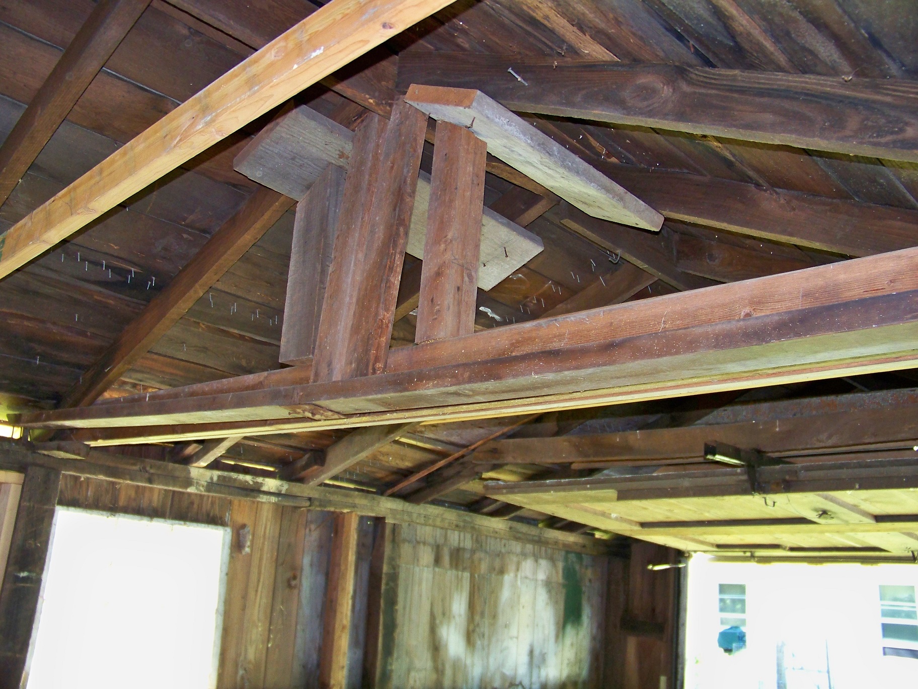

One thing, that beam the previous owner put in, that was level but is now uneven... that would make me crazy. Of course, it adds "character". ;-)

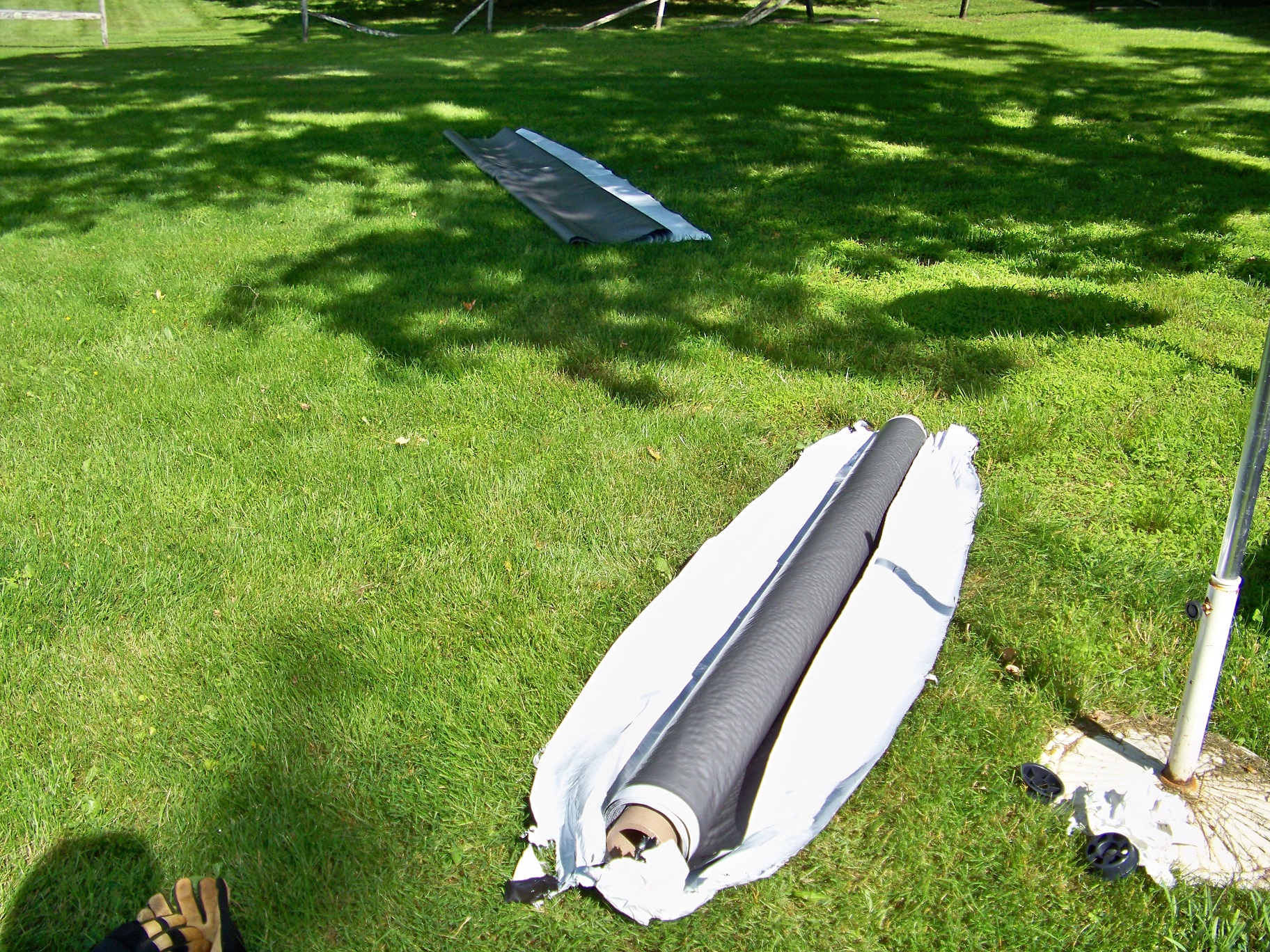

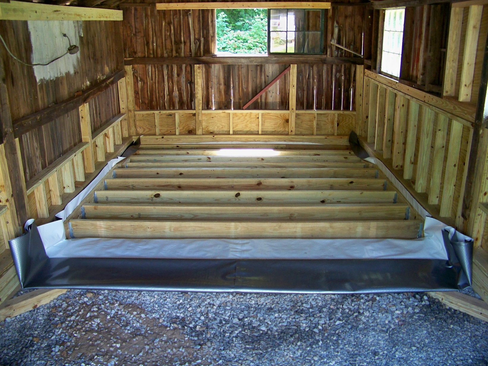

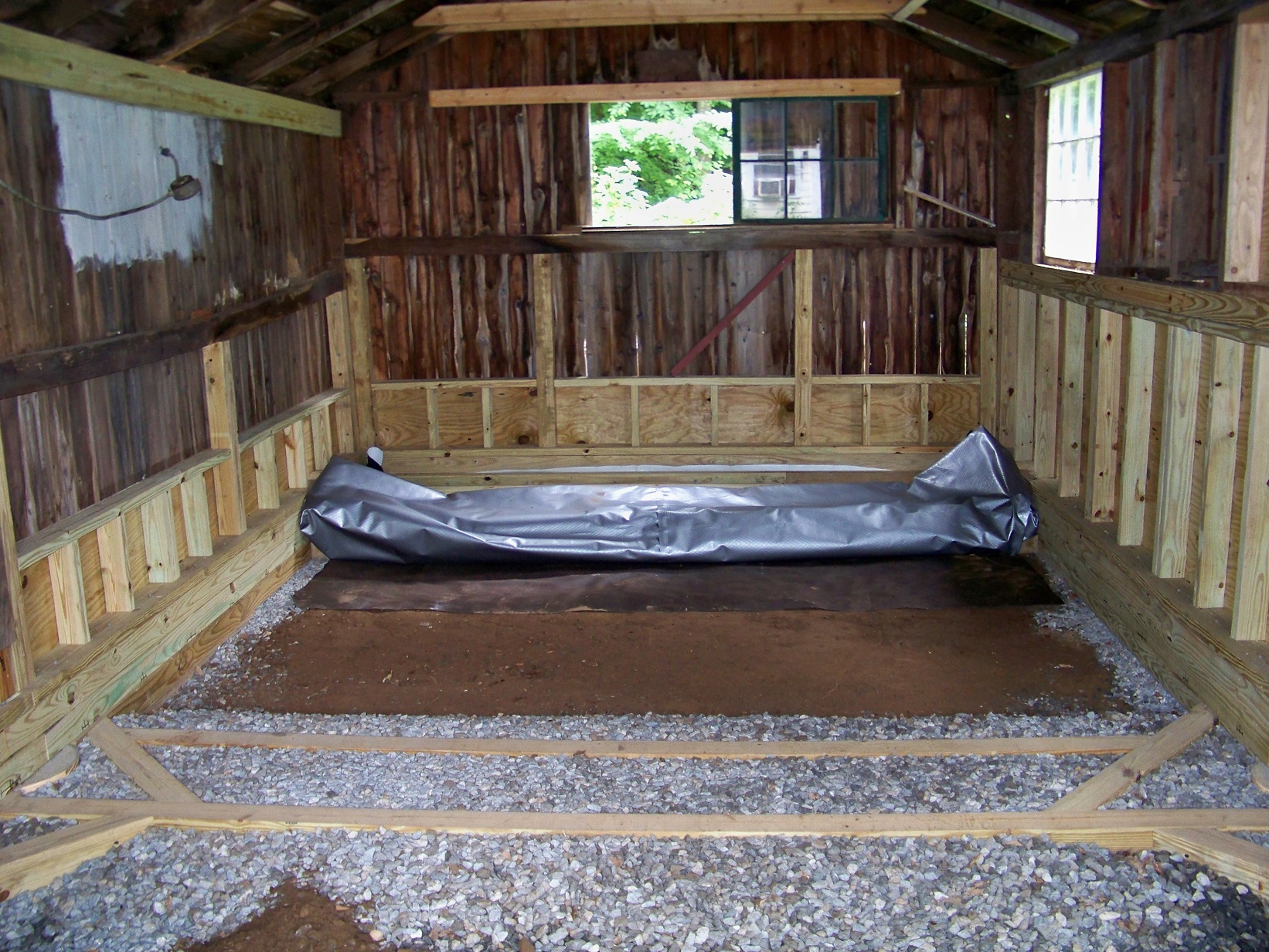

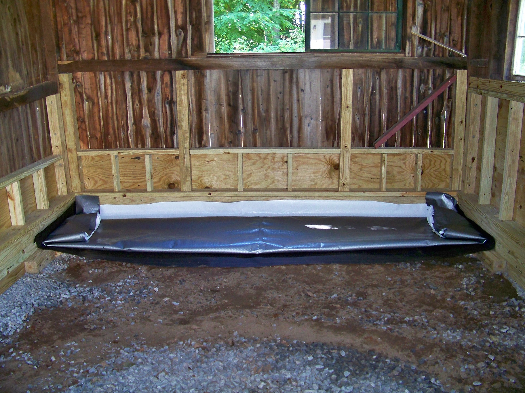

I'll build the floor from back to front, putting the plastic vapor barrier under the joists. I'm using tar paper under the plastic to reduce the risk of puncturing the plastic when I walk on it.
It took me half an hour to unwrap the plastic roll as they had an insane amount of duct tape on it and I wanted to be sure not to cut into the roll.
I'm only using half of the 50' roll for this project. The rest is slated for a future home project. So the cost of half the roll of plastic used for this project ends up being $100.
Working with the plastic this way is a bit awkward, but hopefully worth it in the long run. I'm trying to keep the floor low to maximize headroom so I don't end up hitting my head on the open garage door.

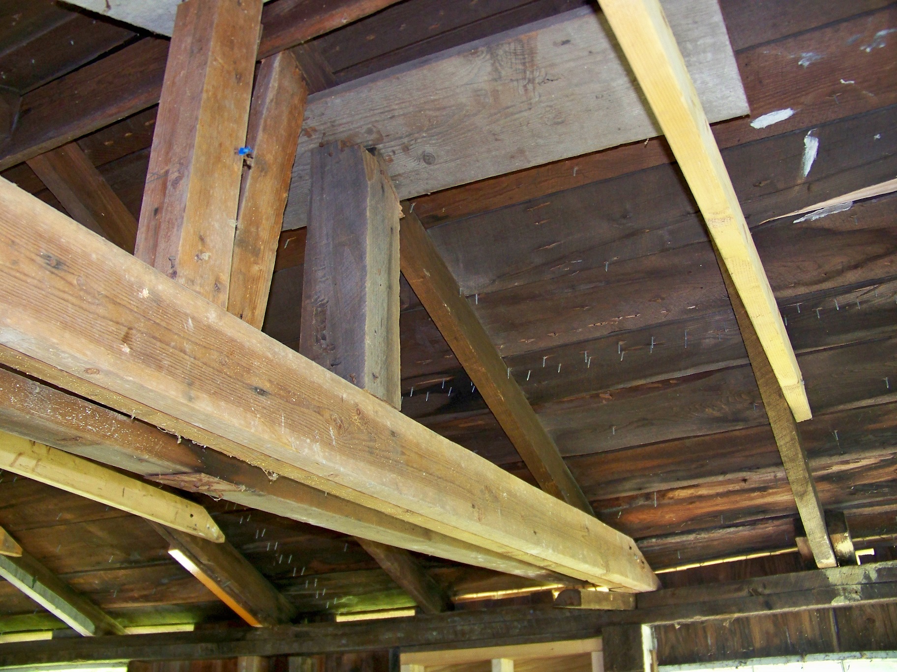

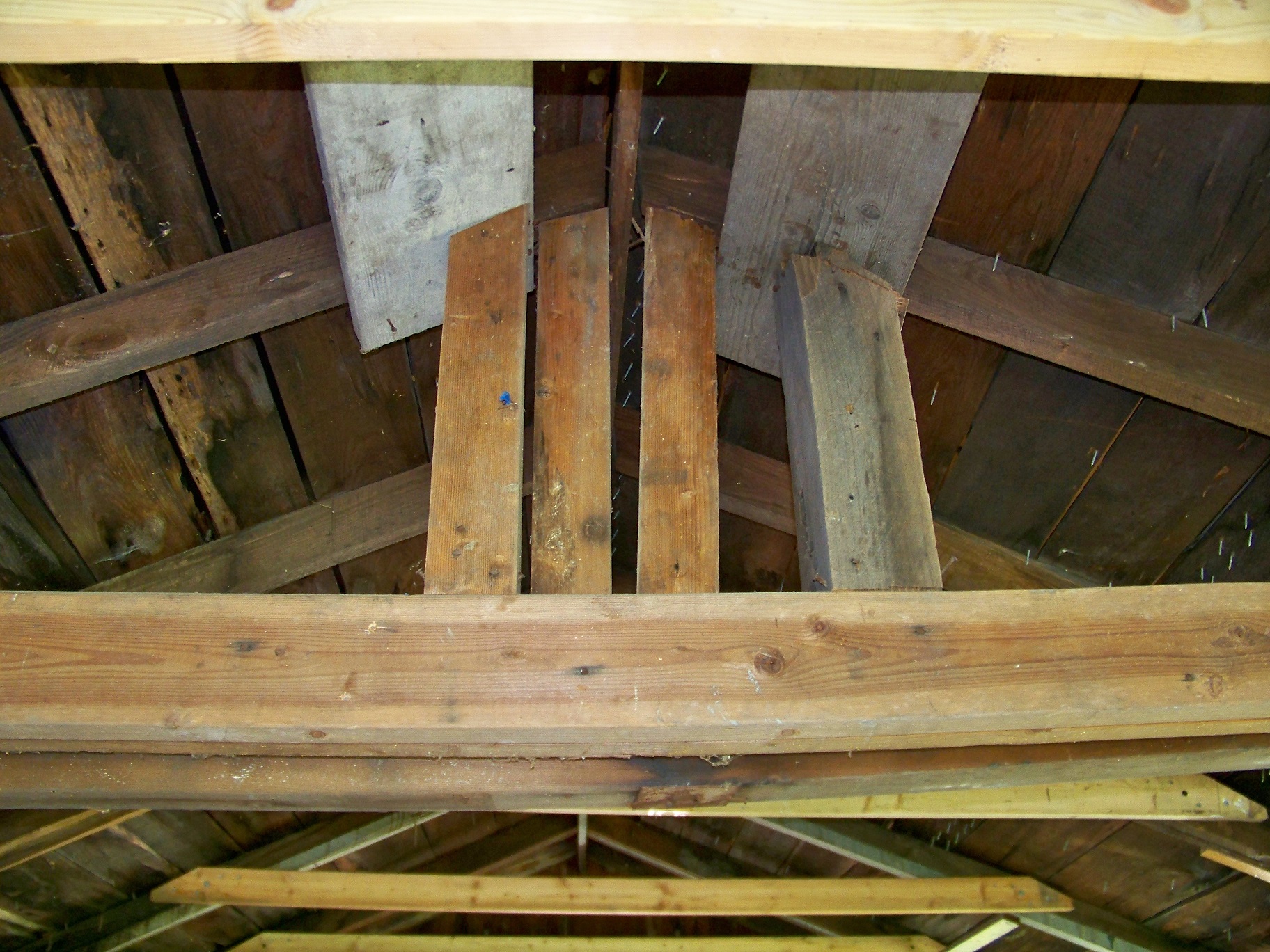

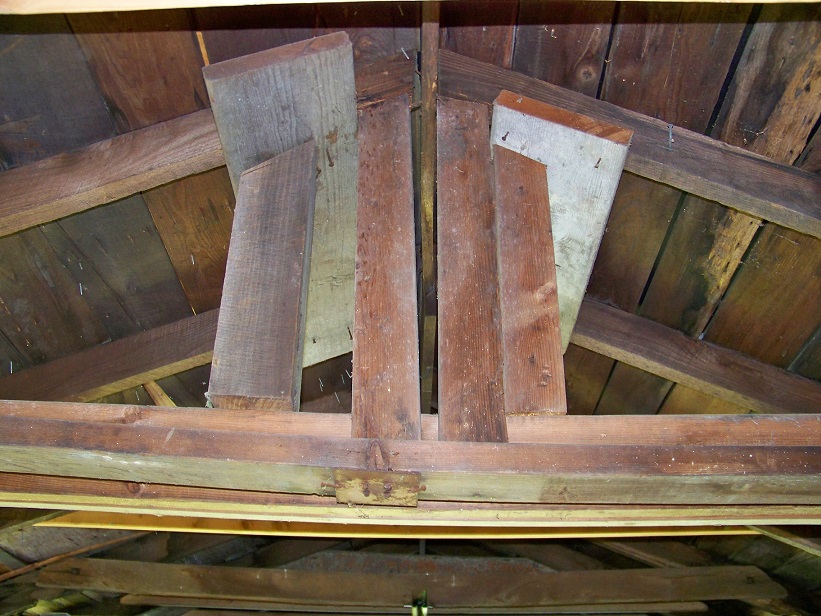

This is fantastic. I lifted (6") and restored an old garage on our property (90 years old), so I can relate to this.
After I finish the floor I'll be removing that crooked center beam. It's a giant cluster f...

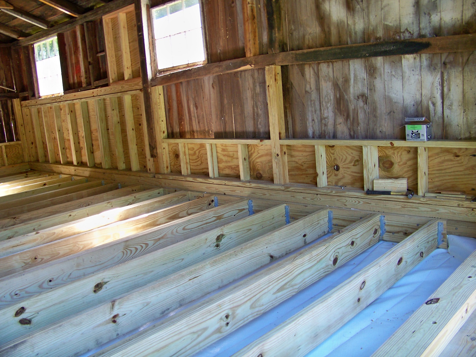

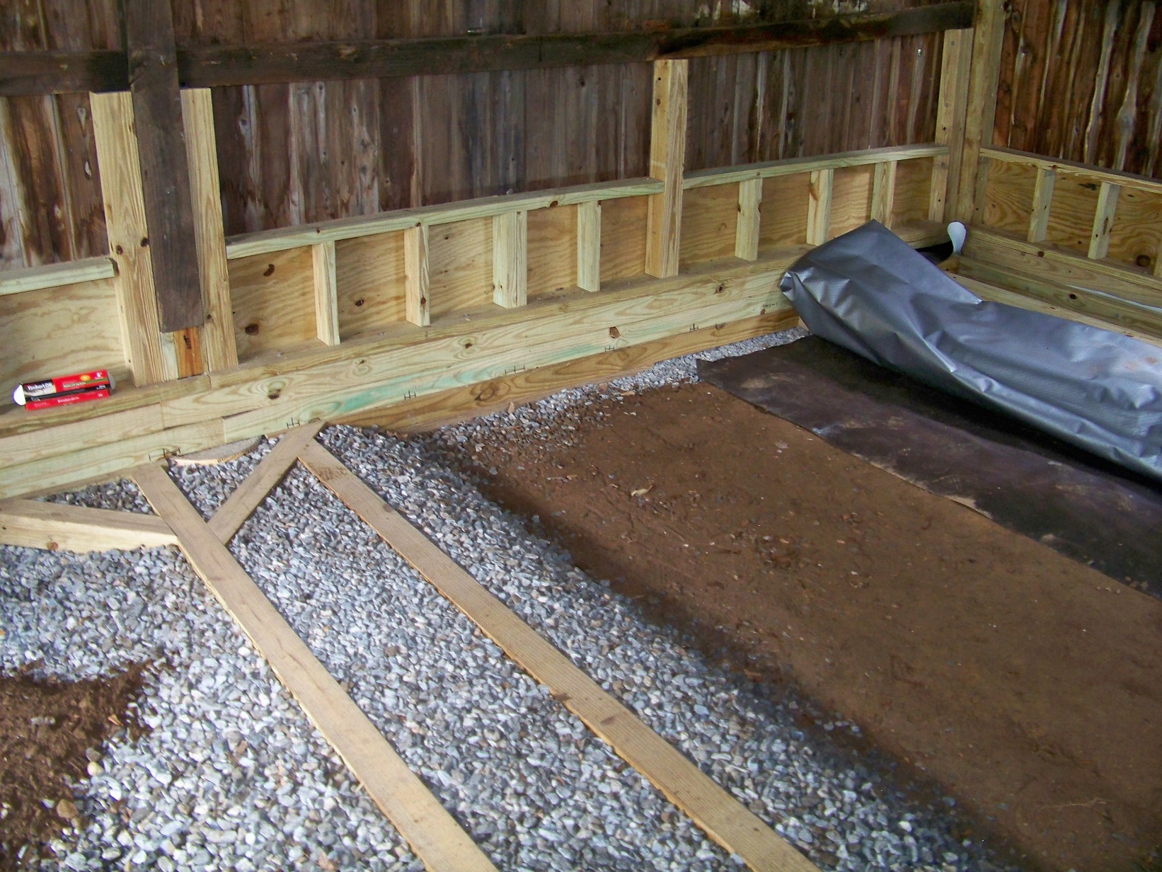

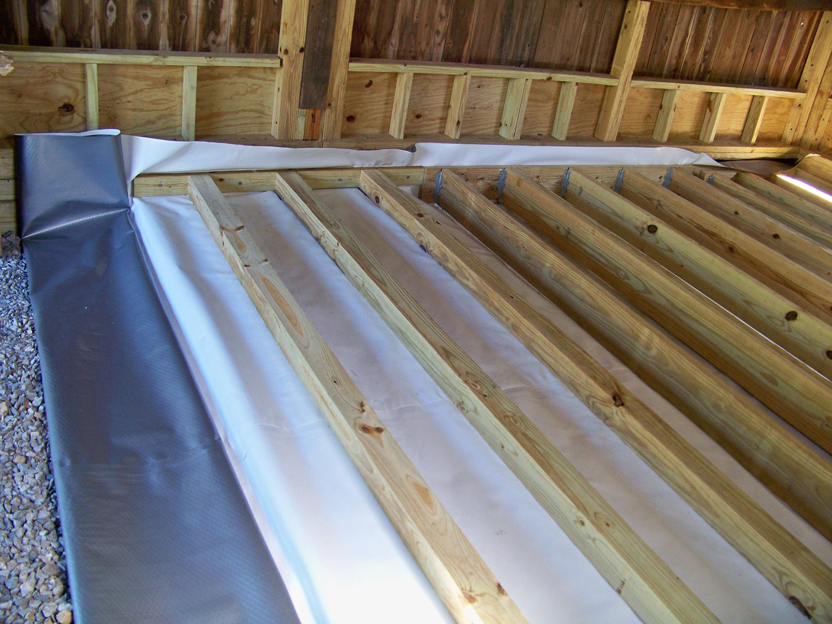

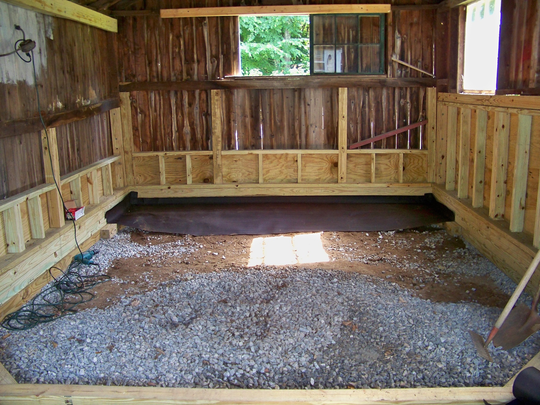

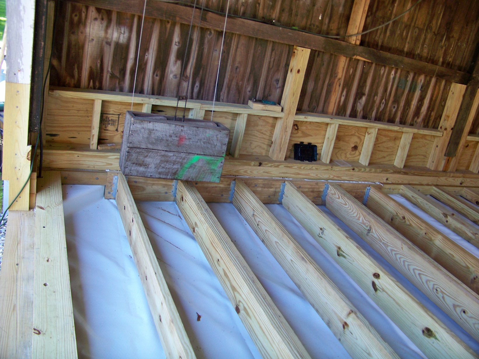

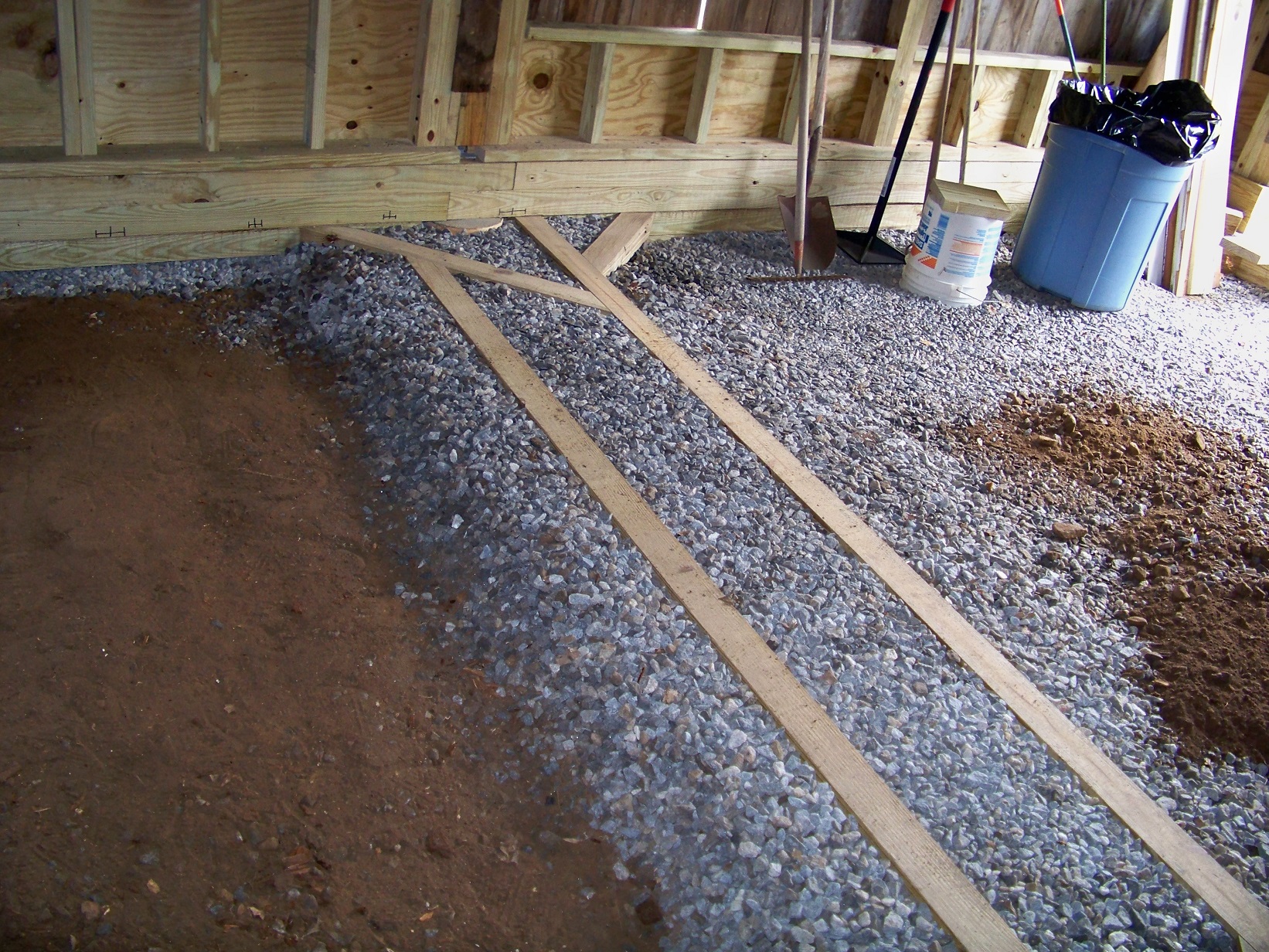

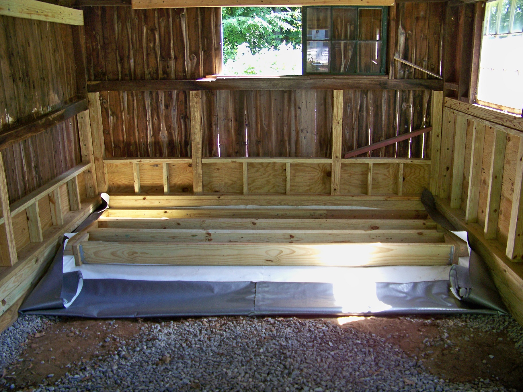

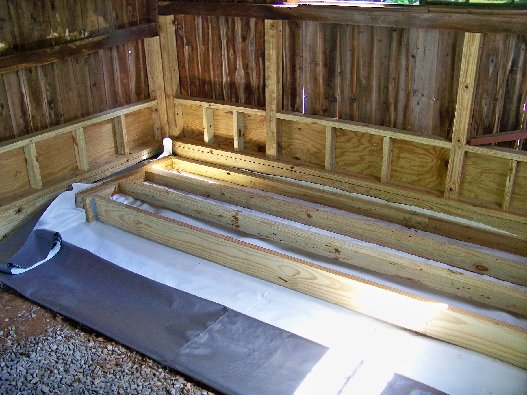

Floor Progress
Discovered my prior dirt/gravel level would interfere with the joists so removed most of the gravel and tamped. Took more time than expected to get it right - being 100° in there doesn't help either.
Working around the 45° 4x4 supports is a challenge. Added second 4x4 cross support to simplify things a bit.
Installed 2x8 ledger boards, joists and hangers. Ledger boards bolted with 3 5/8 LedgerLok bolts (which I have plenty left over from the lifting frame). Joists are 16" OC, double 2x8s spaced 4ft OC made with 1 full length and a couple shorter lengths glued and screwed - adds strength and gives me more screw surface for plywood install.

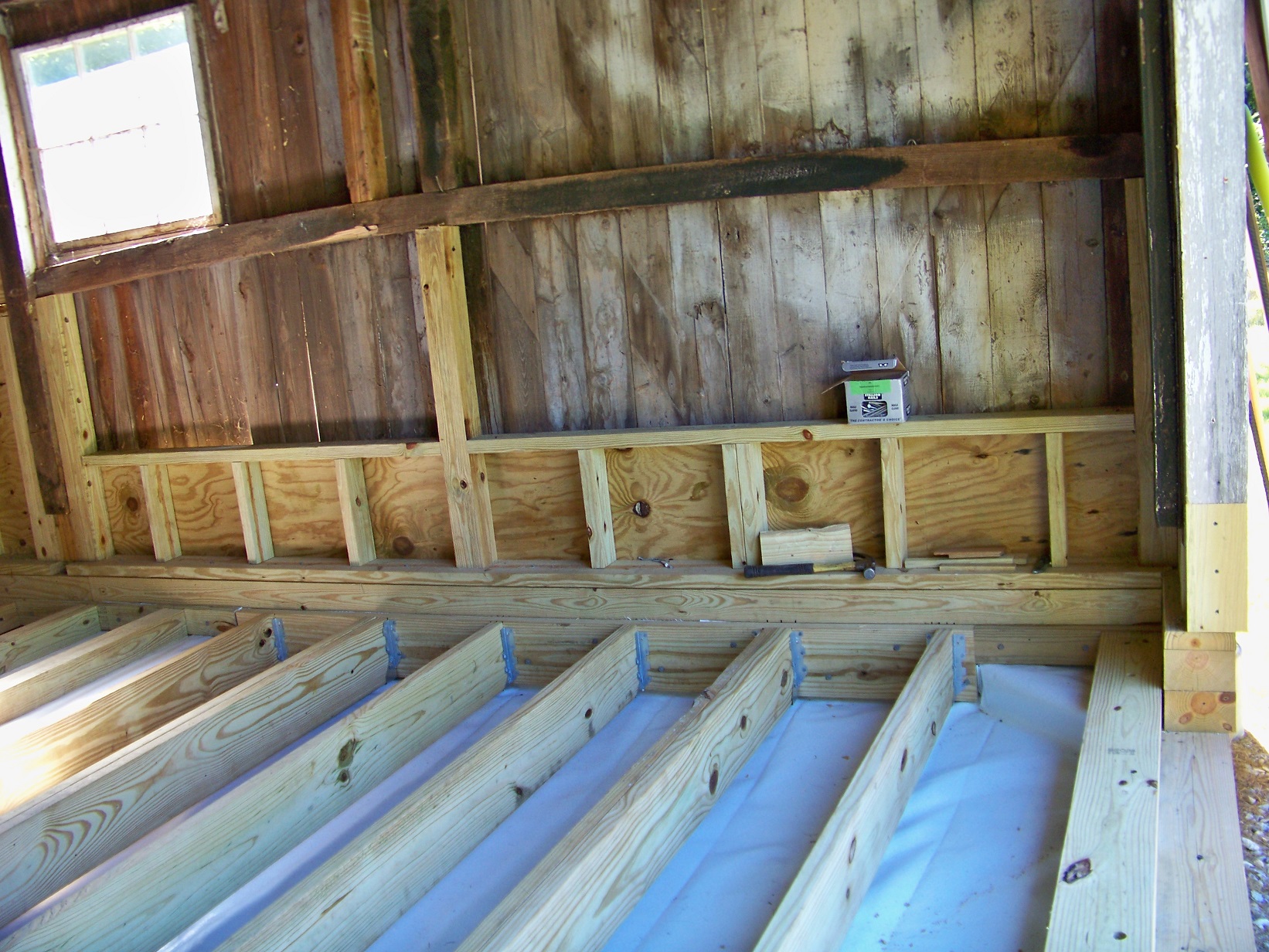

I don't think I need blocking, but is it worth doing at say 4' centers?
Any thoughts on load rating of the 2x8 10.75' span section after I glue and screw (or nail) 3/4 T&G plywood to it? All PT joists purchased in Connecticut HD.
Also, on the last hanger one of the holes landed on a knot, so I drilled a 1/16" pilot hole to get the 10D nail in. Is this acceptable practice? (FWIW: 16D nails used on the double 2x8 hangers)
FMC1959
Feb 9, 2014
2,319
Montreal, Canada / Upstate NY
You are doing a heck of a job, much more overbuilt than most sheds. I commend you on all the time and effort you are putting into this shed....great work.
Blocks would not be necessary, but your criteria and tolerances have been so high till now, it certainly would not hurt. PT can be medium to very wet, so putting in blocks could help down the road, preventing any twist or warpage, although this would be minor. If you do it, stagger the blocks....example, first row put a block at midway (5 ft mark). Next row, put 2 blocks at 3 & 7 ft marks, and continue next row at 5, then next at 3 & 7....till the end.
For the span, most PT is typically pine or fir, or similar. If you check spanning charts, 2 x 8's at 16" centers should be good for at least 12 ft.....here's an online chart
https://www.awc.org/codes-standards/calculators-software/spancalc
As far as the knot goes, I think most framers would hammer through it. If they couldn't, they would move the nail an inch either way to avoid it. I think what you did is fine. If you really worry about these things, drive a screw within an inch of the knot, to avoid it. This would be only for **** people like me, that worry because knots do dry up and shrink, which might cause the nail to lift.
Great work so far. I think you will be very proud of the finished product.
EDIT, I just re-read and noticed the knot was for a hanger...just leave as it is, should be no problem.

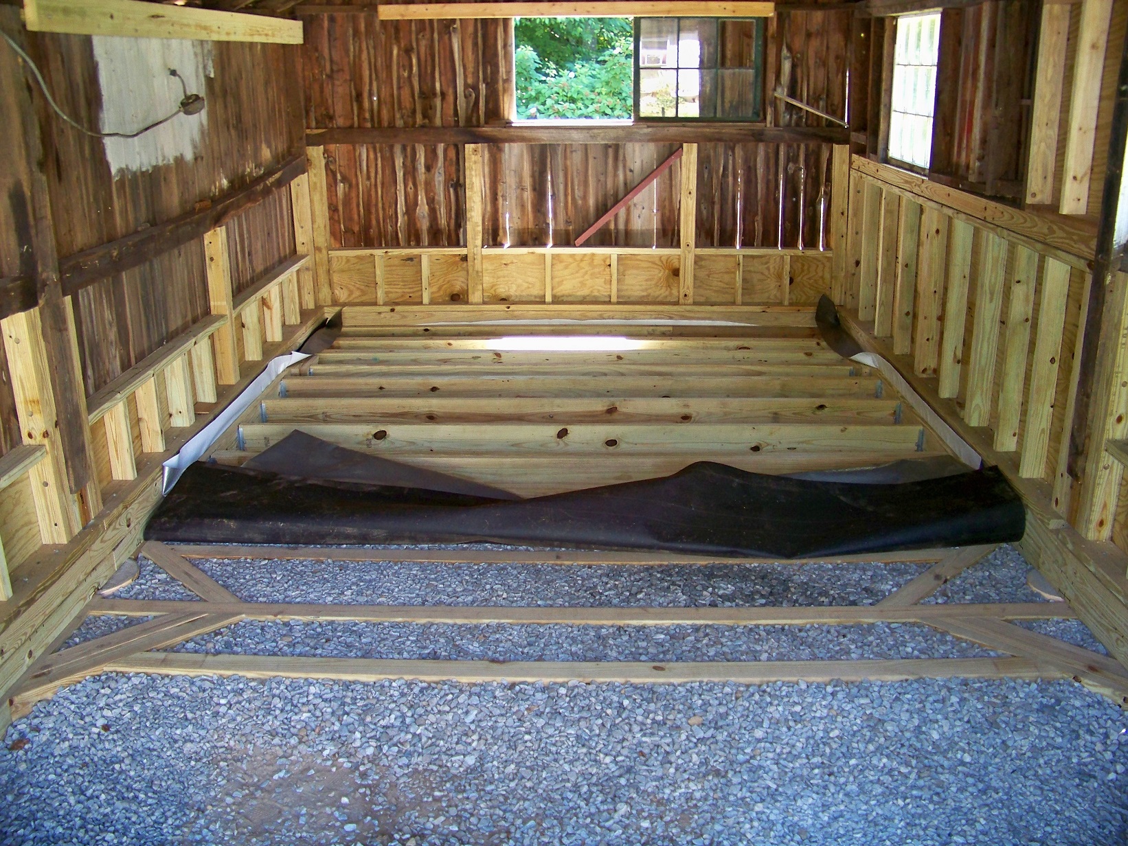

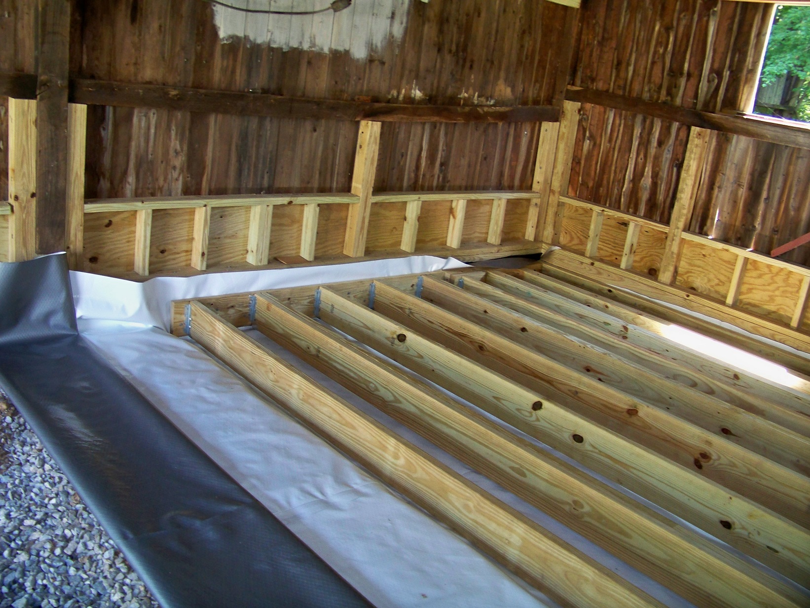

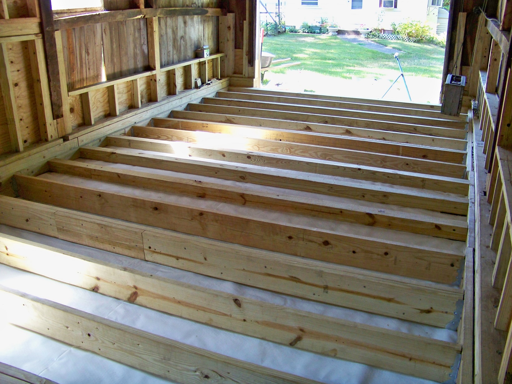

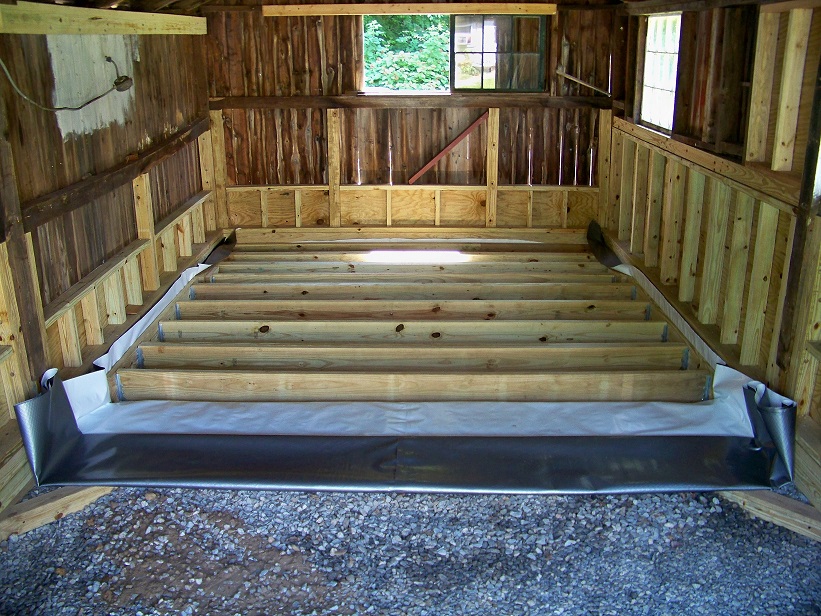

Progress Pics:
Added a couple 45° supports so I could make use of a 10ft 4x4 I had.
Top 4x4s attached to 4x4s under plastic.

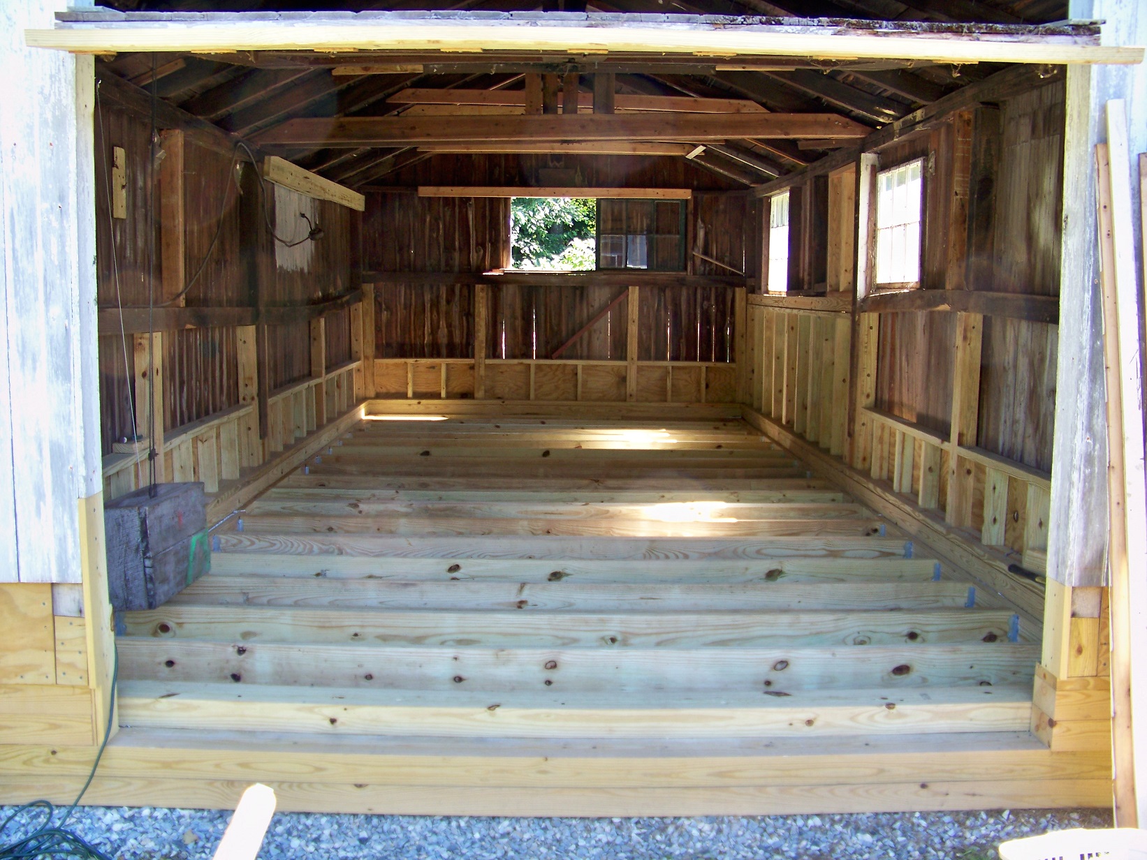

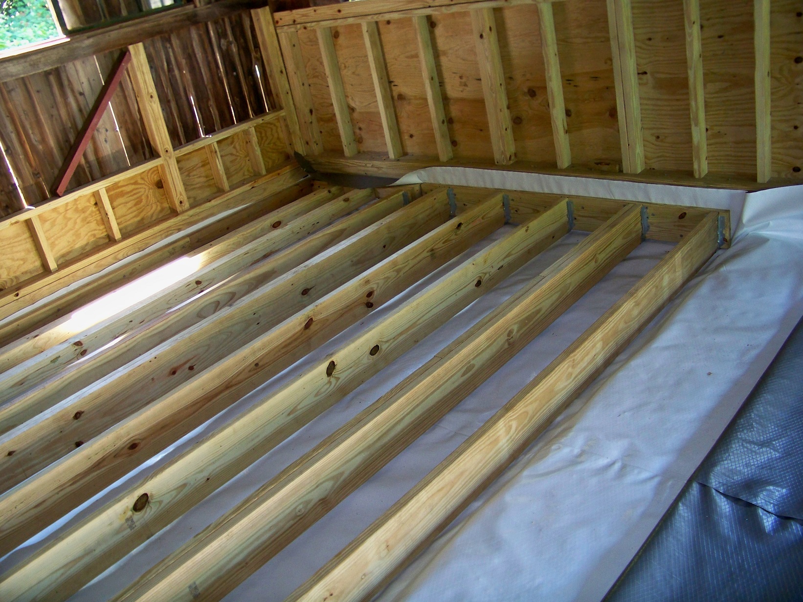

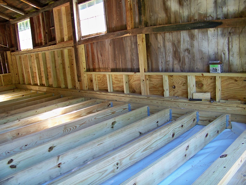

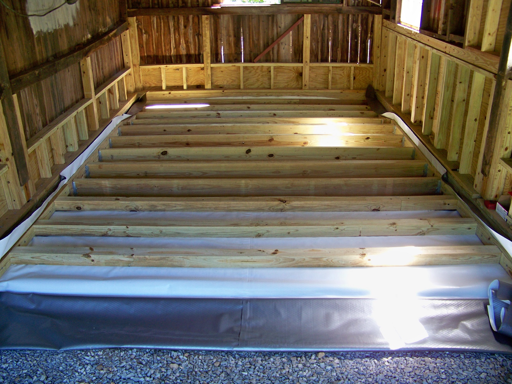

Progress Pics:
Finished installing floor joists.
There's a 4x4 bolted to the structure underneath the 4x6.
I almost managed to do the entire floor from the pile of leftover lifting frame lumber. I did end up having to buy two 12ft 4x4s. All the screws used were recycled from the lifting frame. Next step = blocking.
When the time comes, I've decided not to glue the T&G plywood to the joists. If the roof ever leaks and damages the floor, I want a fighting chance of replacing a section. I'll still glue the T&G to each other.

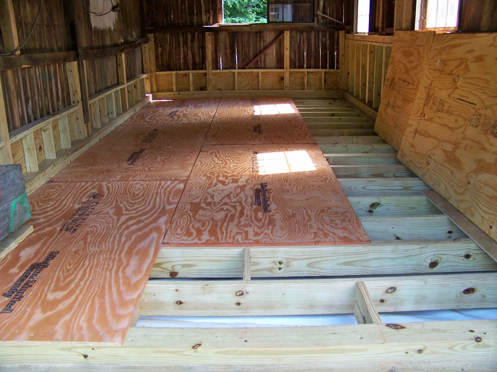

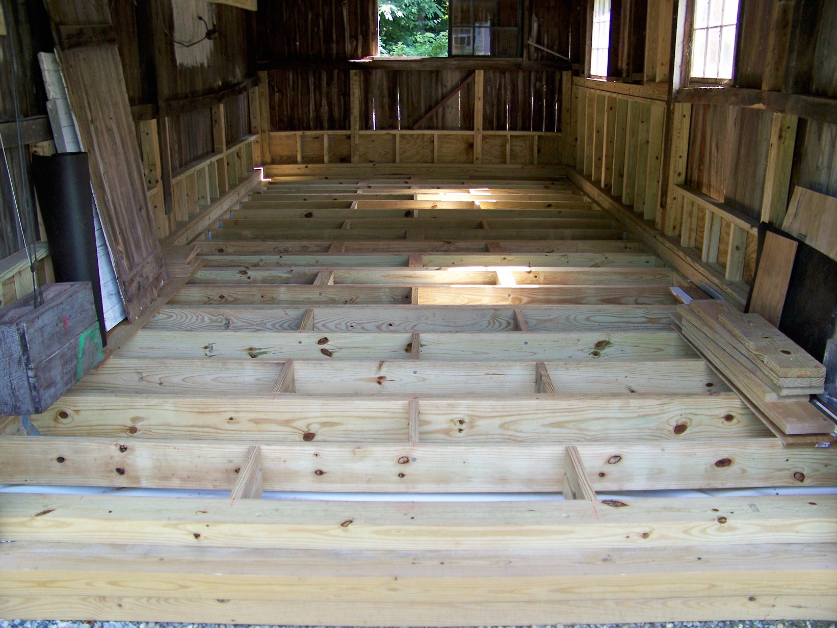

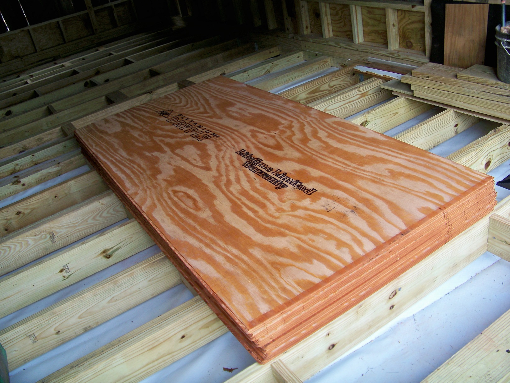

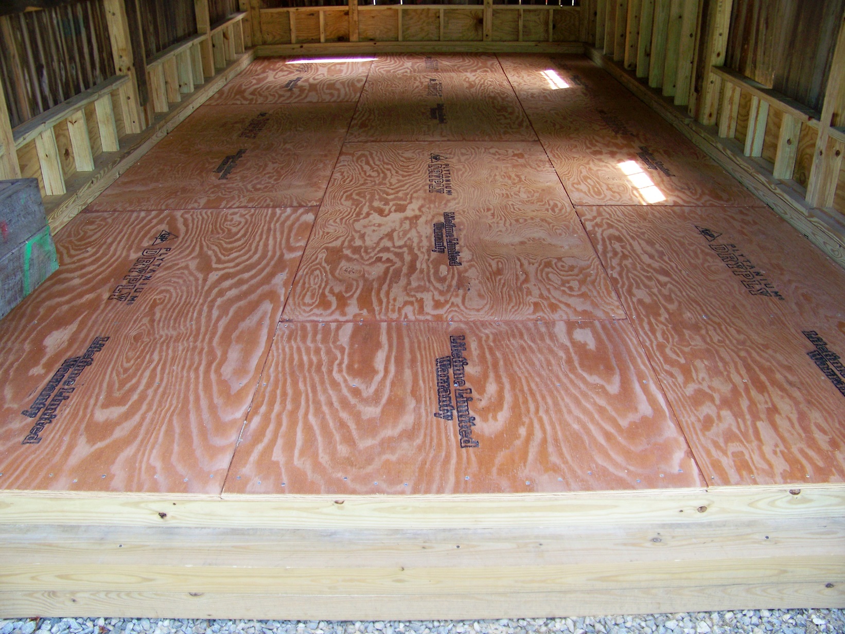

Finished blocking. Excellent use of all those otherwise useless scrap pieces I had laying around. Floor feels rock solid now.
Picked up 9 sheets of 3/4 (23/32 actually) T&G Plywood (link). This stuff is so good it has two snazzy names: Plytanium DryPly. Sounds more like a Marvel comic character than a building product.
P
Platonic Solid
Nov 29, 2014
3,587
CT-USA

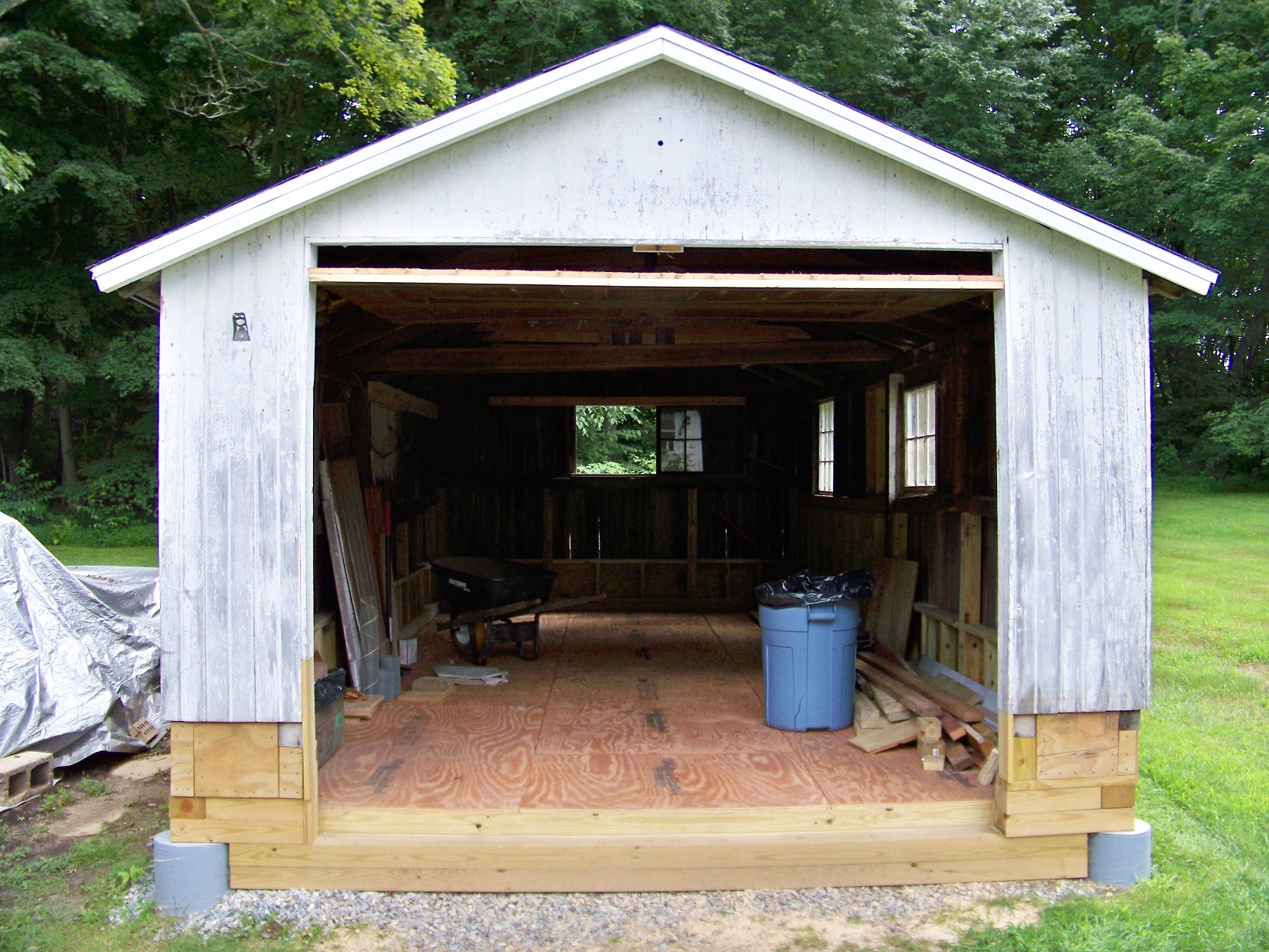

Progress:
It's official! The Rat Shack now has wall to wall T&G Plytanium flooring! That sentence alone should increase resale value at least $1,000 over uninspired regular no-name plywood sub-flooring. :)
Now onto the walls. Seeing as how there are plenty of gaps in the vertical siding, I need to do something about that . . . tar paper, Tyvek, plywood . . . not sure what yet, but something.

Yes, no bounce, no flex, feels great. I'm sure it's safe to put a motorcycle in there. Not sure I'd put a car in there (not that I intended to do that anyway).

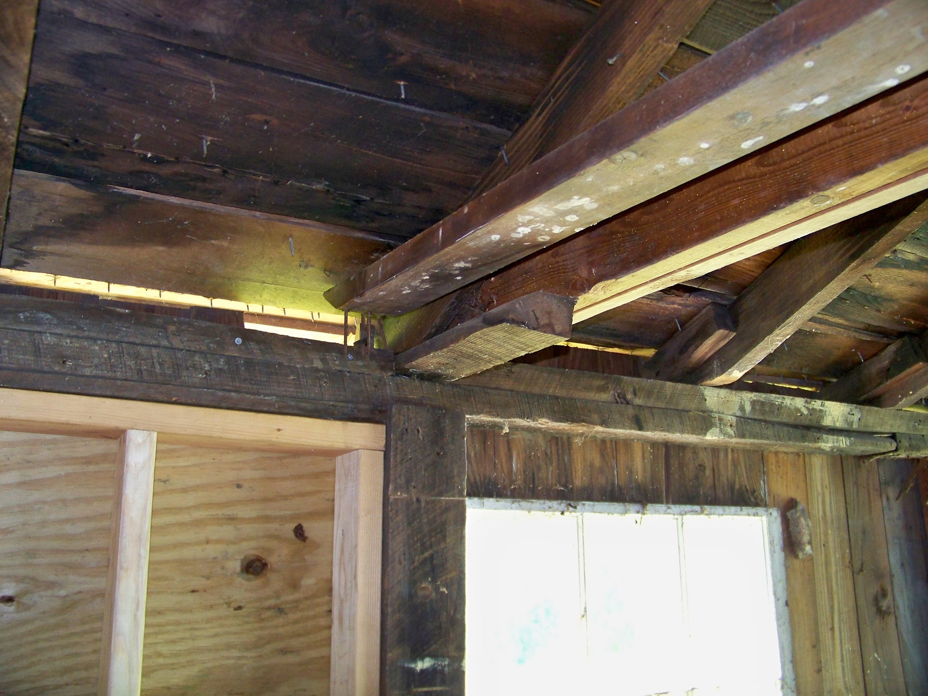

Interior walls:
I was thinking of using 2" EPS foam board (link) cut to fit the openings between the post and beams. I believe the foil faced side should be towards the interior, but would rather have the white side in for the light reflectance value. Not sure it matters in a shed that isn't heated or cooled. Purpose is primarily to keep the interior dry without causing unanticipated moisture issues on existing siding (plus, detering a few bugs and spiders wouldn't be the worst thing that could happen).
I was also thinking of using tar paper between the EPS and existing siding. Not sure if I should provide an air gap between the siding and EPS. I could make an air gap easily enough using vertical strips of 1" EPS between the siding and 2" EPS.
Felt/Tar paper would be attached to interior siding - then 1" EPS air gap strips - then 2" EPS board.

bored350 - Good point. I am going to make a valiant attempt at making this building mouse-proof. Whether I succeed is a different story. With respect to rodents, having an air space between the EPS and siding is more apt to give them a nice hiding space. I'm guessing I could skip the air space without issue since the building isn't heated/cooled.
Cutting anything less forgiving than EPS to properly fit the curved beams is more hassle than I'm willing to deal with on this structure.

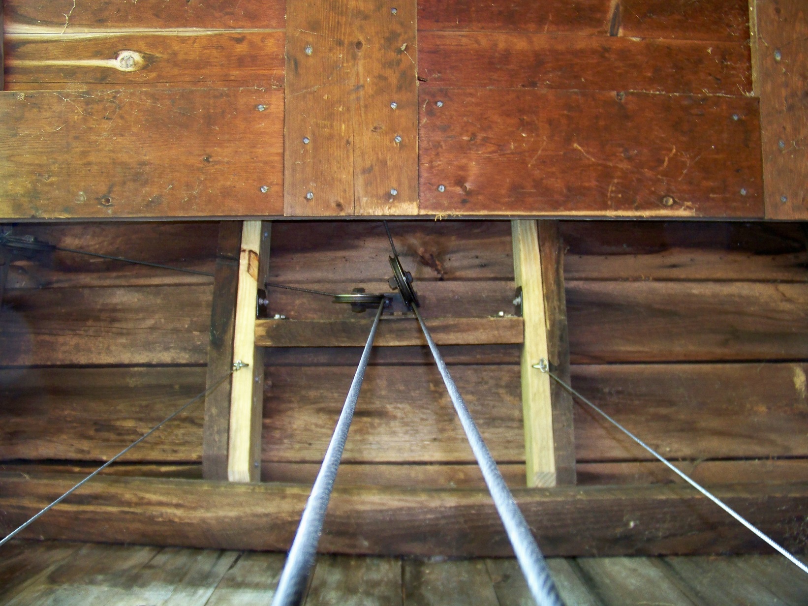

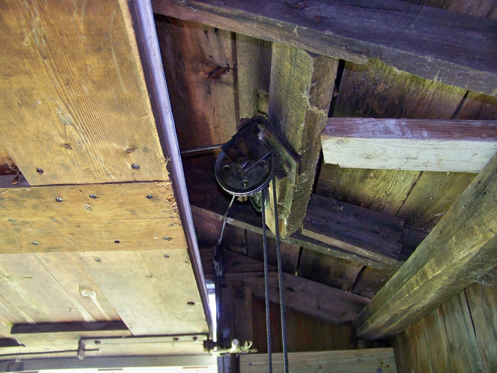

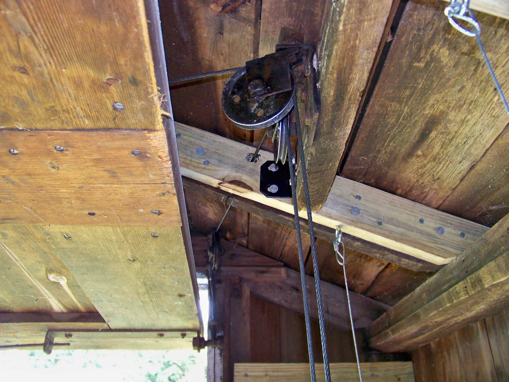

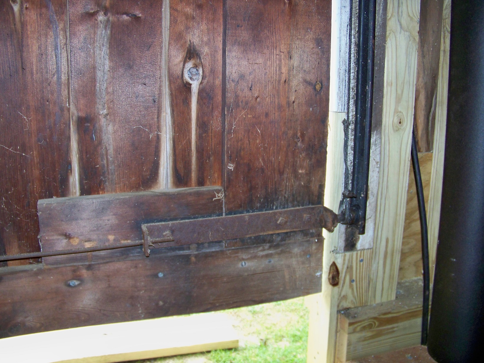

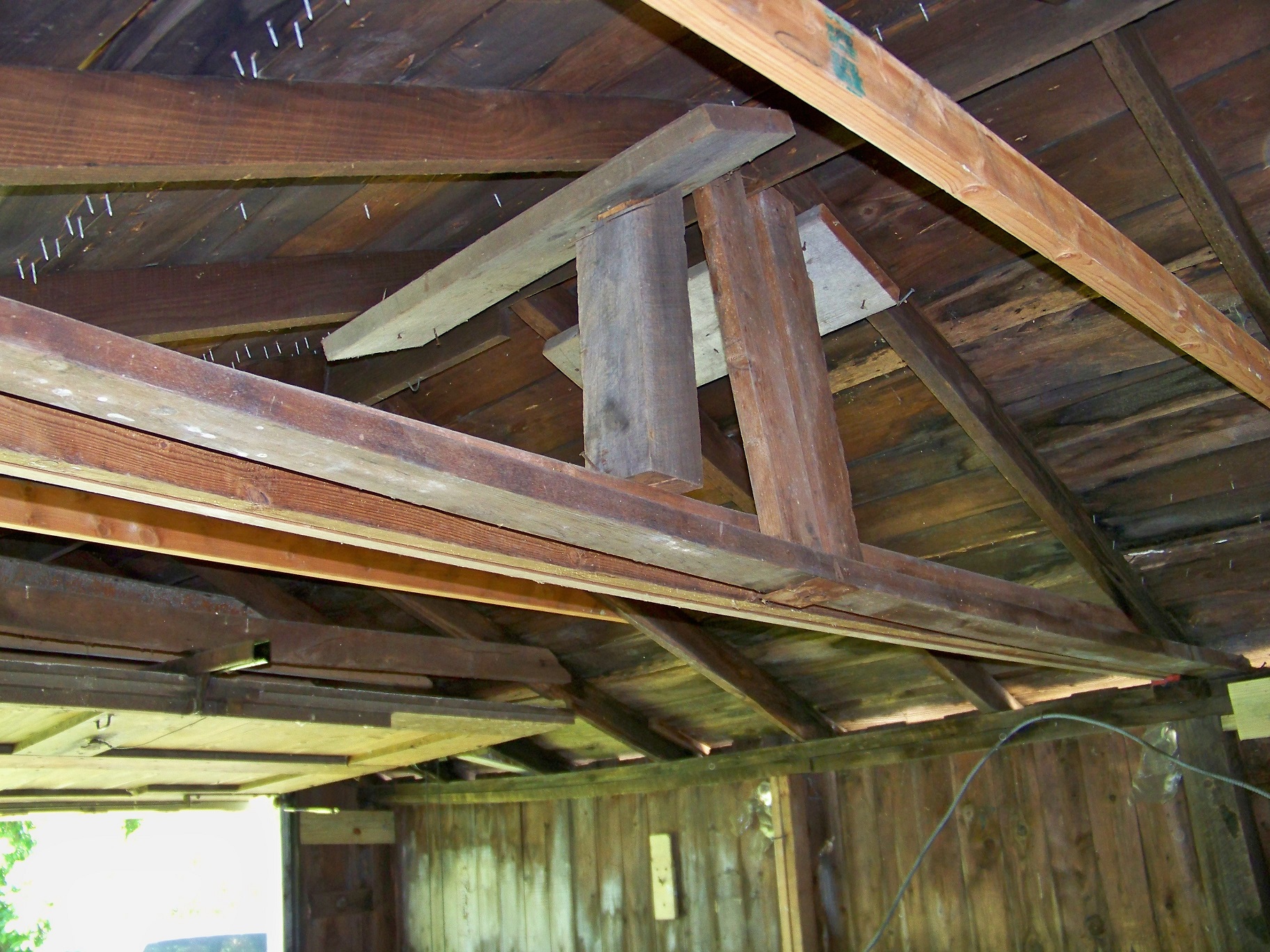

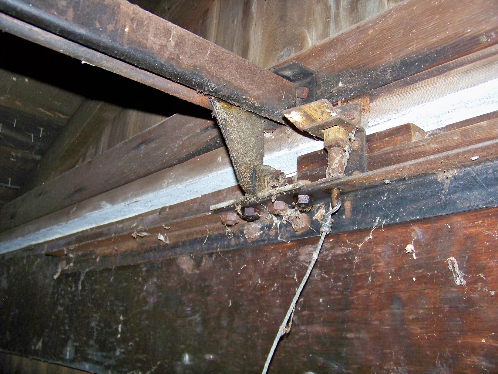

Decided to fix the garage door which hasn't worked right for many years. This is what actually started the raising of this structure as I kept hitting my head on it. I figured now that the structure is raised it was worth fixing the messed up pulley setup.
Previous owners just wedged pieces of word in there to keep it from tilting even more. There is a hole in the rafter for the cable, but someone decided that wasn't necessary and allowed the cable to cut a significant grove in the rafter.
Below is "fixed".
Emptied all the sand out of the weight cause it was leaking all over the place. Put a heavy weight plastic bag in there and put it all back plus some gravel and a couple bricks as even with the pulleys fixed the door still doesn't stay open all the way. It's oddly worse than before I "fixed" it. :wtf:

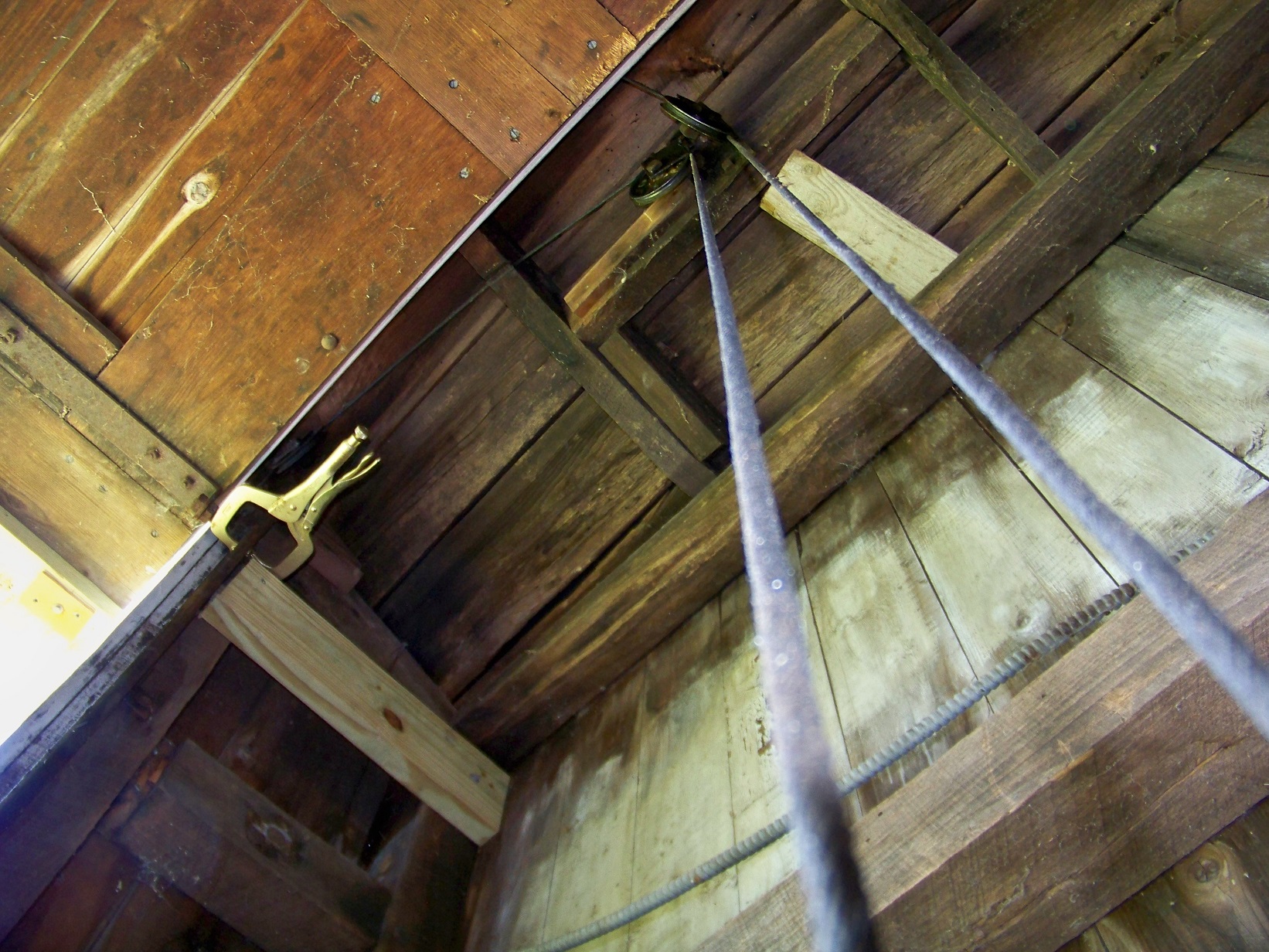

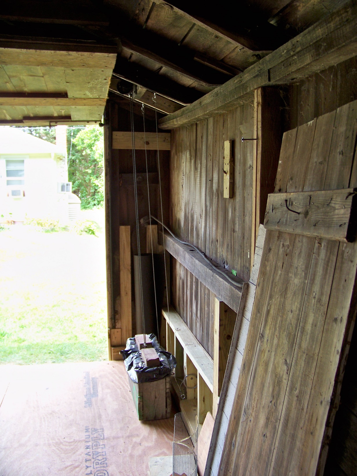

Last fall I attached an 8'6" 2x10 pressure treated board to the bottom of the garage door to take up the large space. I figure this is too much weight for the counter weight to handle.
Previously posted Last Fall pic
Removed the 2x10 and cut the bottom straight.
This solved that full open issue, but then one of the rollers pops out of the track and I discover it has no bearings - like they all fell out long ago. Which would account for why it doesn't operate smoothly.
I managed to pop it back in the track using a pry-bar and clamps. (Yeah I know that's not he way it's supposed to be done, but was way too frustrated to do it right). So now I'm searching for an 80-something-year-old replacement roller. Can't seem to find anything like it anywhere. It's a 2 inch roller with a 3/4" threaded shaft.
If I'm lucky enough to find the rollers I should probably replace the center roller mechanism too.
If I can't find replacement rollers it may be easier to just put a new sectional door in. I'll try posting my quest in the general section and see if anyone has any sources.
