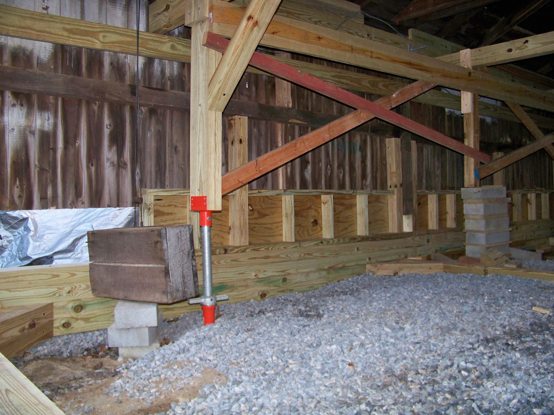

I don't have the option of letting the original column rest on the foundation timbers as that is where the concrete pier threaded rods are located. I could put a piece of 4x4 or 4x6 in the space between the threaded rod and original post attached to sistered PT on sides.
The cuts on the original posts were done with a sawzall, thus are far from straight.
I've used flat steel bar (clamped or temporarily screwed) on both sides of a 4x4 as a cutting guide to make straight cuts with a sawzall. Works very well.
Yes, its hard on the blades, but it gets the job done.
It would seem prudent to get the building shimmed and bearing upon solid materials, prior to adding the sistering boards.

How about this?
I could cover all of that with a 2x8.
Might be able to do something similar to the corner 4x4s. The anchor rods could be more of an interference issue there as they're not exactly perfectly oriented.

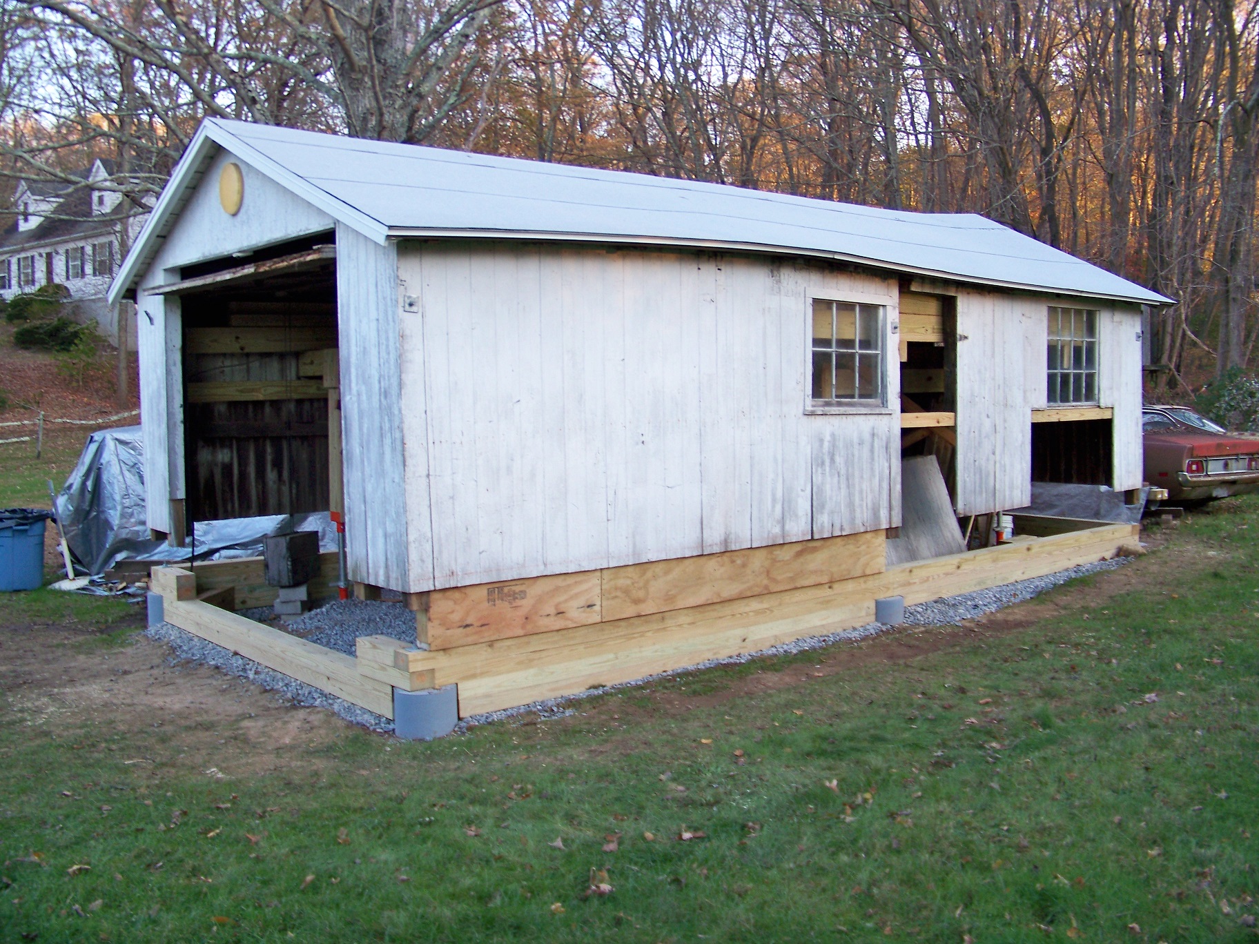

Your foundation looks good -- nice work on it so far.
I'd probably make the 2x6 sill plates pretty short -- about the width of the post. They don't need to go all the way along the exterior of the shack. I'm not sure why you're planning to use 24" tall PT sheathing behind the new siding. You could just use a strip of PT plywood about 6" tall instead -- that would be plenty to connect the old siding to the new siding -- it doesn't need to go all the way down to the sill plate.
The new siding should extend down past the top of the 4x6 beam, so water can't get into the foundation on top of that beam. The siding can be attached to the beam instead of the sill plate. if you're worried about rain getting in through the siding, you could attach Tyvek to the inside of the siding.
Are you planning to make the floor level with the lower section in the doorway?

RickP – Making a pseudo half wall with full sill and plywood will make straightening/aligning the walls easier as the foundation isn’t in ideal alignment with the walls in all locations. I will attach it to the existing posts, beams and siding – push walls to desired location – then secure sill to foundation.

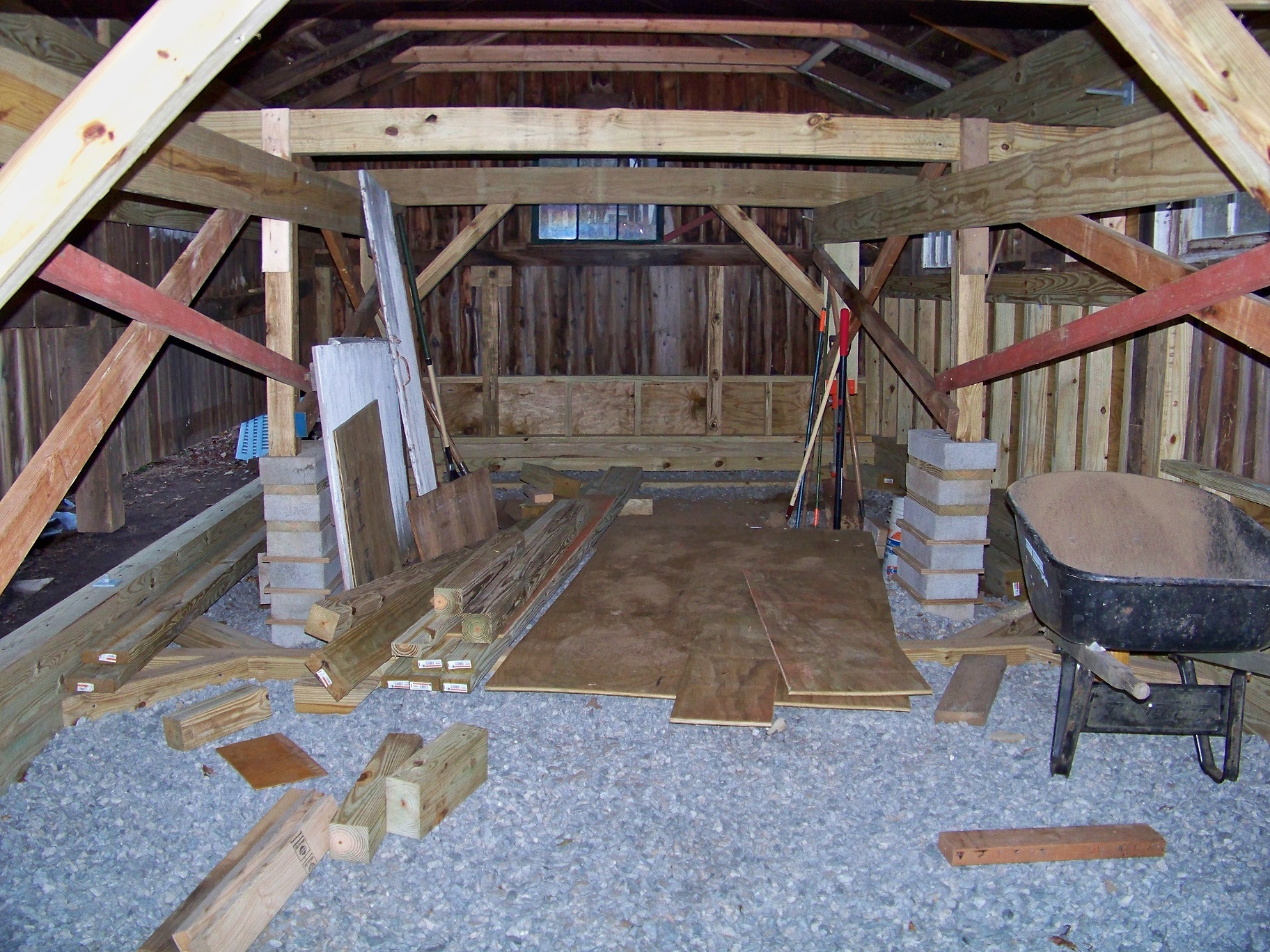

Though the floor may not happen till spring, my current thinking is a free floating floor:
Bring gravel up to lower section in doorway (tamp)
Cover with vapor barrier (tape to foundation)
Place 2” insulating sheathing (tape seams)
Glue T&G plywood to insulating sheathing
This will raise the floor 2.75” from the current garage door sill pictured.

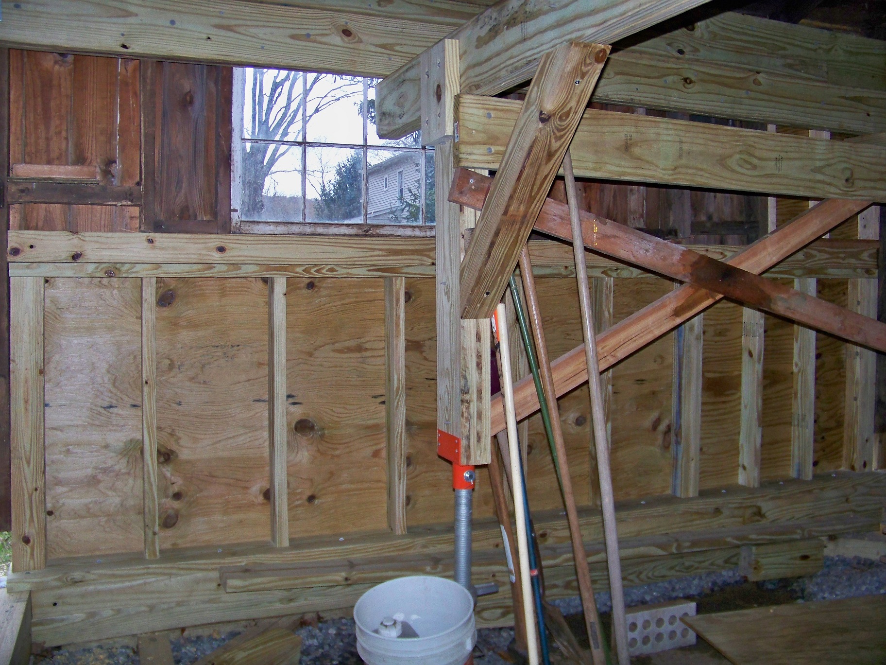

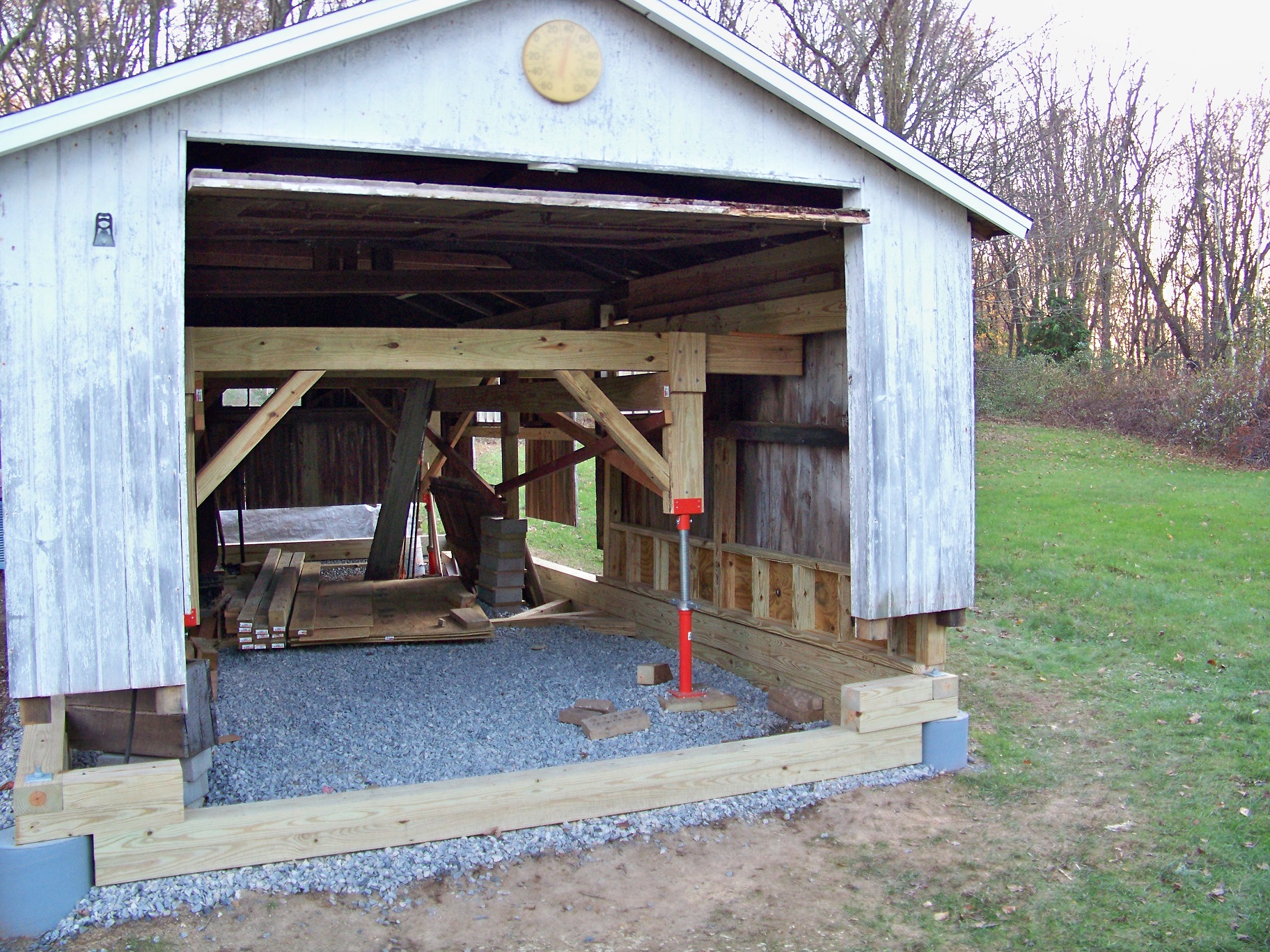

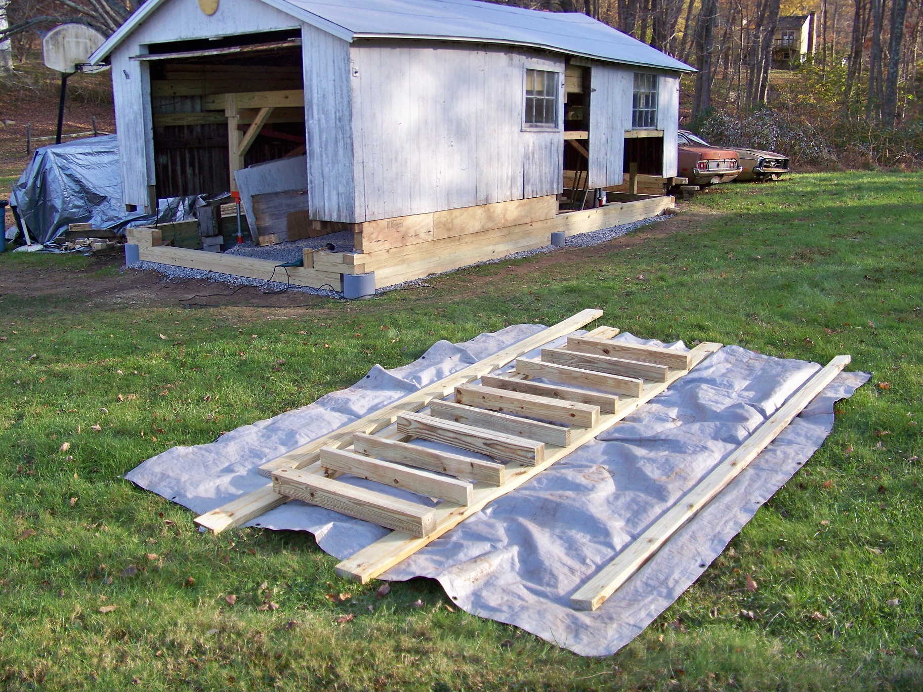

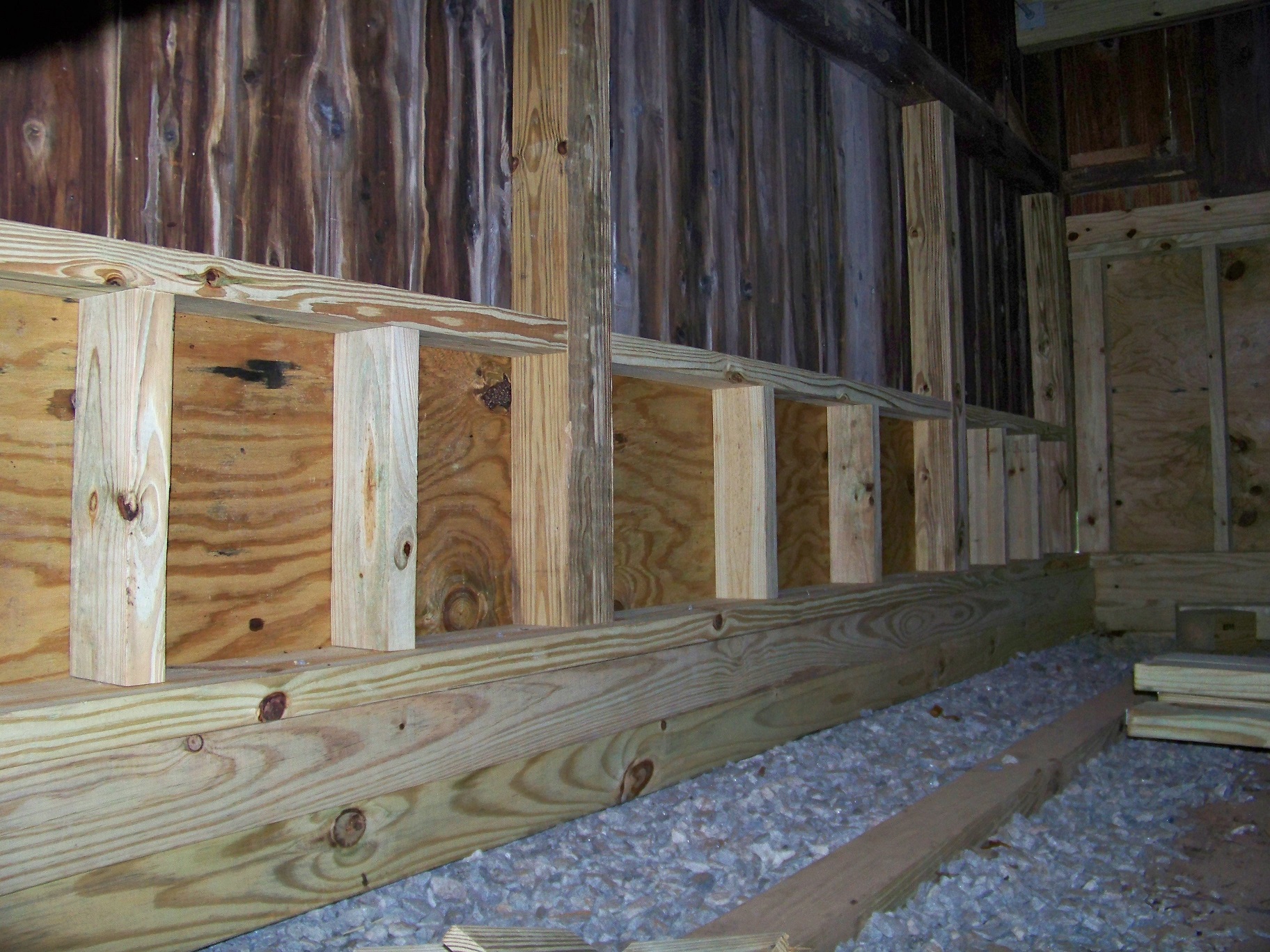

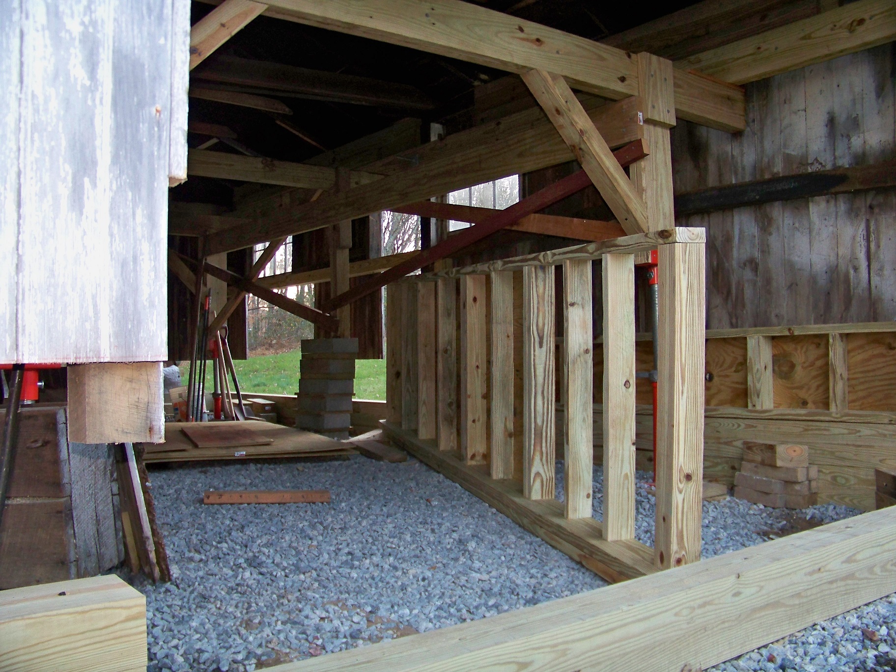

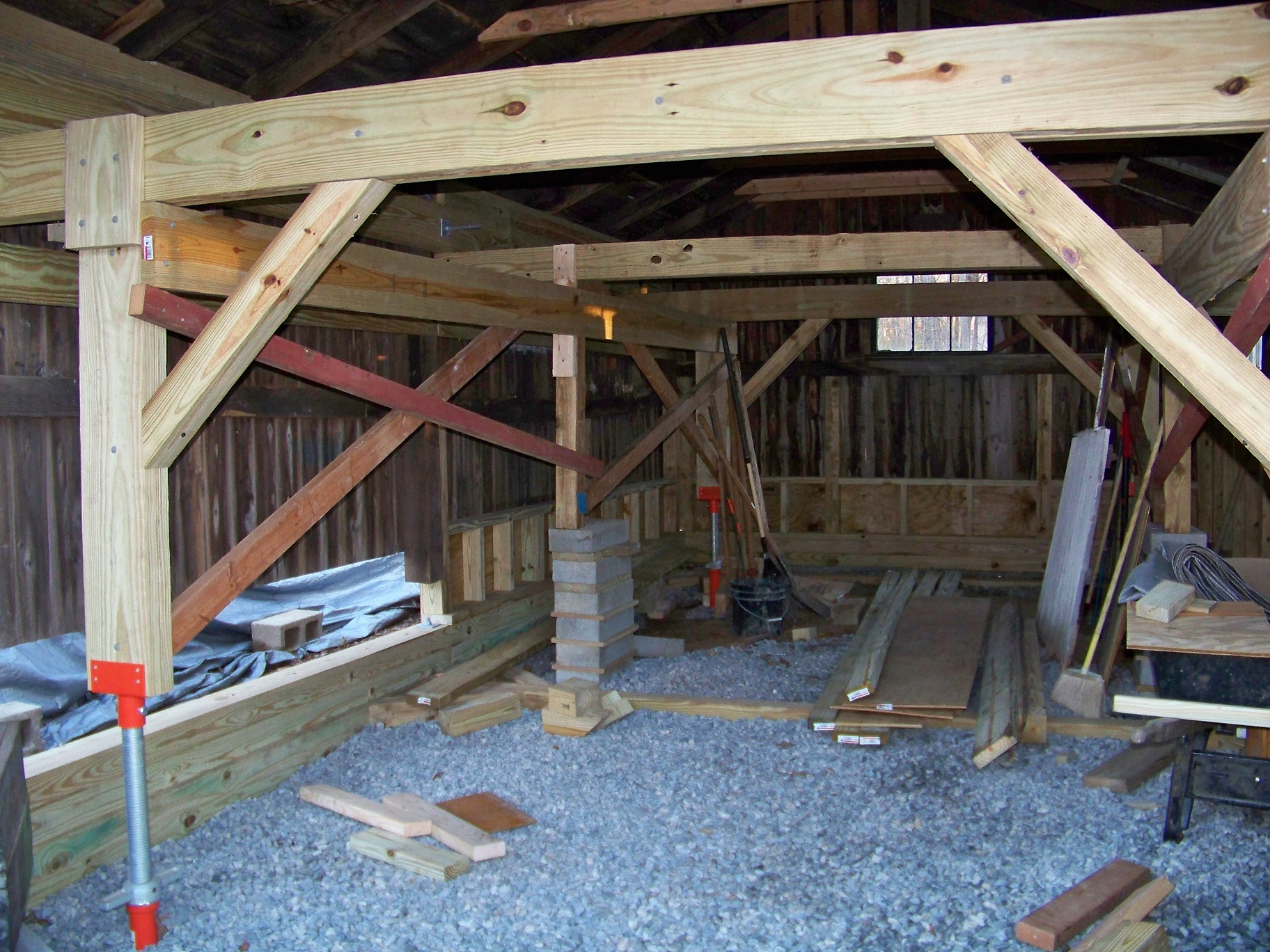

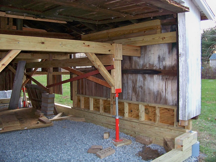

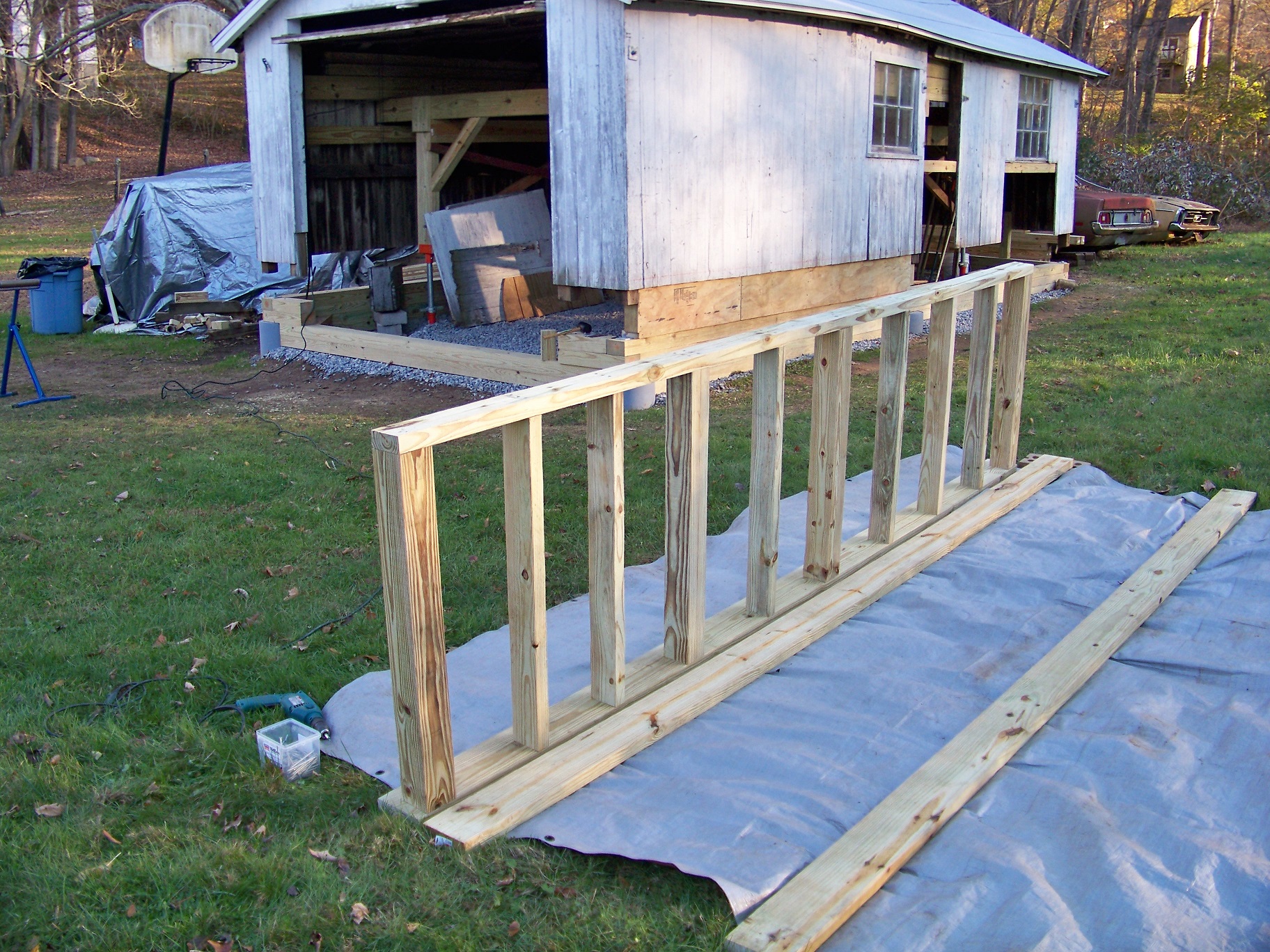

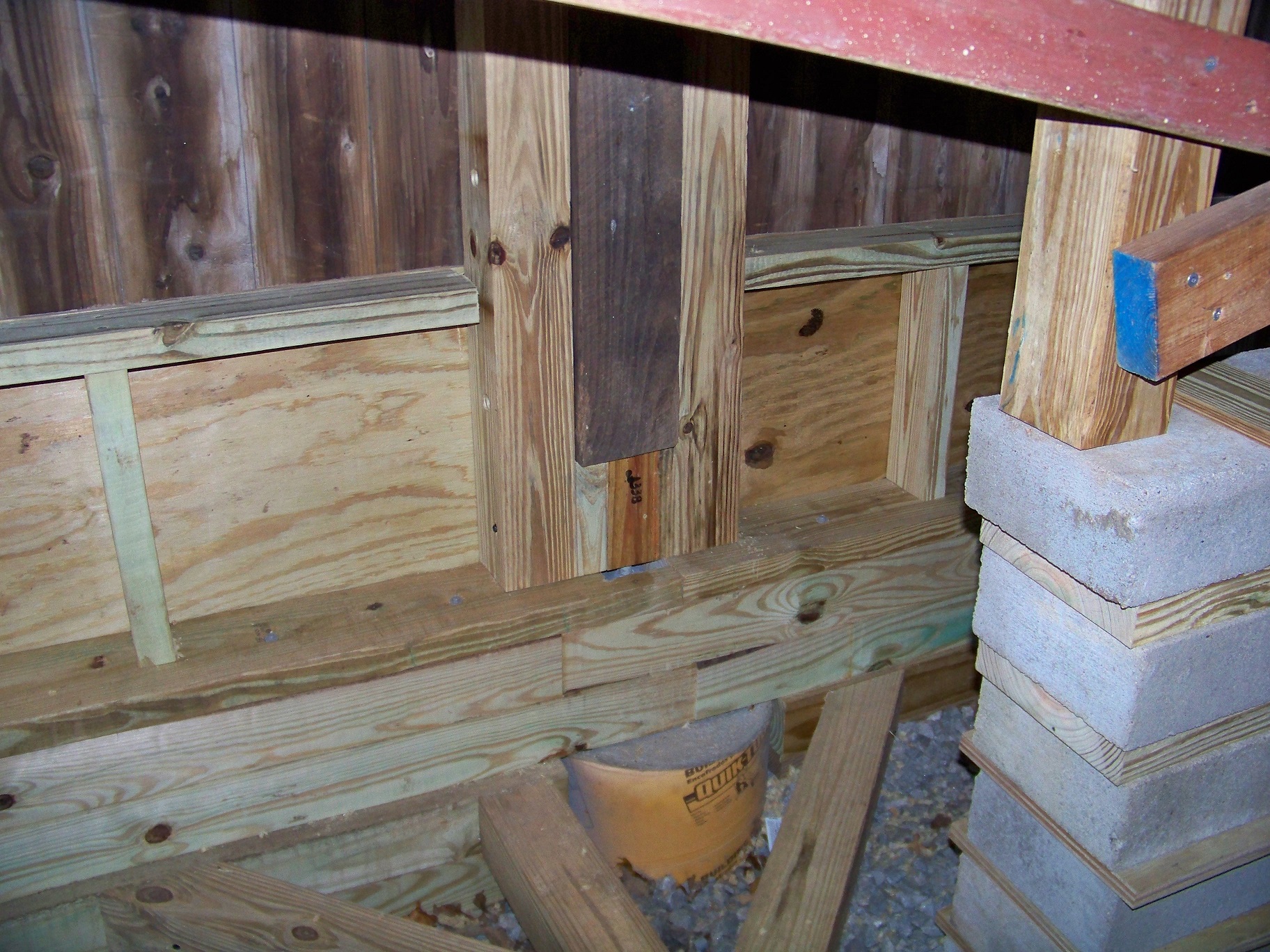

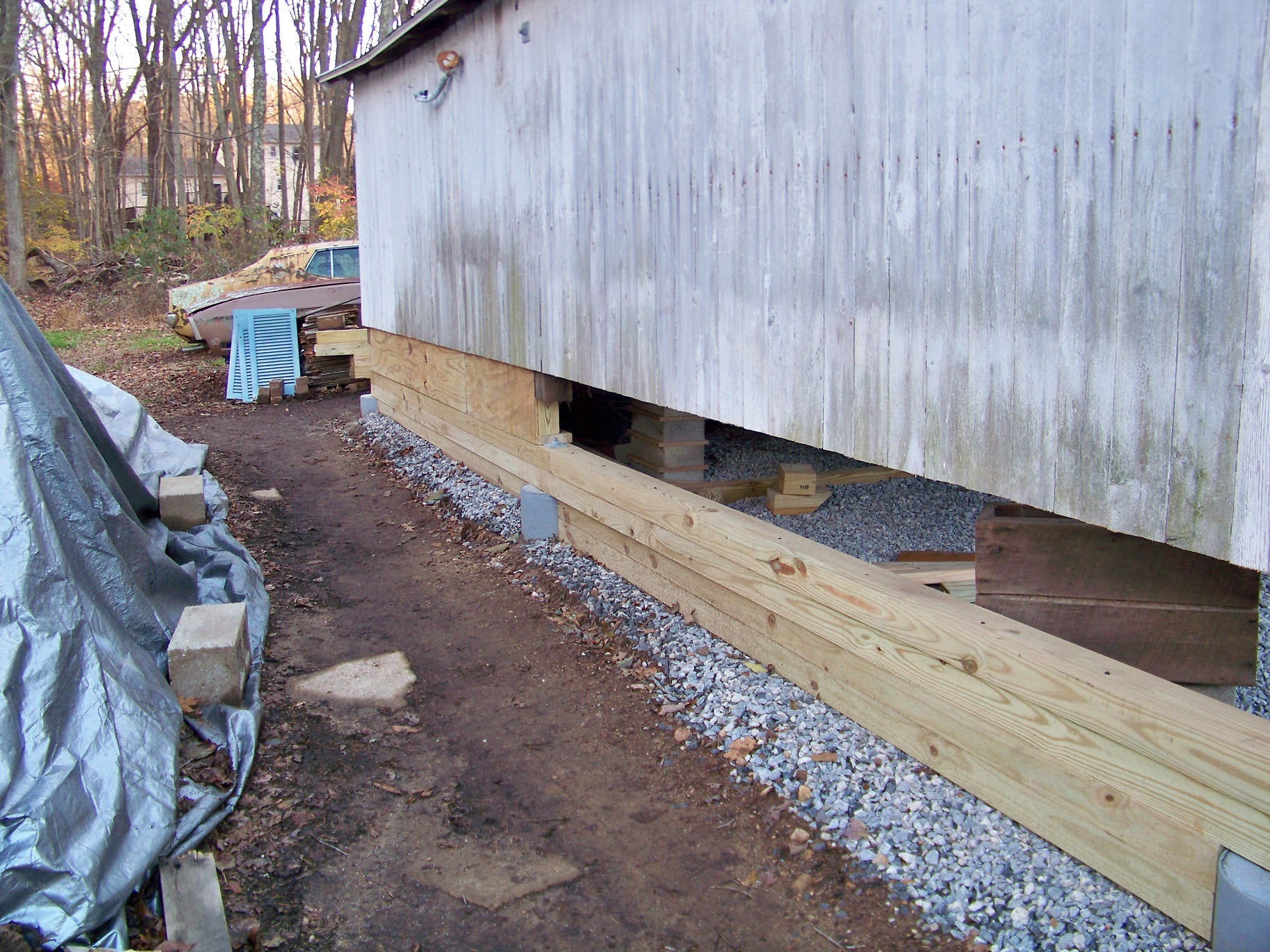

Progress Pics:
Prefabricated the first support wall on the ground and put it in place. A bit awkward getting it placed as the lifting frame is in my way. Found it a little easier to push it in from the exterior. It isn't actually attached to anything yet.
Before making the wall I lifted the right side another 3/4" as this is my last chance to get it right. Since the right lifting shore is maxed out, I used a bottle jack and stuffed a 3/4 shim on top of the lifting frame.
Prefabricating walls might work well for new builds, but it didn't work out so well for this structure. After building the wall and fitting the bottom into place, I found the existing center post is not straight. Fortunately I used screws to attach the plywood to the new posts (the rest is attached with nails). I ended up removing the screws and using the sawzall to cut the 2x4 so I could angle the new post to match existing post.

oldironfarmer - Thanks LOL. Heck yeah! I watched a couple youtube videos so now I'm an expert - NOT. I'm a bit of a perfectionist, so letting the small stuff go and moving on in favor of progress is a challenge.
I was originally going to make the plywood portion 24" tall, but ended up going for 16" to use less material.

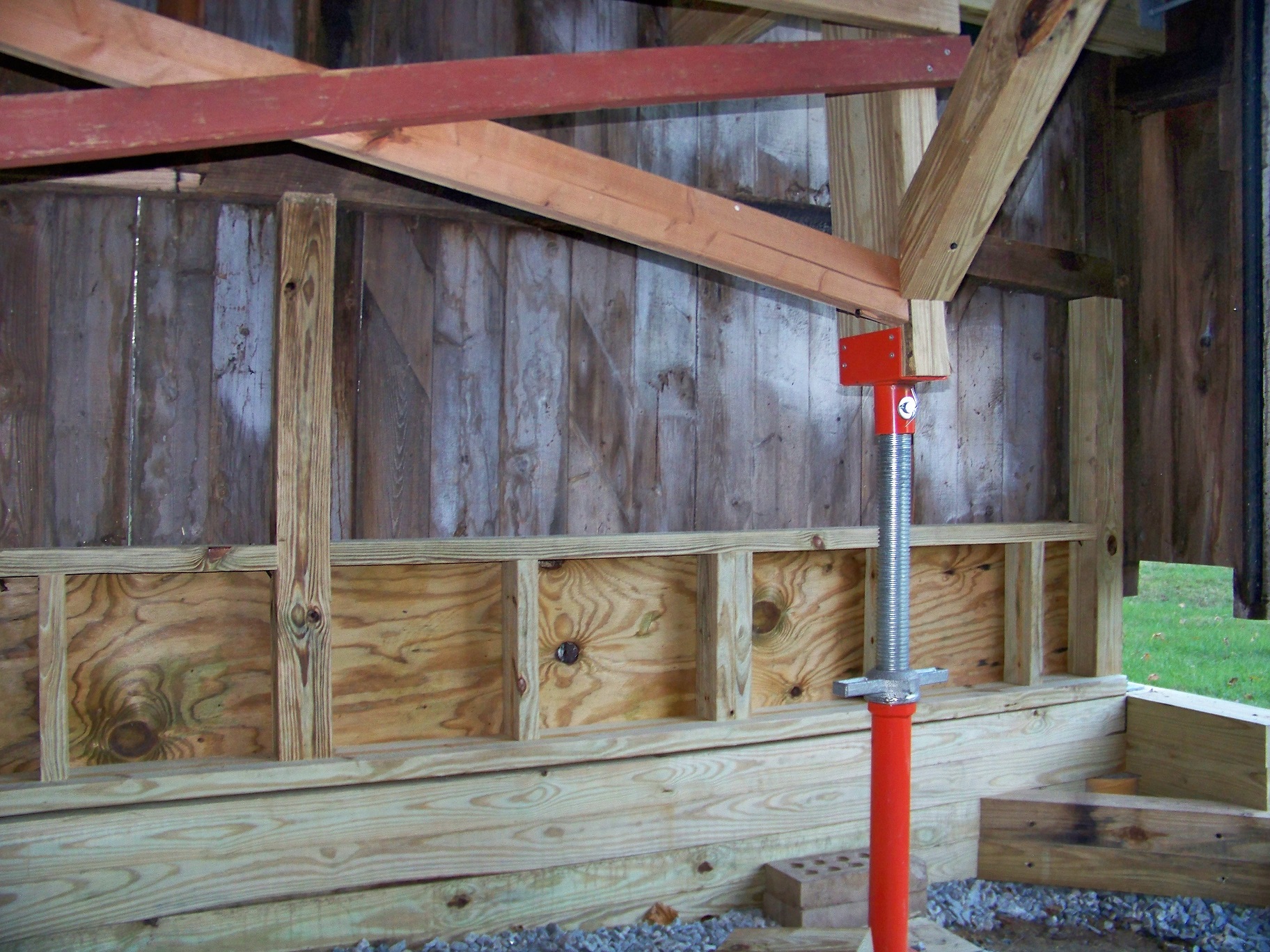

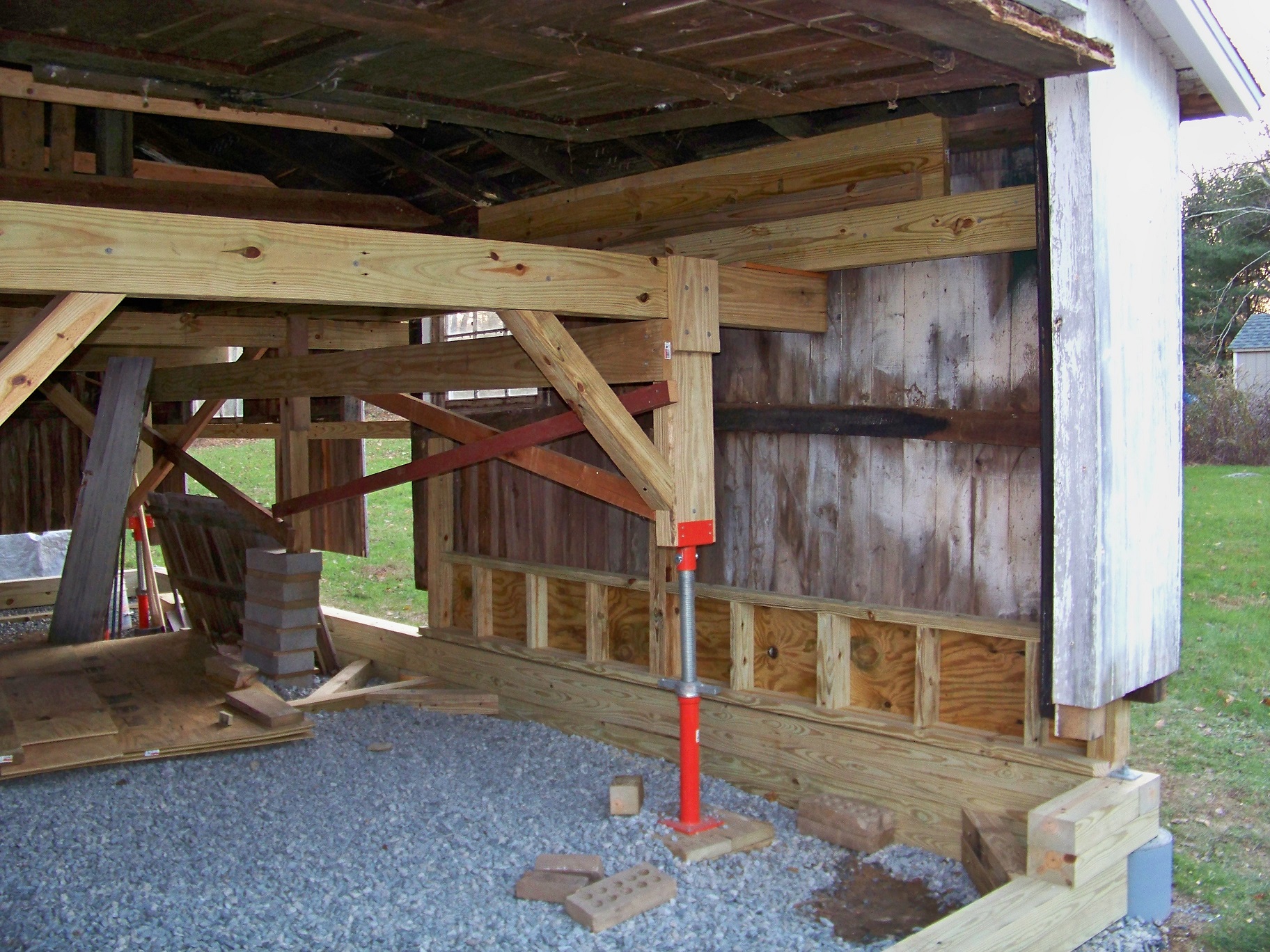

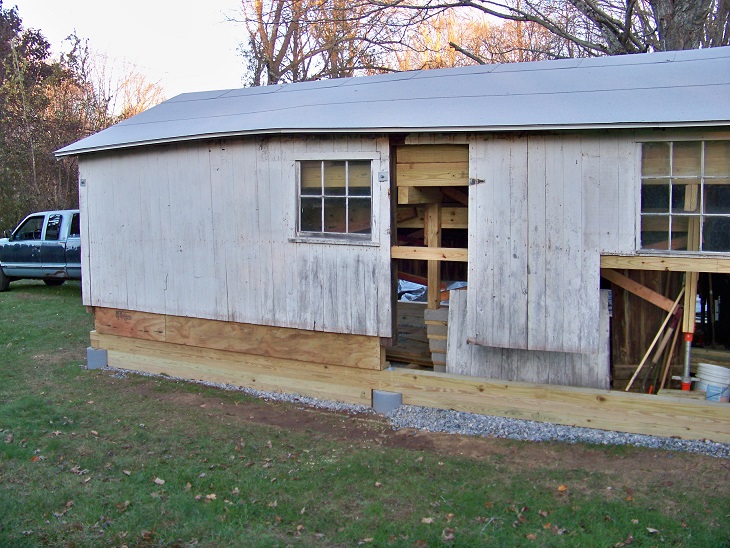

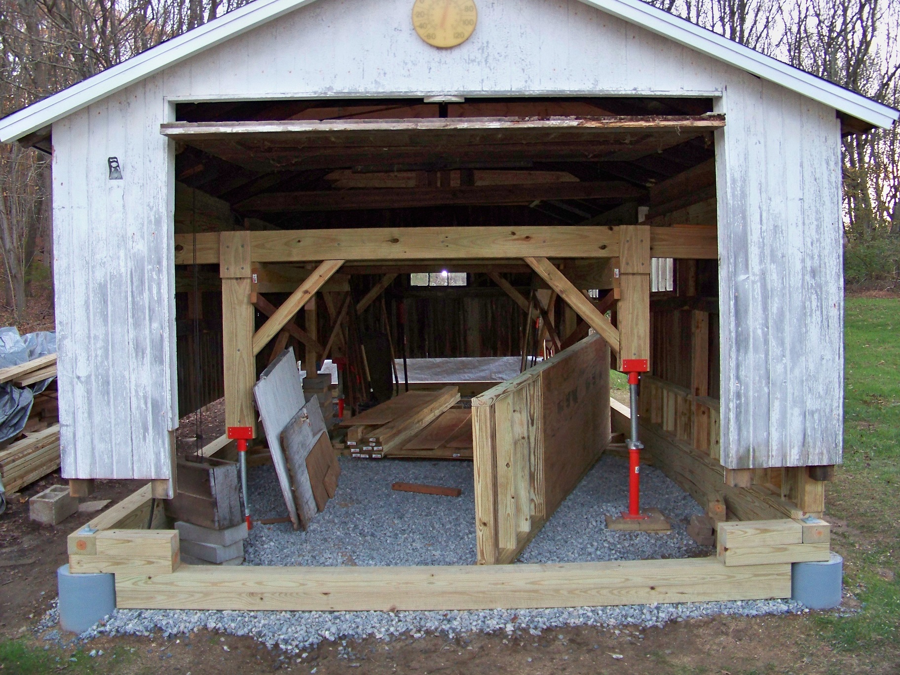

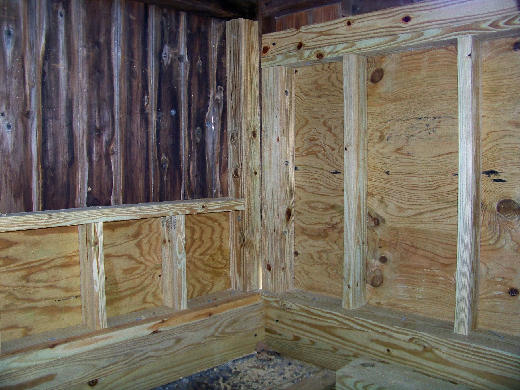

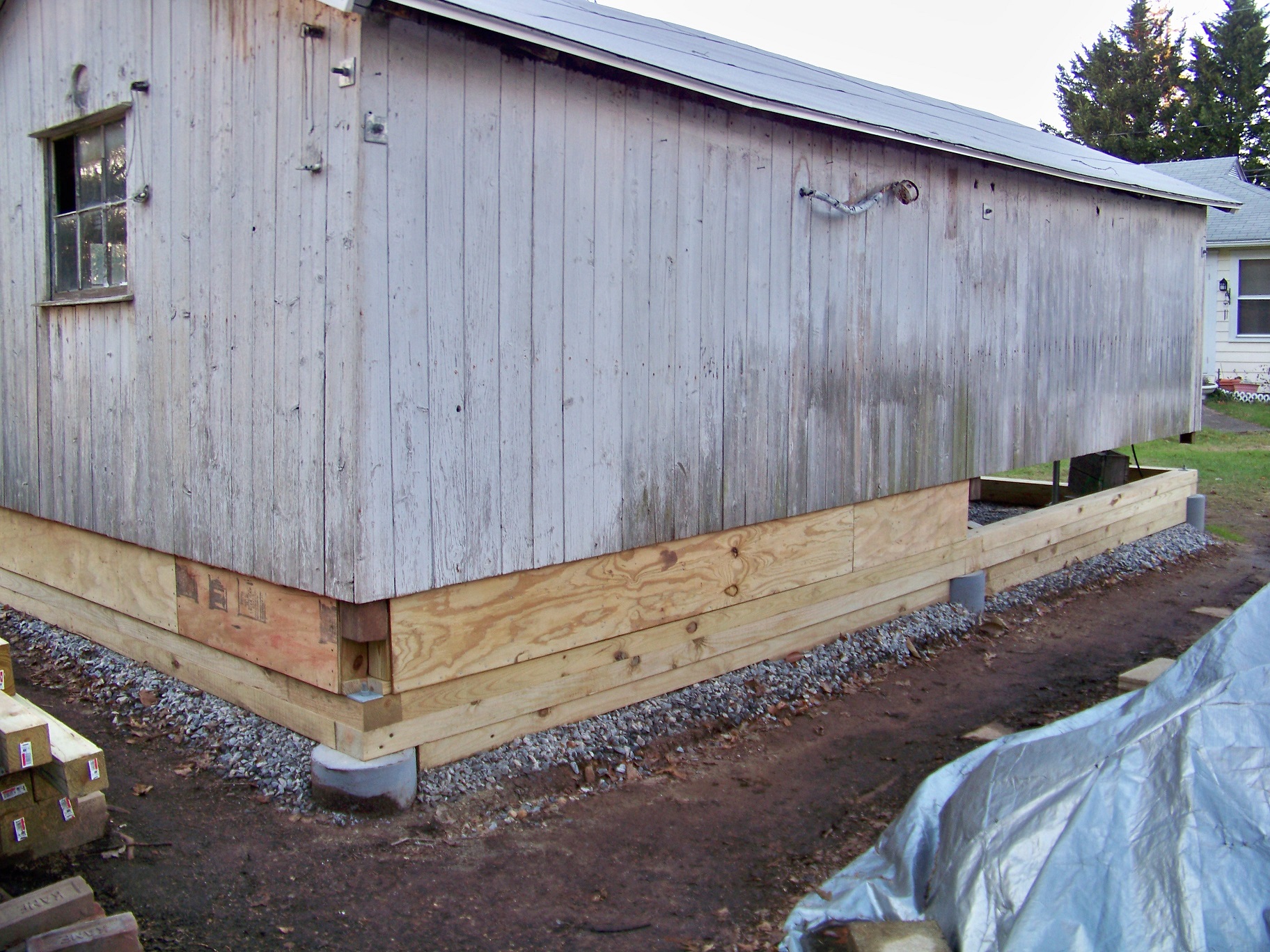

Progress Pics:
The front right wall is now attached to the foundation and existing posts. Used 5" LedgerLoks in new 4x4s counterbored 1.5” deep to give proper 3.5” grip into existing posts. Sill attached with 3-5/8" LedgerLoks every 16”.
Figured it would be easier to make a half wall for the right rear since I have to cover the openings. I placed the 2x6 sill on the foundation and marked the locations for each post and stud. Clamped 12’ 2x4 to underside of mid-wall beam. Rough cut wall studs. Held each stud in its intended placement and marked finish cut length. Cut length about 1/16 shorter to make sure I can actually get the wall in after is assembled (hopefully).
When assembling the wall I put 1 screw in top and bottom to keep it in place - then nailed everything together using two 16D 3.5" HDG nails per end.
I pulled the wall into the shed as I wasn’t sure I’d be able to lift it after attaching plywood. Didn’t have time to finish attaching plywood as I was rapidly losing daylight.

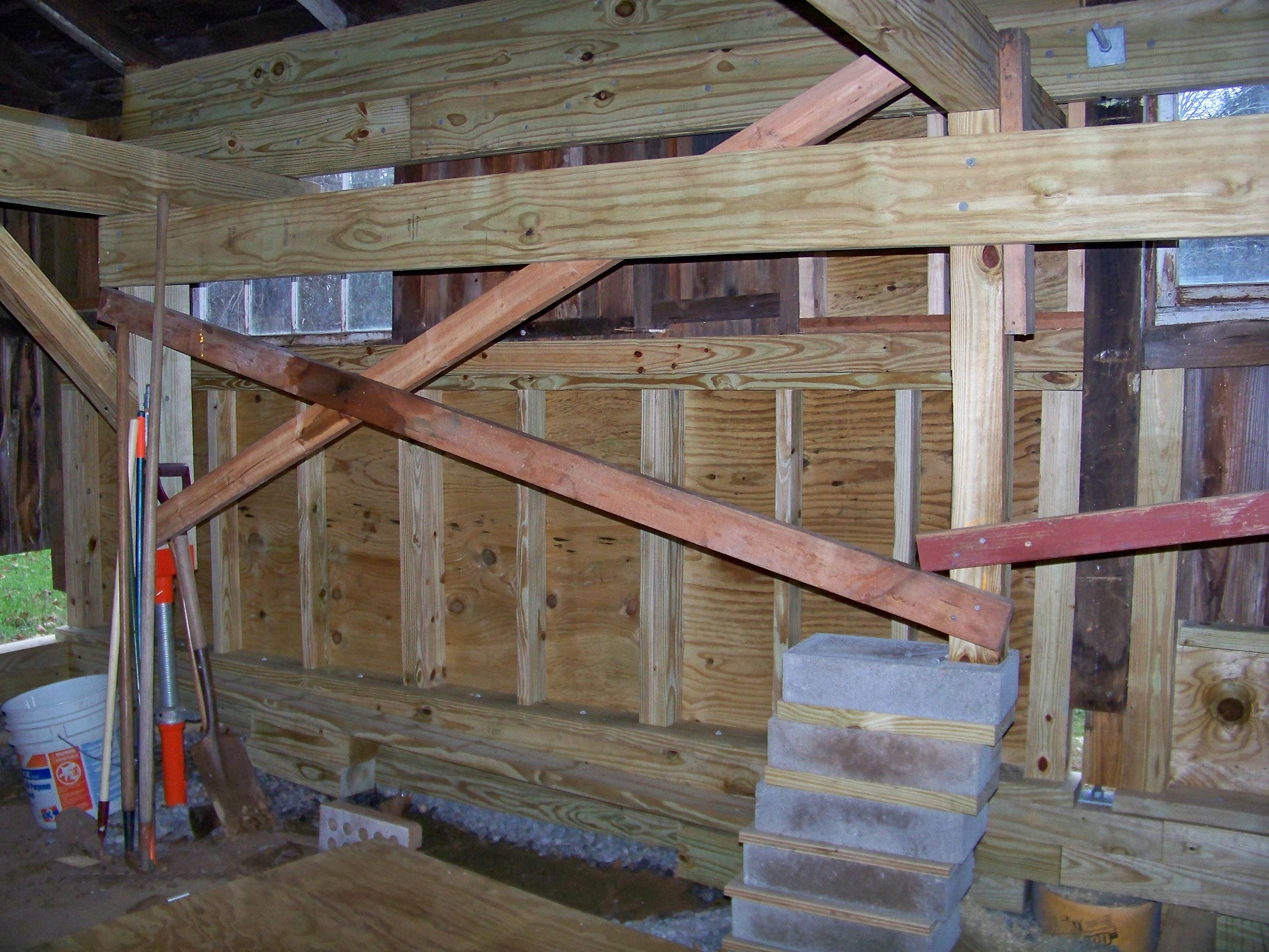

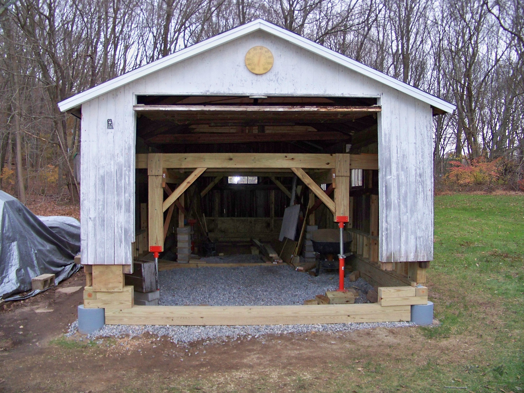

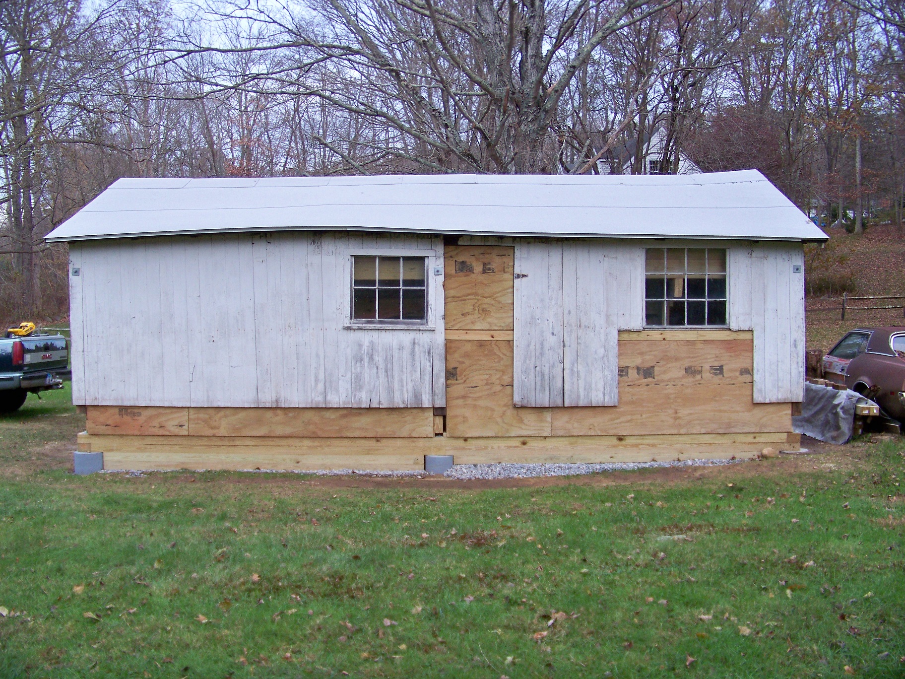

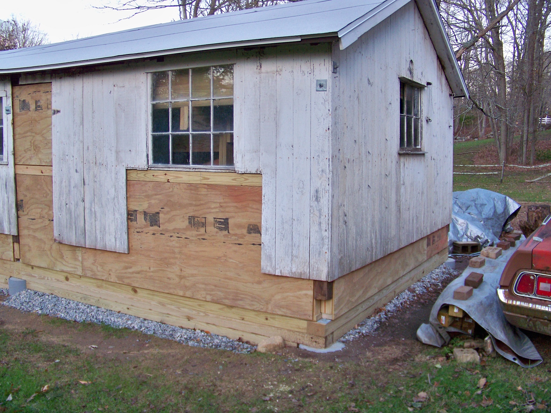

Progress Pics:
Half wall is in and bolted into place. Slid it on a simple 12' 2x6 ramp. Fit perfectly without modification. Also walled off the upper man door opening. Kinda hard to get good pics inside with the lifting frame in there. Lucked out on the weather = 50° and rain held off till almost sunset. Have to watch the weather closely as I don't think my new Dewalt miter saw is water proof.

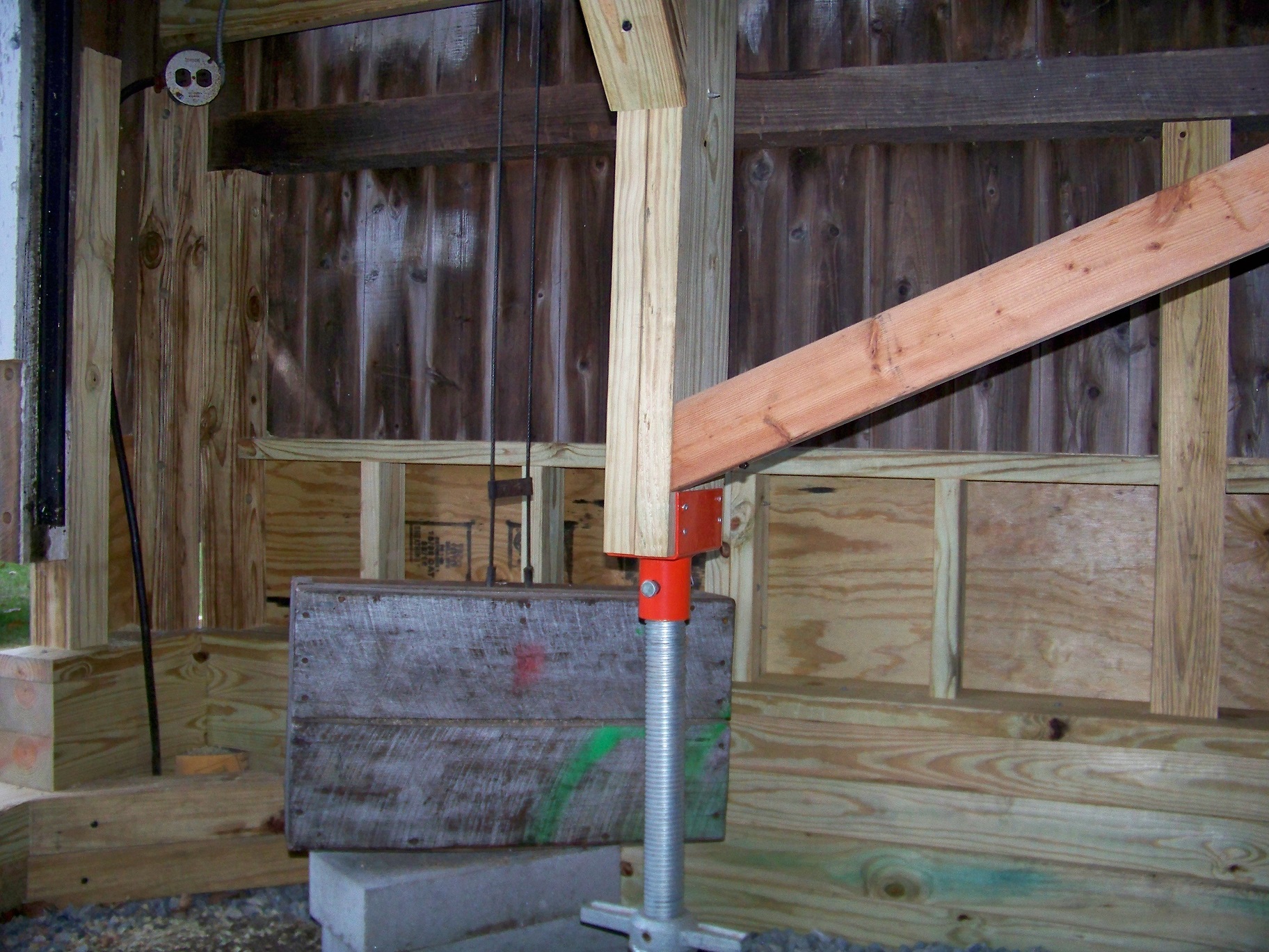

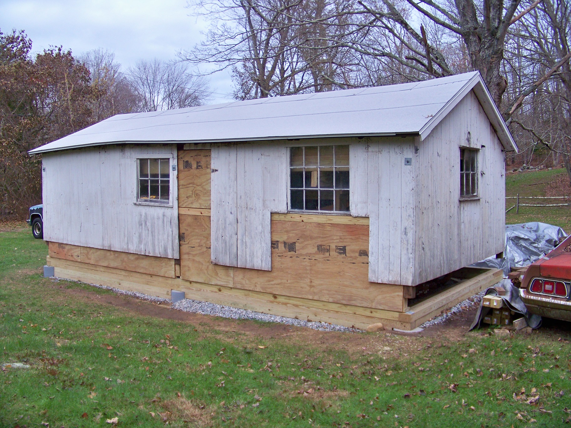

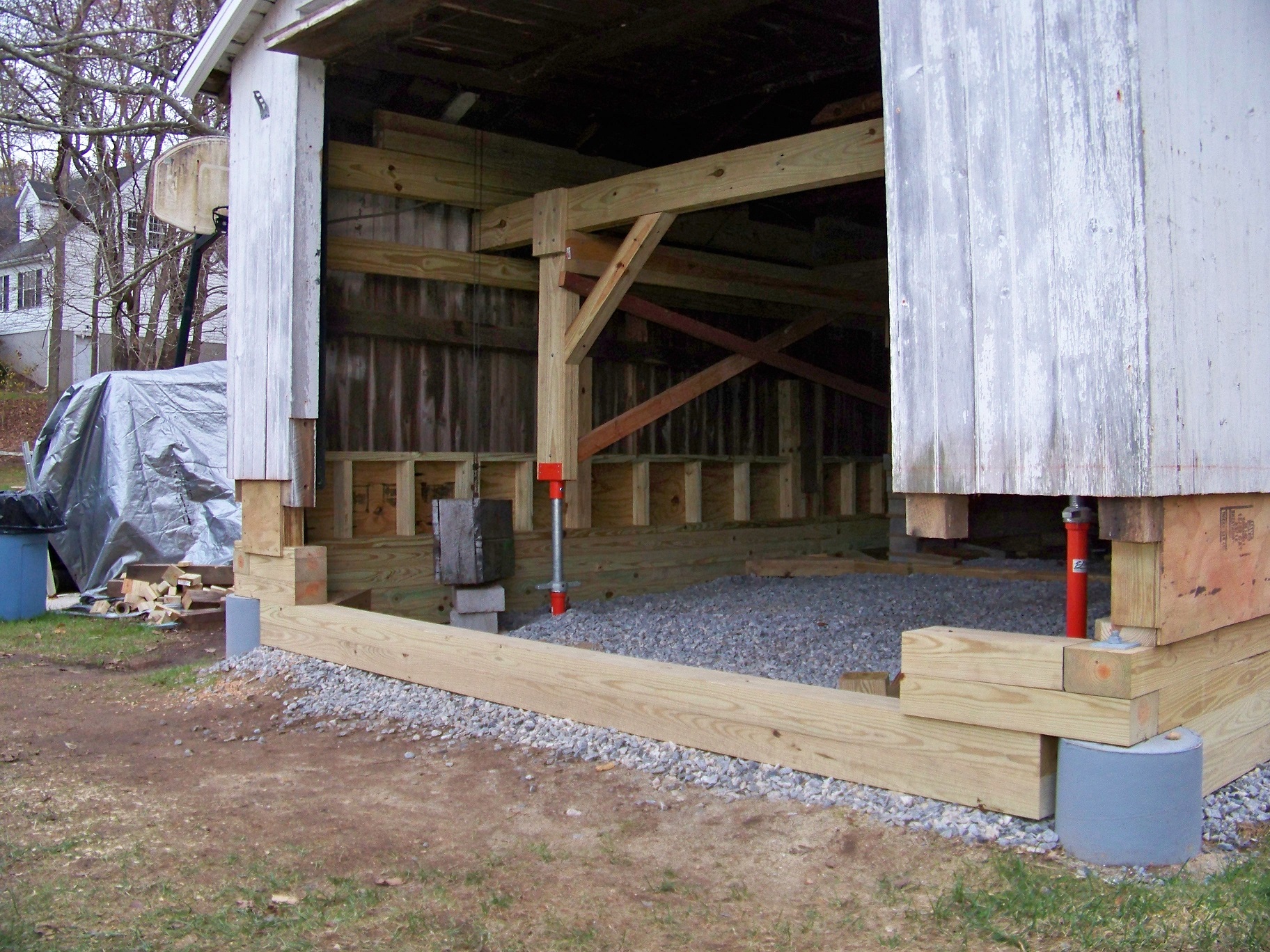

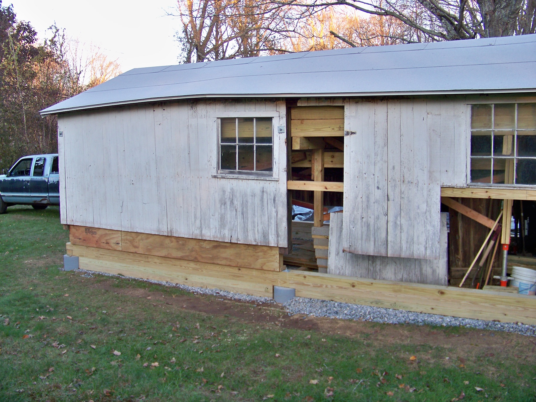

Progress Pics:
Had to do some sawzall massaging to get the rear wall in. Good thing I didn't save the rear wall till last as there's no way I could have gotten it in there without the remaining side gap. It isn't fully fastened yet as I ran out of daylight.

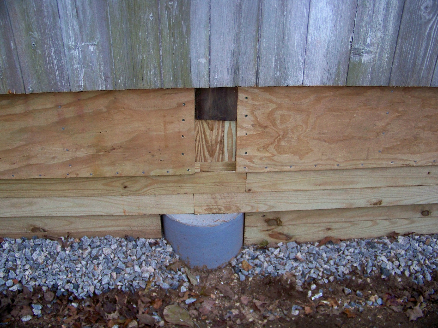

Thinking towards the future with respect to best way to finish the 19 inch section between the existing siding and top of cement piers. I'm carrying below quote over from my other thread about how to work with PVC. PVC is still an option, just not likely worth the hassle.
Pvc expands and contracts way too much if you have any real lengths of the stuff fastened at both ends. My recommendation would be treated 1x or plywood and cover with something called ground breaker. It's a textured fiberglass sheet that comes in 1ft and 2ft high 50 or 100ft long. I used it on my last house to protect the pink board I put against my house foundation. Held up great to 10+ years of string trimming. Fades a little but other than that no complaints. That's what I'd use. They have a good selection of accessories for it at menards but you said those aren't near you. Maybe home depot?
http://www.homedepot.com/p/12-in-x-...ic-Foundation-Protection-Kit-GB-1-K/205735697
If I go above route I still need to do some kind of trim work to the bottom of existing siding (Water table trim, drip cap, J-channel ?).
I've also considered T-111 mounted horizontally. Mounting it vertically would look like turd IMO.
If it makes a difference, I can still slide Tyvek or tar paper in between existing siding and new PT plywood.

A z roof trim to go behind the existing siding then over the new siding would keep water from getting behind the new siding. But if you do that leave a 1/8" gap or more below the existing siding to the metal to let the bottom of the existing siding dry out.
T-11 or T-111 horizontally would not last long IMHO. The grooves need to be vertical. Hardy board would fit there nicely.

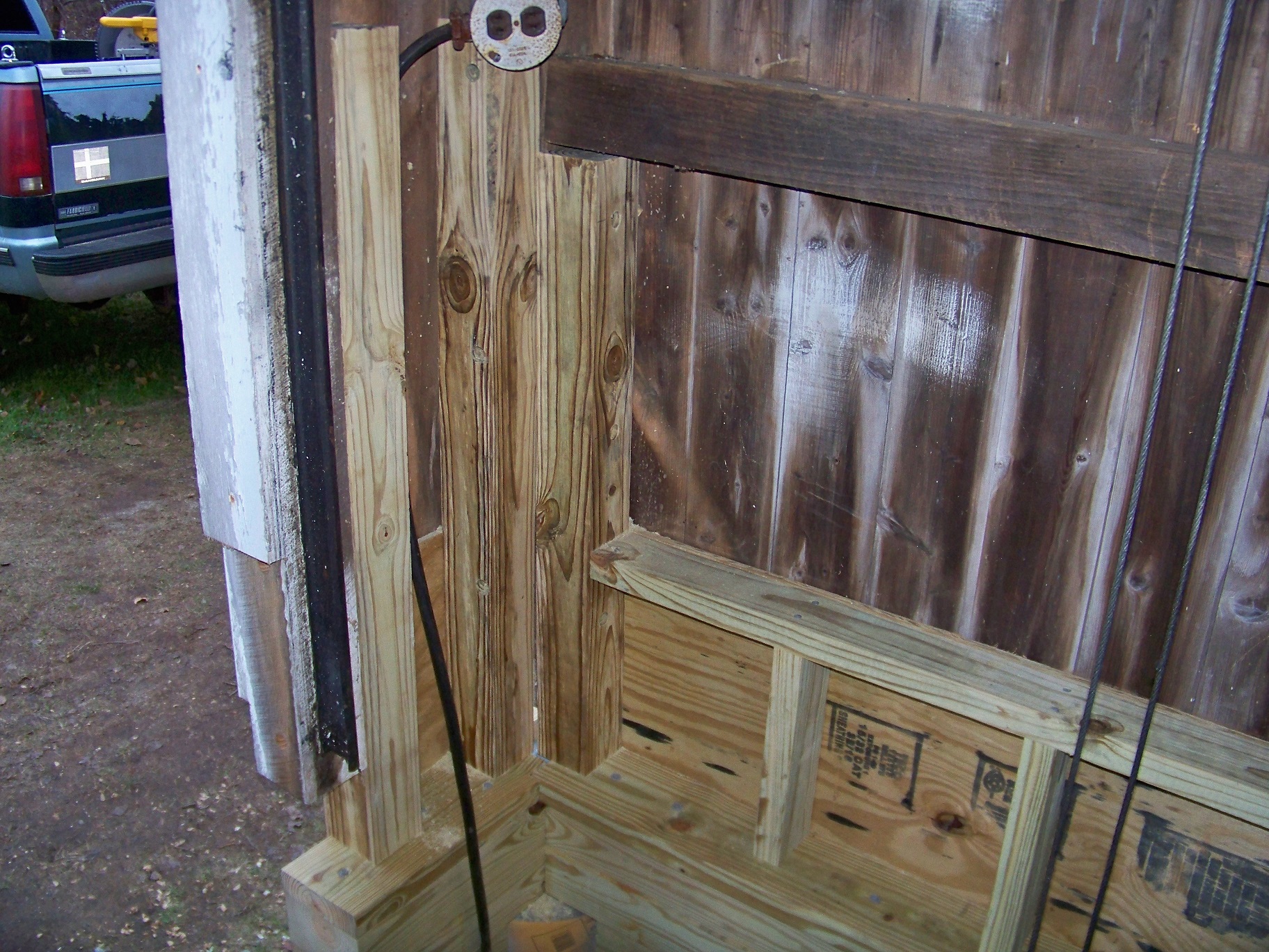

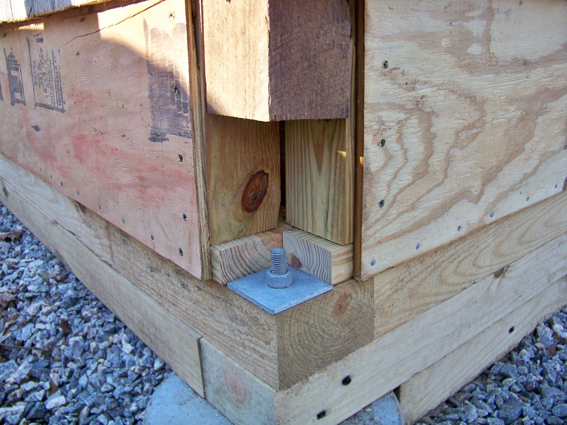

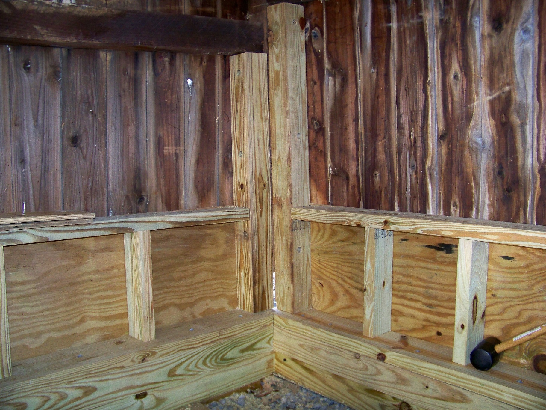

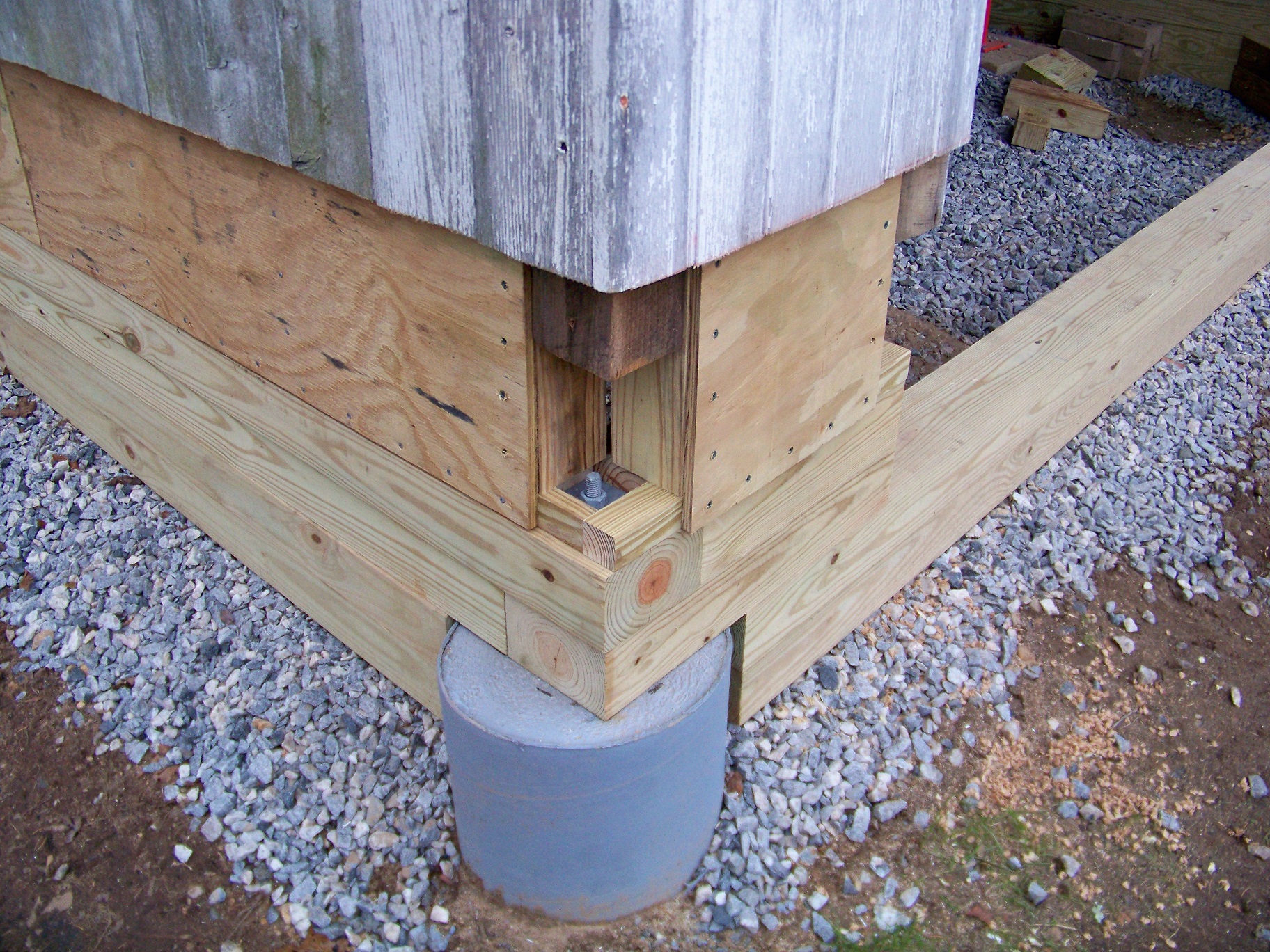

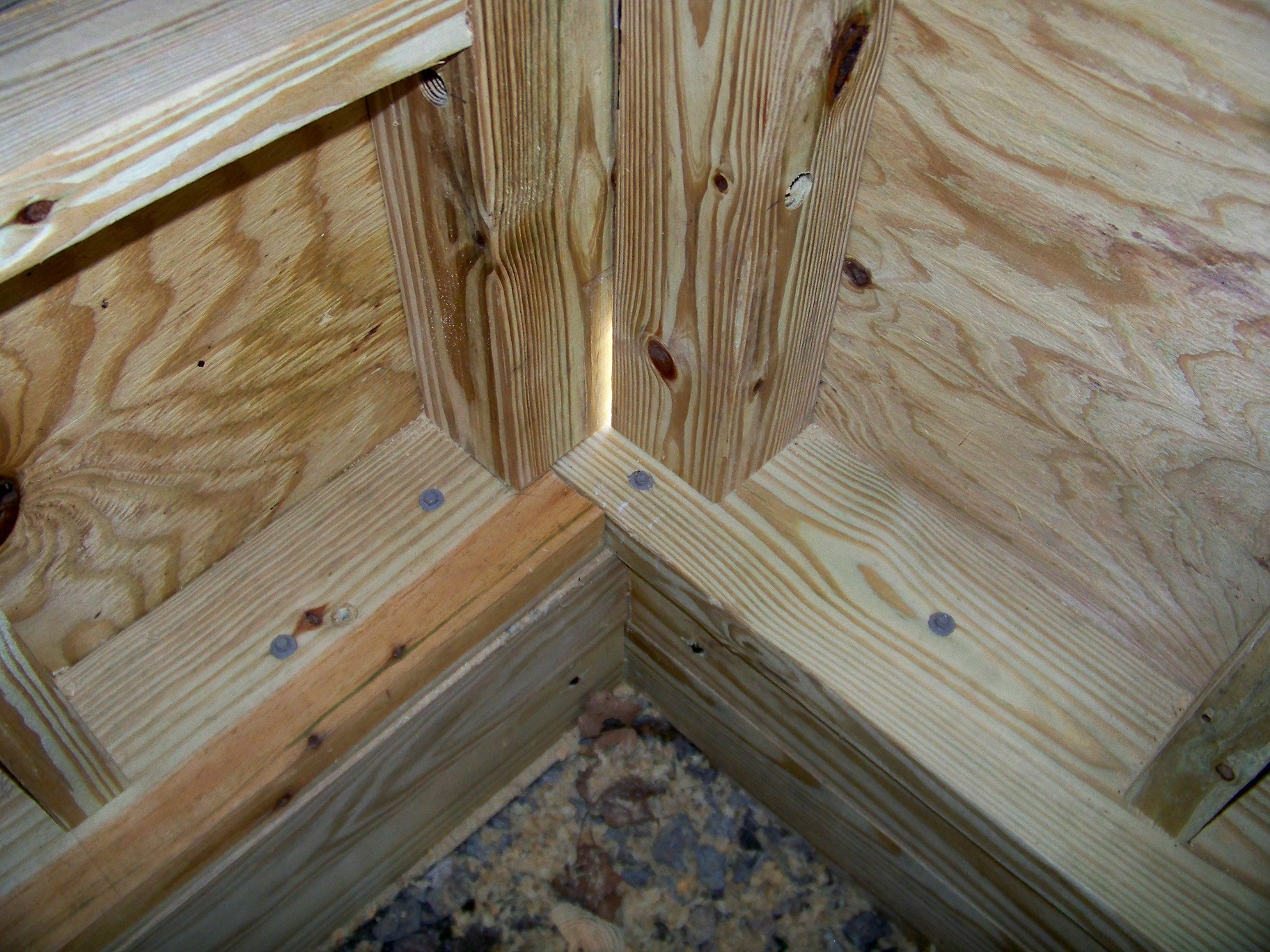

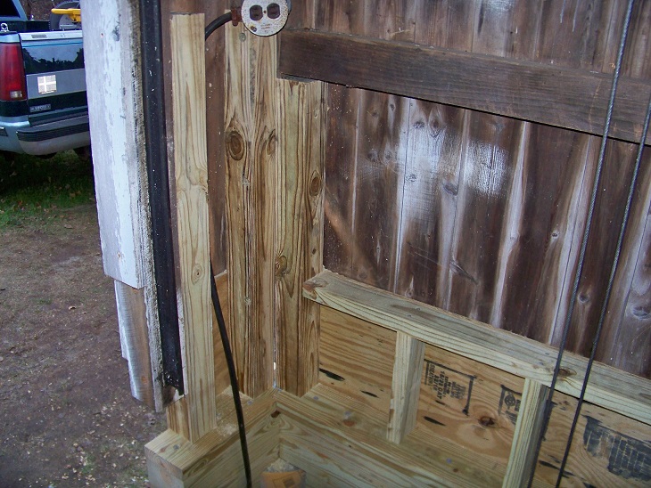

The rear and left rear walls are now attached. 2x6 sills are notched in the corners to fit together. 4x4 blocks will fill the space between threaded rod and posts.
Right Rear Corner
Left Rear Corner

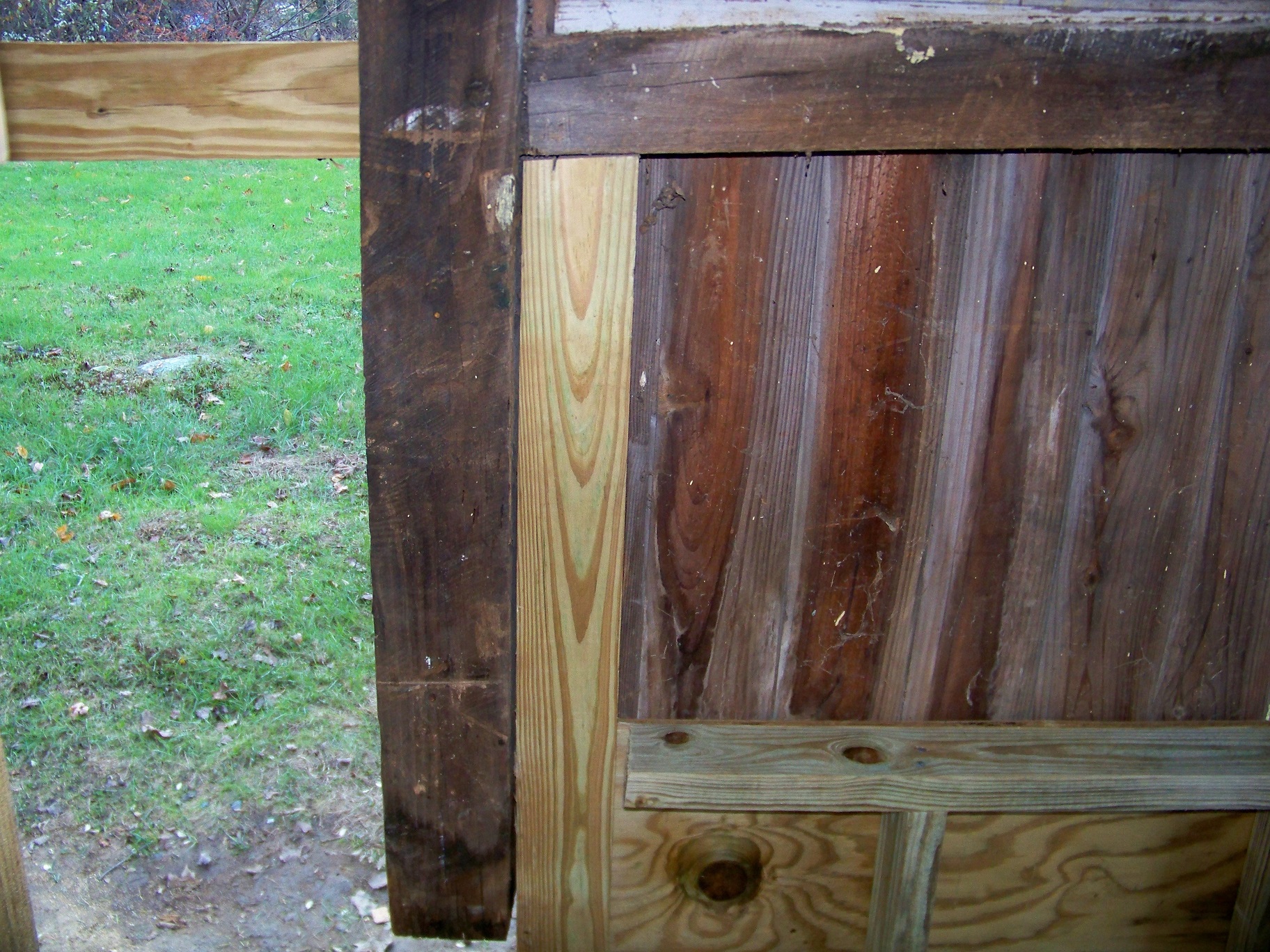

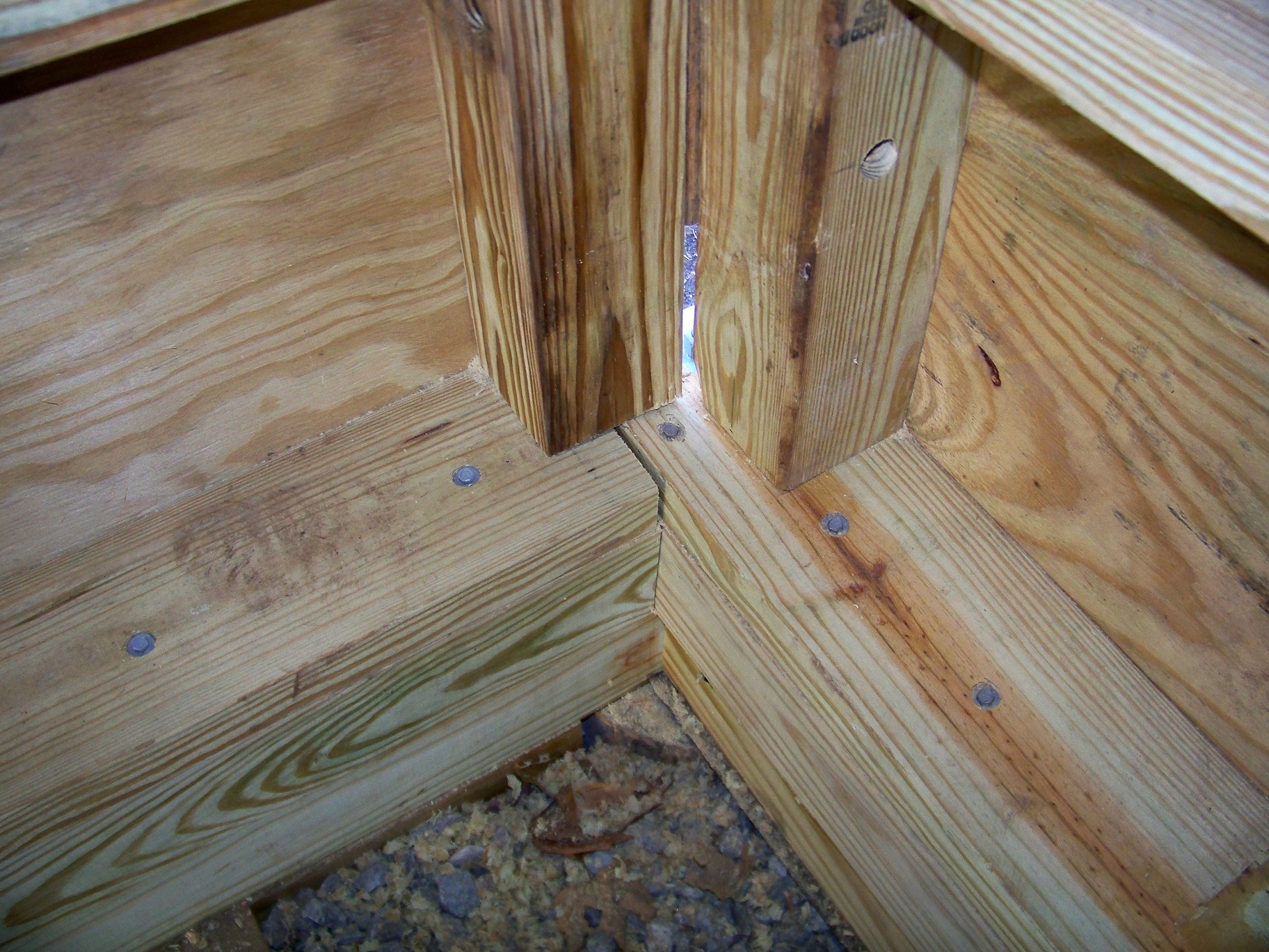

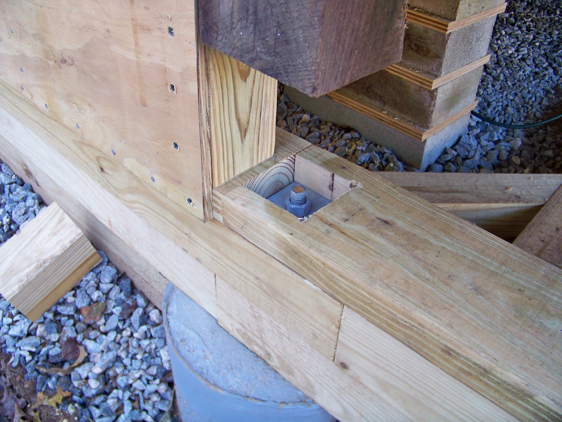

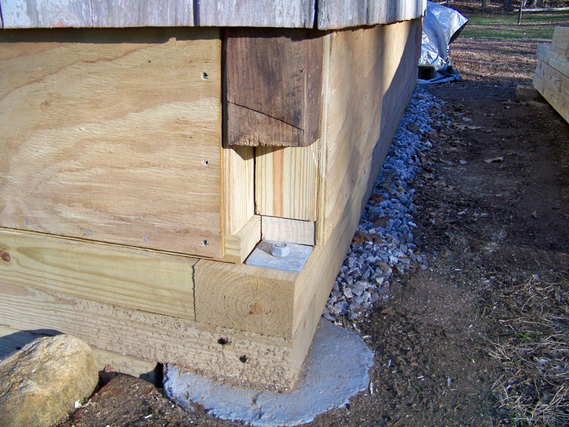

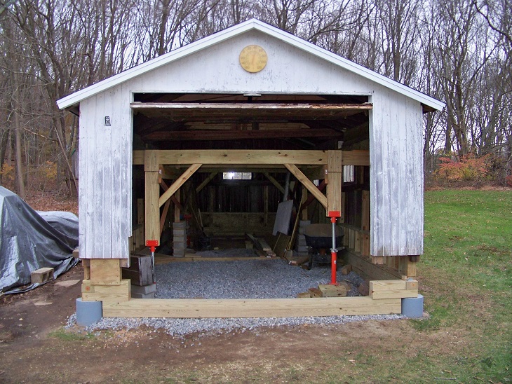

The left center and front threaded rods not being as close to the edge gave me the option of notching the 2x6 sills around the bearing plates. To give me a fighting chance of installing the notched wall I made it in 2 pieces - an 8ft section and 4ft section. I had previously cut the threaded rod down to 1.5 inch.
A piece of 4x4 and 2x4 fit perfectly under the post. Each is sistered to their respective posts and a 10 inch Timberlok driven through to whole thing. Had to use a socket wrench for the last 2 inches of that one. All post bolts are hit with the socket wrench before moving on. Just like the right hand wall earlier, I had to get out the sawzall and cut the 2x4 so I could angle the post. I'll fill that space later.
Rather than try to even out the sawzall post cuts I scribed the angle on the filler pieces and miter cut them.
Front left corner support is attached. Though my intent was to have the plywood stand proud of the 4x6 base, that just didn't happen in all locations.
Getting real close to being able to remove the lifting frame. Had hoped to get to that stage over this holiday weekend, but apparently my imagination works much faster than my body.
