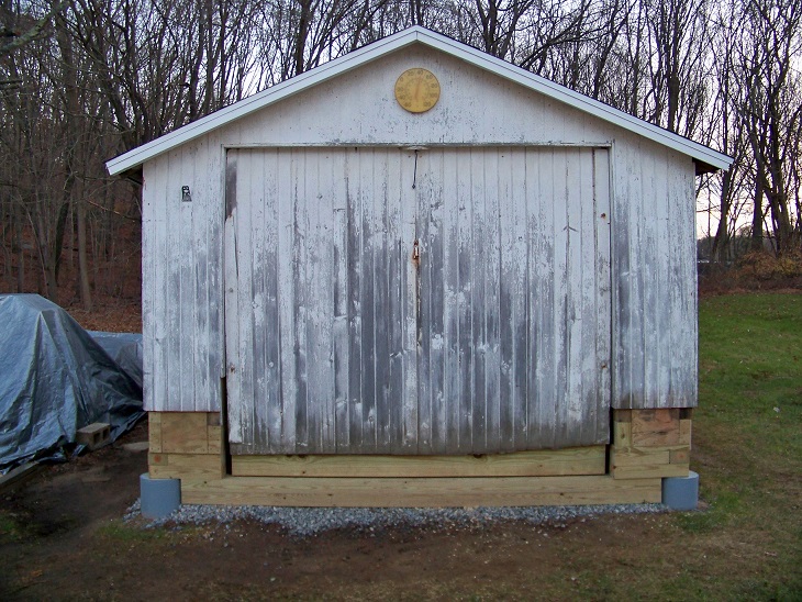

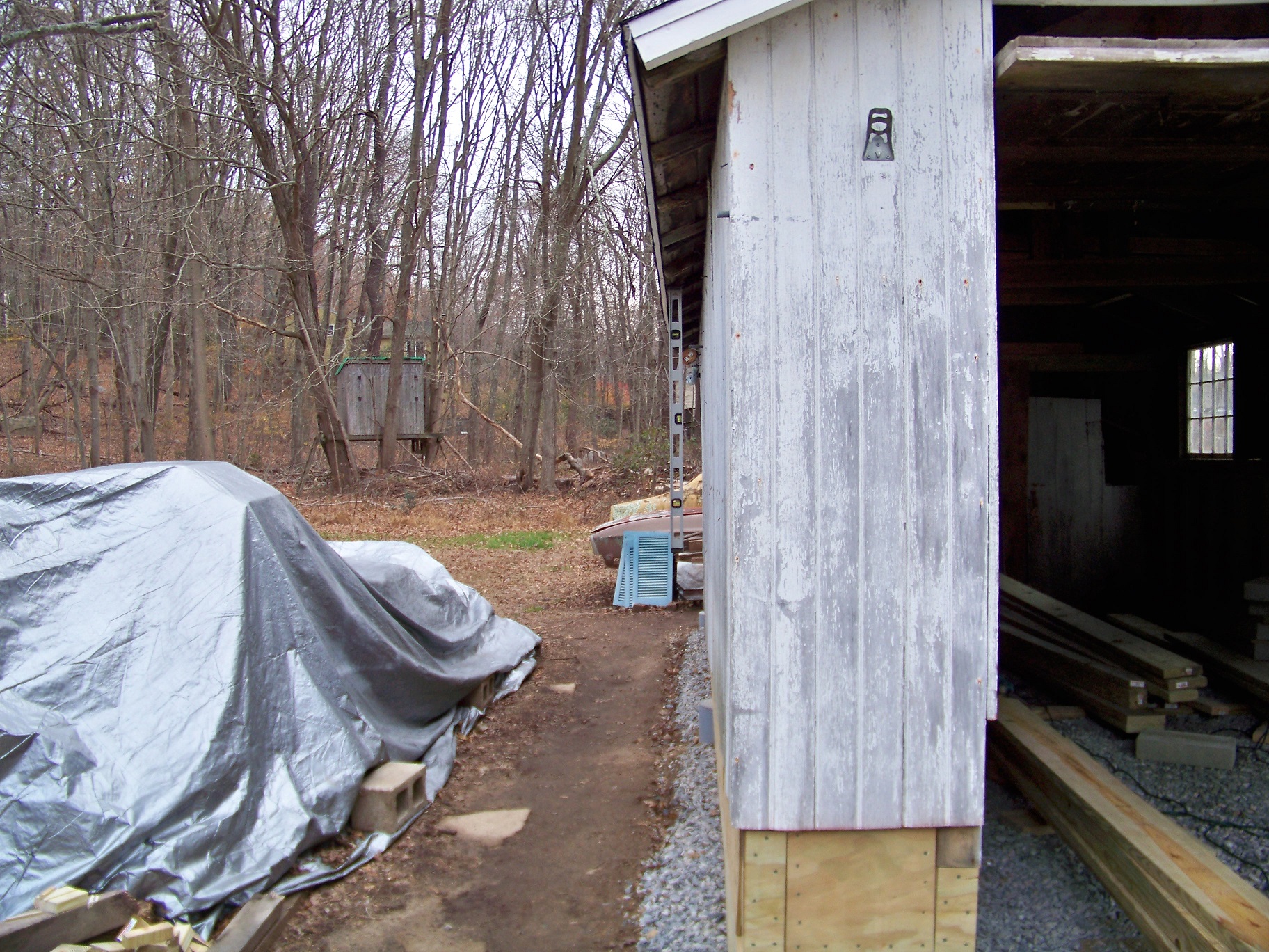

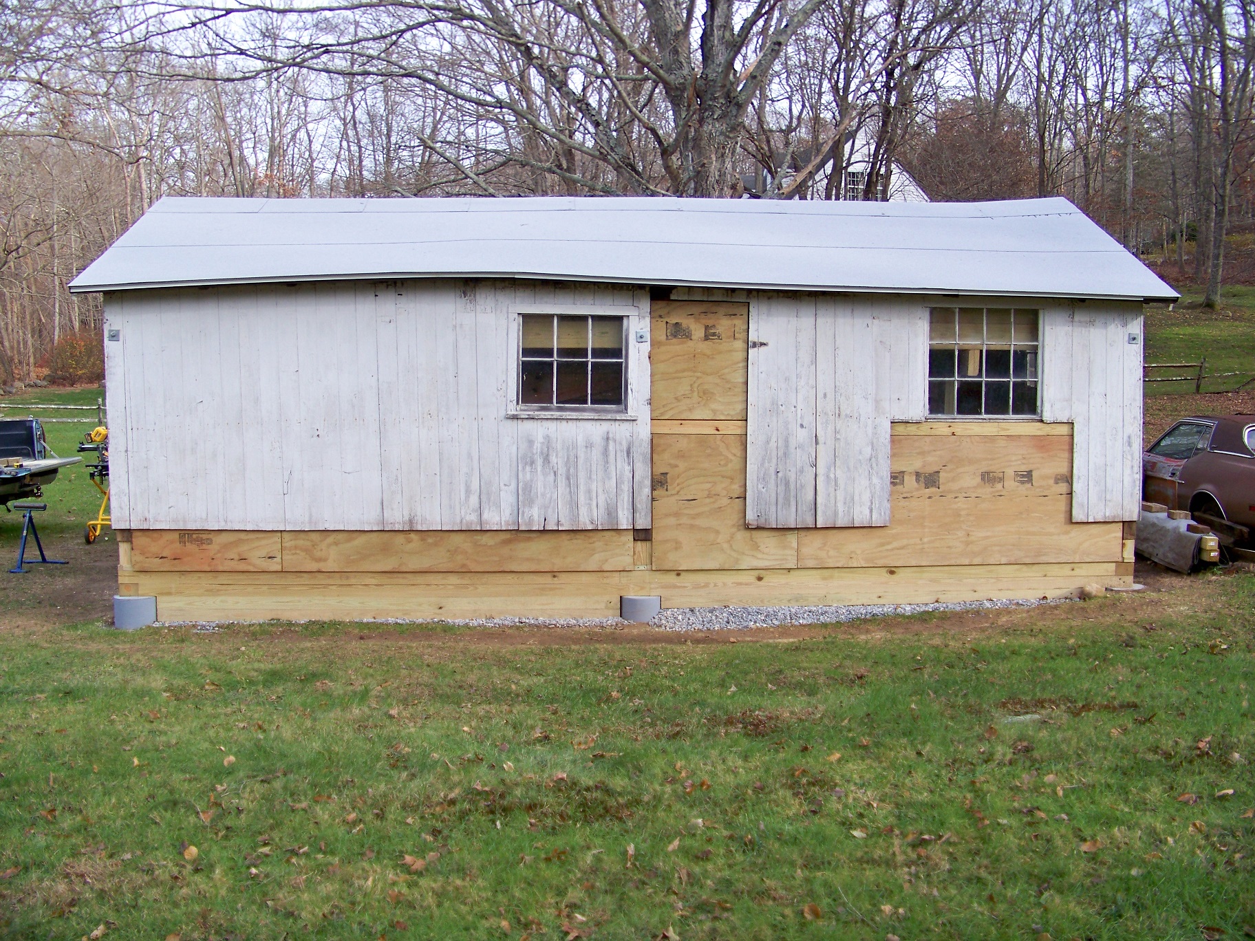

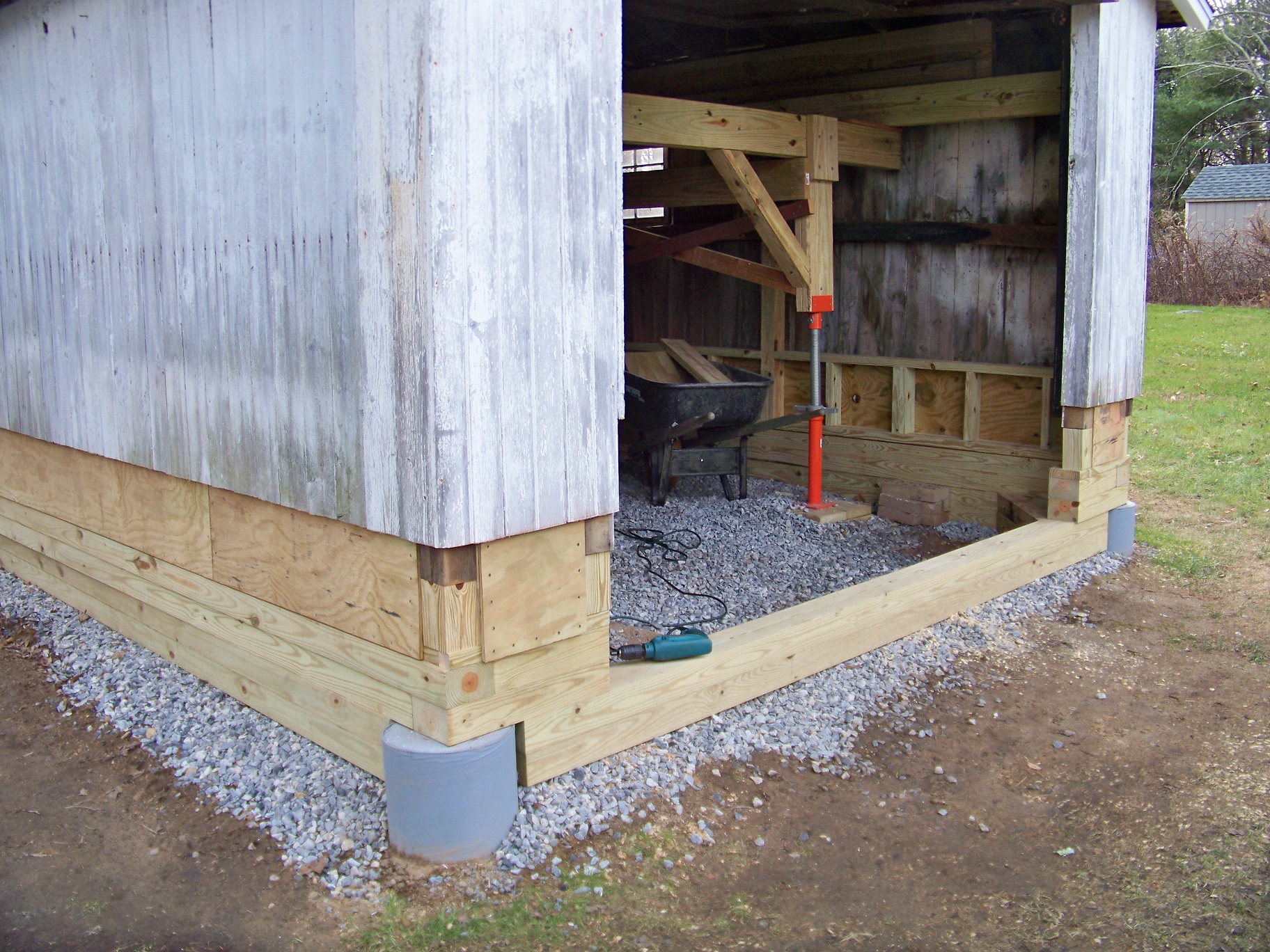

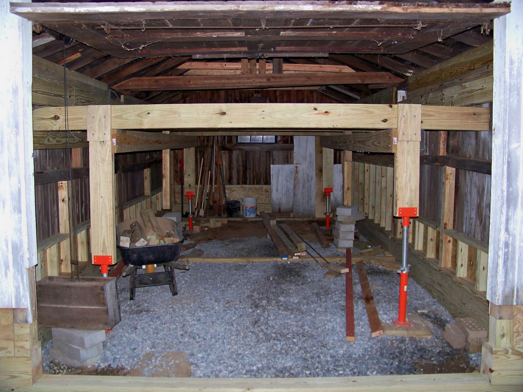

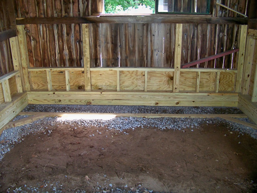

Progress Pics:

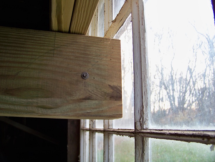

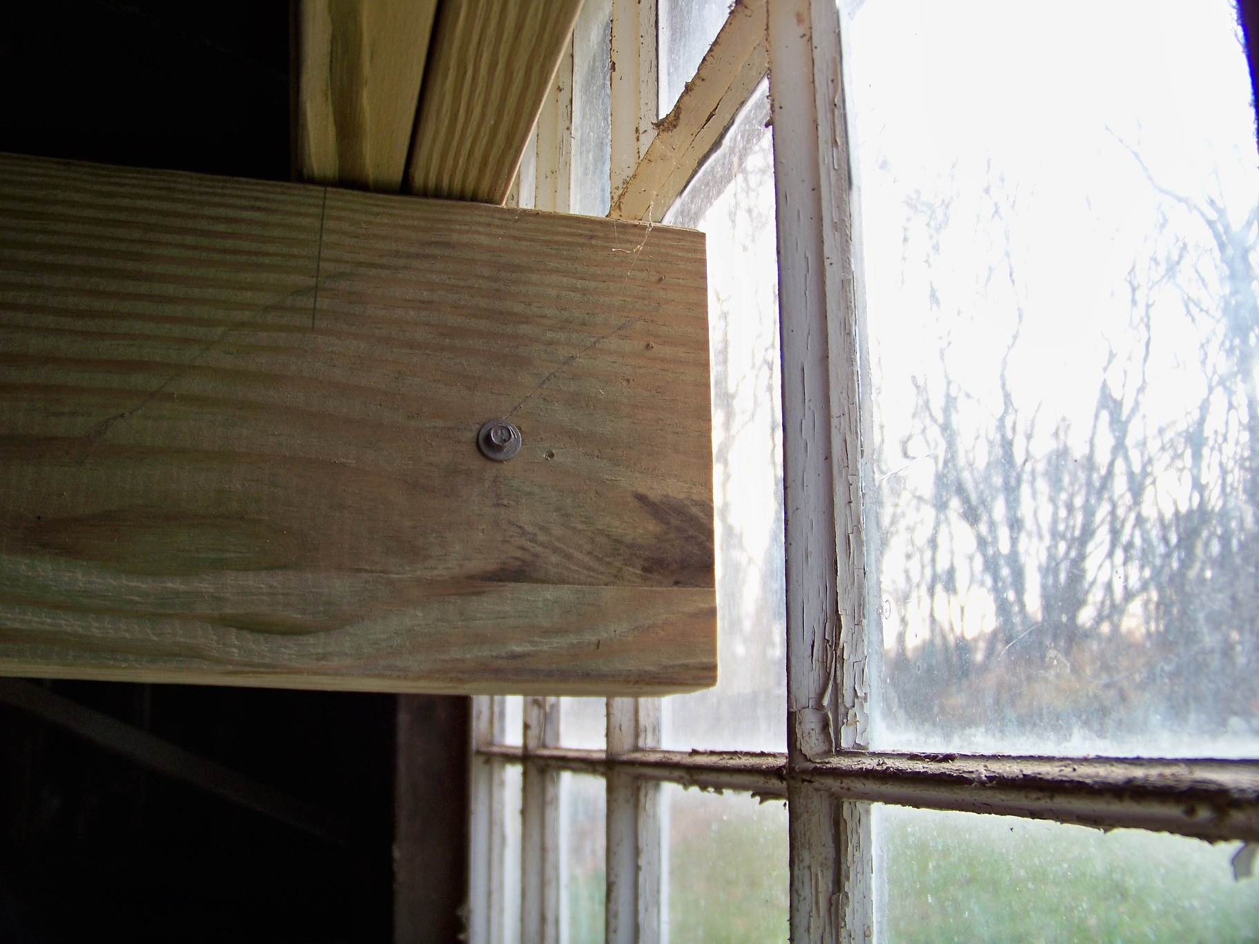

Finished the walls and putting 4x4s under old posts.
I hadn't noticed until today that I lucked out as the lifting frame ended up only 1/4 inch from the window glass after straightening the walls.

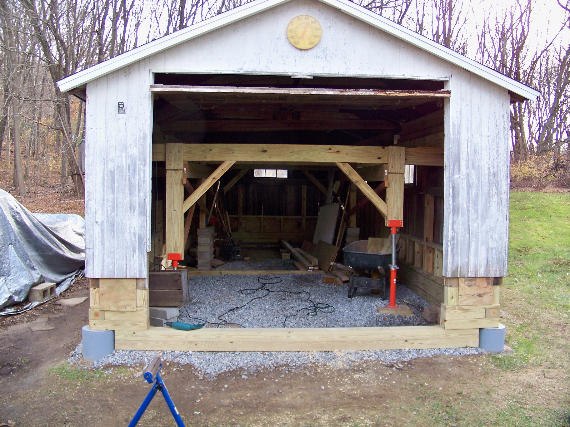

Lowered the lifting frame and the building is now standing on its own. :rocker:
Started disassembling the lifting frame.

All I can say is what I've already said. Awesome work.:bowdown::bowdown:
Regarding the frame almost hitting the window... You planned it that way. :lol_hitti
I'm kind of sad to see you're done, I've enjoyed this thread.

I've hit a major milestone, but "done" isn't a word I can use just yet. Really looking forward to not hitting my head on that dang lifting frame. Now I gotta dig the lifting shores out of the ground so I can use them at my primary residence to hold up the second story sun-porch and rebuild the storage room beneath it. The shed project was practice for the pending sun-porch project. I have more PT wood than I know what to do with which is the result of me constantly changing my mind as to how I wanted to do this.
The purpose of the shed is for long term storage items for me as it's 20 minutes from home.
Remaining Shed projects:
  • Garage Door extension, overall fit adjustments and fix latching mechanism so I can actually lock it.
  • Rodent proof soffits
  • More gravel
  • Floating insulated floor without joists
  • Window repairs
  • Restore/Replace the thermometer
  • Tyvek and siding
  • Considering putting Tyvek and plywood on remaining interior walls
  • I should probably remove that nasty exterior electrical outlet and update the interior ones.
  • Paint Exterior
Then I think I can call it "done".

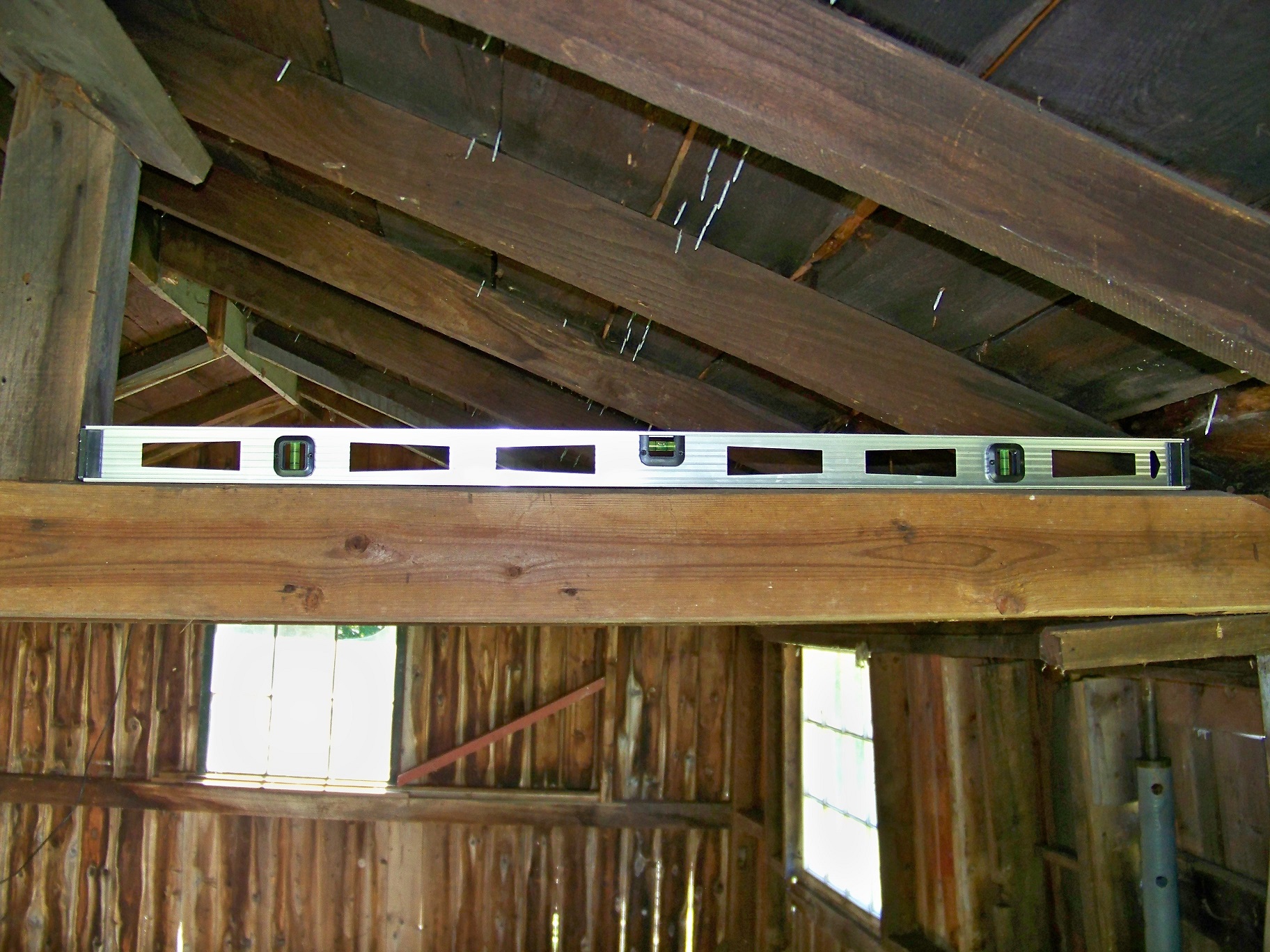

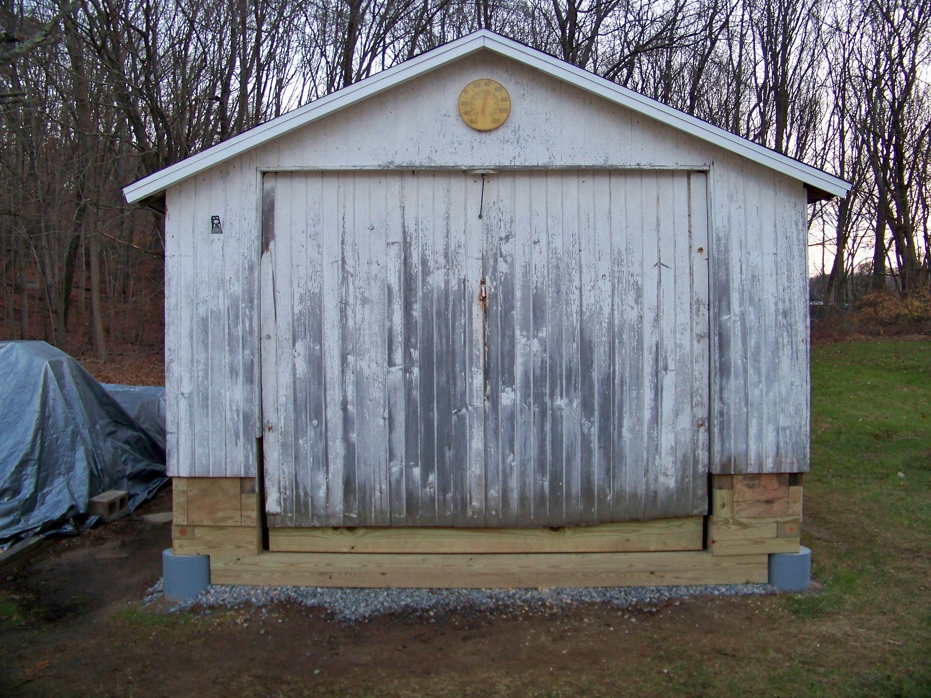

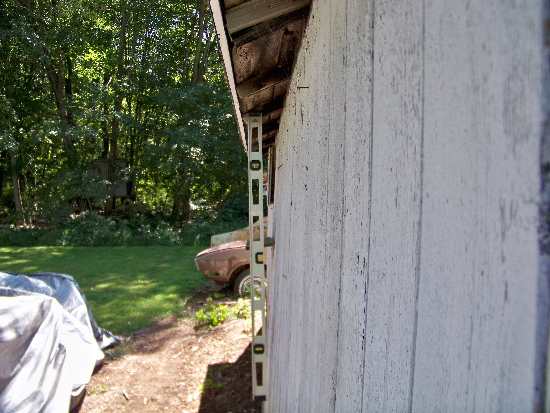

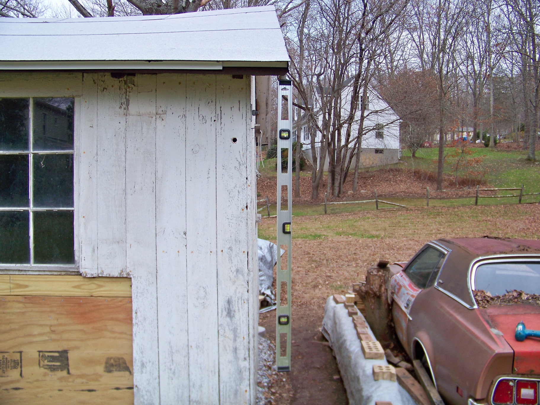

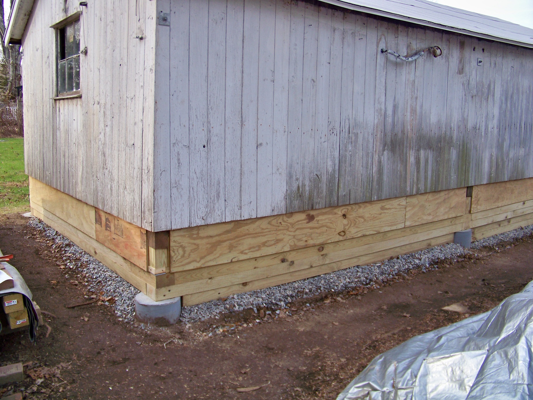

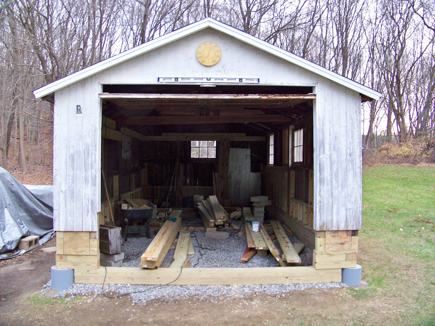

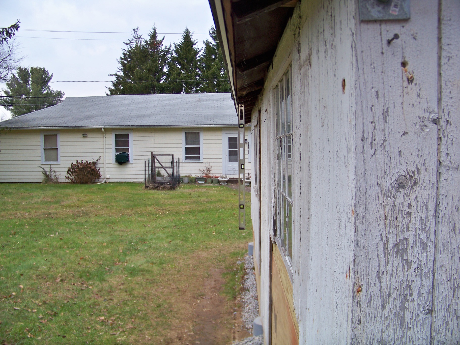

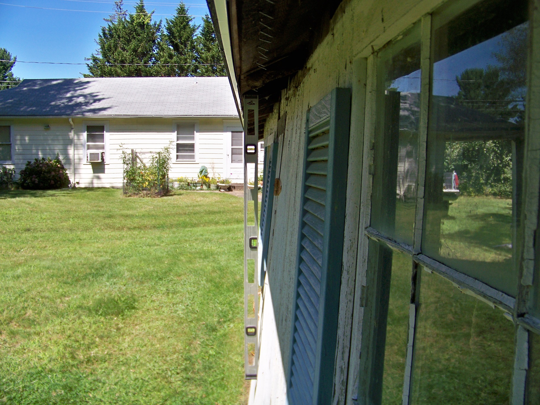

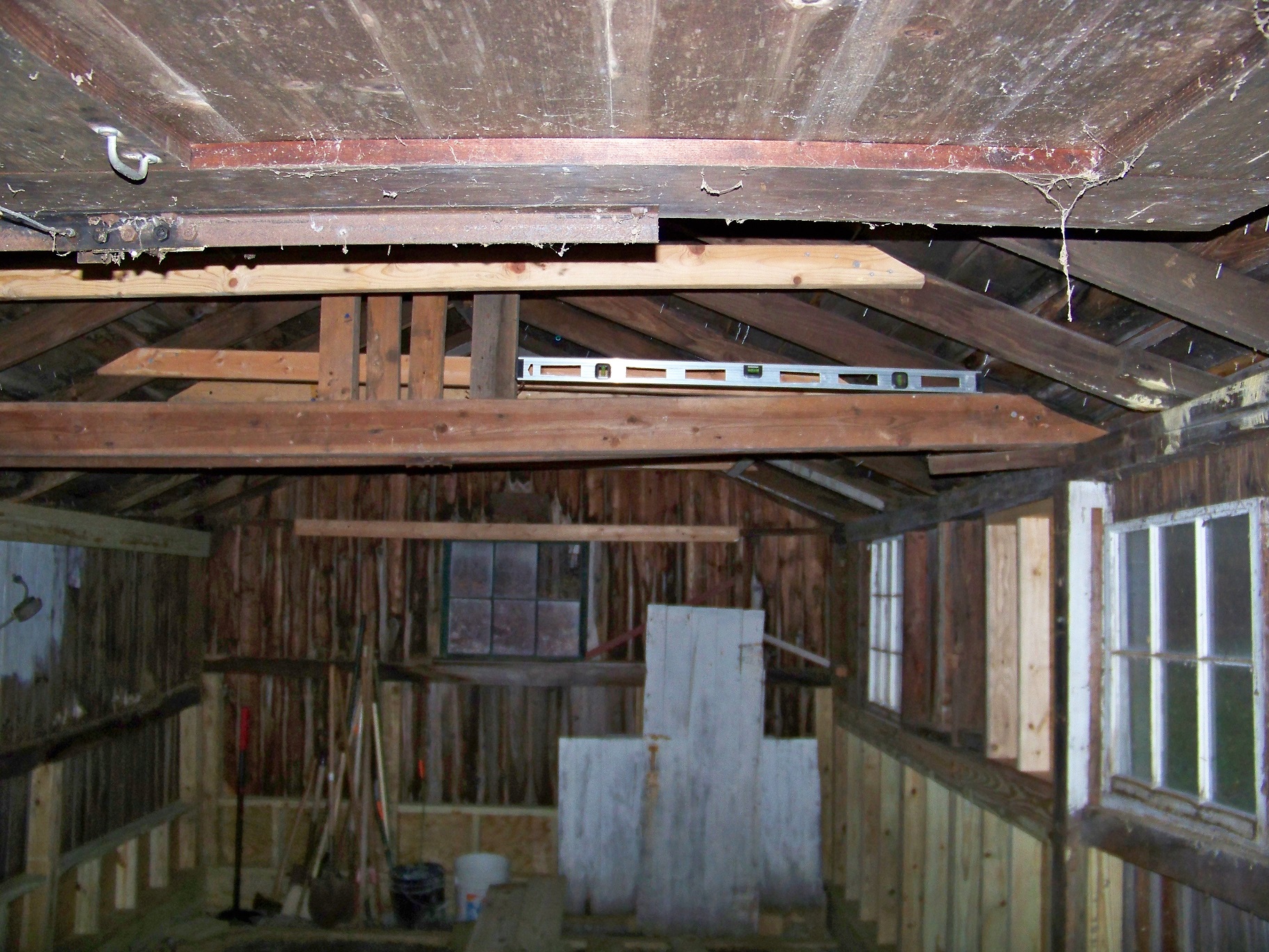

Progress Pics:
Got the lifting frame down and almost all building supports removed. I was swearing at myself all day for using so dang many screws. The hex head ledger lock screws were a breeze to remove, but those dang spax torx drive were a nightmare. Stripped the heads of 10 of them. I thought maybe it was the bit that they provide with the screws, so I took a T20 from the cheapo HF set I got for $10. The HF bit broke instantly - total ****. I quickly realized that I had better leverage when I inserted the screws than I do now that the building is 20 inches taller. I took a break to take some level pics for a before and after comparison.
Still a slight tip forward, but much better than it was.
The level beam that someone installed in a crooked shed is now a crooked beam in a level shed.

It occurs to me that since I can slip the cedar shingles under existing siding, I don’t think I need to use drip cap and Z-flashing.
Also considering cutting that crooked beam out of the center and just adding another collar tie. I'll have to take more pics to show how much of a cluster that beam really is. I'm not sure if there may have been a different beam there originally. More investigation required.

I took a closer look at the crooked center beam and though it's jerry rigged, the reason it's crooked is the right top plate is much higher than the left. Not going to play with that beam anytime soon (unless I hit my head on it after I put the floor in).

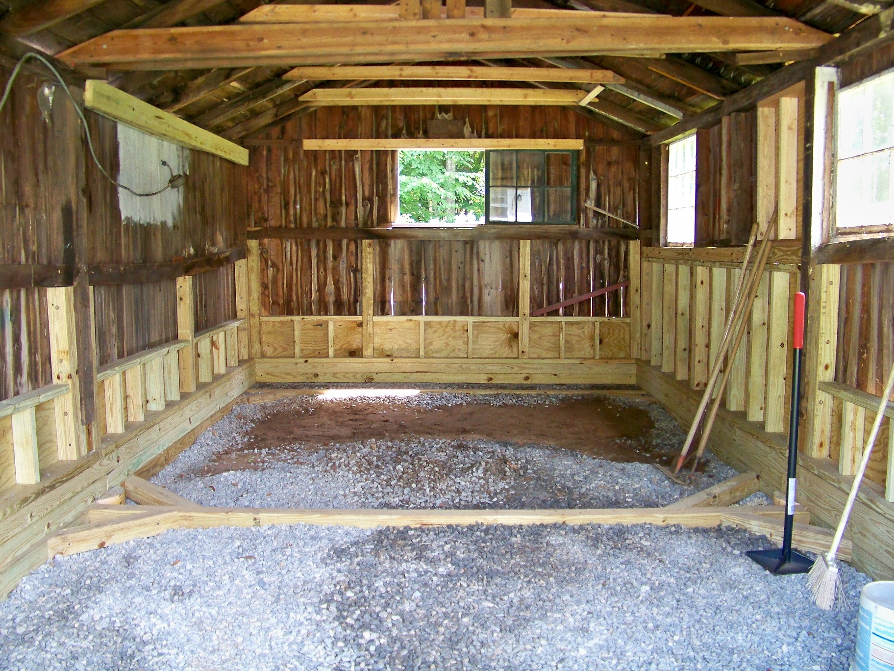

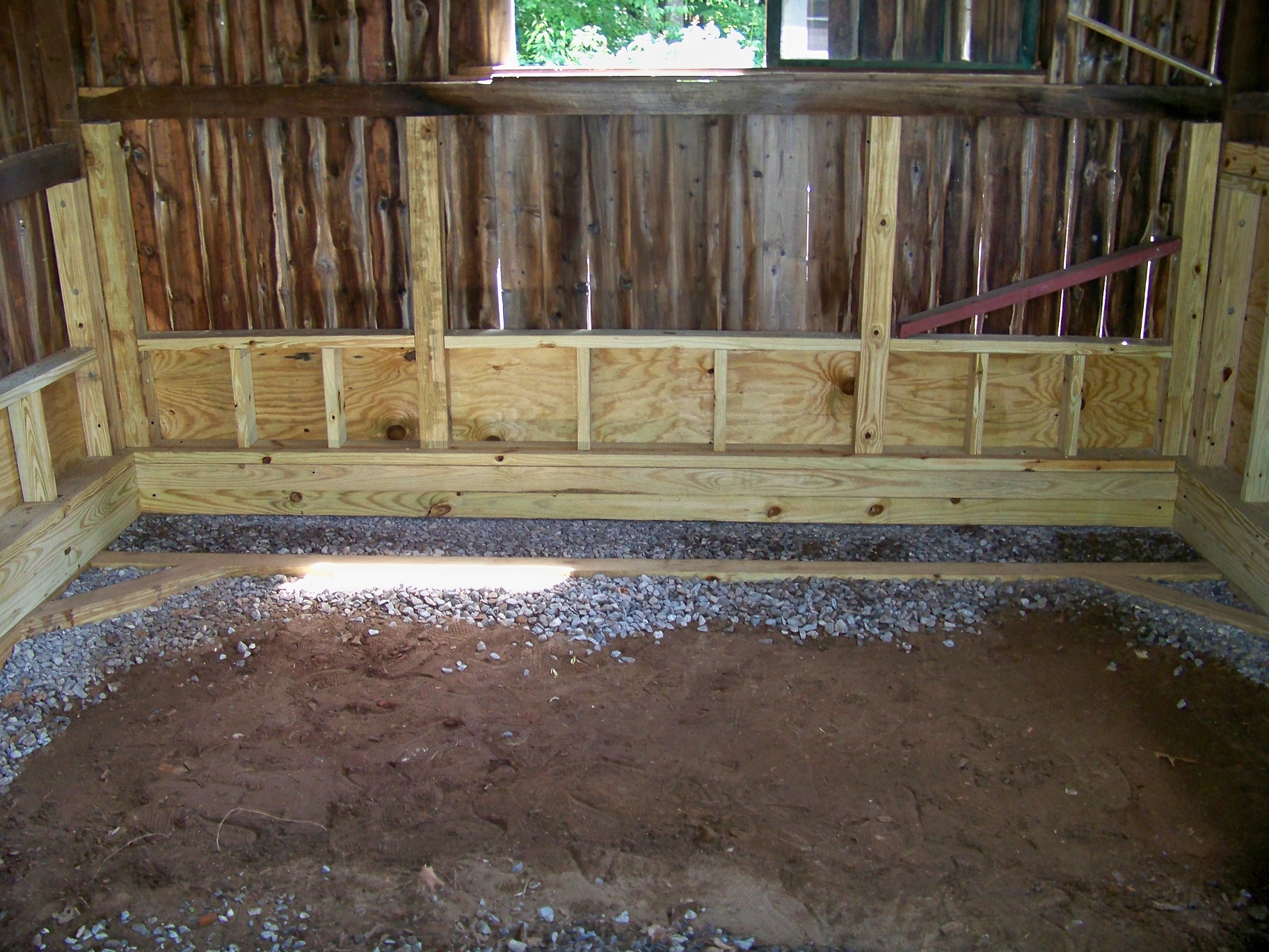

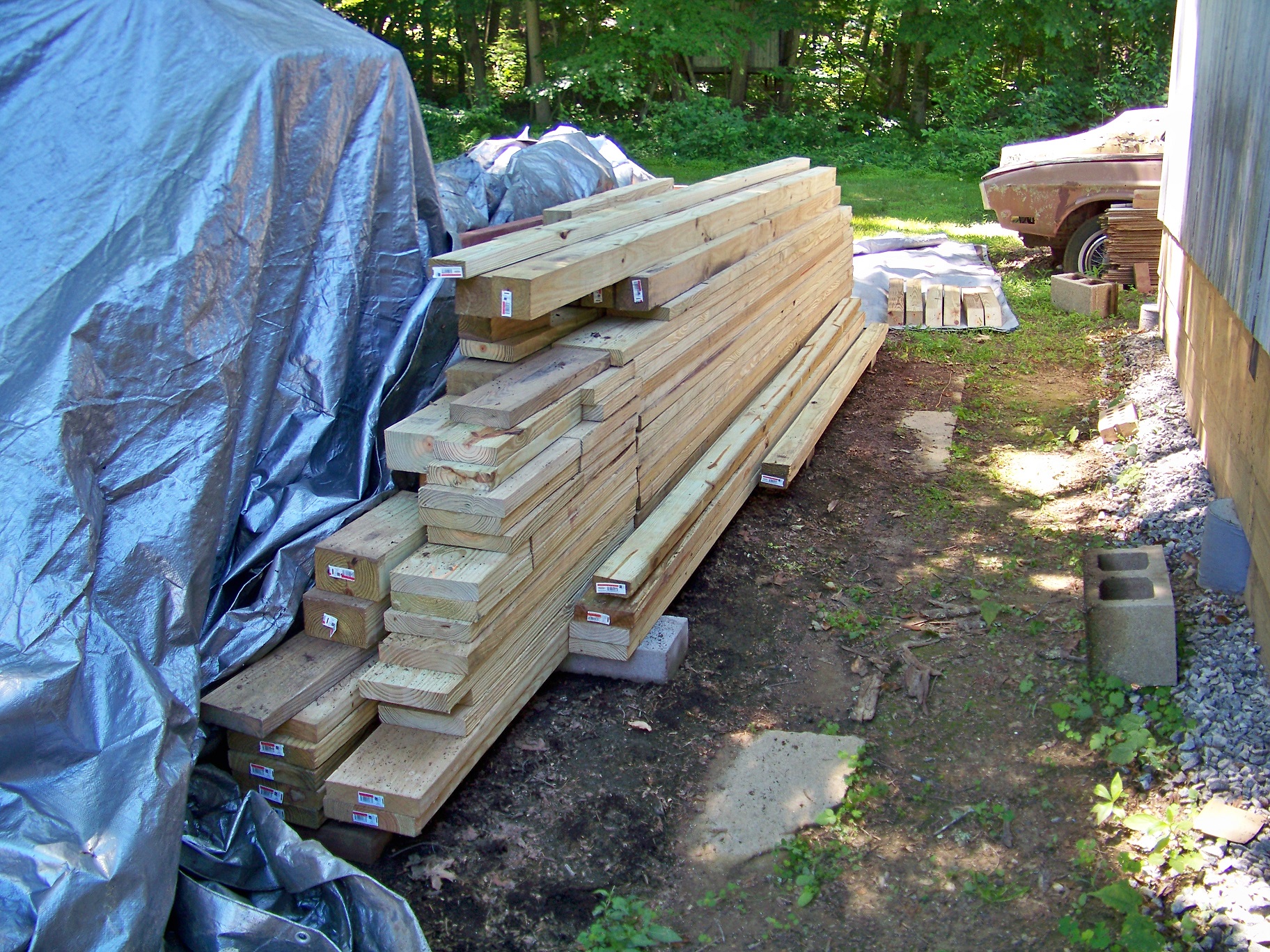

I cleaned all the lumber out of the shed. Filled the lifting shore holes. Leveled and tamped the gravel at the back wall.
There's frick'n spiders everywhere! Each one I see looks different from the last. I'll be setting off a bug bomb in there soon as a recent bug bite left me with "flu like symptoms" for a week (not really sure if it's related).
I ended up with quite a pile of lumber from the lifting frame and a bunch of 2x8s I purchased, but ended up not using. I was originally going to experiment with a joist free floating floor, but it's actually cheaper to use the lumber I have and make a regular floor.
So now my challenge is to see if I can make the whole floor (minus the plywood) from the existing wood pile.
