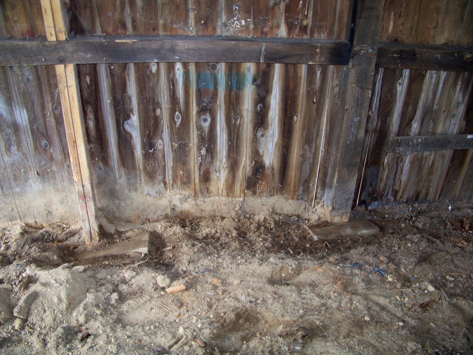

My Old Tools – Now that the floor is out I can see remnants of a sill beam. At some point someone put cement blocks under the center posts. I haven’t dug around the corner posts yet. I may just go ahead and lift and see what happens.

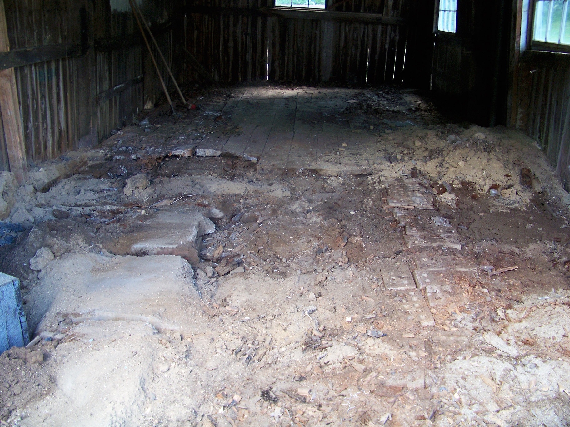

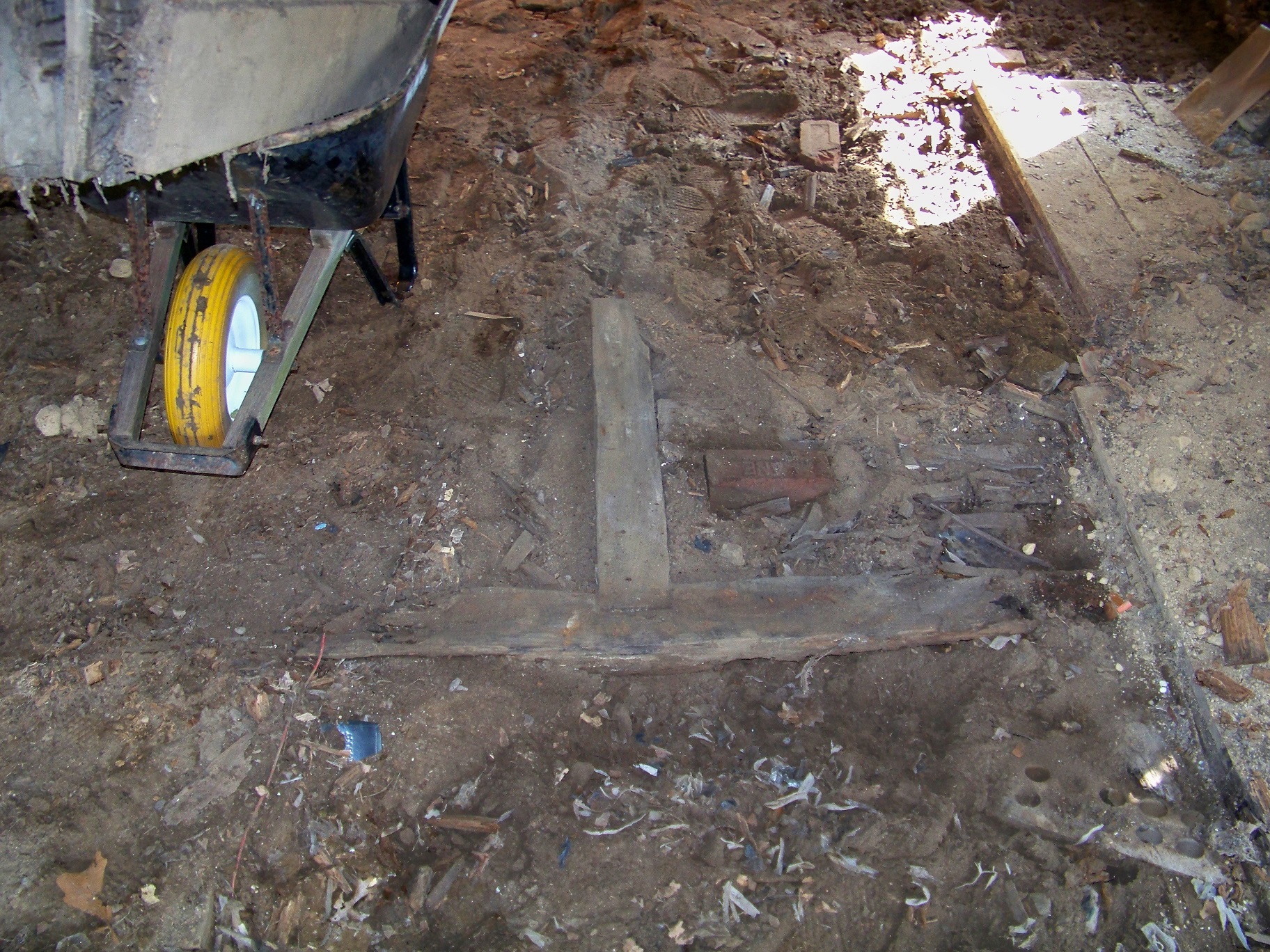

Today's Progress Pics:
Half the floor removed reveals poured cement things on left and bricks on right. both stop halfway into garage.
Under the floor I found this odd 1" dia. black 2ft long hose. Both ends flared out to 2" dia. and plugged with something. I thought it might be a piece of copper cable, so I started to hack into it. Some kind of liquid started squirting out under pressure. Not having time to play I tossed it (and it kinda creeped me out). It's still under the wood headed for the dump in the bed of my truck if someone really thinks they know what it is.
Here's a clue to the original construction. This is right in the middle of the garage (and it's completely rotted out).

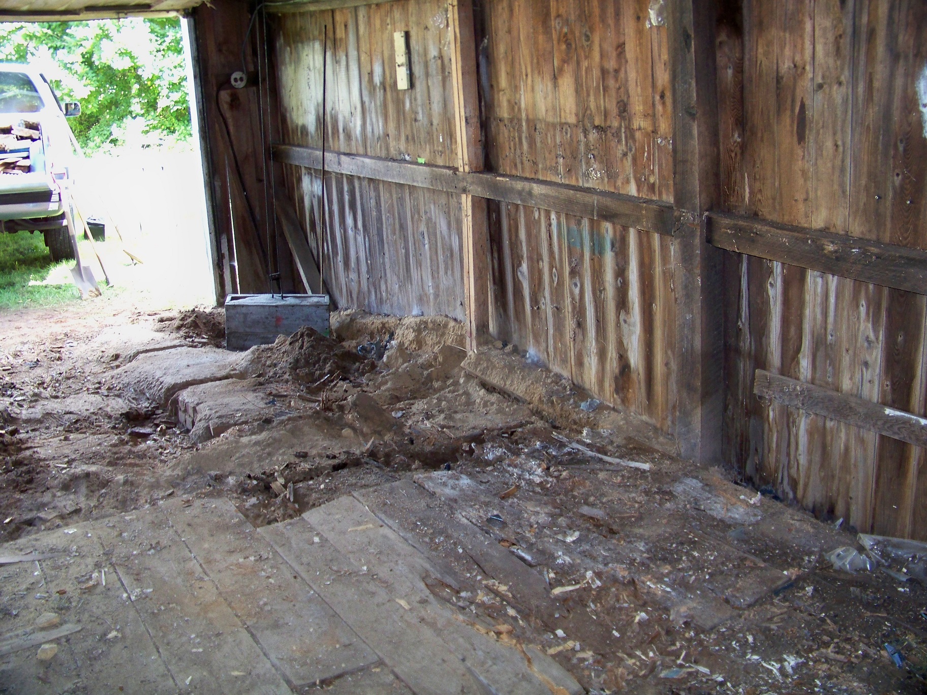

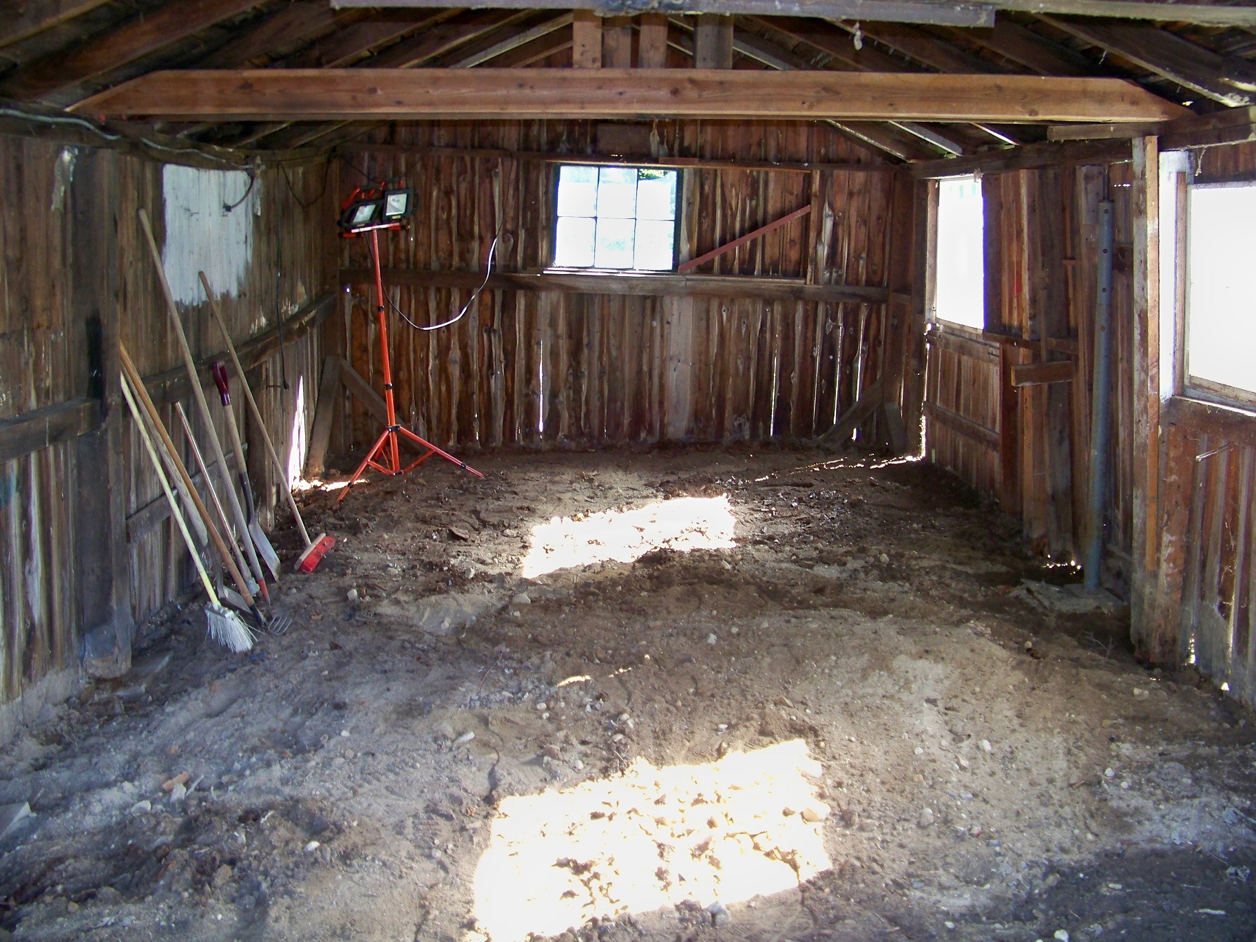

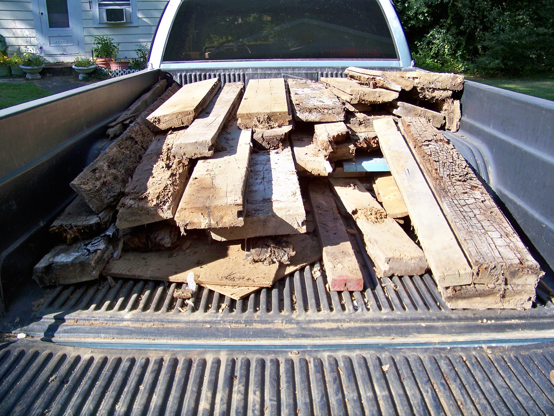

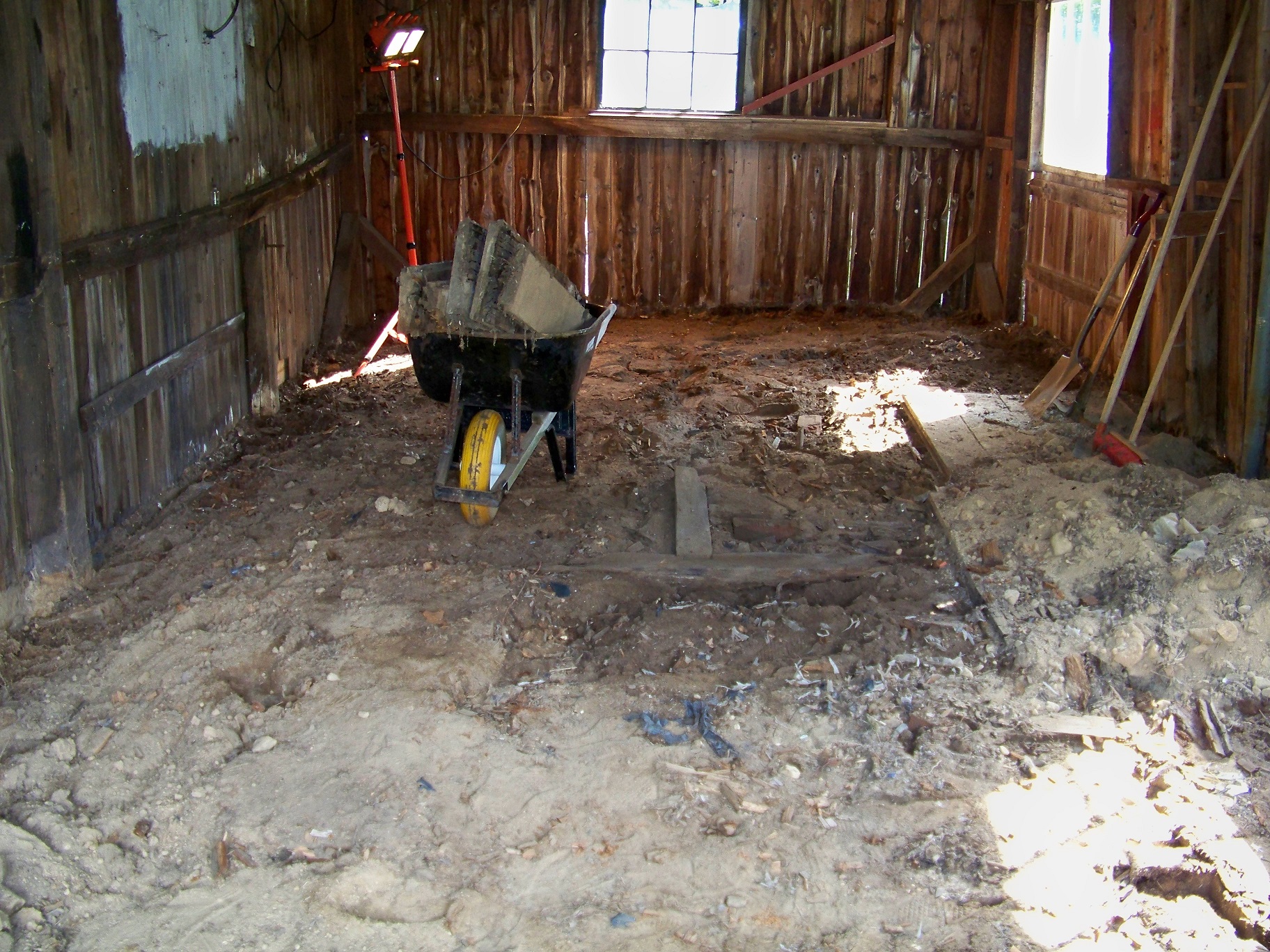

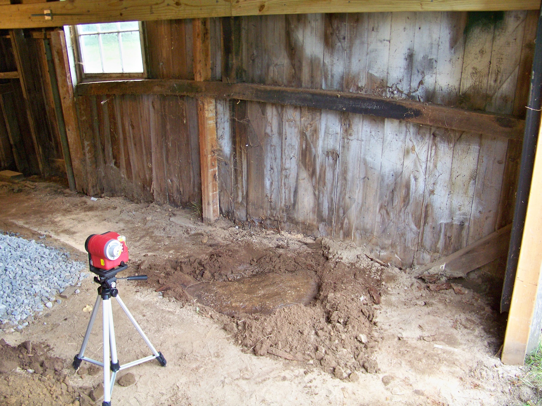

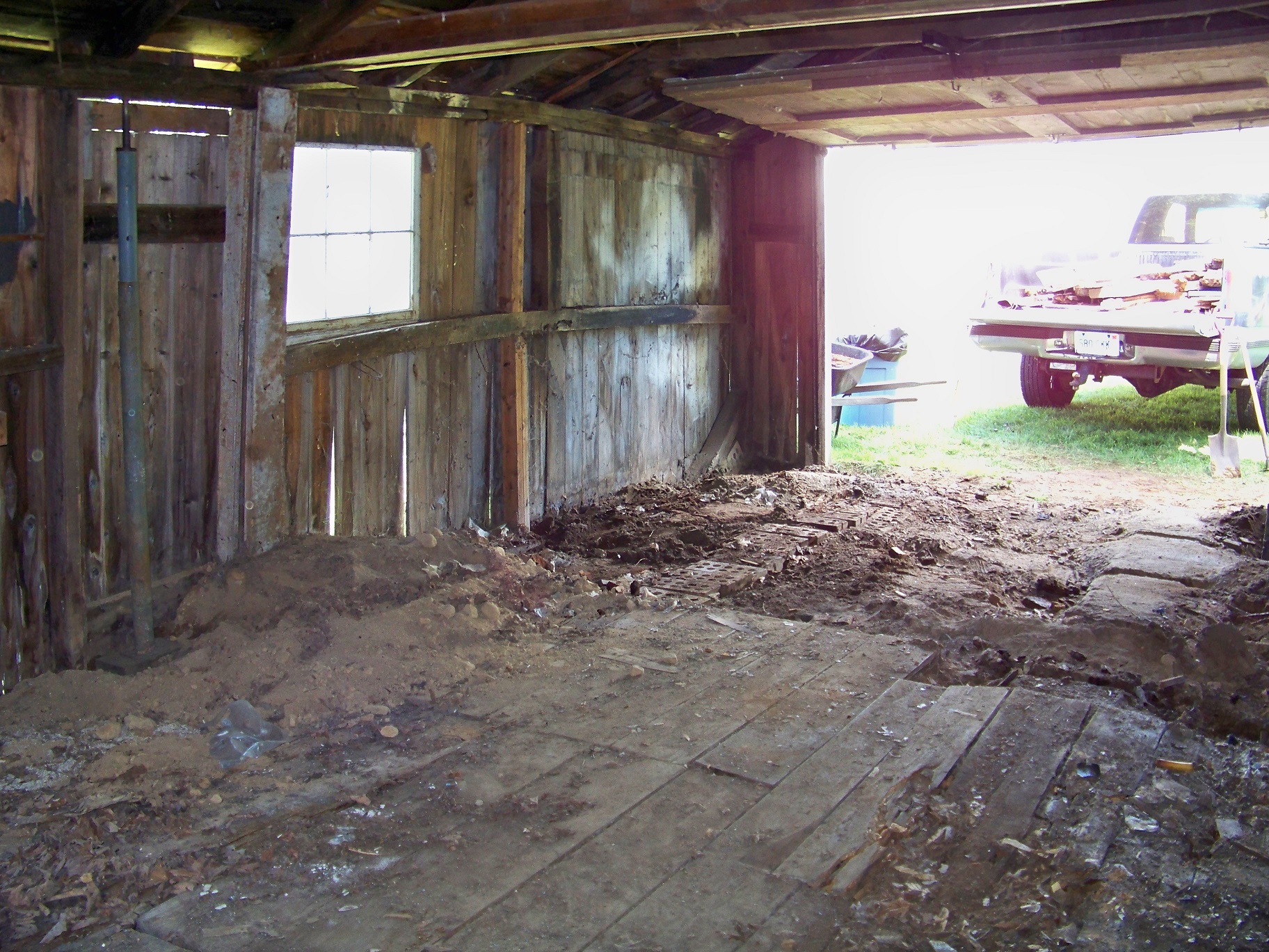

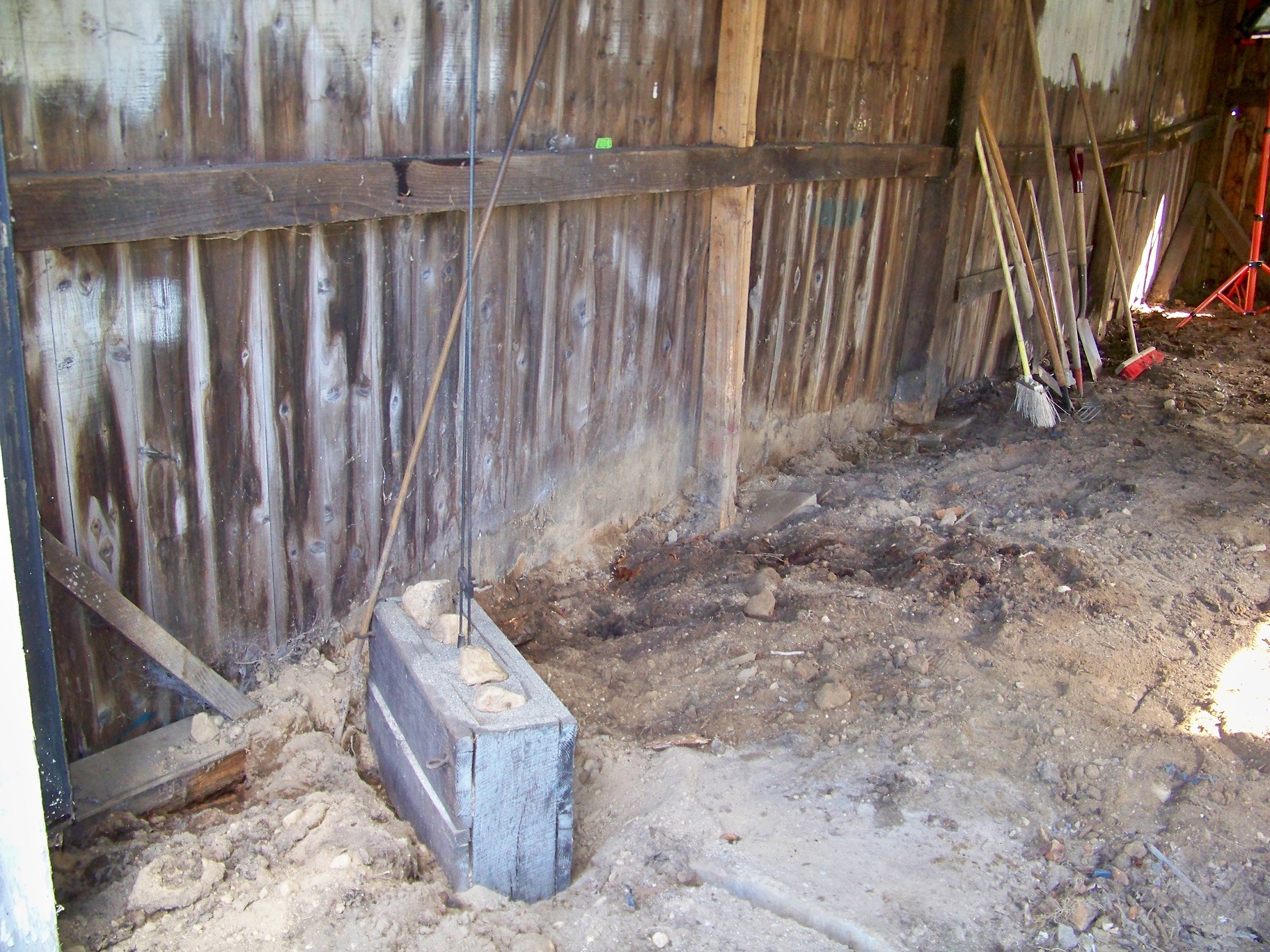

Today's Progress Pics continued:
All wood flooring removed and dirt redistributed. I did find a pretty good sized old critter cave under the flooring near the previous large dirt pile.
Old structural repair with cement blocks and non-pressure treated lumber.
I dug a hole for the counter weight so I can open the door all the way. You can see the sill plate here too.
I thought I'd be able to save some of the flooring for cribbing. I only ended up with four 4ft pieces. Some is going to the dump. The rest is so far gone that I dumped it in the woods to let mother nature finish the job.

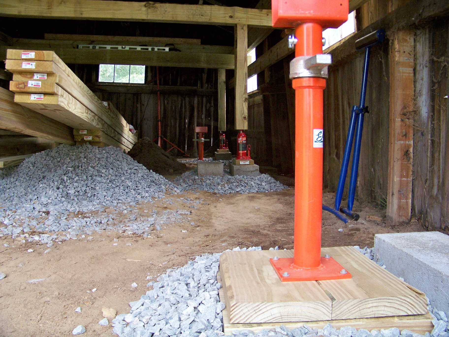

So here I am compiling a shopping list for all the necessary guy wire components and it hits me (like a dope slap), if I lift from the top, I don’t need any guy wire. I need to be planning the lifting frame that I’ll be lifting the building with.
4 of these arrived the other day:
Ellis Light Duty Steel Lifting Shore STL-22 (linked)
each with STL-JHD double joist holder U-head adaptor (linked).
Total with shipping = $700

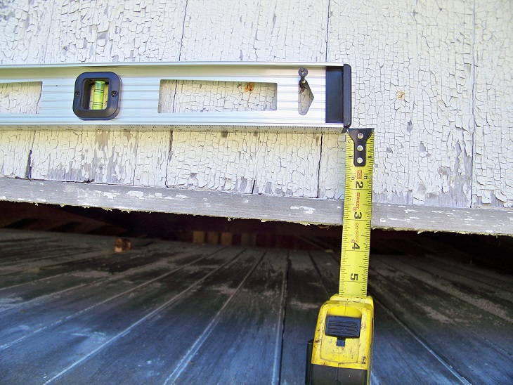

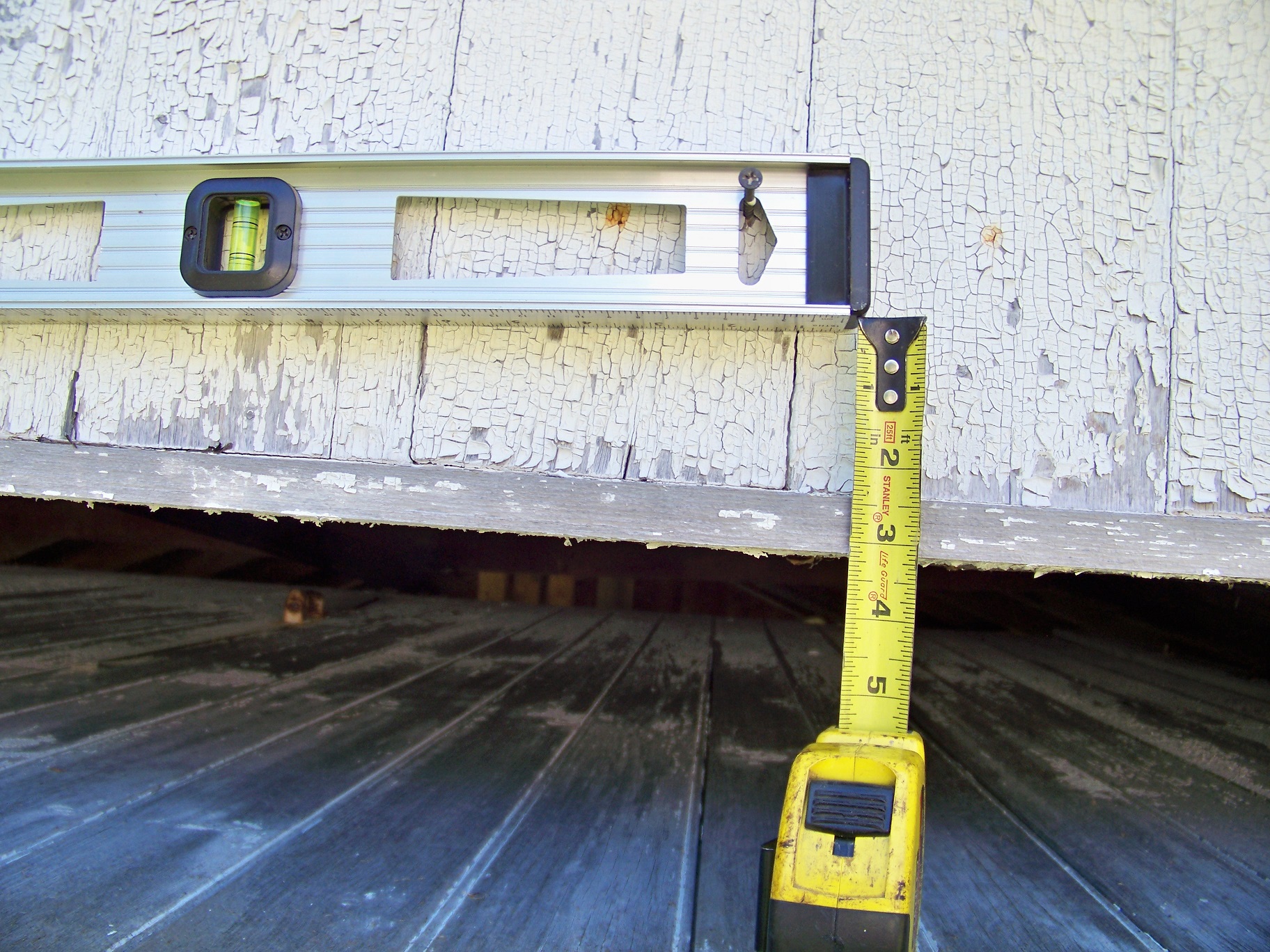

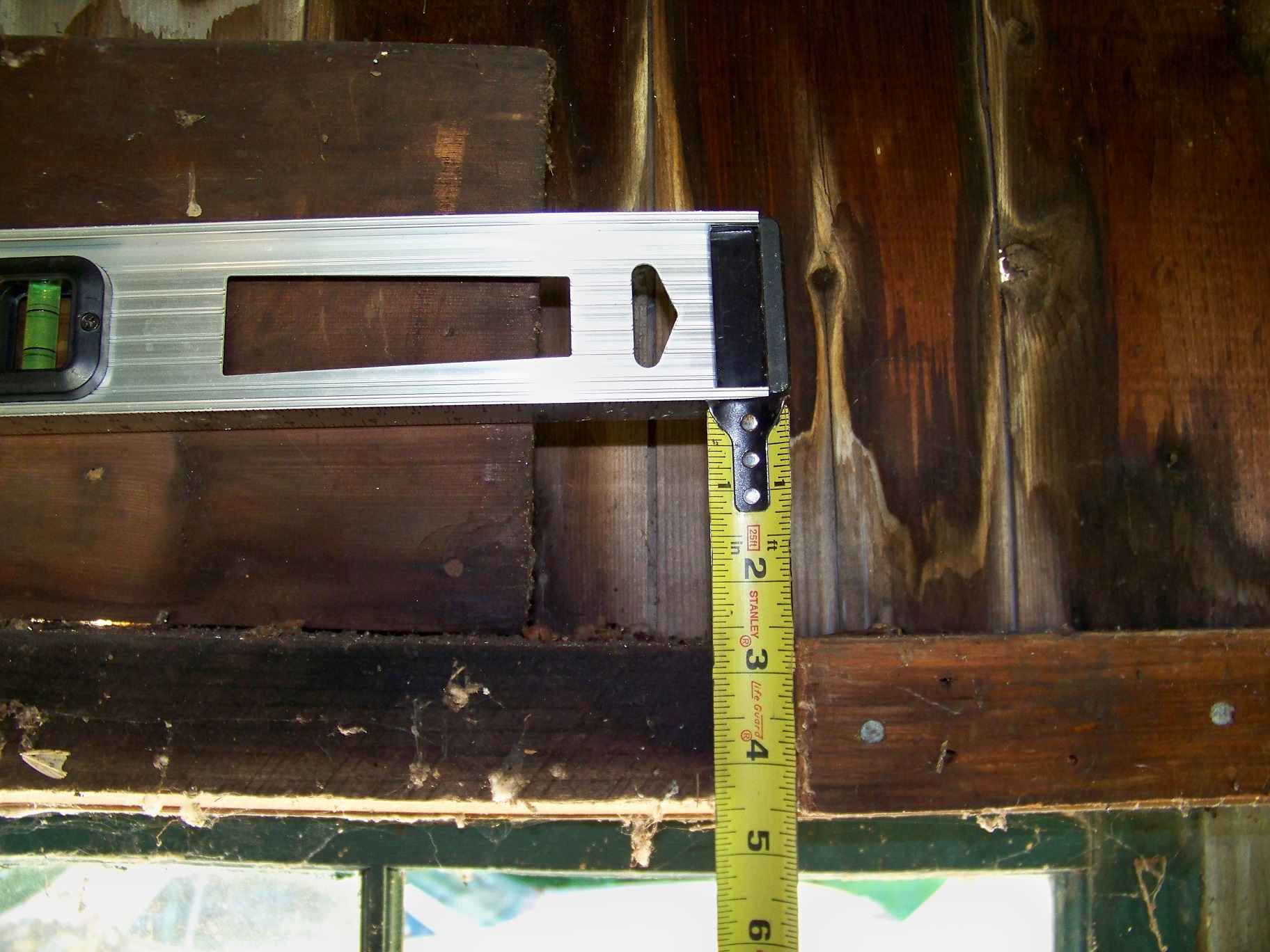

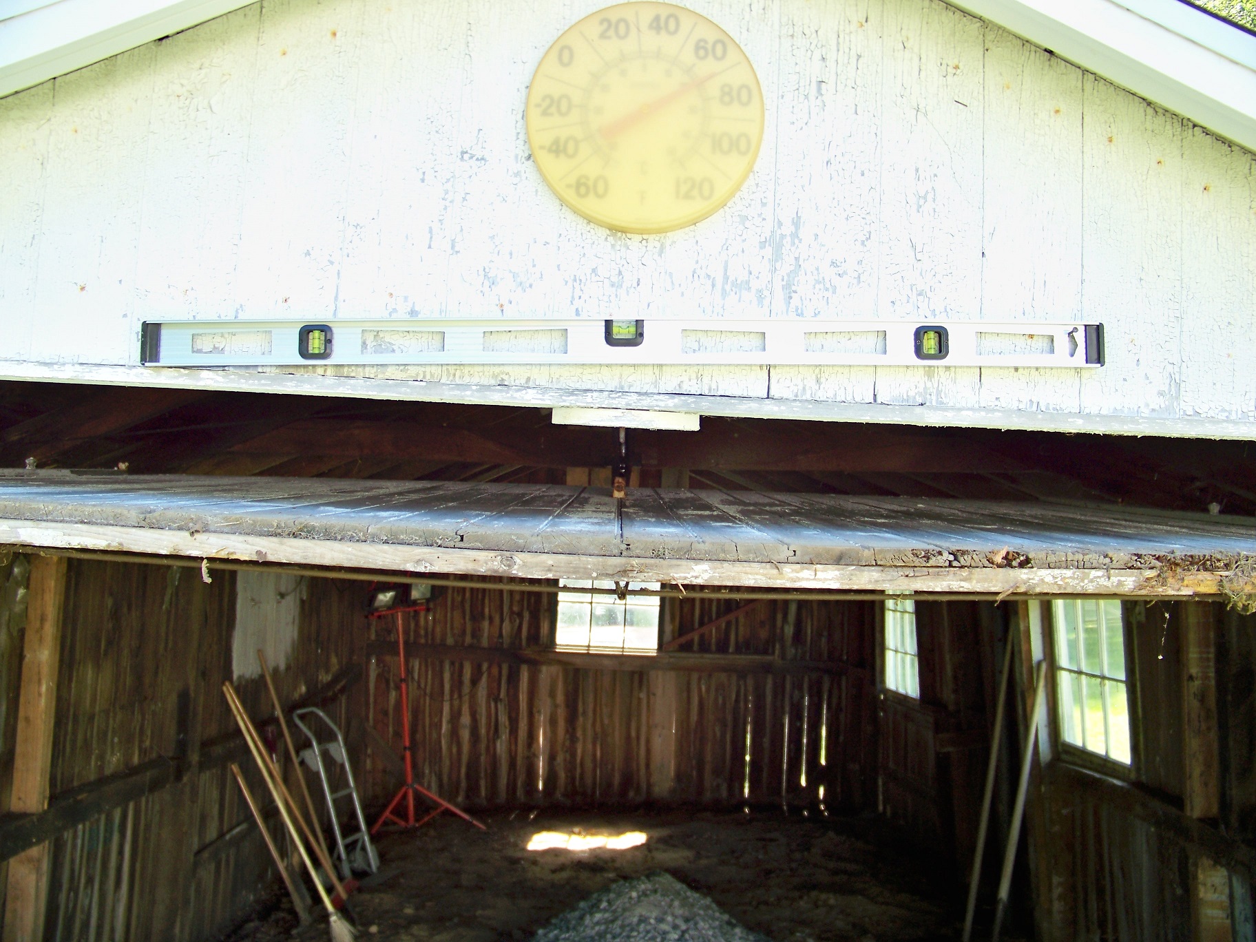

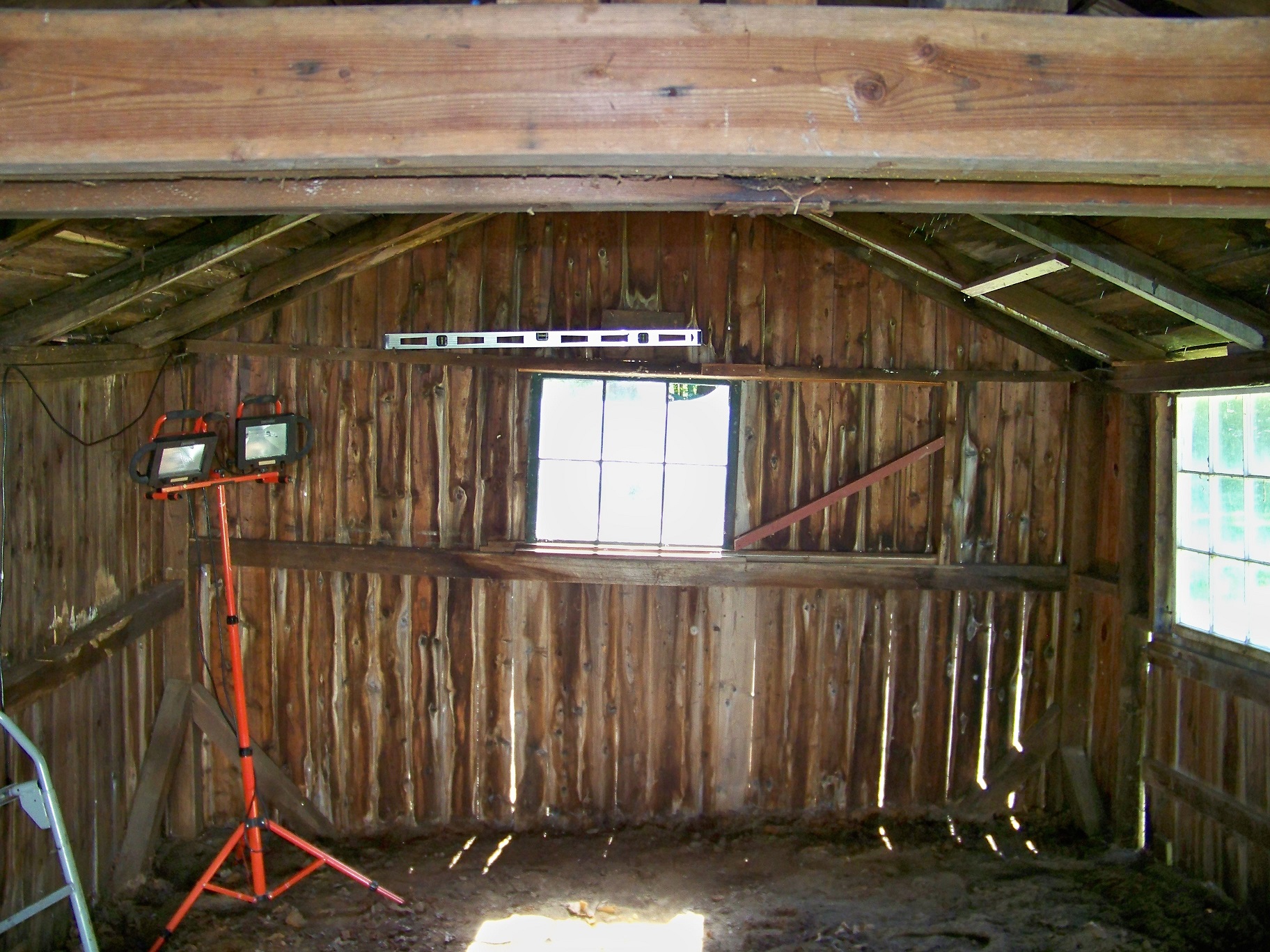

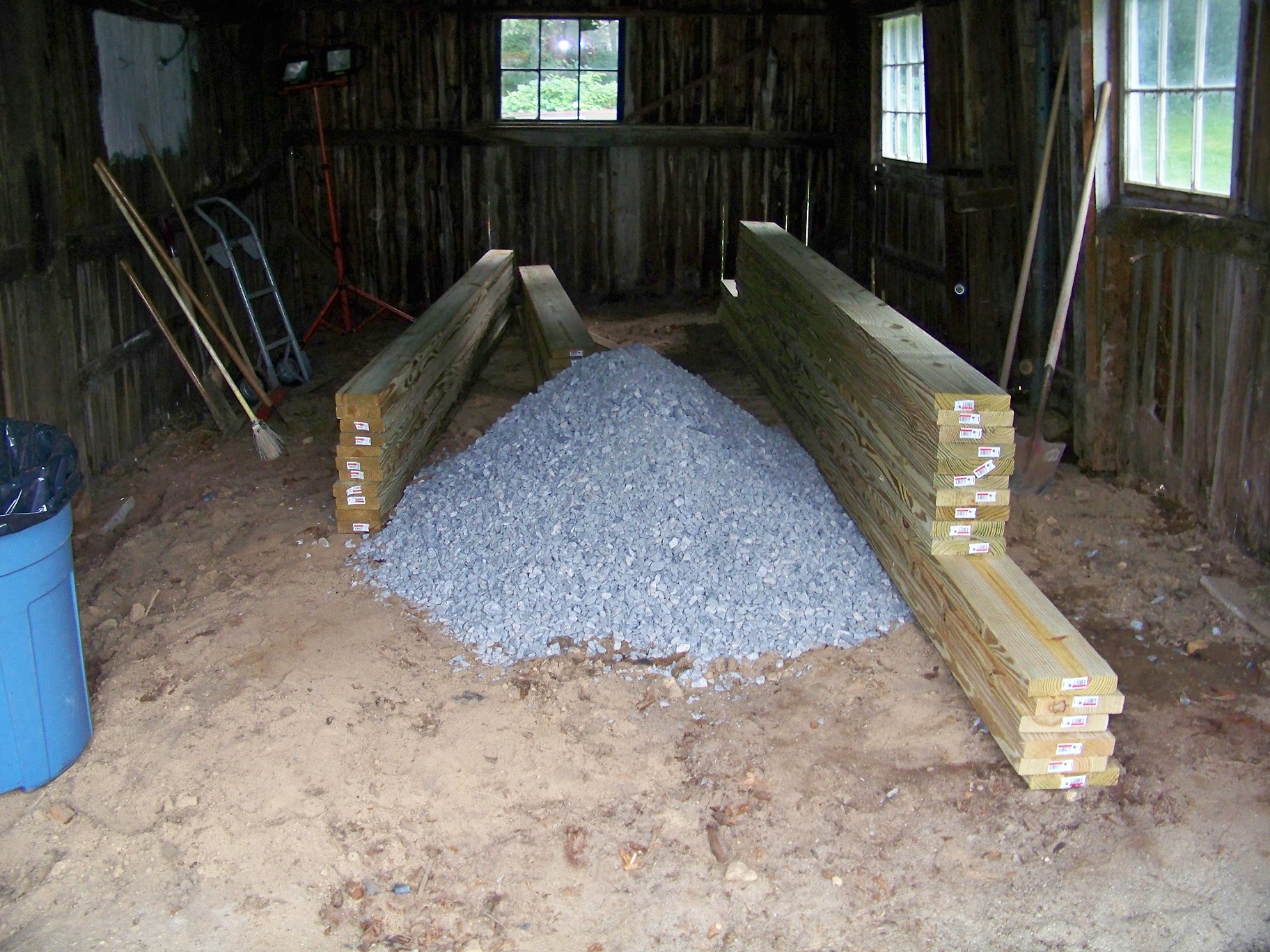

Today's lack of progress pics: (Wanted to get lumber, but can't seem to get the flat bed running lights to work.)
1 ton of 3/4 stone ($19) for drainage under new sill and as part of base for lifting shores.
I knew it was crooked, but dang!
The PO did 1 thing right - the center beam is level (that's the only good thing I can say about it).​

Just tilt your head!
The time someone saves by not squaring things is tripled later on when they go to add windows, doors or siding.

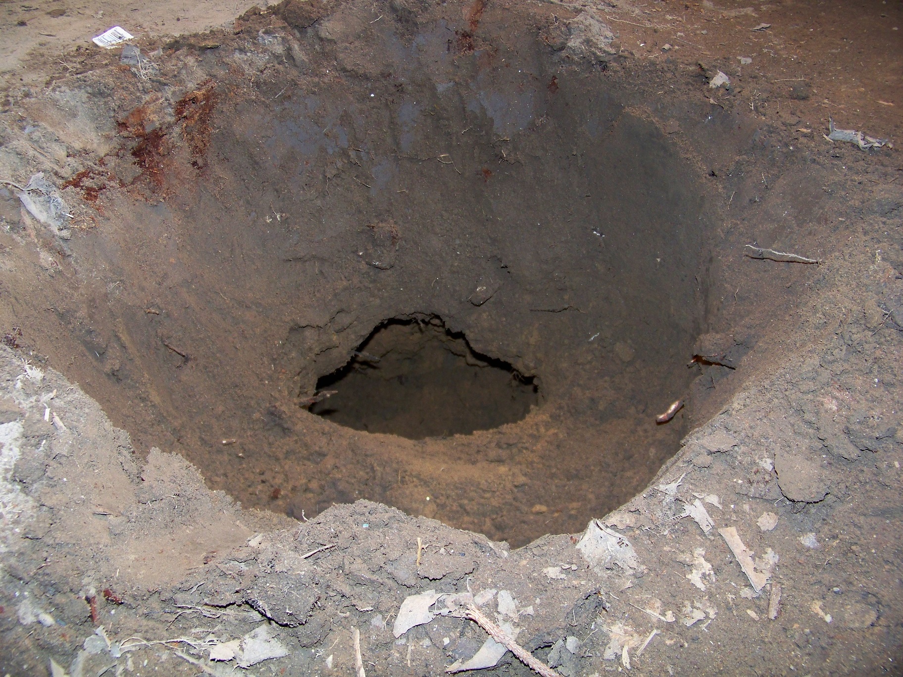

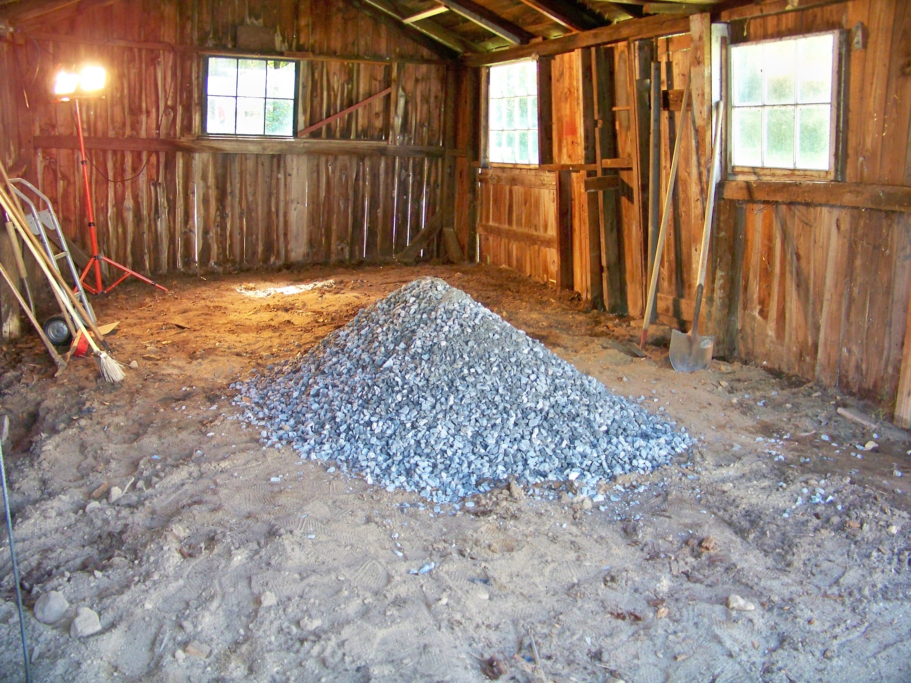

Obviously building the original structure on dirt wasn’t the brightest idea, but it has been there for a very long time. I pretty much wrote off the demise of this structure to rotting wood sills in dirt, which I’ve come to realize is only partially correct.
While removing the old wood floor I encountered a maze of endless critter tunnels and several pockets filled with shredded plastic, paper and nut shells. My tenant had commented in the past that she’s always seeing chipmunks coming and going from the shed. I didn’t think much of it since heck they’re only cute little chipmunks.
I’ve pretty much raked the whole garage covering the holes and visible tunnels. The soil under the floor is much looser, stone free, and easier to dig in than the soil outside. The dirt piles that were growing on top of the floor were more what I’m used to = heavy with lots of rocks. Though I’ve never seen a chipmunk move small stones, I’m not convinced that this isn’t part of their behavior.
While unloading the 3/4 stone I notice 2 new holes directly next to one of the uneven cement support blocks placed by a previous owner. Now I understand why all the cement blocks are very crooked. Sure some of it may be that they’re sinking into the old rotting sill beam, but the chipmunk burrows certainly aren't helping.

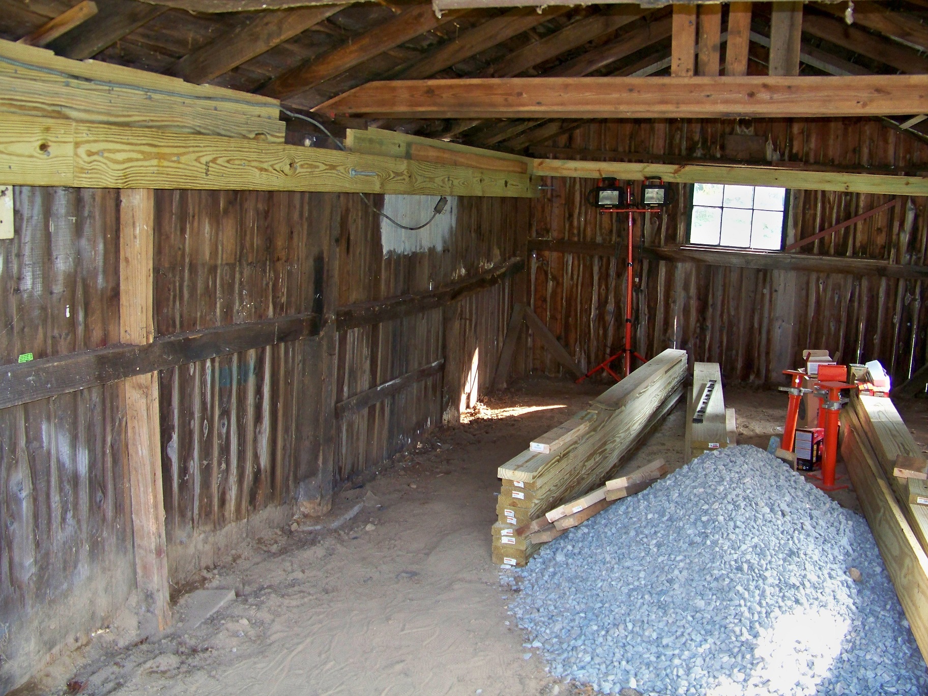

Purchased 1/2 the lumber required for the job. All pressure treated and darn heavy. Only got 1/2 cause HD ran out (of lumber I would consider usable).

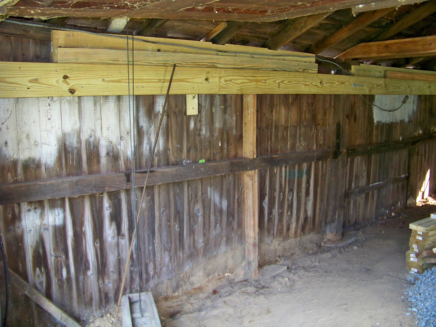

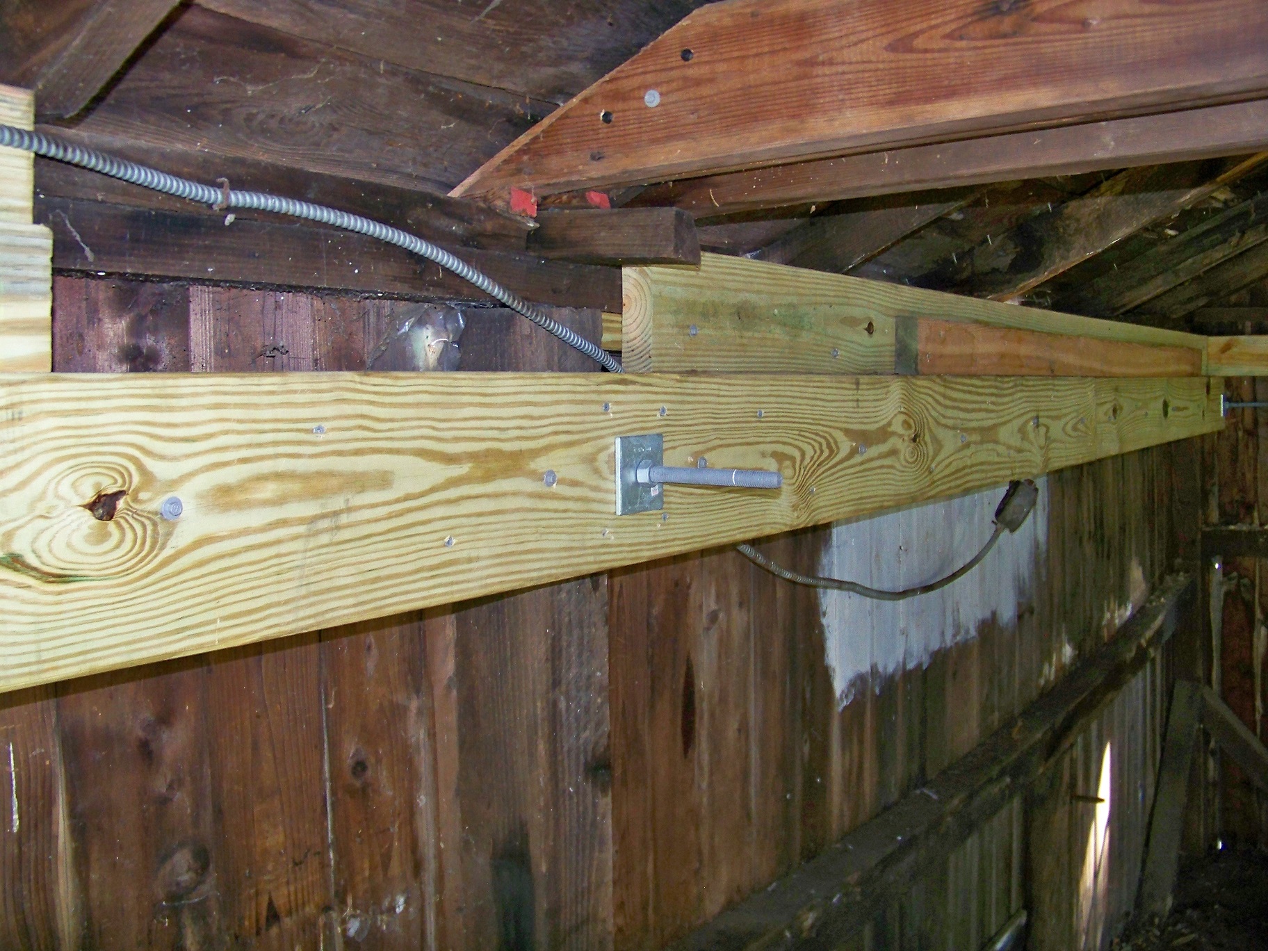

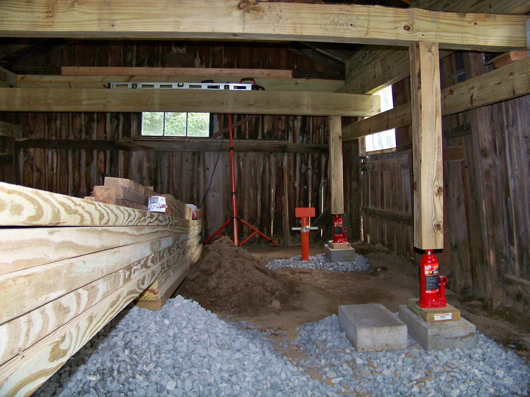

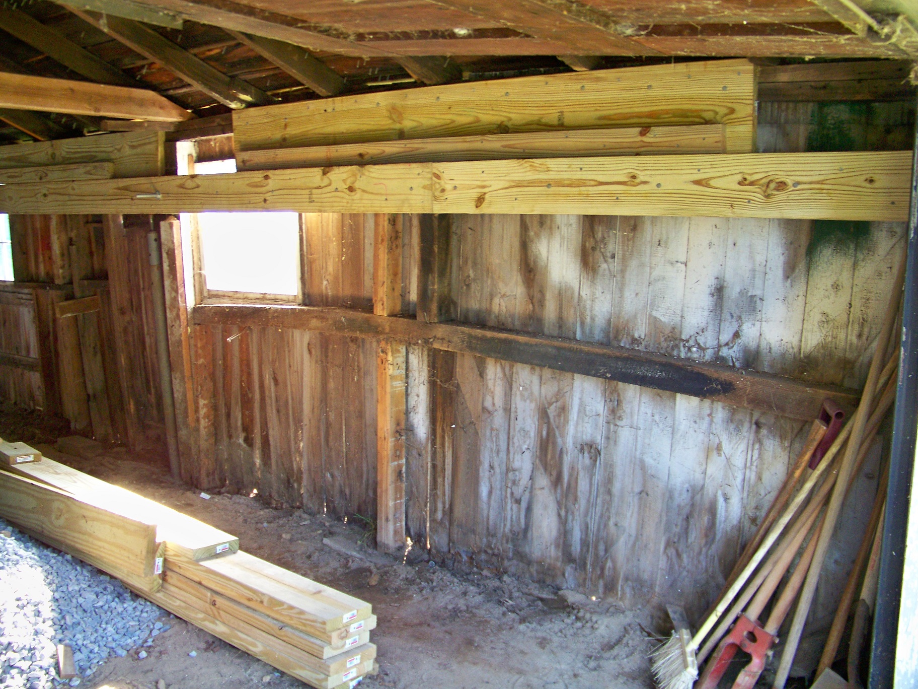

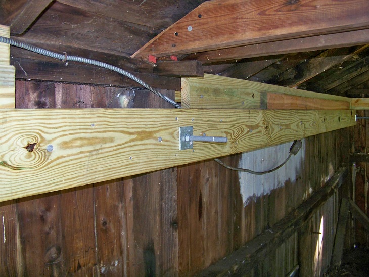

Progress Pics:
The lower sistered 2x8 beams are attached to the main posts via 5/8" Hot-Dip Galvanized threaded rods that go through the exterior walls. Existing washers will be replaced with 3" square bearing plates when they arrive. Beams attached to top plate are not mechanically attached to lower sistered 2x8 beams, just resting on top to help distribute the load when everything is lifted.

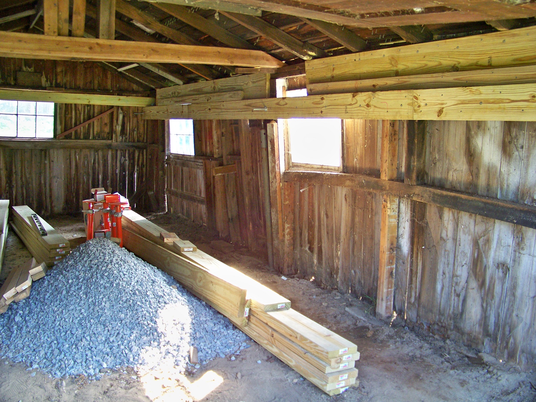

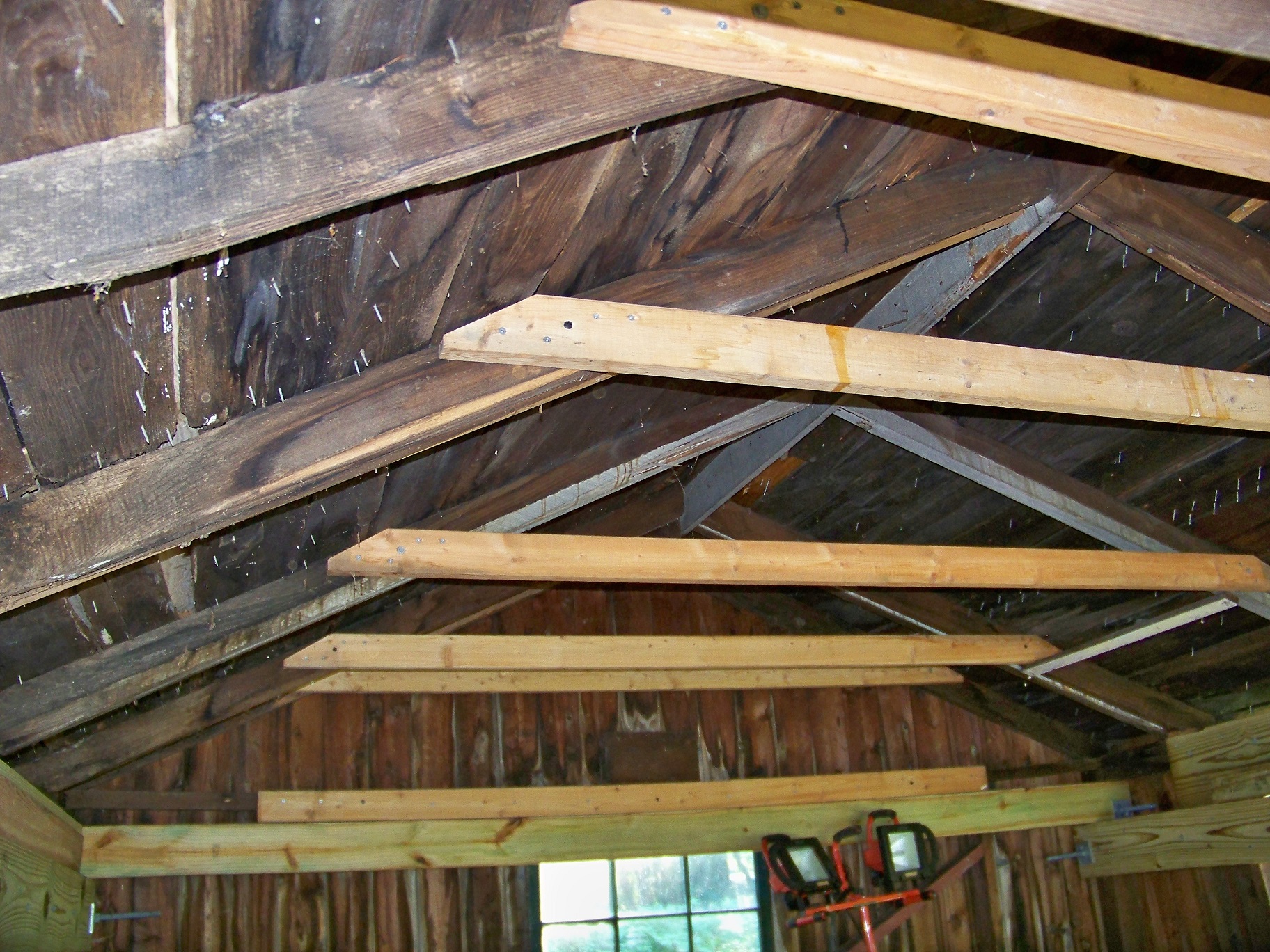

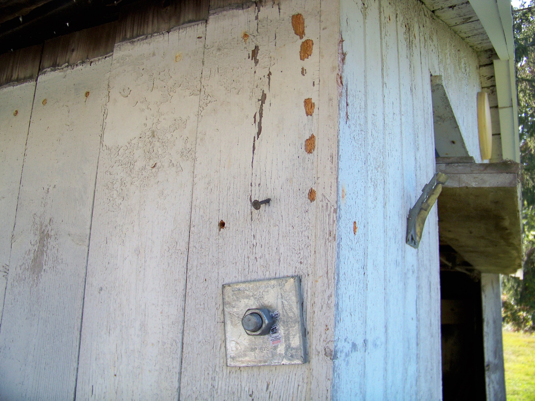

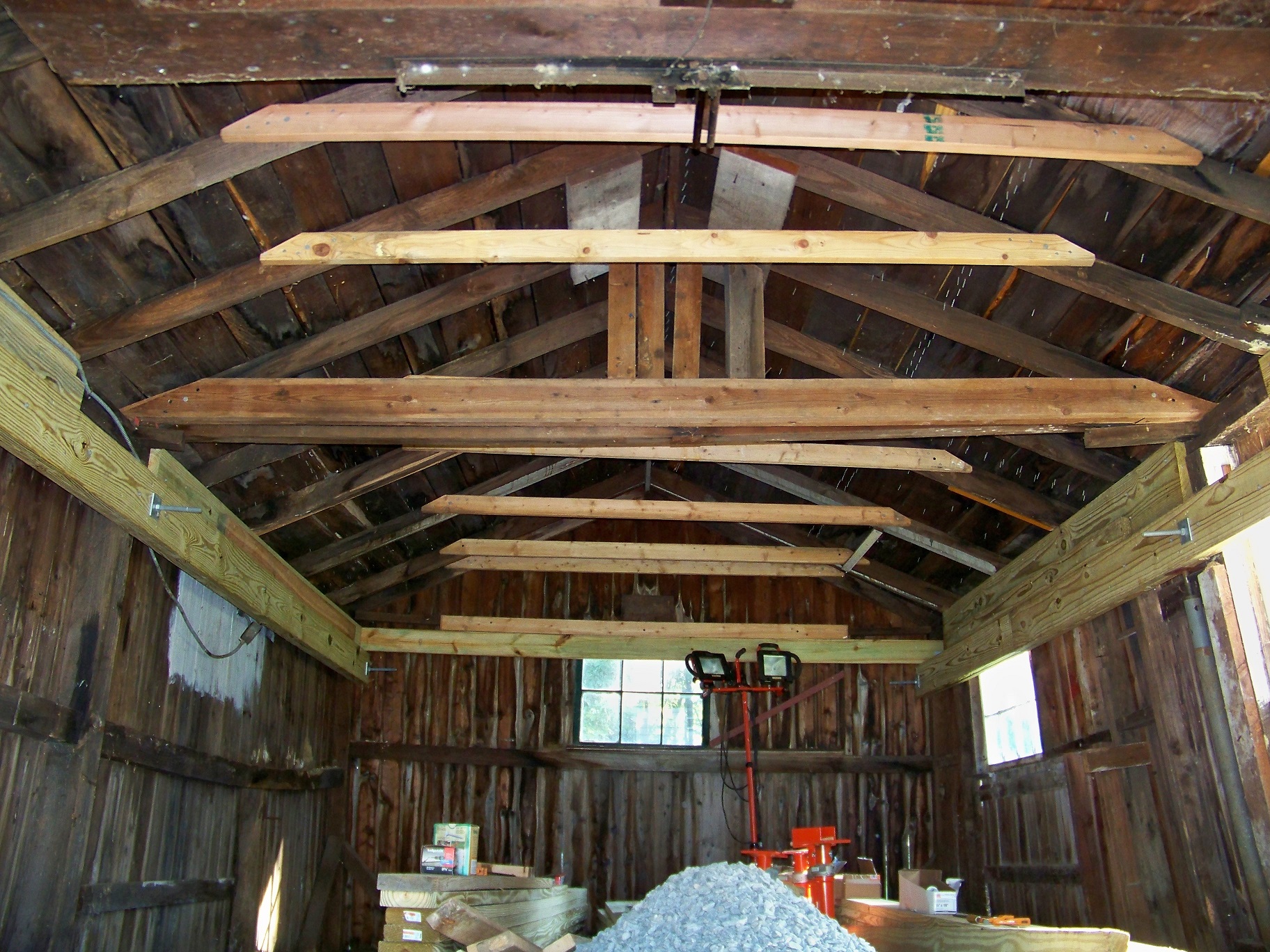

Added Collar ties:
Added 3 inch sq. Hot-Dip Galvanized Bearing Plates interior and exterior:
The threaded rods were sticking out about 4 inches on the exterior which apparently made an ideal wood pecker perch, so I put the excess length on the interior.
MikeF2316
Dec 29, 2012
9,605
Thornhill, ON
I can already feel the bumps on my head from those. And they're 500 miles away!
And I can say, you're a madman for taking this on. :bowdown: Looking forward to more.
P
Platonic Solid
Nov 29, 2014
3,587
CT-USA
Actually, they're shoulder height, and yeah I have successfully avoided injury so far, but now they're sticking even farther in. I didn't really want 16" rods, but it's all I could get. I keep hitting my head on the beam above it.
It's just now starting to get exciting as the next step is to build the lifting frame.

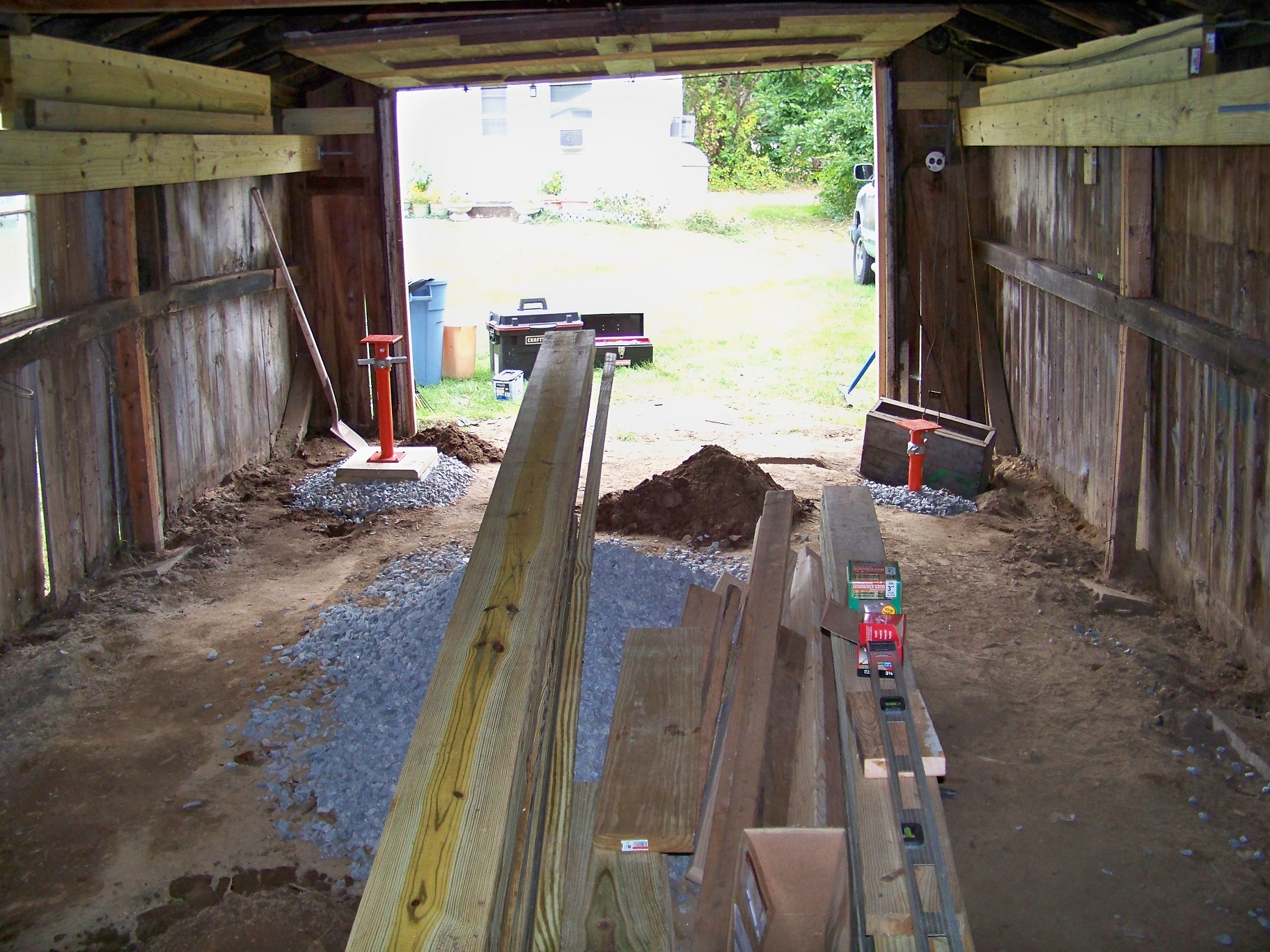

I'm thinking it might be best to treat this like those prefab pre-built sheds and put the whole thing on top of a 4"-6" gravel base, that way there isn't any wood underground.
theoldwizard1
Feb 22, 2011
43,433
SE MI
You are still going to need a PT footer (double 2x6 or 2x8), but the gravel base it an excellent idea.

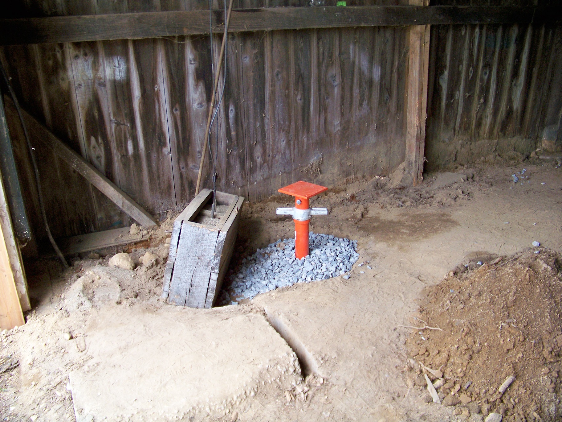

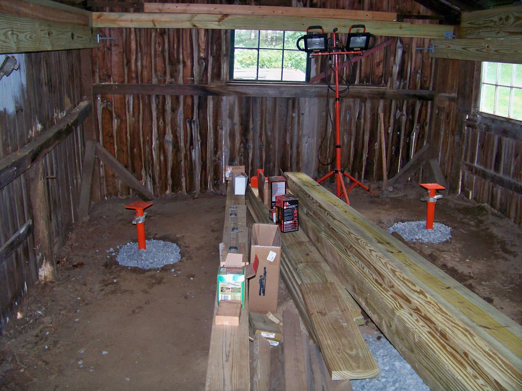

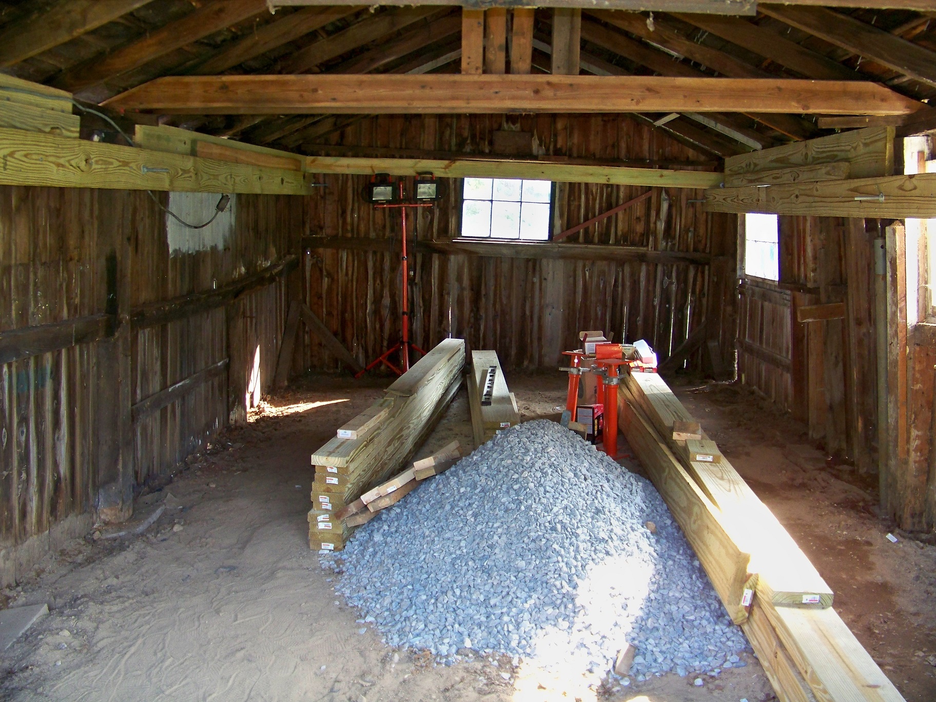

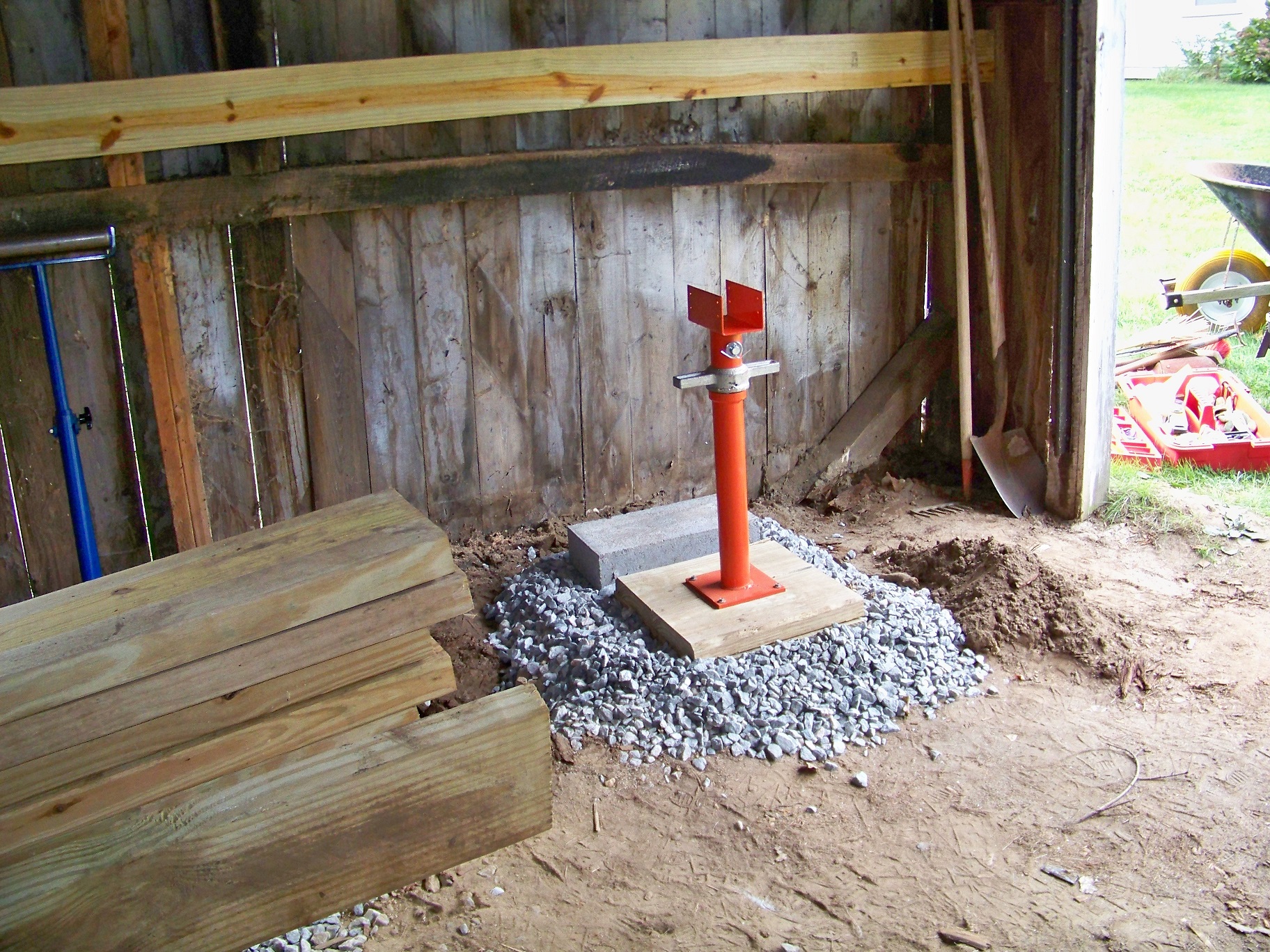

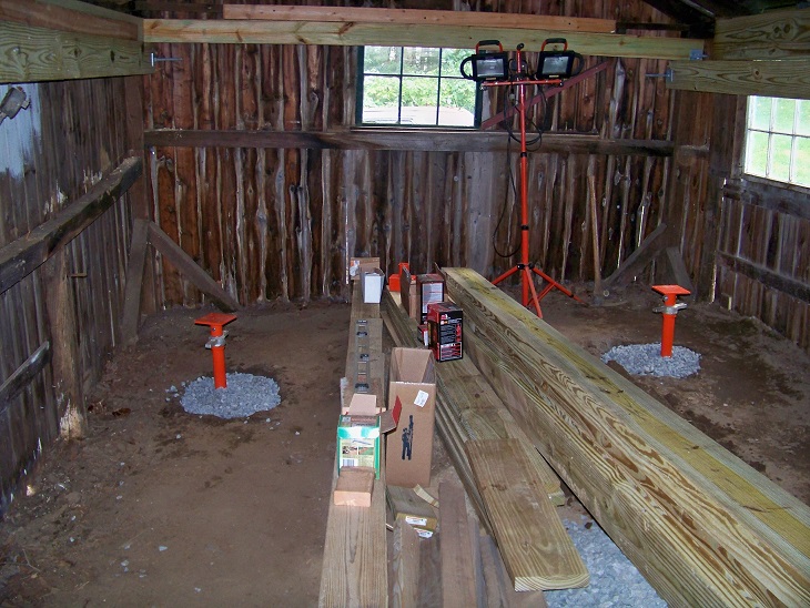

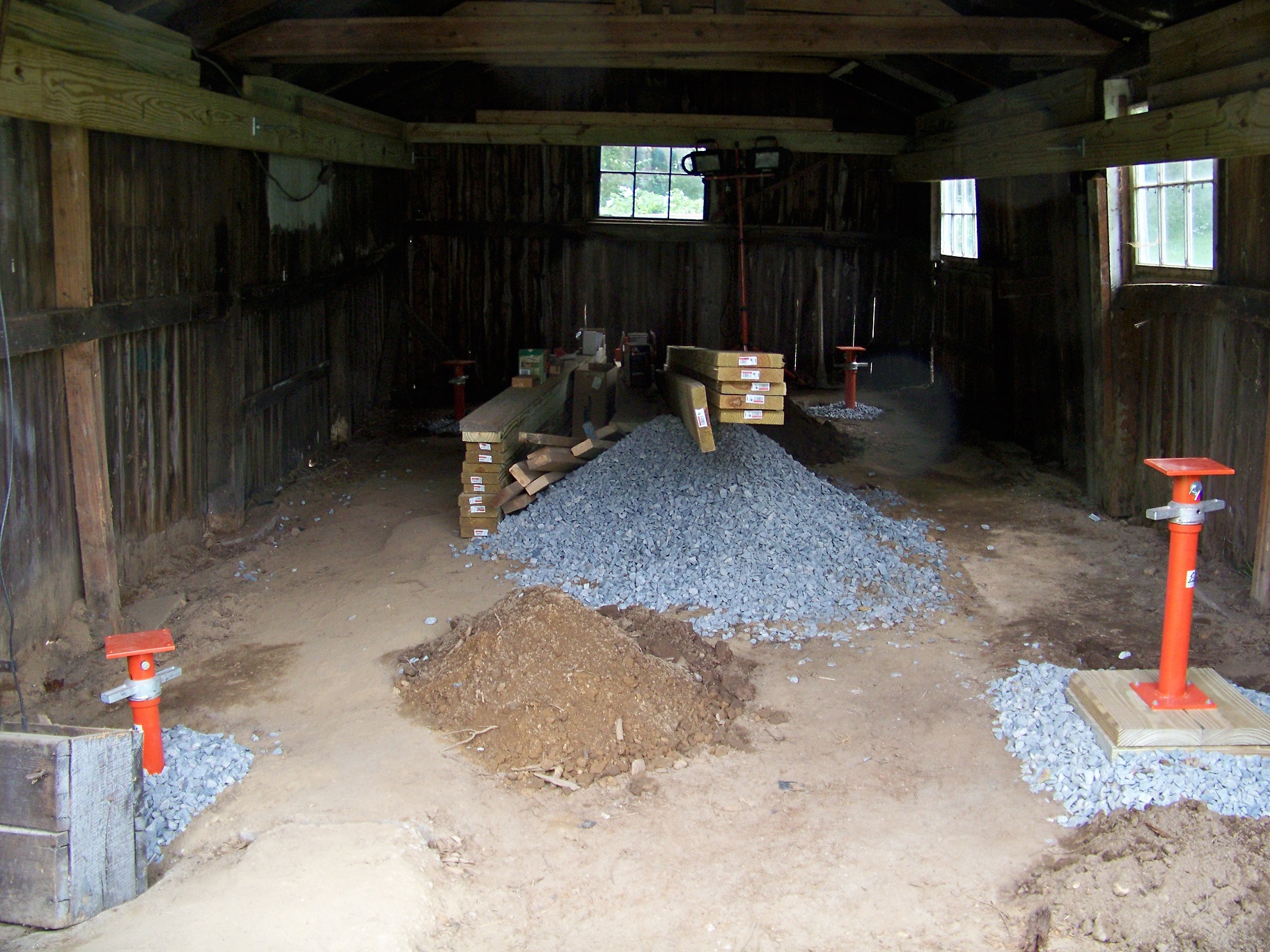

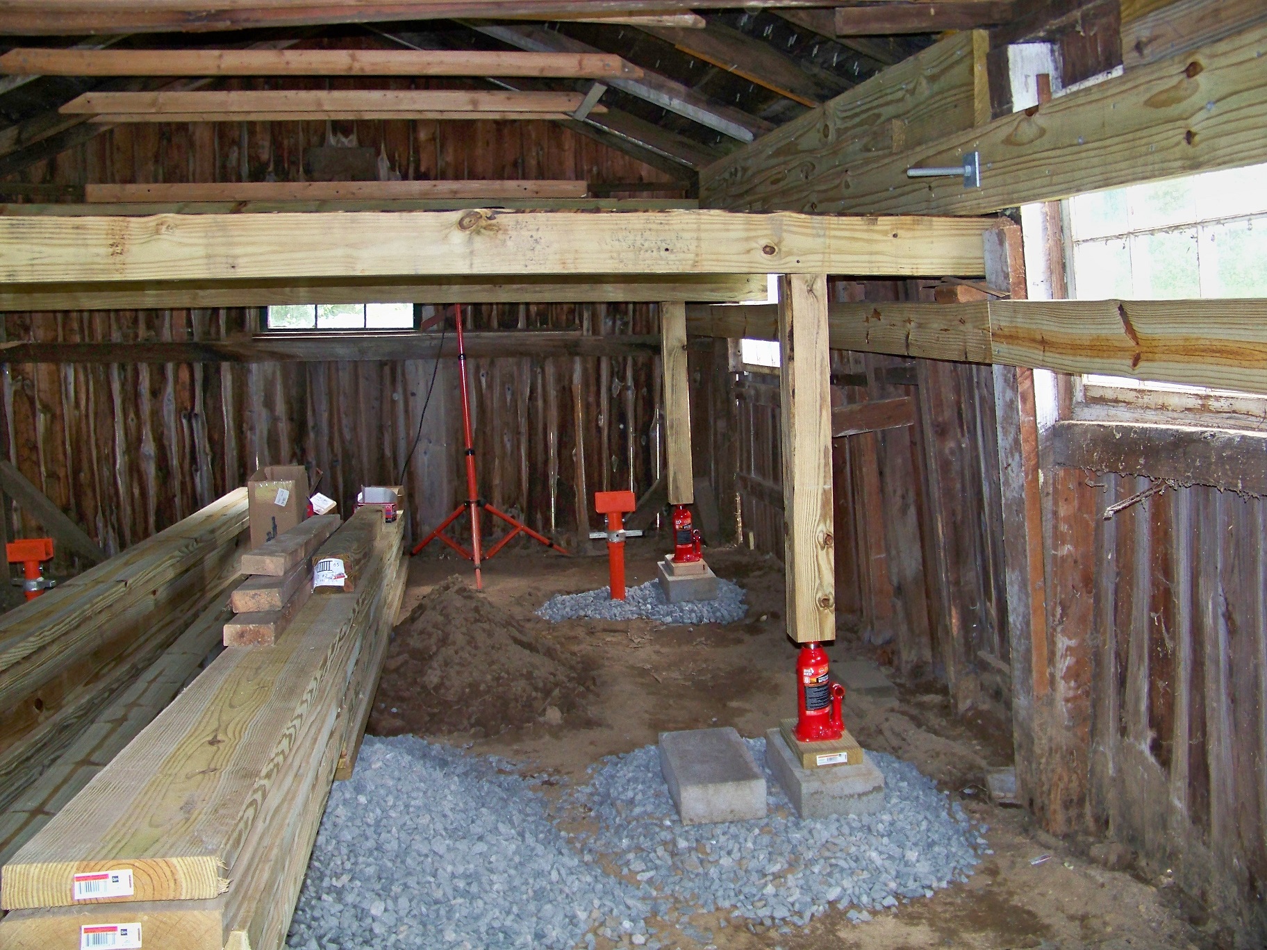

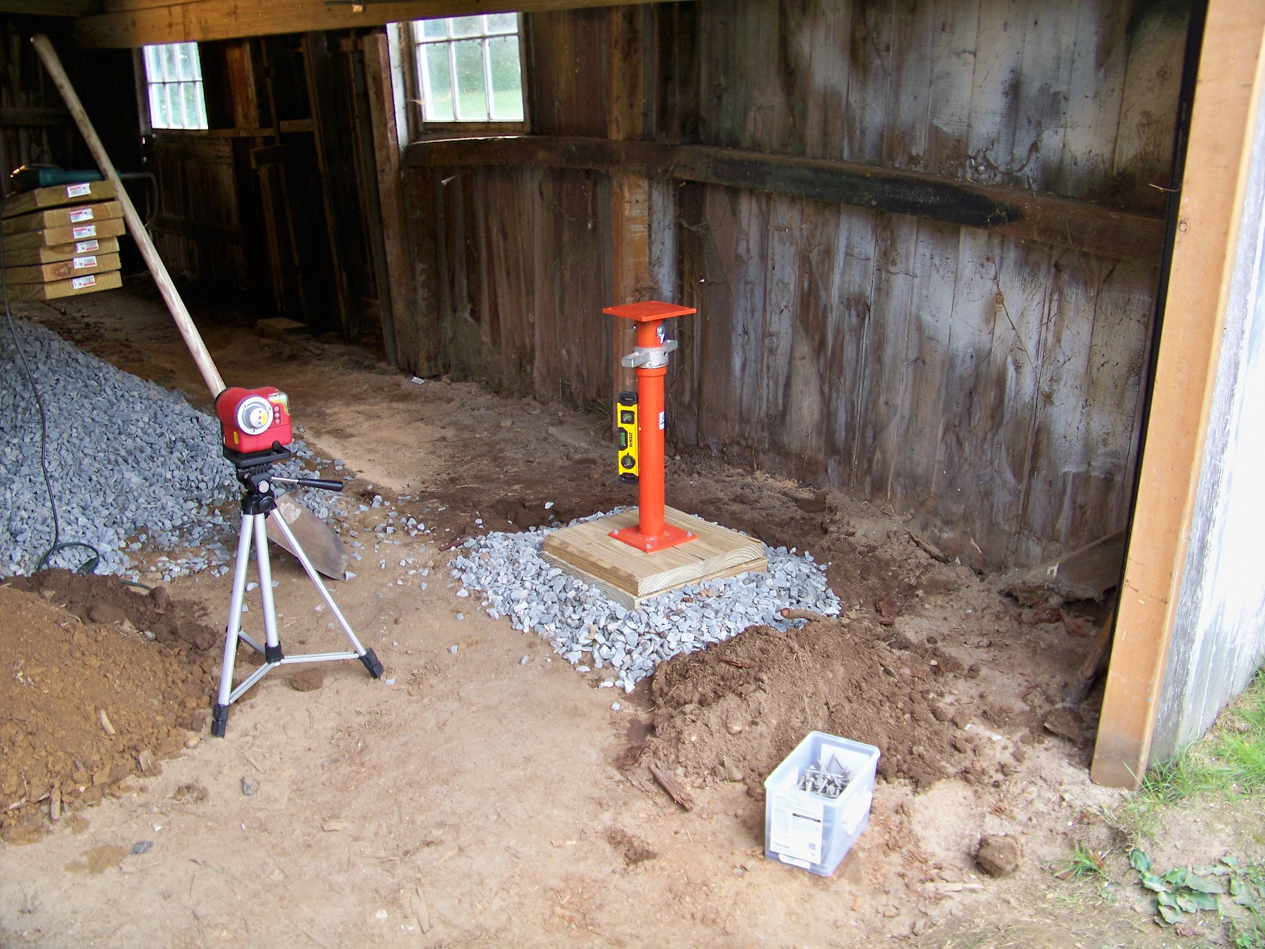

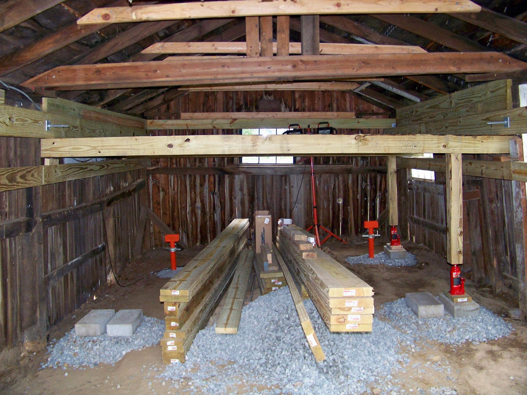

Progress Pics:
I attached the lifting shores to a wood base and buried them, putting gravel under and on top. I did encounter a few surprises along the way.
I encountered a massive boulder that can't be moved so I put that lifting shore on top of it.
While digging the hole for the right rear a large cavern appeared. Dang chipmunks! Good thing I decided to dig or this could have been a disaster. It took most of the dirt I had removed from that hole to fill in the cave.

Progress Pics:
I need to lift up the right side to make the beams of the lifting frame level before attaching everything to the lifting shores. I attached a row of boards to the left and right walls to temporarily hold the beams while I work beneath them.
