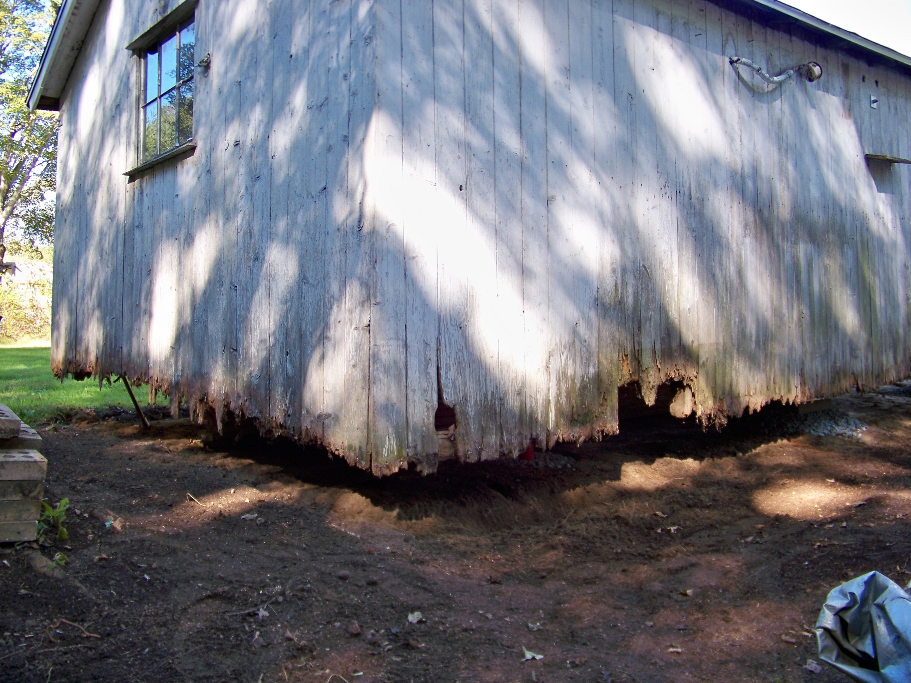

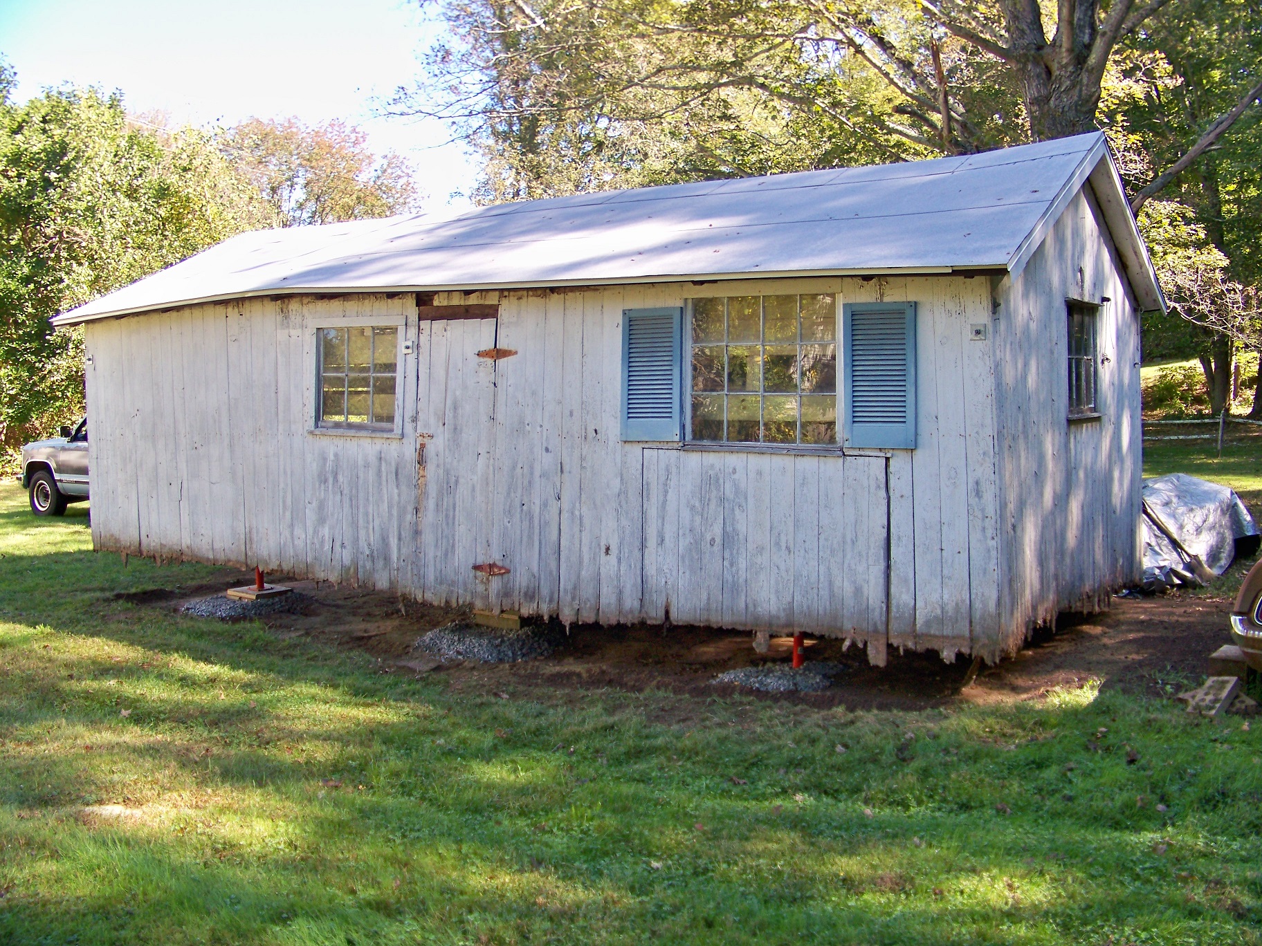

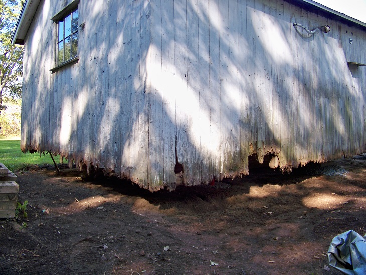

Thanks all for the encouragement and great rodent extermination advice. As ambenz said, it's not always convenient to stop and take pictures of everything I'm doing. Especially during trial and error steps.

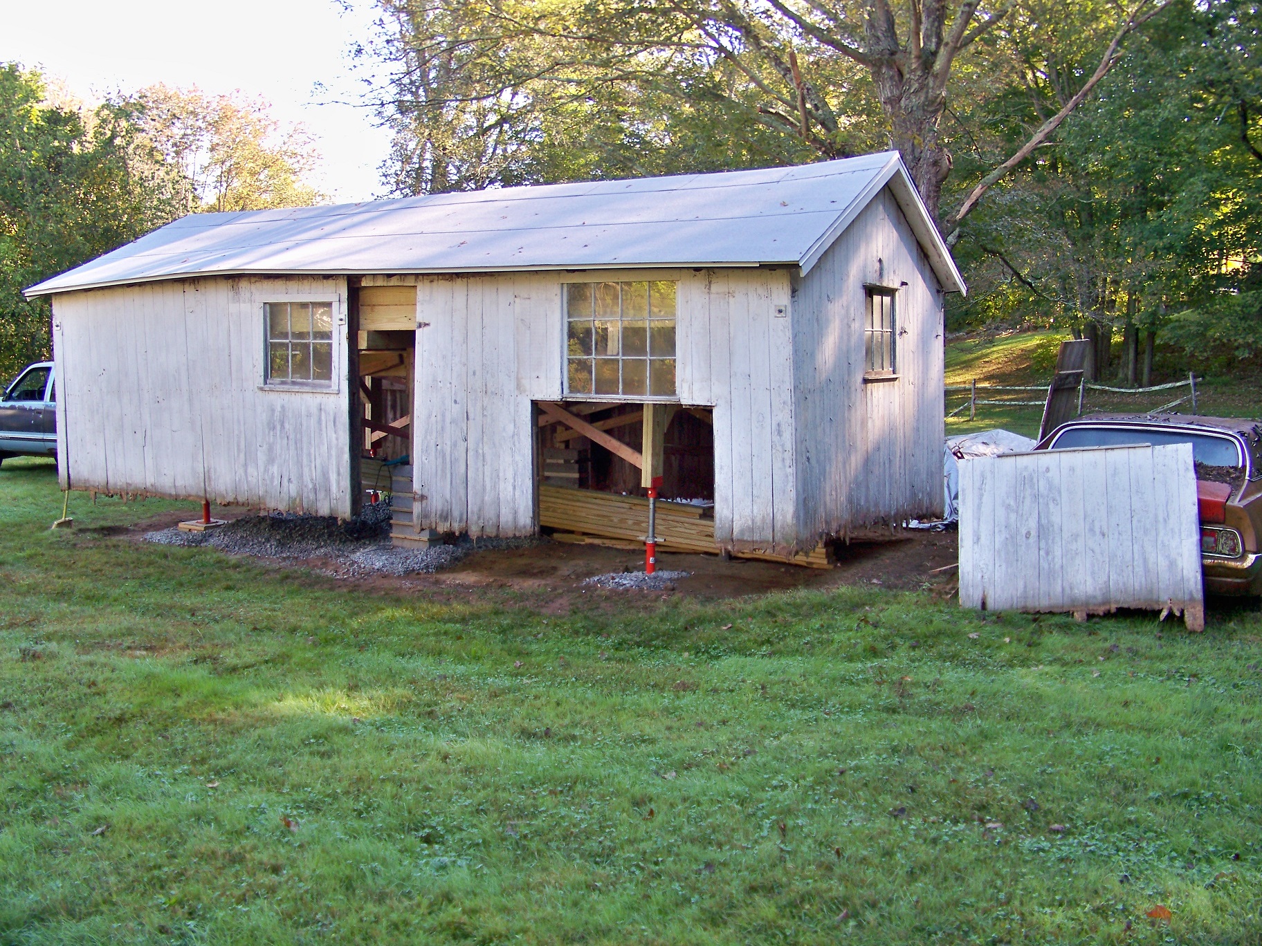

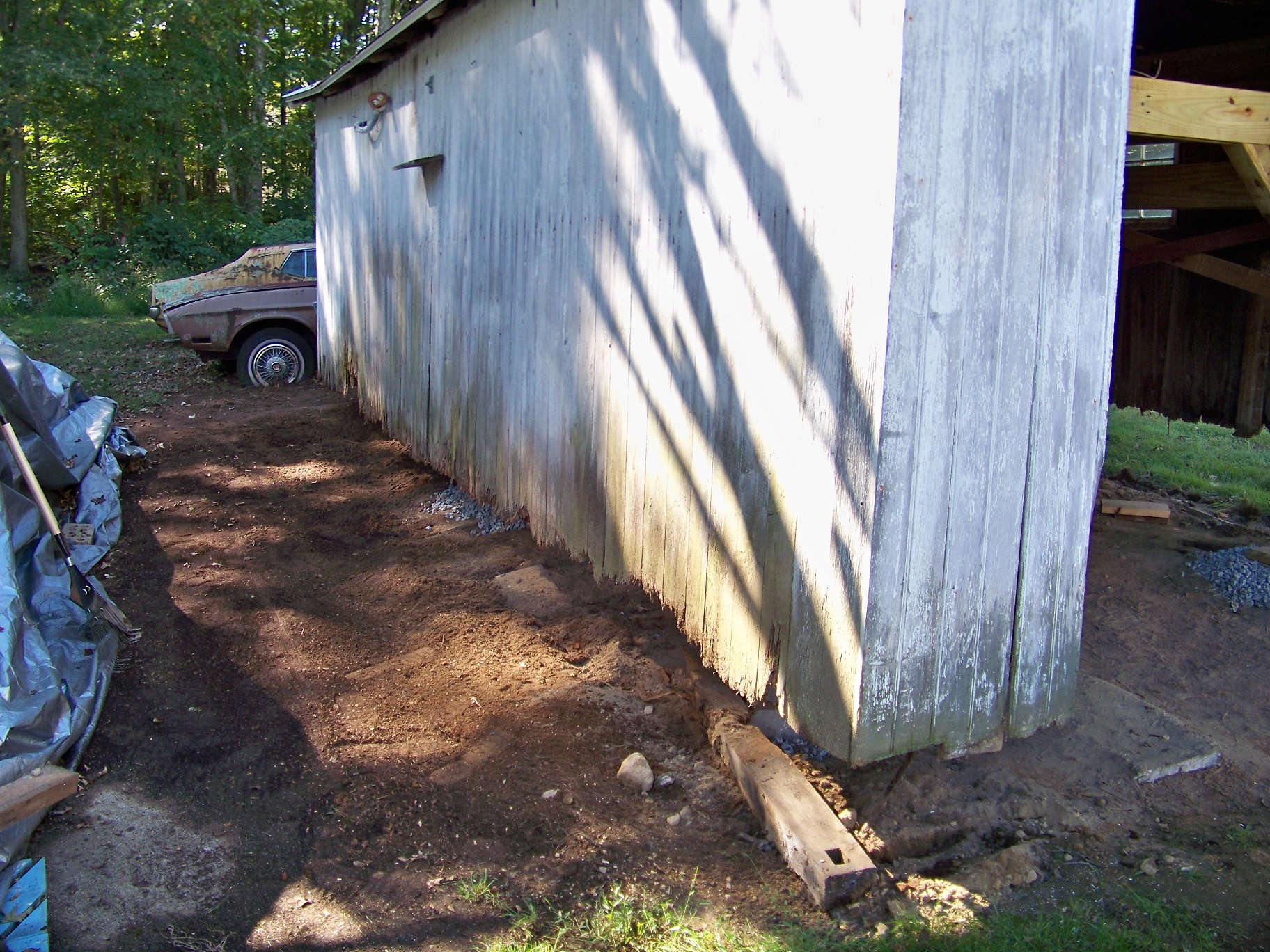

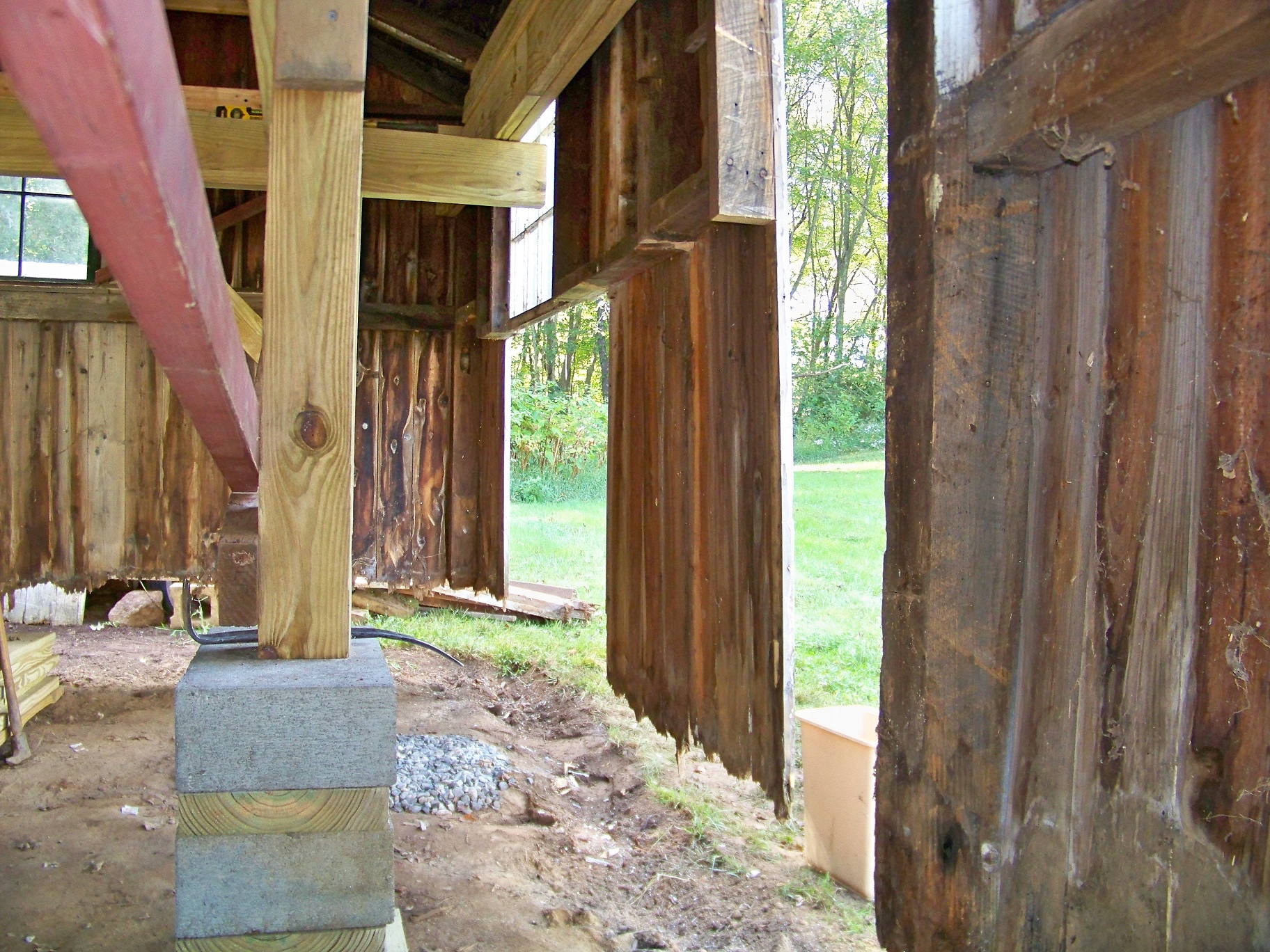

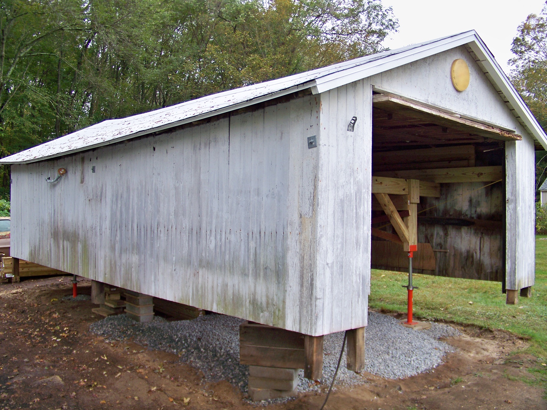

Progress Pics from Monday 10/2/17:
Cleaned up all the leaves and debris around the shed.
Removed any remaining sills on the structure and dug up the rotting wood in the ground. Also removed the lower 45° supports.
Having a very hard time getting the outward bow from the wall with the man door. Tried using ratchet straps = When tied to the lifting frame the lifting fame moved. When tied to the opposite wall the opposite wall moved. Used 12ft 2x6s wedged on the exterior at an angle which kind-of worked, but the man door now bowed out even farther than before.

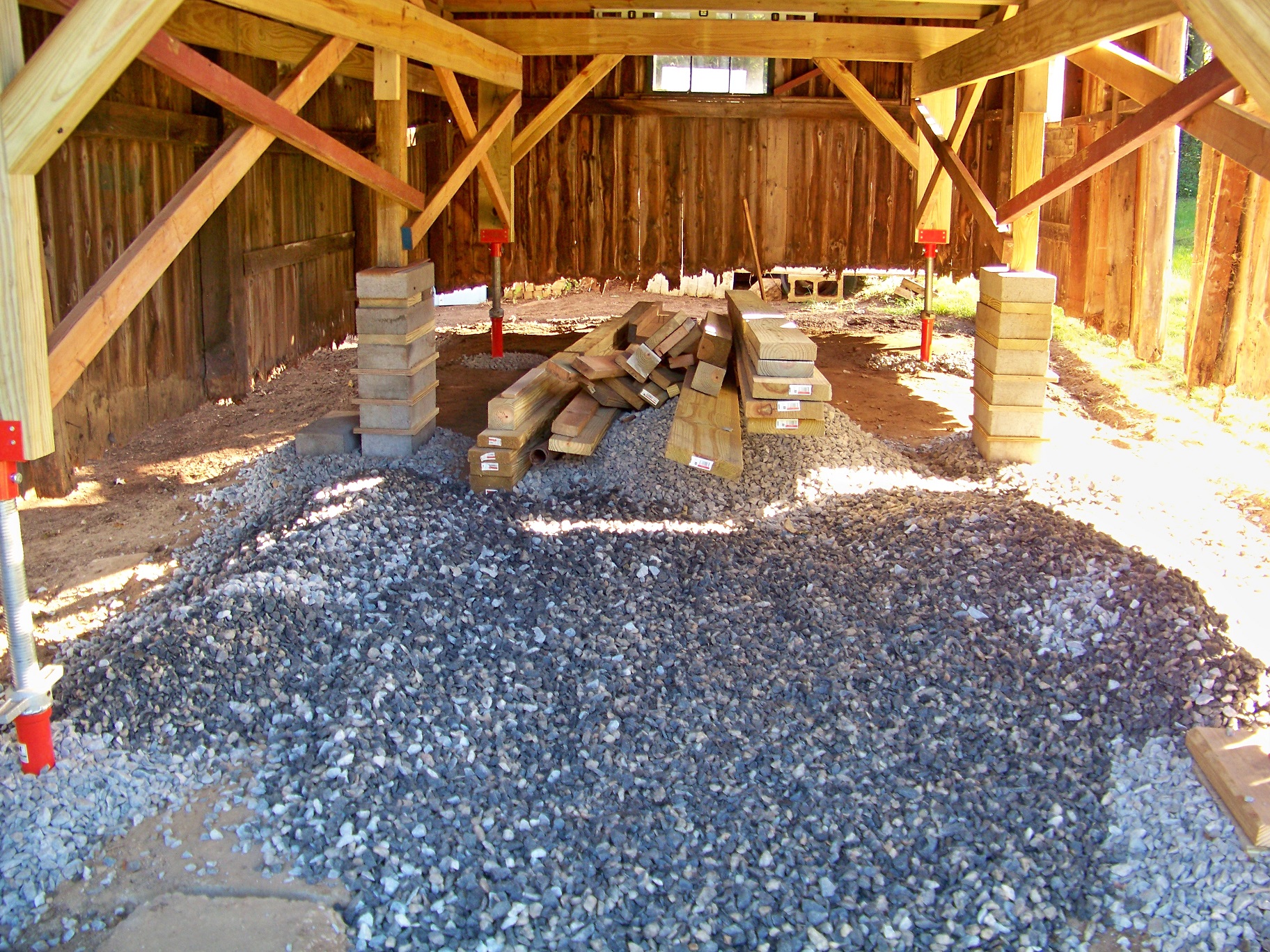

Shoveled another ton of gravel out of the pickup.
Came up with a theory as to why to wall won’t move. The man door was likely installed after the wall was already deformed. Then later someone nailed it shut. Removing the door seems to have helped.

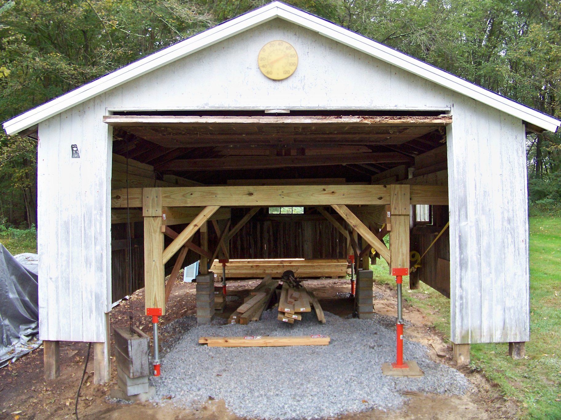

If that is rolled roofing, I'd level the building and roof when I set it back down. I don't believe it'll undue your roof repairs?
At 14 and 21 inches, I'd back the hay wagon and move it to a new location

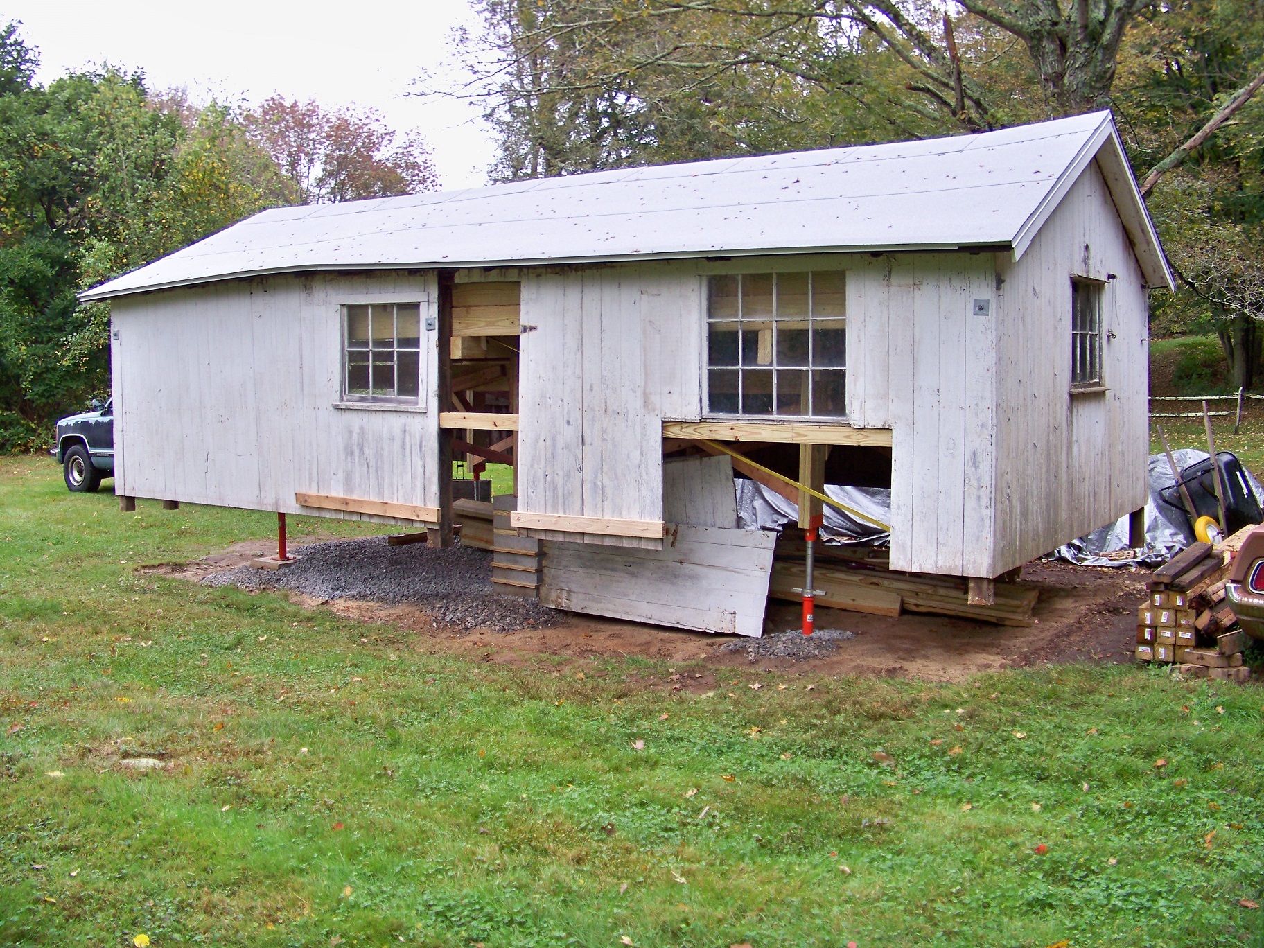

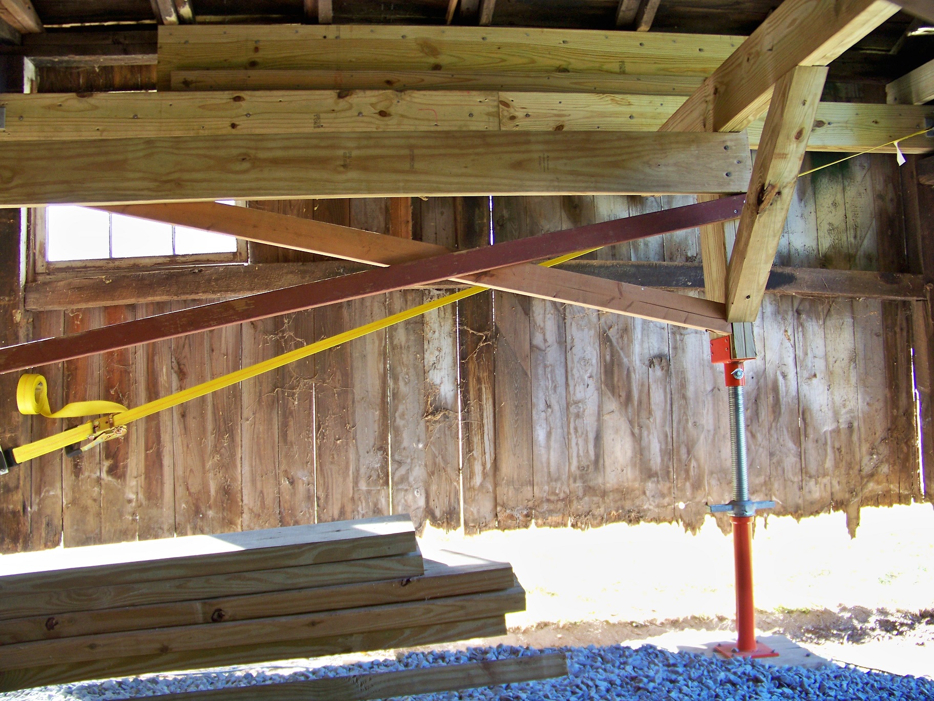

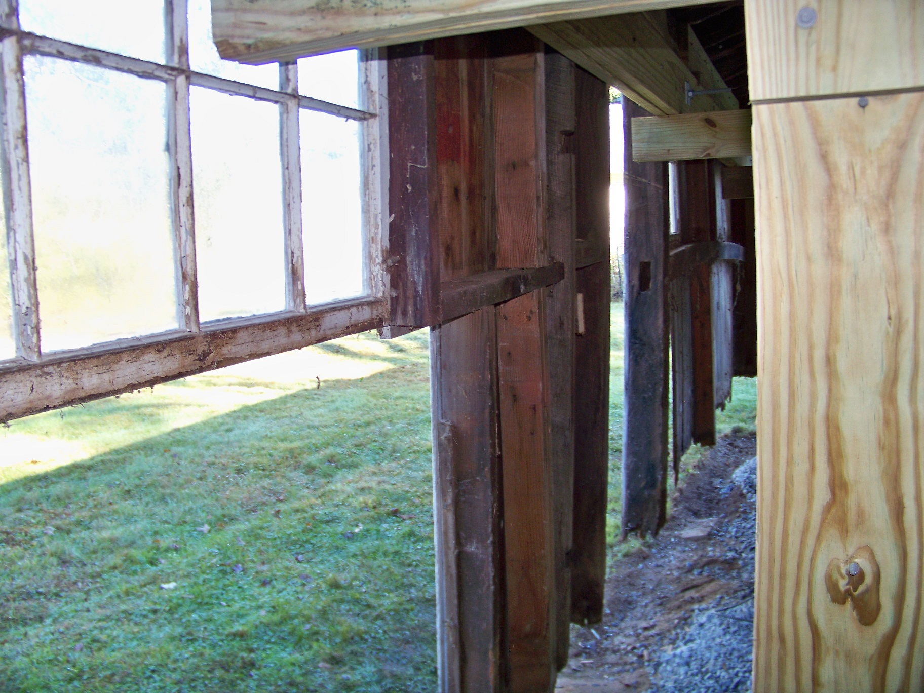

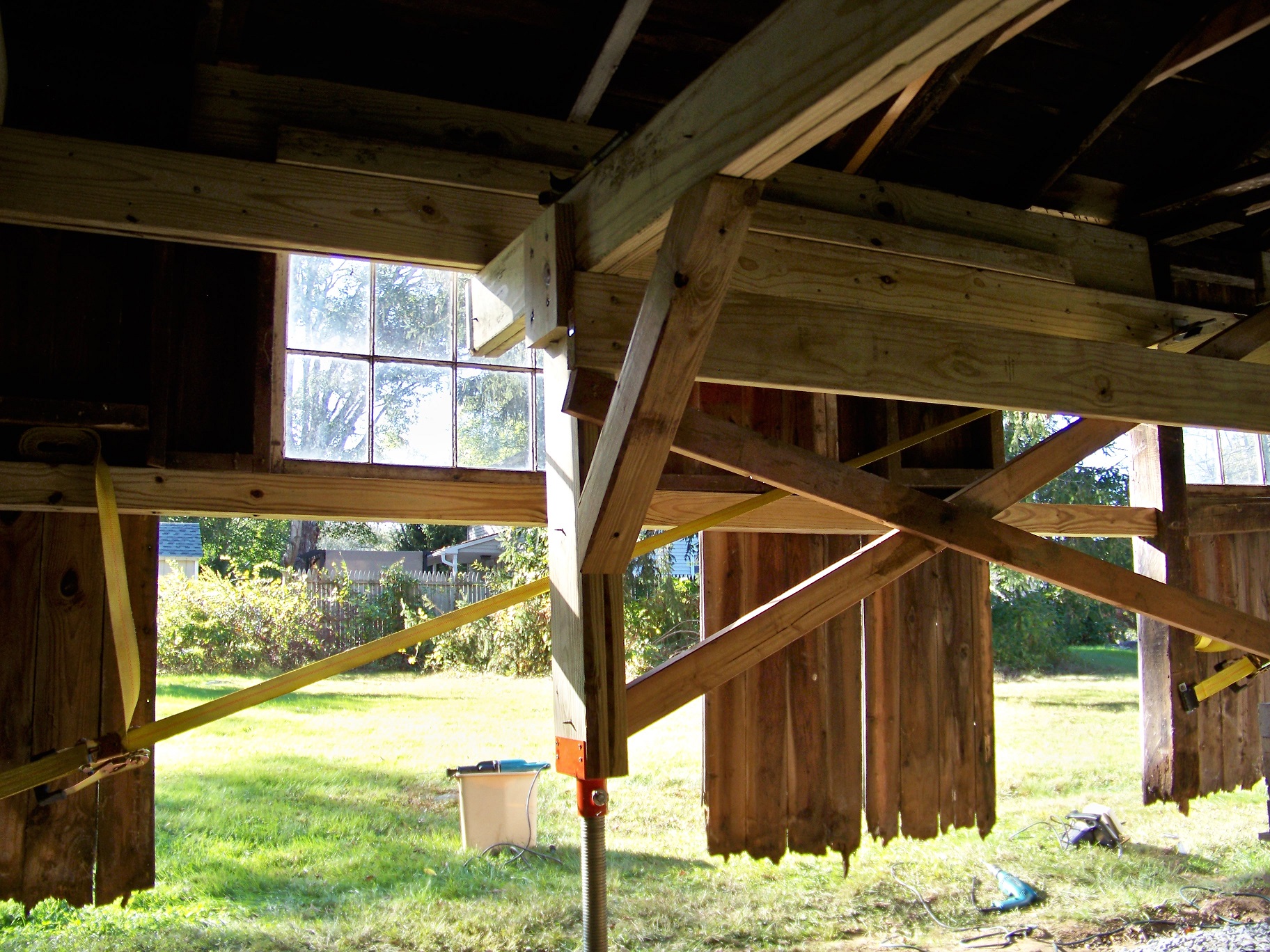

Progress Pics from 10/3:
To further improve my chances of straightening the wall, I removed the other odd access door under the window which, like the man door, was also nailed shut.
all pics linked to larger image

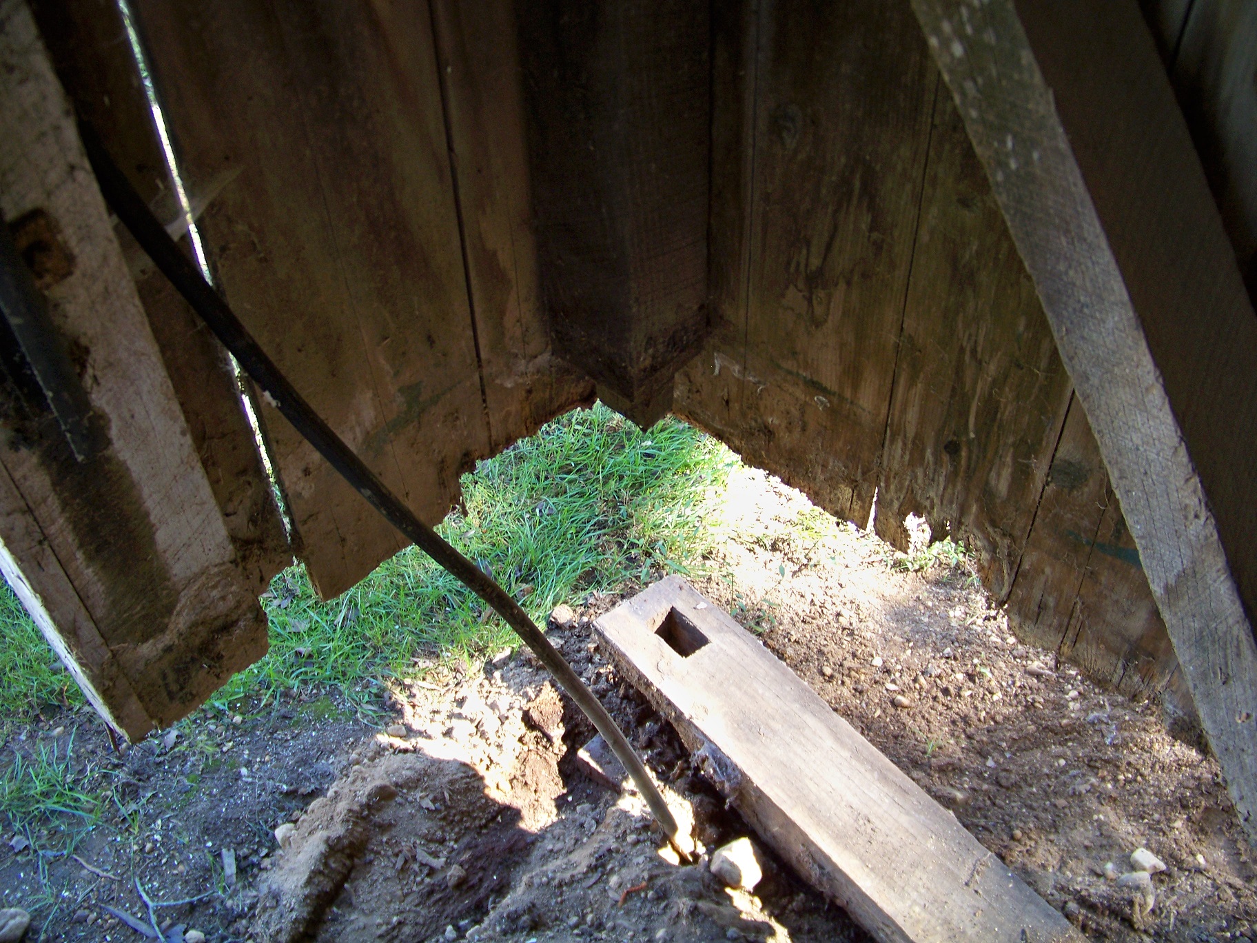

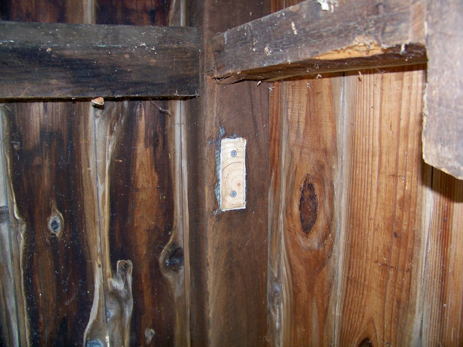

Under the man door trim I find a mortise, which I expected as there’s an open mortise in the opposing corner column. Keeping in mind that this structure has very few posts and beams, every one of them is critical to its stability. Someone decided to remove a center beam and install the 2 doors which seriously compromised the structure.
Cut the various 2x4 posts.
Filled the mortise joints with some perfectly sized (1 3/8 x 4) hardwood pallet wood I had lying around.
Installed a new 12’ 4x4 beam where it belongs.

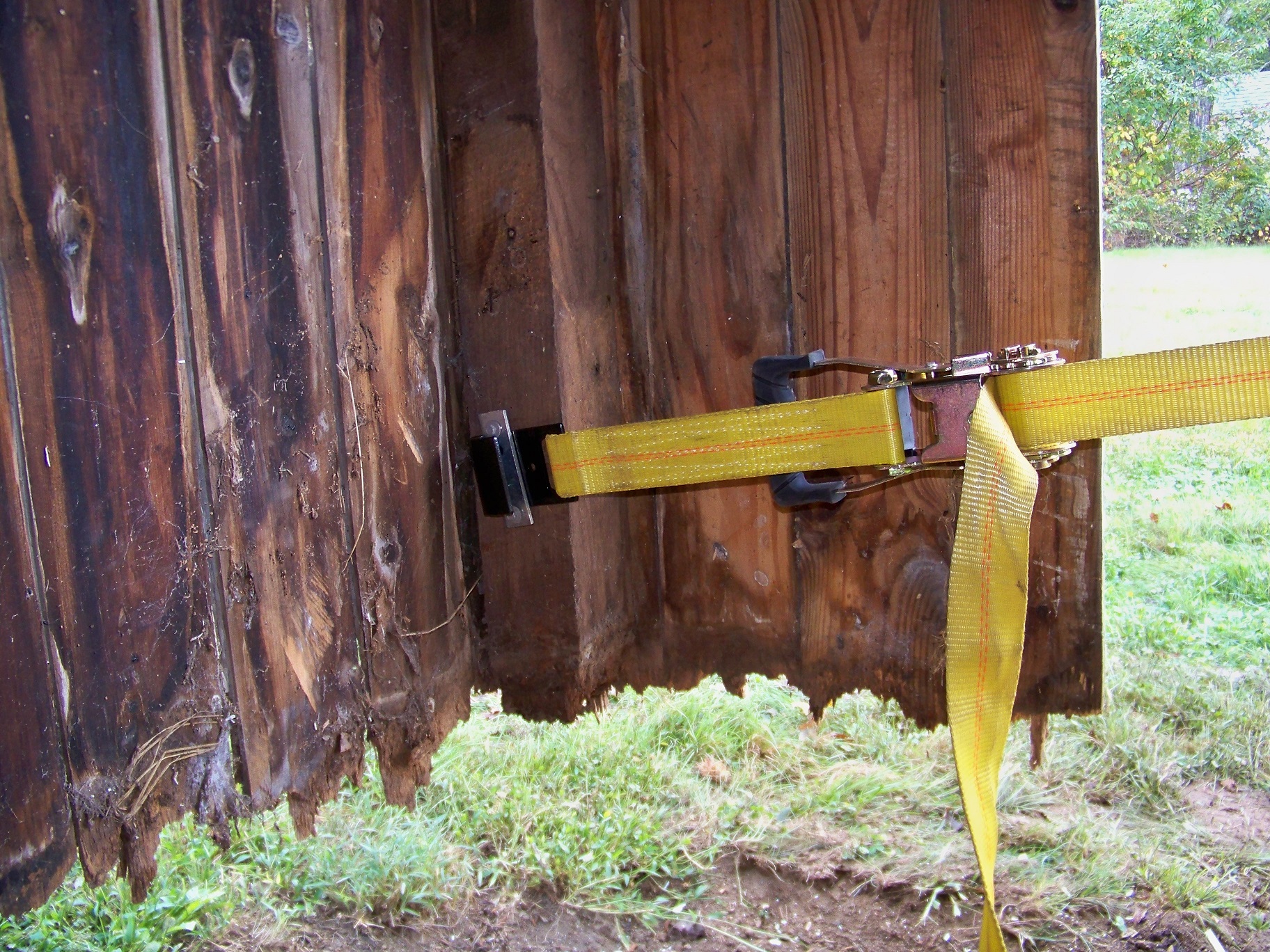

Attached ratchet straps to persuade the structure into compliance. The other end is hooked onto the 5/8" threaded rods.

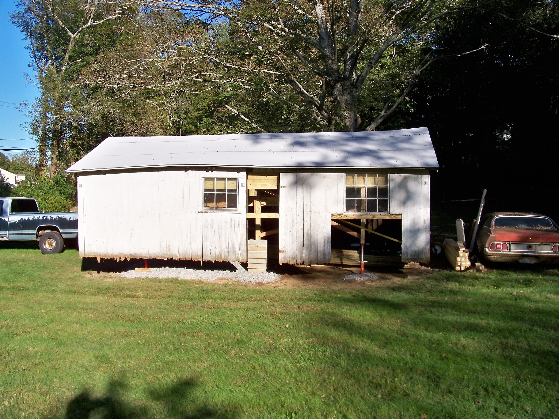

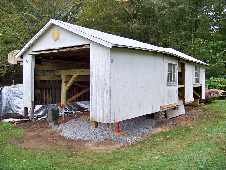

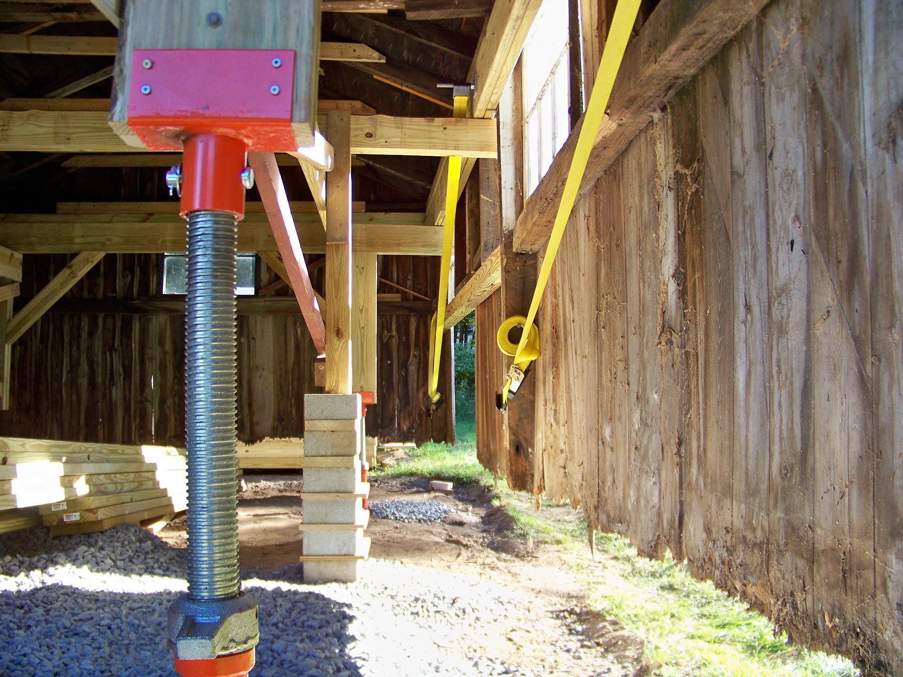

Progress Pics from 10/3 continued:

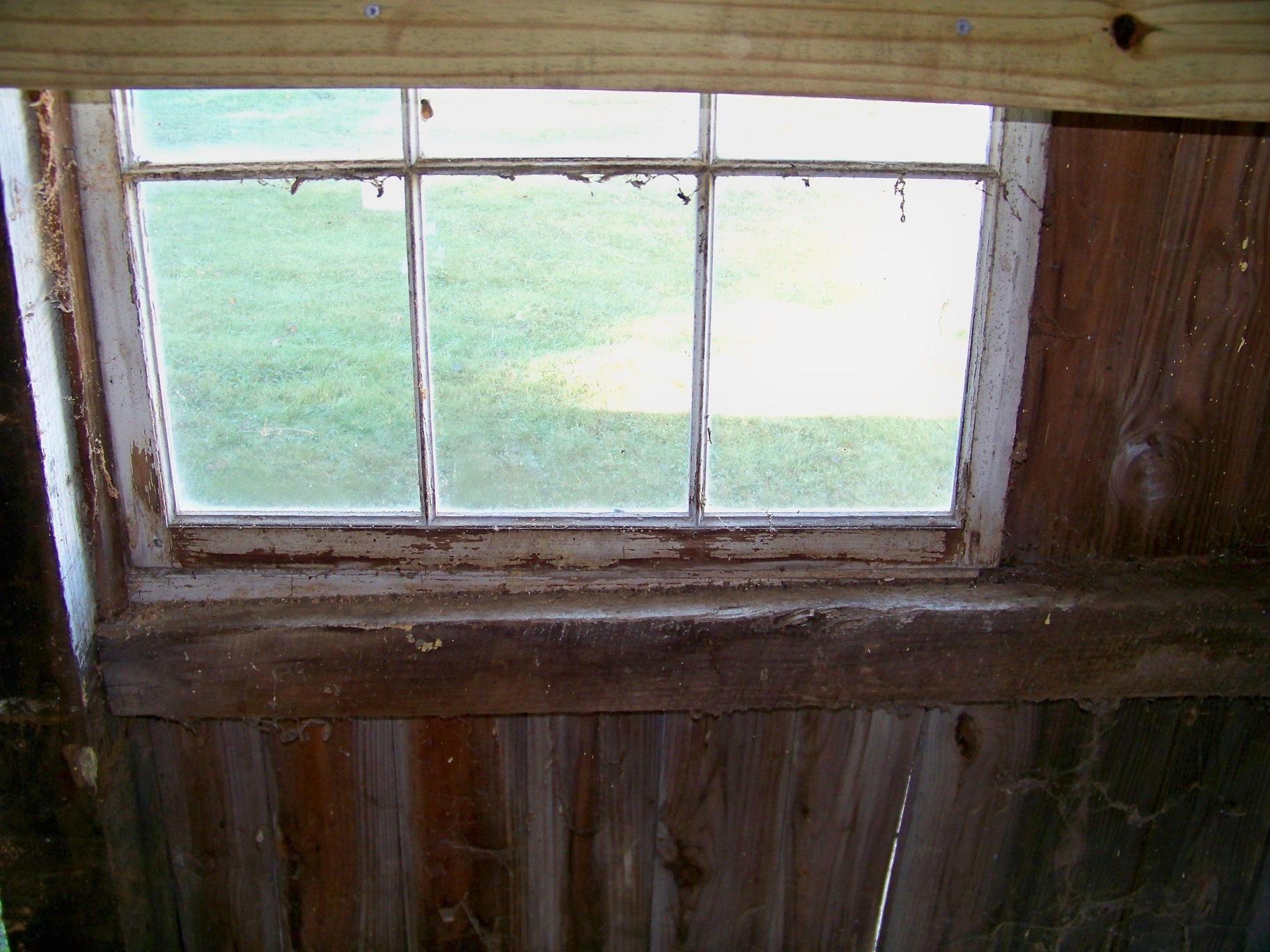

I noticed something else - After cleaning all the debris away yesterday I don't see any newly reformed vole holes! :rocker: It would be nice if that's all it takes to get rid of them. Meanwhile the chipmunks seem to be having a field day under the giant tarp.

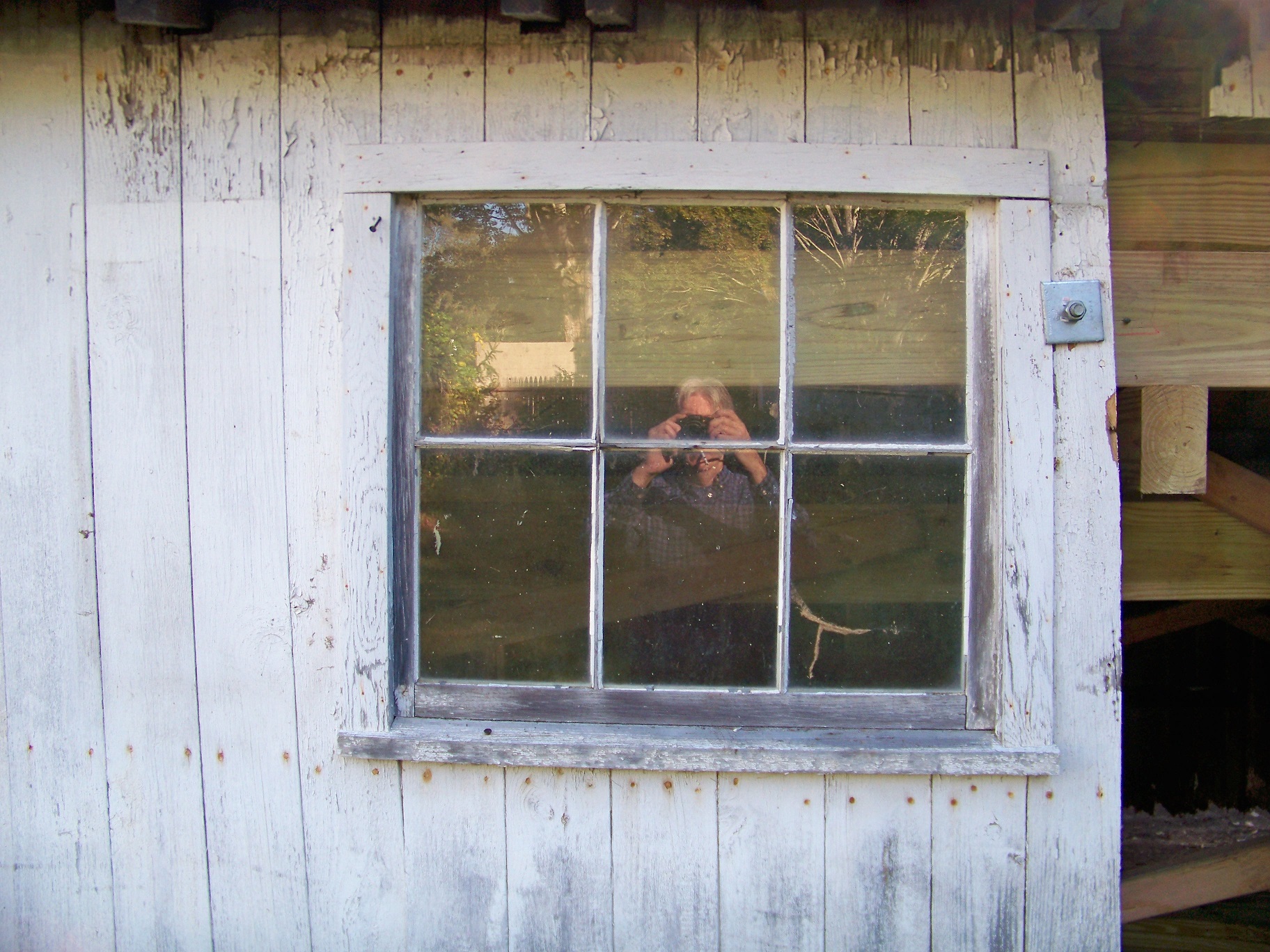

On the wall in below pic you can see how badly bowed the center beam is,
yet oddly, the window sill is level.
Overlooking that I photo bombed my own picture - Even though the overall building is now square, including the window, you can see how the siding to the left of the window is not even. I’ll be chalking that up as another character feature.

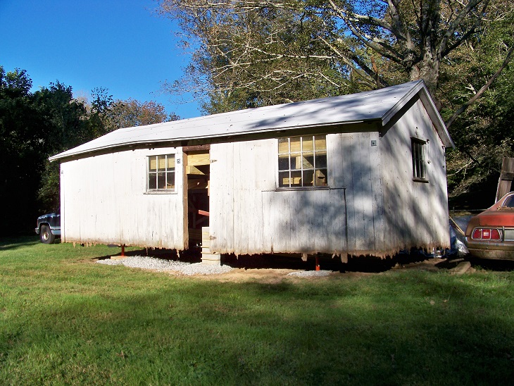

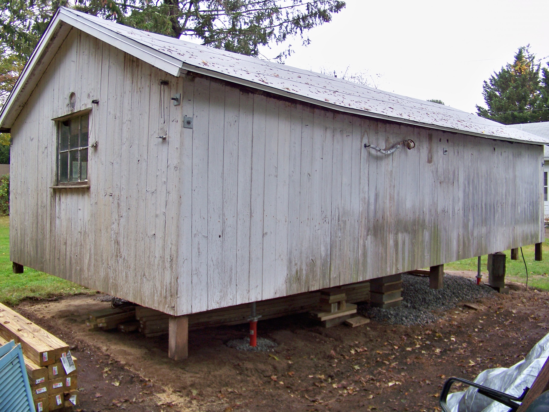

Progress Pics:
The first time I cut the bottom siding, yesterday, I only cut the bad stuff off and each side was a different height. Once I was done I realized I should have cut everything the same height, so I went back today to fix it. Had to screw some 2x4s to the siding to make it flat. Posts have also been trimmed.
I've decided to use 4'x8' x 3/4 PVC Sheet (link) on the bottom. Just need to learn best handling practice. At $100 per sheet I don't want to make any mistakes.

That new cut line at the bottom looks too straight!
What's left looks easy. You just need to build a base with a straight and level top plate.
I actually have to check all the dimensions again. I started out with my laser level which is fine if you're dealing with a normal square structure, but this is far from square. Not that I have any desire to cut everything a third time, but rather than cutting the bottom level, I'm wondering if I should just measure the exterior 4 corner wall heights and make them all equal - connect the dots - snap a line and cut it that way. I had to re-cut the front so the siding immediately to the left and right of the garage doors is equal. This is actually more difficult that I expected - maybe if I made a reasonably level gravel floor I'd have something better to gauge from.
The lifting frame has developed some arch at the ends so the building isn't as square today as it was when I first lifted it. Well... "square" is probably an overstatement. Let's just say it was less crooked in all directions.

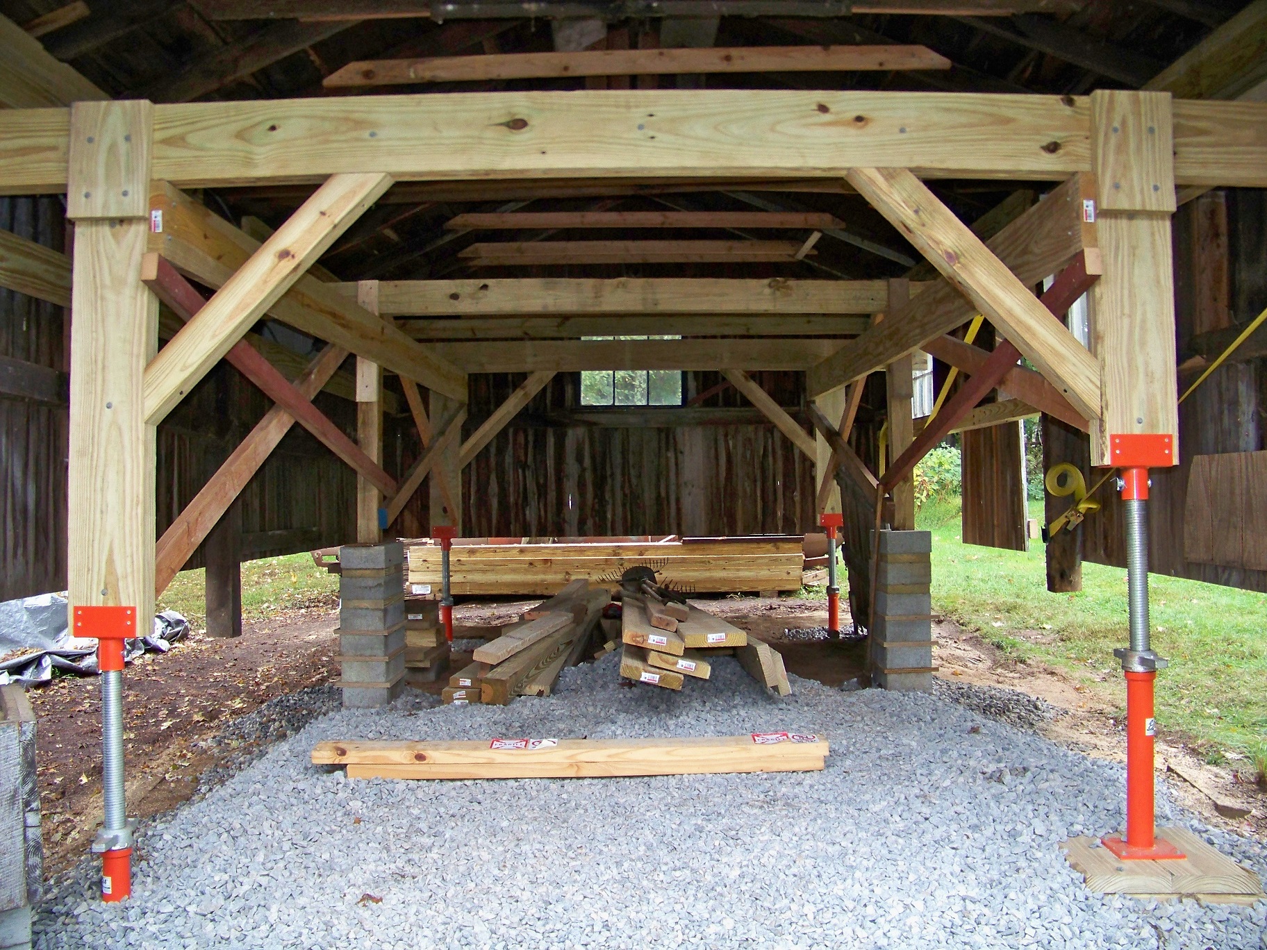

Change of plans! Cause nothing is really set in stone until it's actually set in stone. I purchased a cement mixer this morning. Looked at the HF one, but the reviews were so bad I opted for this $300 one at Lowes:
Plan now is to use six 12 inch sonitubes at whatever depth I can reasonably dig to. I've watched 1 video and read 1 web page on how to do this, so I must be an expert (NOT)! :)
I'm not spending $400 for a rebar cutter/bender, so I'll dig the holes first and see what lengths I need and purchase accordingly. No I'm not likely to dig down the 42+ inches to get below the frost line, but we'll see how it goes.
The plan for wood is to install three 12ft 6x6 PT beams the width if the shed onto the cement columns using these:
Then put two 12ft 6x6 PT length wise each side, to get the 24ft needed, on top of the aforementioned 6x6 perpendicular beams.
Attach framed floor to first set of 3 beams.

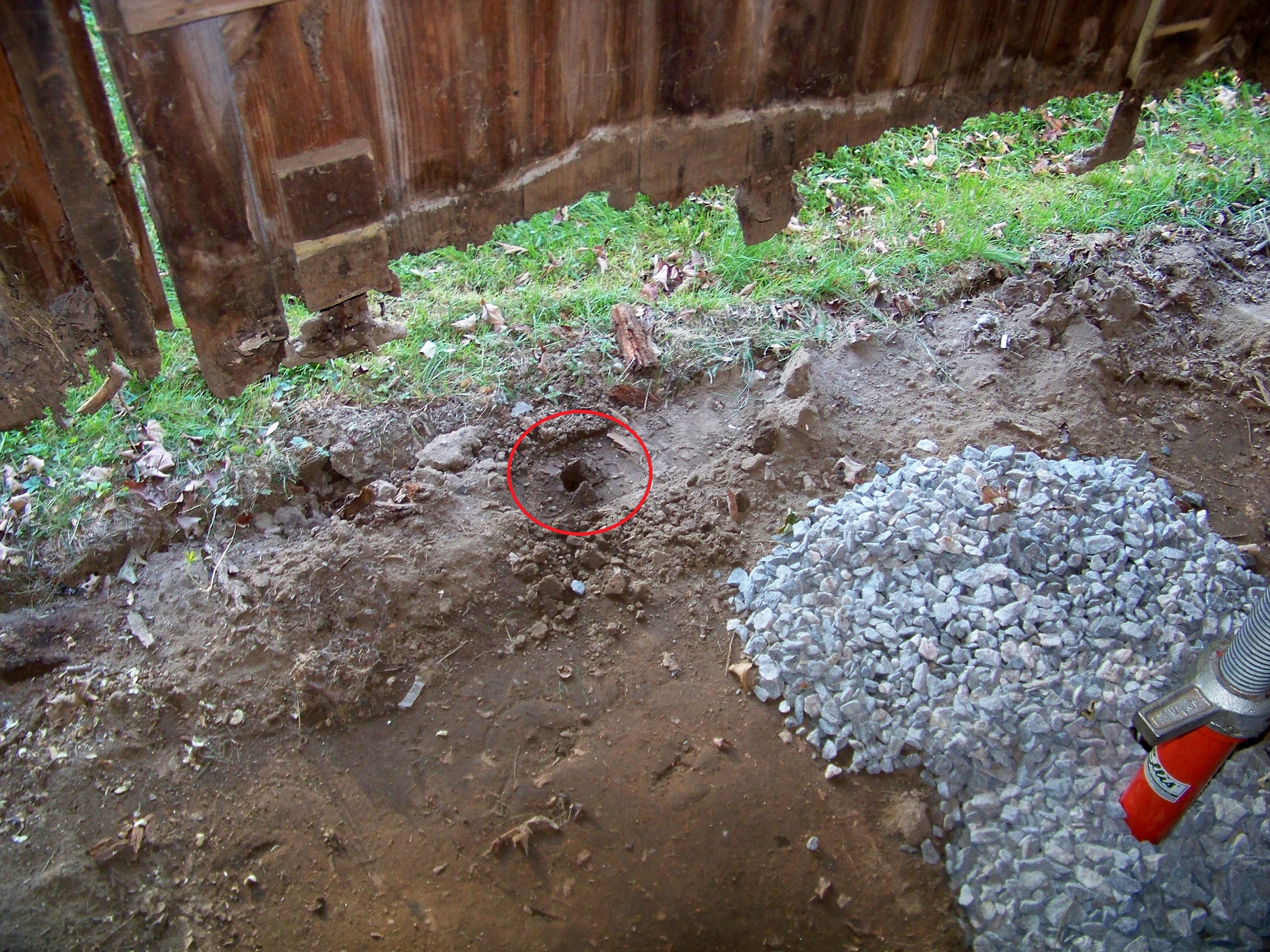

So I saw the culprit making holes and nests today. My best guess is it's a vole. Saw him disappear down a hole, so a took the rake and filled in the hole and stomped on it. 3 hrs. later the hole was back. Not sure how to get rid of these things.
Next step - Cut the bottom off.
Pour ammonia down the hole. It is heavier than air and will asphyxiate the little buggers.

ambenz mentioned putting ammonia soaked rags in the holes. I suppose pouring it directly in the hole achieves the same result. I'll deal with that after I'm done. OT - I used to design blue print machines which use high strength ammonia. I remember hooking up the ammonia pump check valves backwards on a machine which created an amazing ammonia waterfall in the engineering lab.

Unless you have a few extra 6x6s that you want to use, I think they're overkill for this job. I'd use them on a shed that would be moved someday, or one that was just resting on the ground, but not the rat shack.
For the bottom of the walls, I'd recommend using a couple of PT 2x6s instead, attached to each other with galvanized 12d sinkers. You can use two sets of three 8 footers for each wall, and stagger the joints to span the 24' length of the wall.
For the cross beams, I don't think they're really adding anything structurally, except they will keep the bottom of the walls parallel. You could use something cheap for that, like PT landscape timbers or 2x4s. Or concrete 'grade beams' with rebar in them (if you decide to keep the mixer). But you might not need them at all if you run your floor joists across the width of the shed -- they'll keep the walls parallel a lot better than 3 cross beams.
The floor joists can be tied into the base of the walls on each side with joist hangers. If you do that, you might want to use double 2x8s for the base of the walls.
