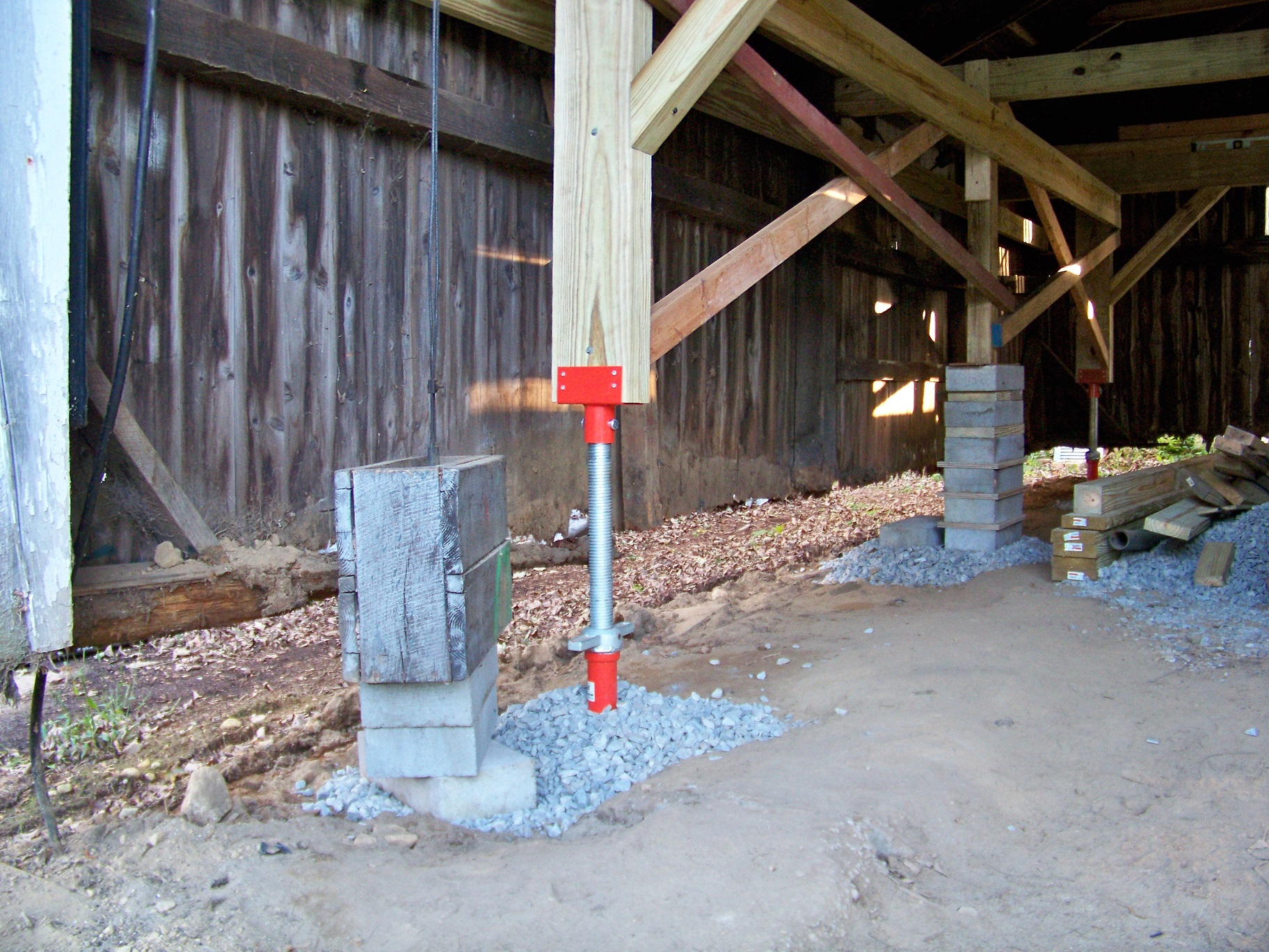

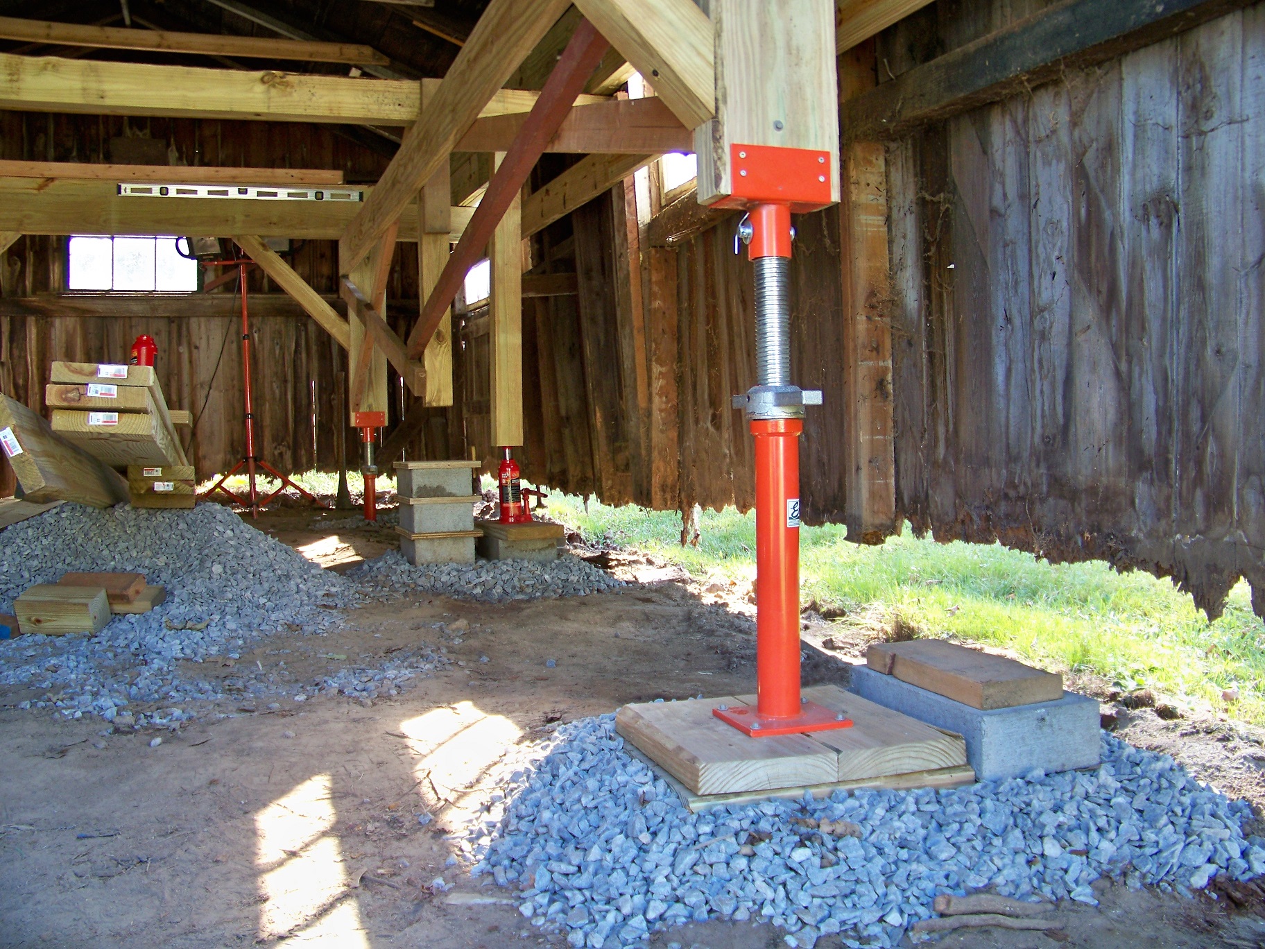

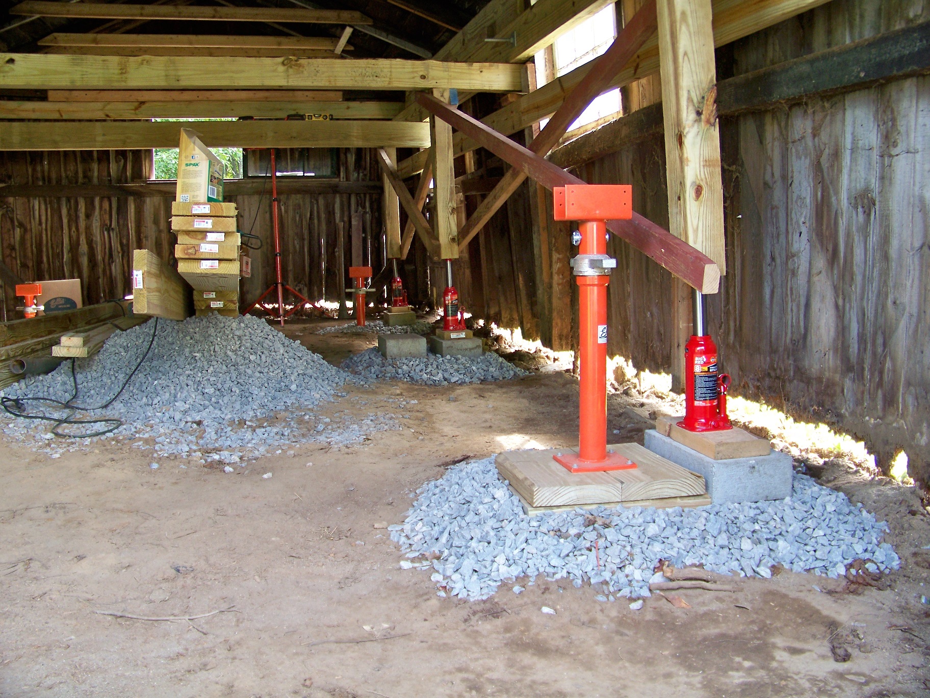

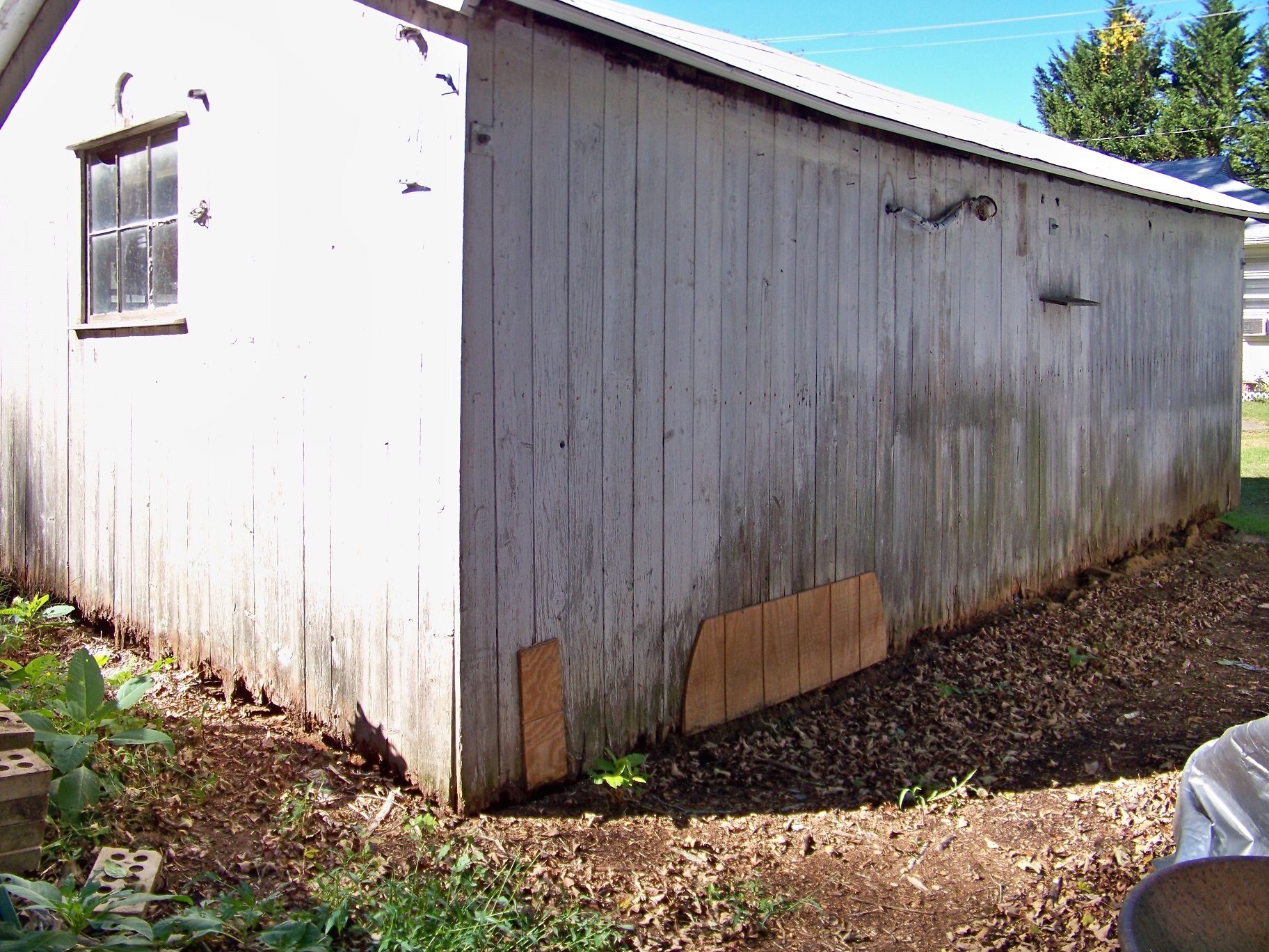

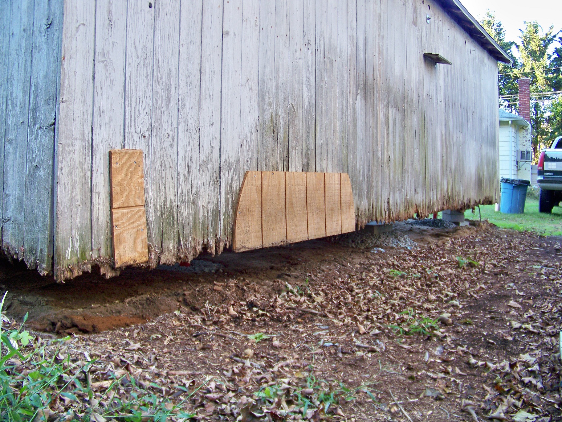

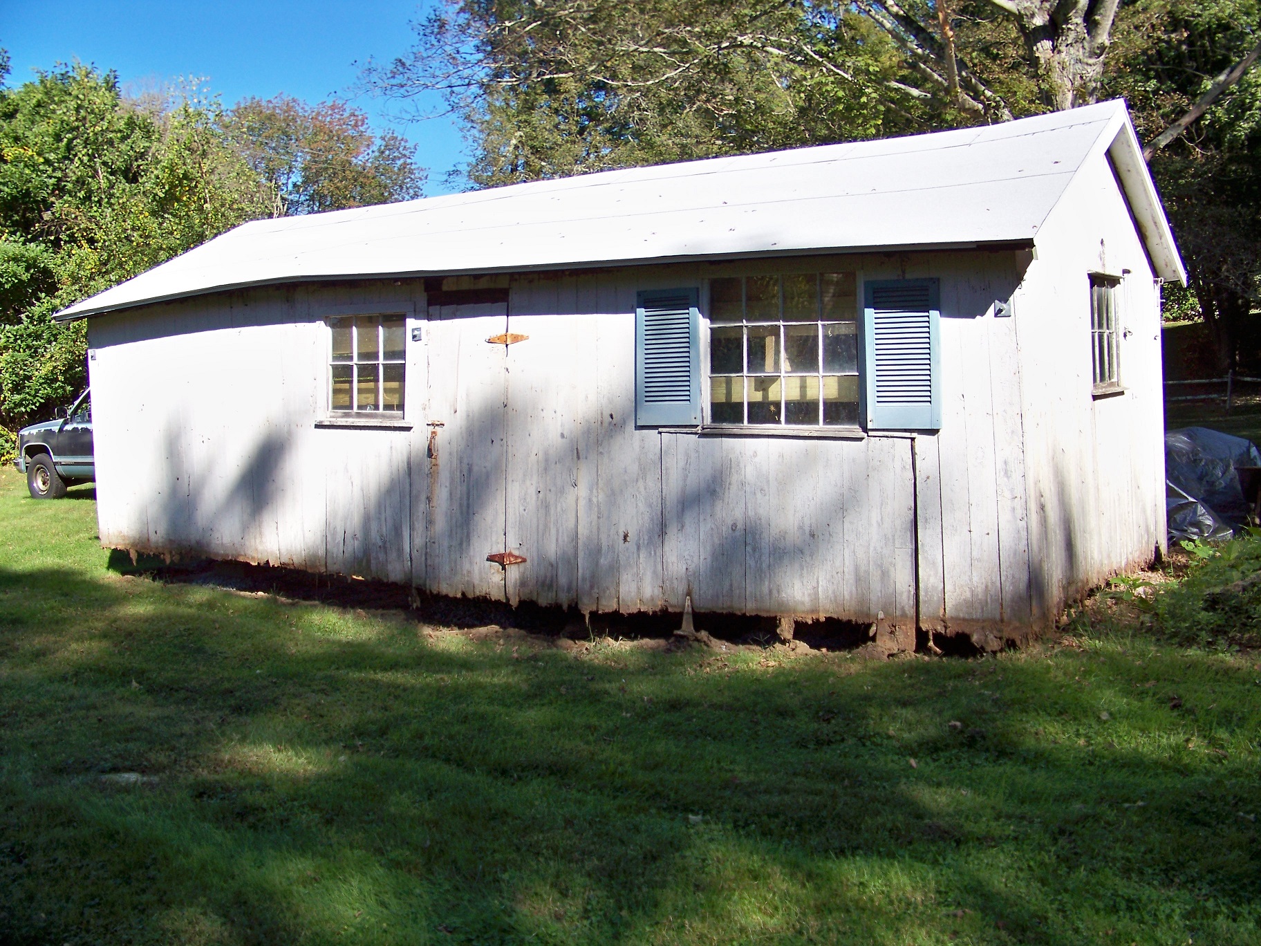

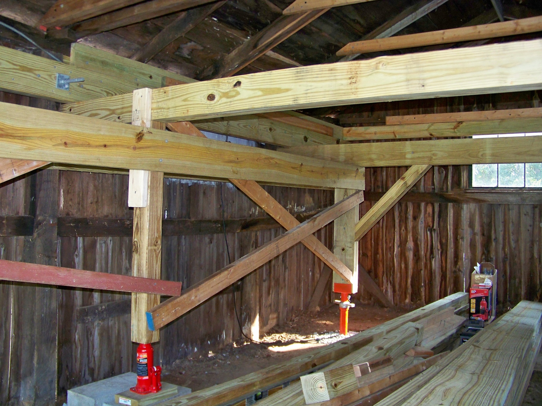

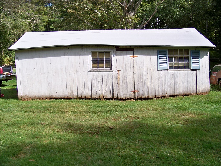

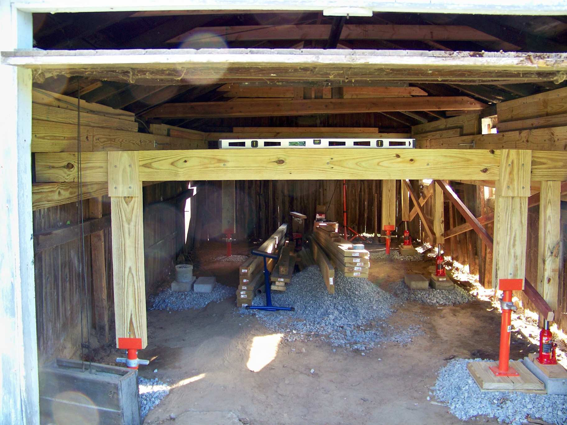

Progress Pics:
My high precision plumb bob (it's an old window counter weight hanging on a small ratchet strap).
This is the first raising stage to get the 3 lifting beams level. The max lift range of the jacks is 9 inches and that's exactly what I needed to level it. I went back and forth raising each jack 1/4" at a time. The posts on the bottle jacks are not physically attached to the beams, but I figured cross bracing would be a good idea anyway. The structure didn't complain much at all and everything remained remarkably stable.

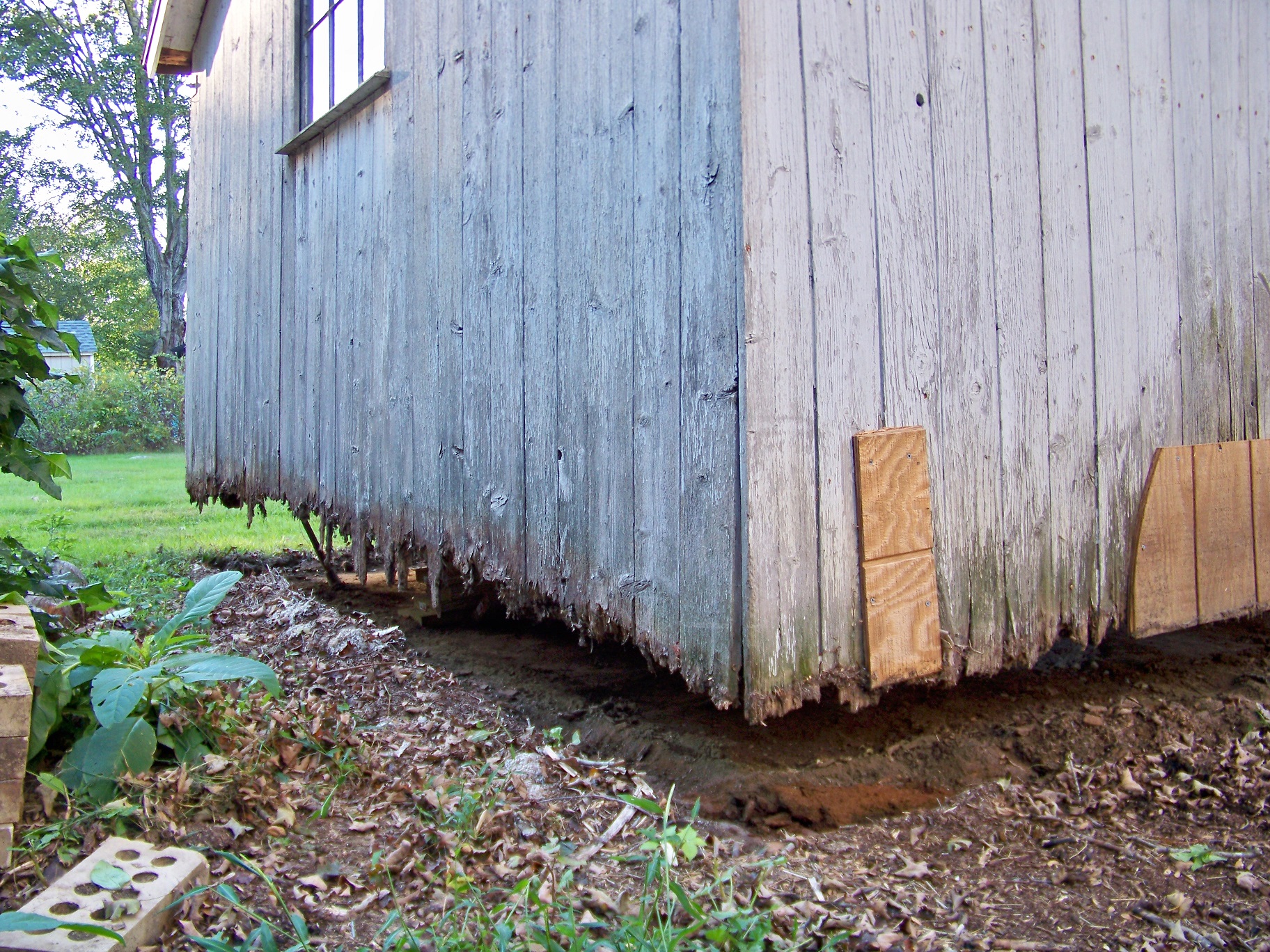

forAK - At the moment I'm thinking: Cut away the bad stuff - fill interior and 1ft perimeter exterior with 3/4" gravel 4-6 inches deep - make new sill with 4x6 pressure treated to sit on gravel - patch 4x6 or 4x4 to existing posts - make pressure treated floor.
I still need to figure out a low cost retaining wall for the gravel. 16 in. x 8 in. x 4 in. Concrete Block is only $1.40 each, which works out to the same cost per foot as 4x4 pressure treated.
Also need to figure out what to put on the lower exterior walls. Some type of horizontal siding would look best.

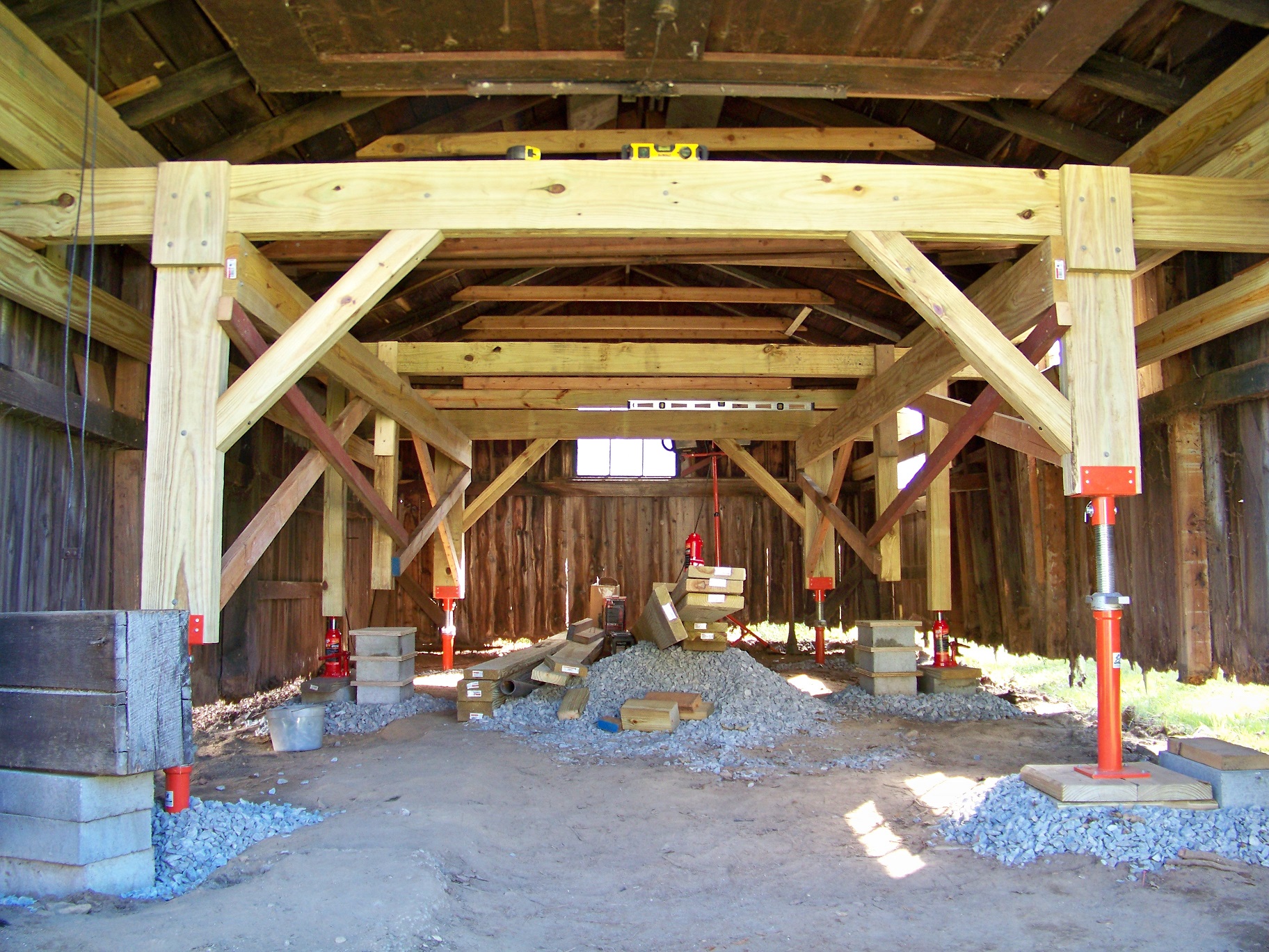

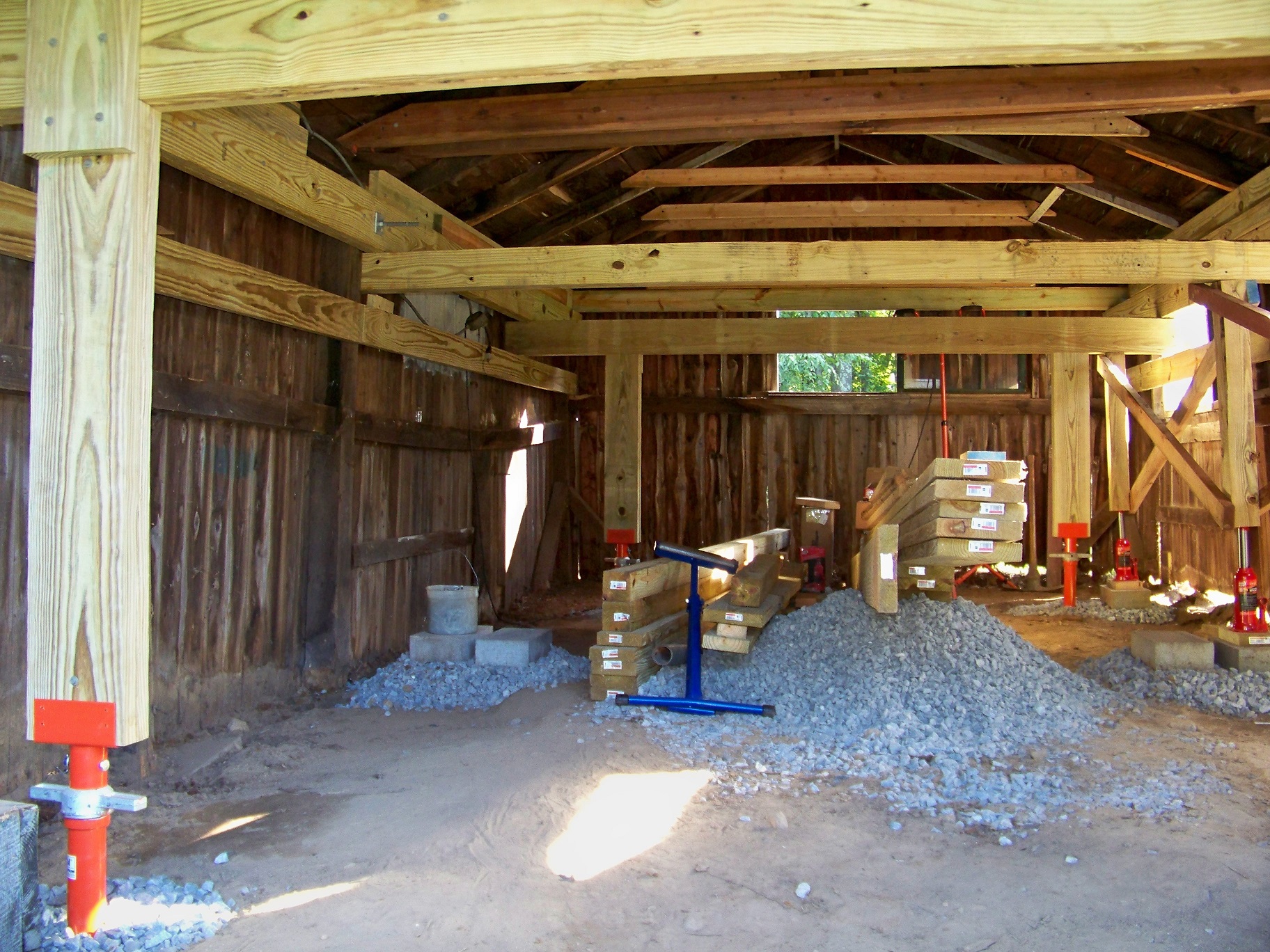

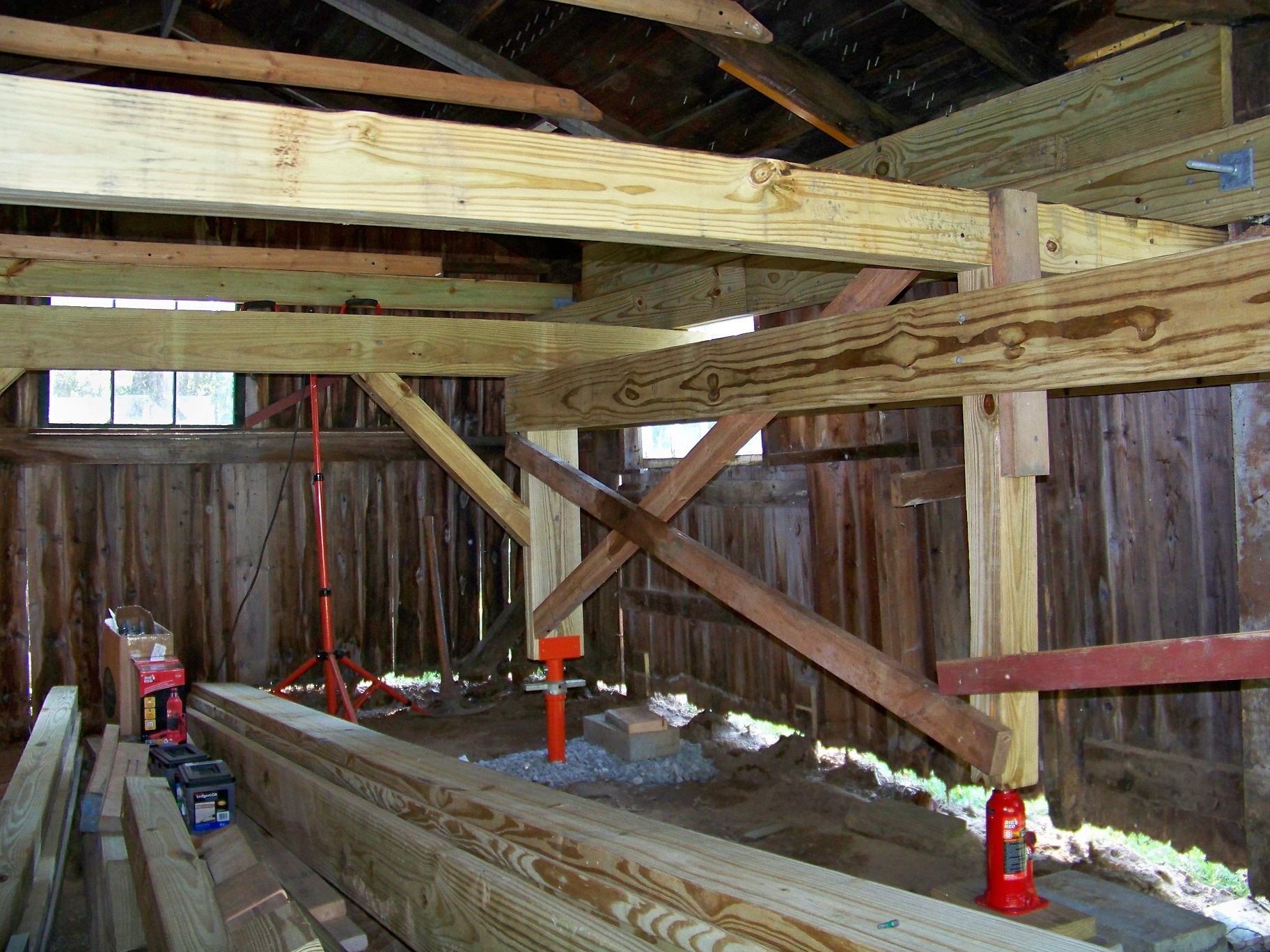

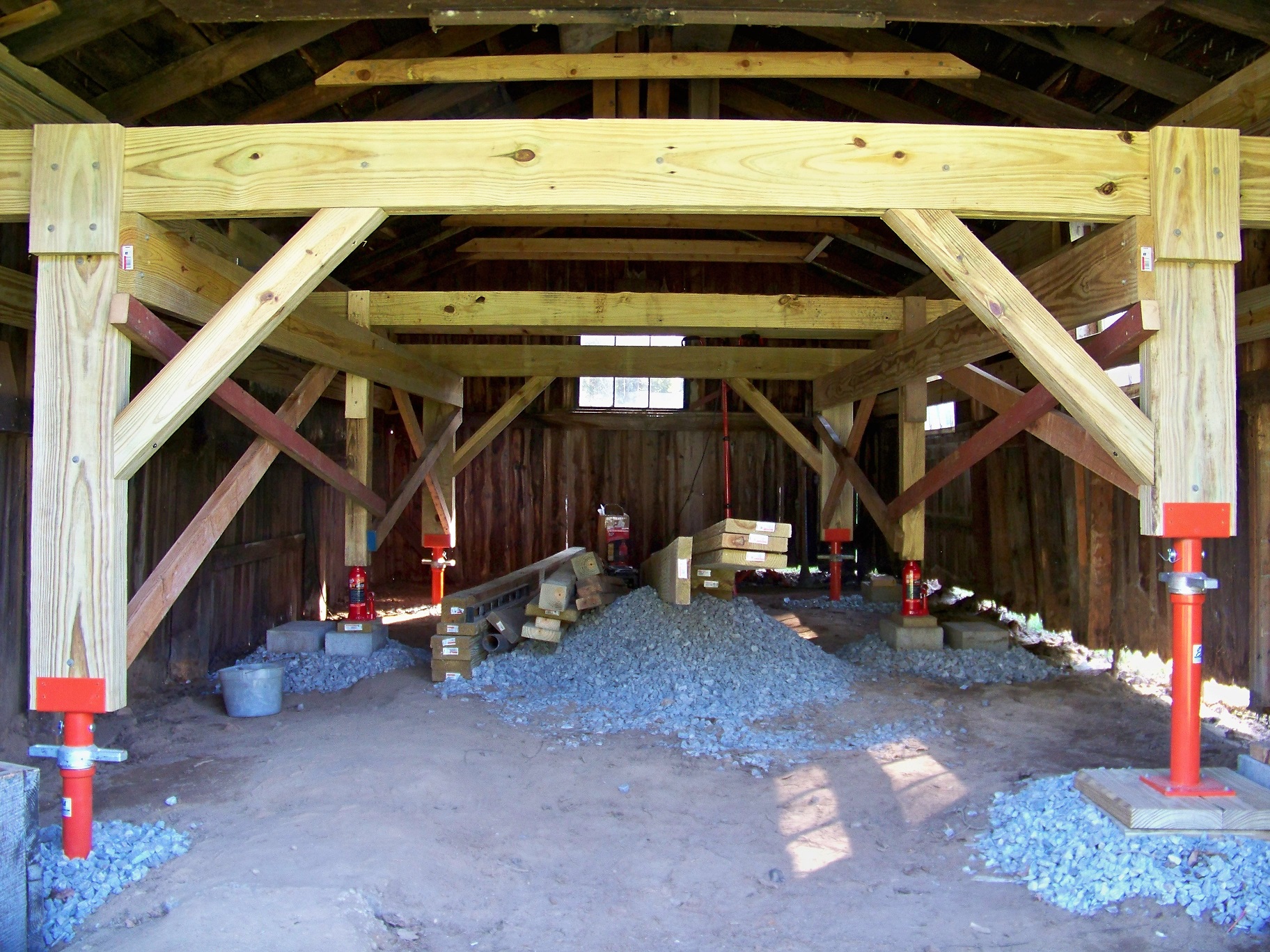

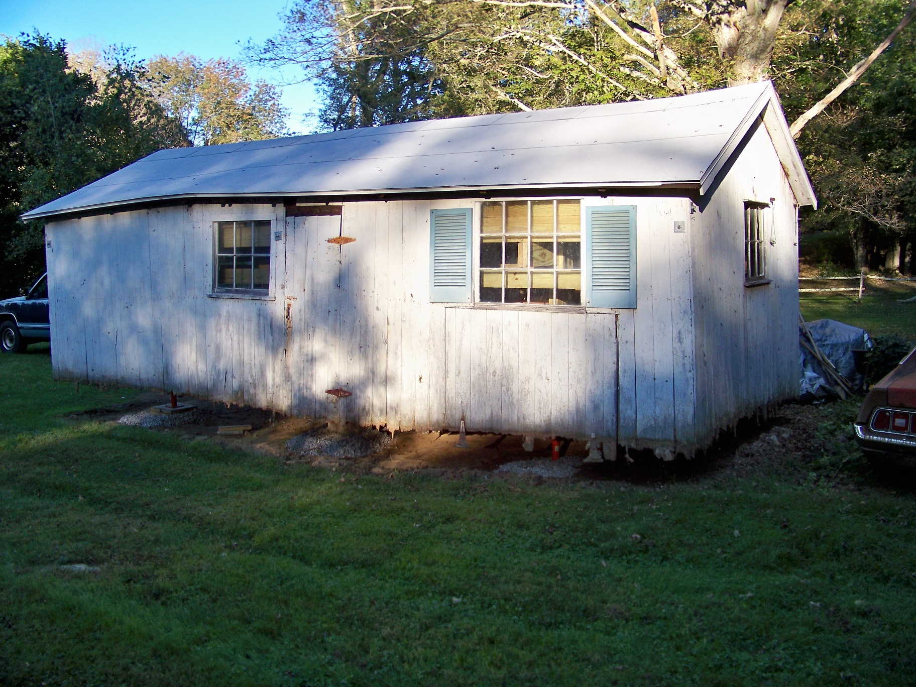

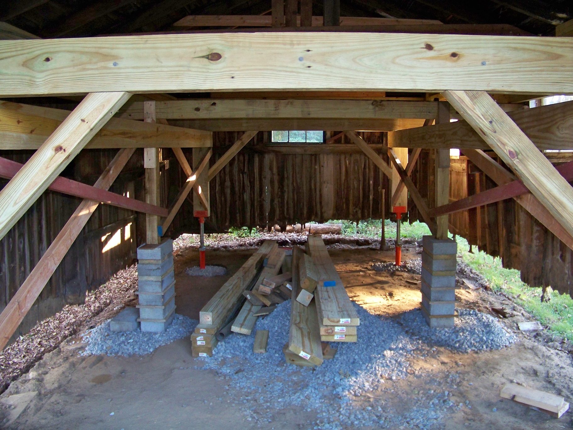

Progress Pics:
I'm officially ready to lift! As much as I wanted to go for it, I decided to wait till next time as there's no point lifting the building and then leaving it up there for a week with no progress. It's also like mid-summer temperatures today and I was starting to slow down from the heat. I debated putting some cross bracing on top, but I'm 50/50 on whether that's really necessary. I've got X and Y direction bracing covered, just not sure about Z. If I add Z cross bracing I'll be ducking even more than I do now during the raising process.

I think you have enough bracing in it!
If it wasn't so hot and you were ready, I'd say "Go for It!"
Take your time, lift it up, shake it a little, seems stable, raise it up and "Git Ur Dun!"

I lifted mine with a single 20 ton hydraulic house jack and a 4x4. I just raised a spot a couple of inches jacking under the top plate. blocked it, and moved a few feet. A couple of laps around the building and I was up high enough to knock out the rotten sill and slide a treated 4x6 under the studs. After that it was toenailing and scabbing studs to the 4x6, and then pour a floor inside.
If I jacked under the top plate the walls would fall off. Do you have pics of your restoration? I assume you had some sill to actually block against. As you can see, I have nothing.

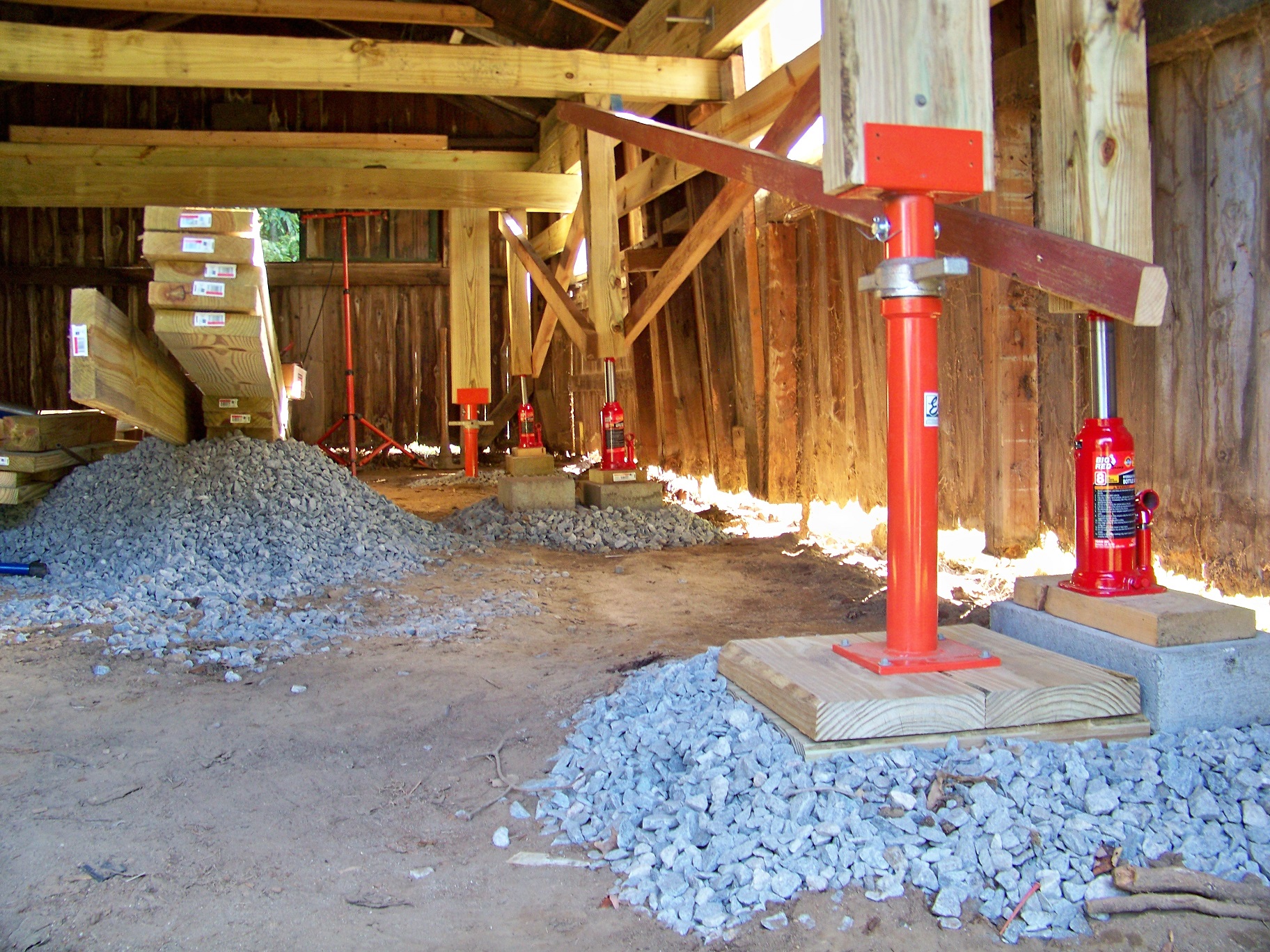

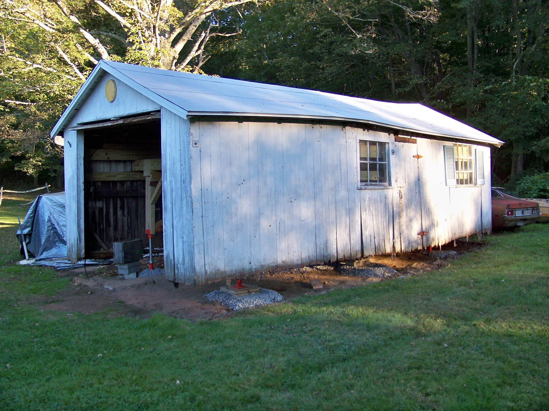

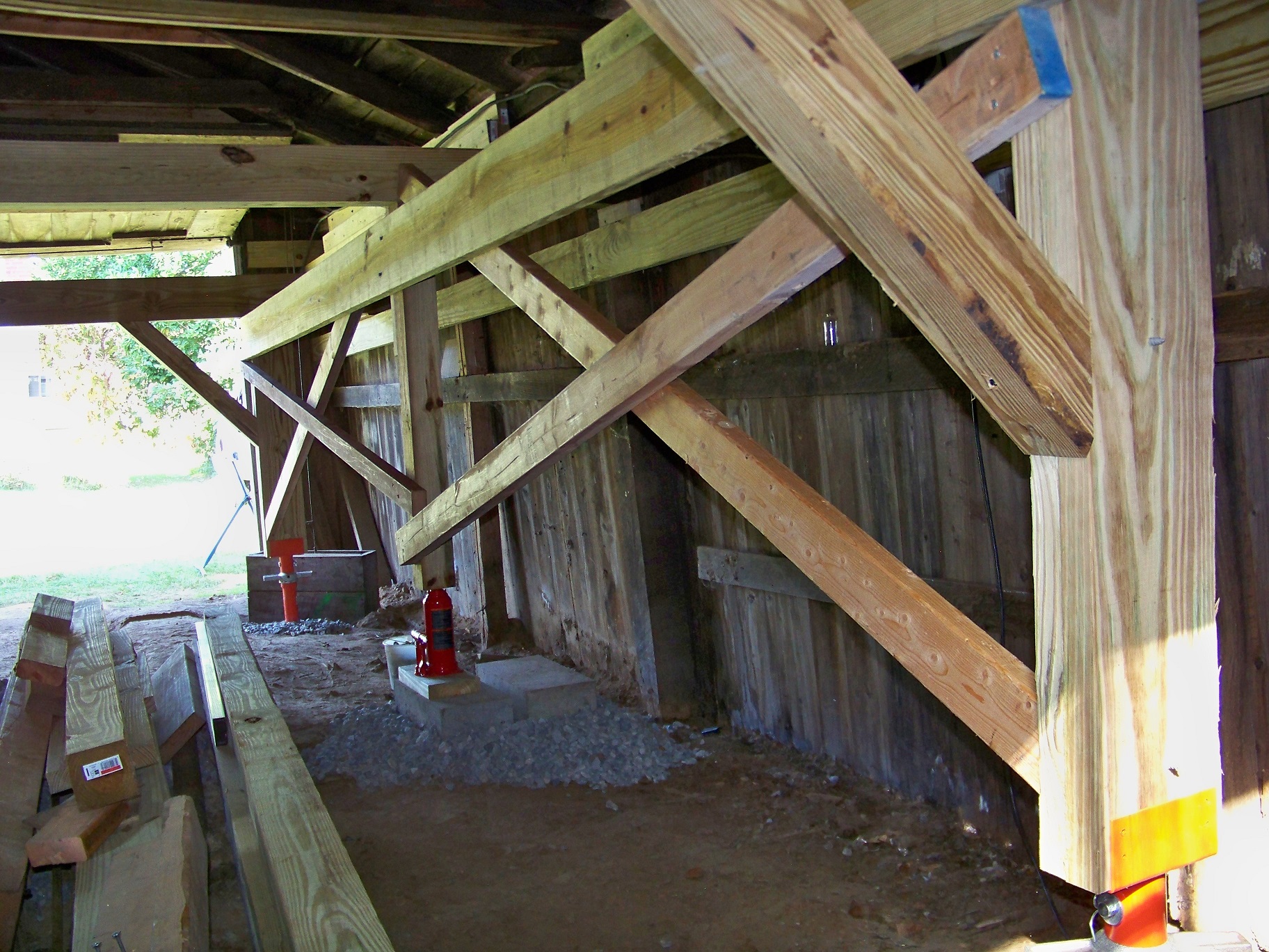

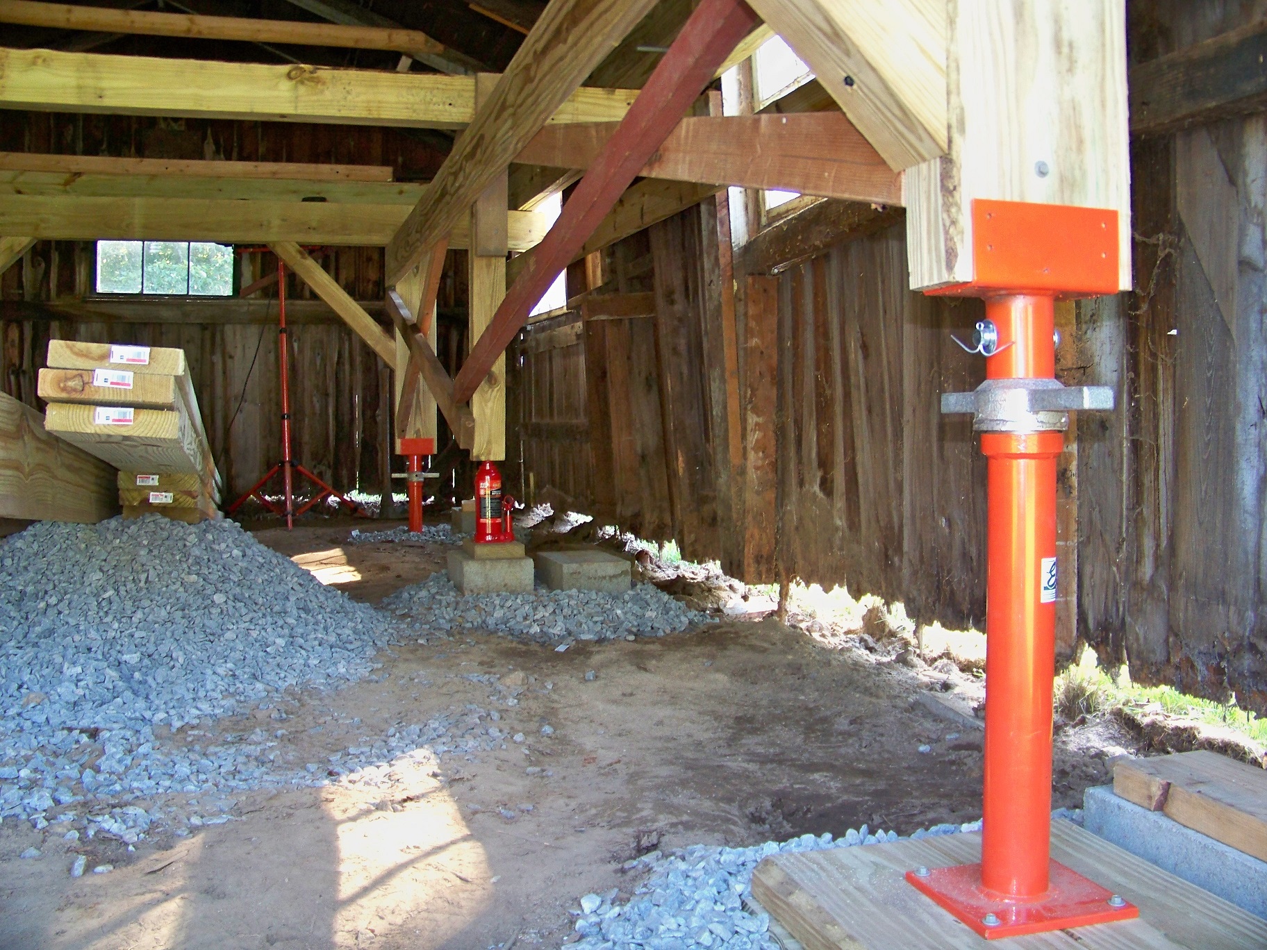

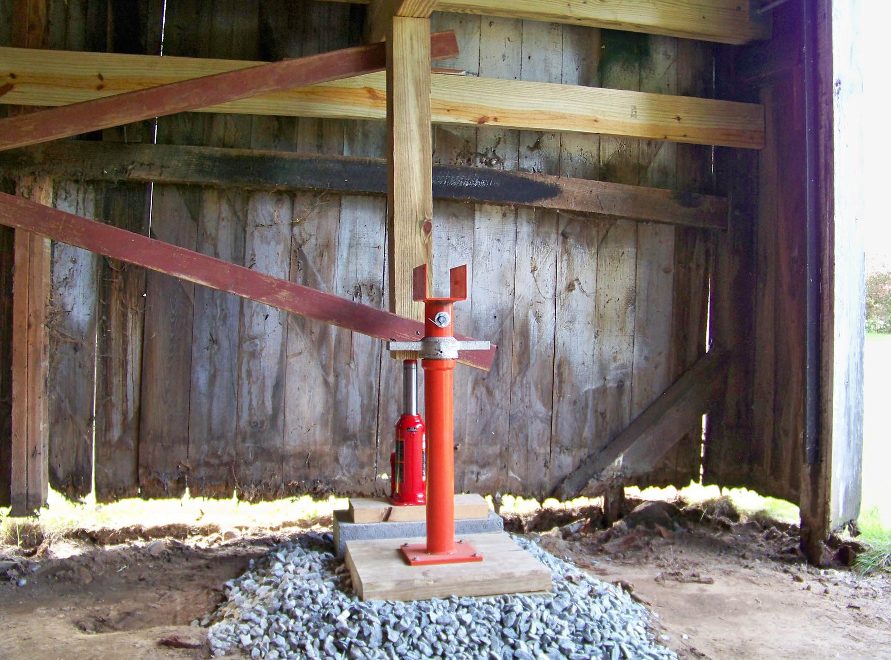

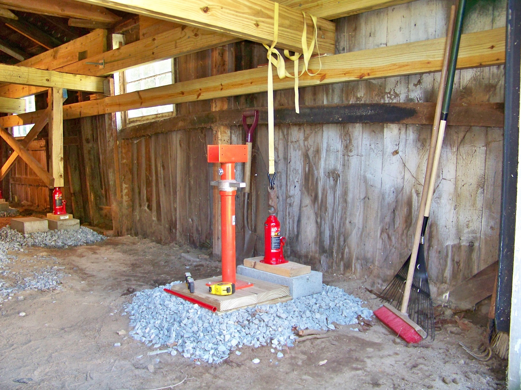

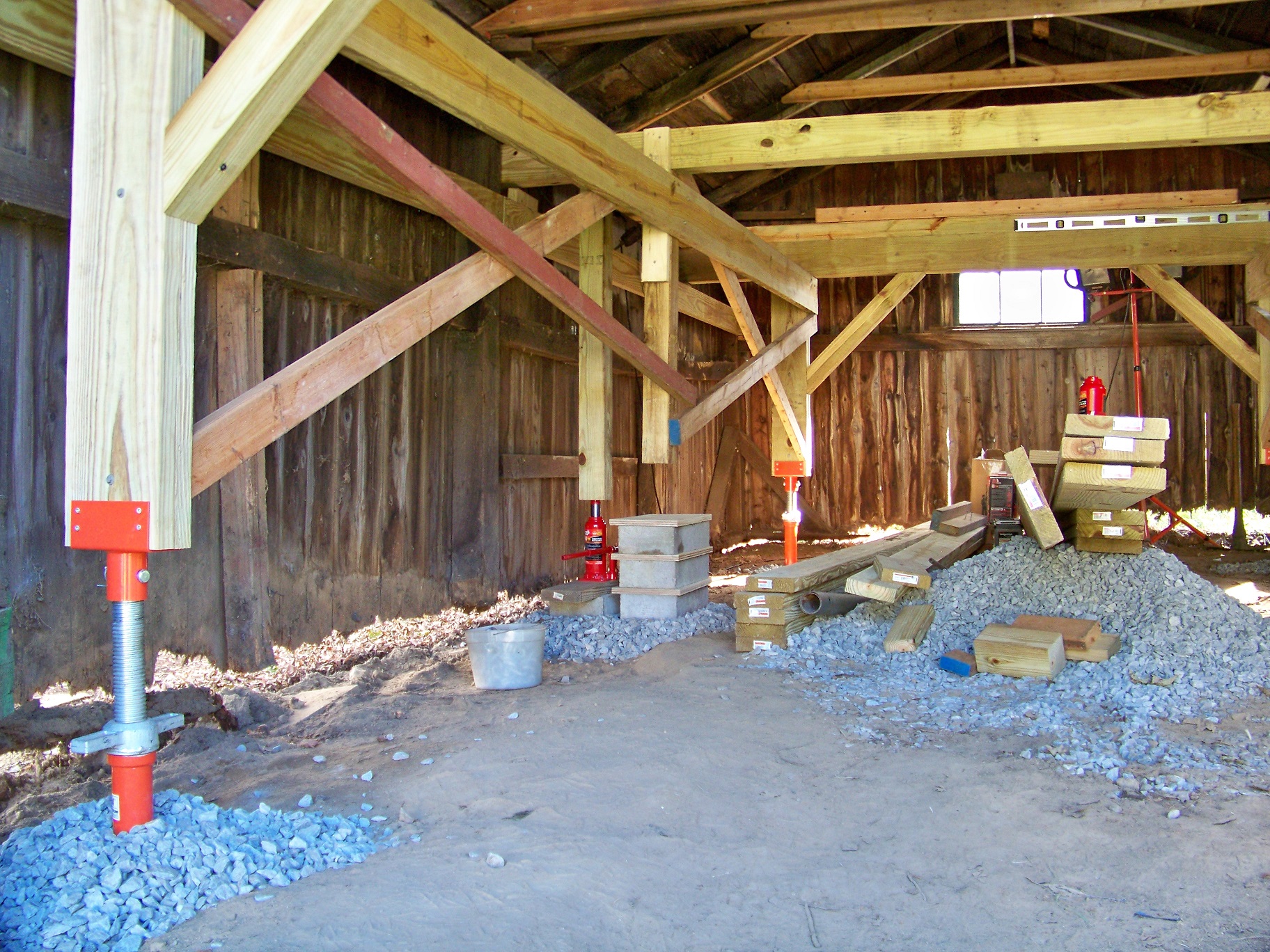

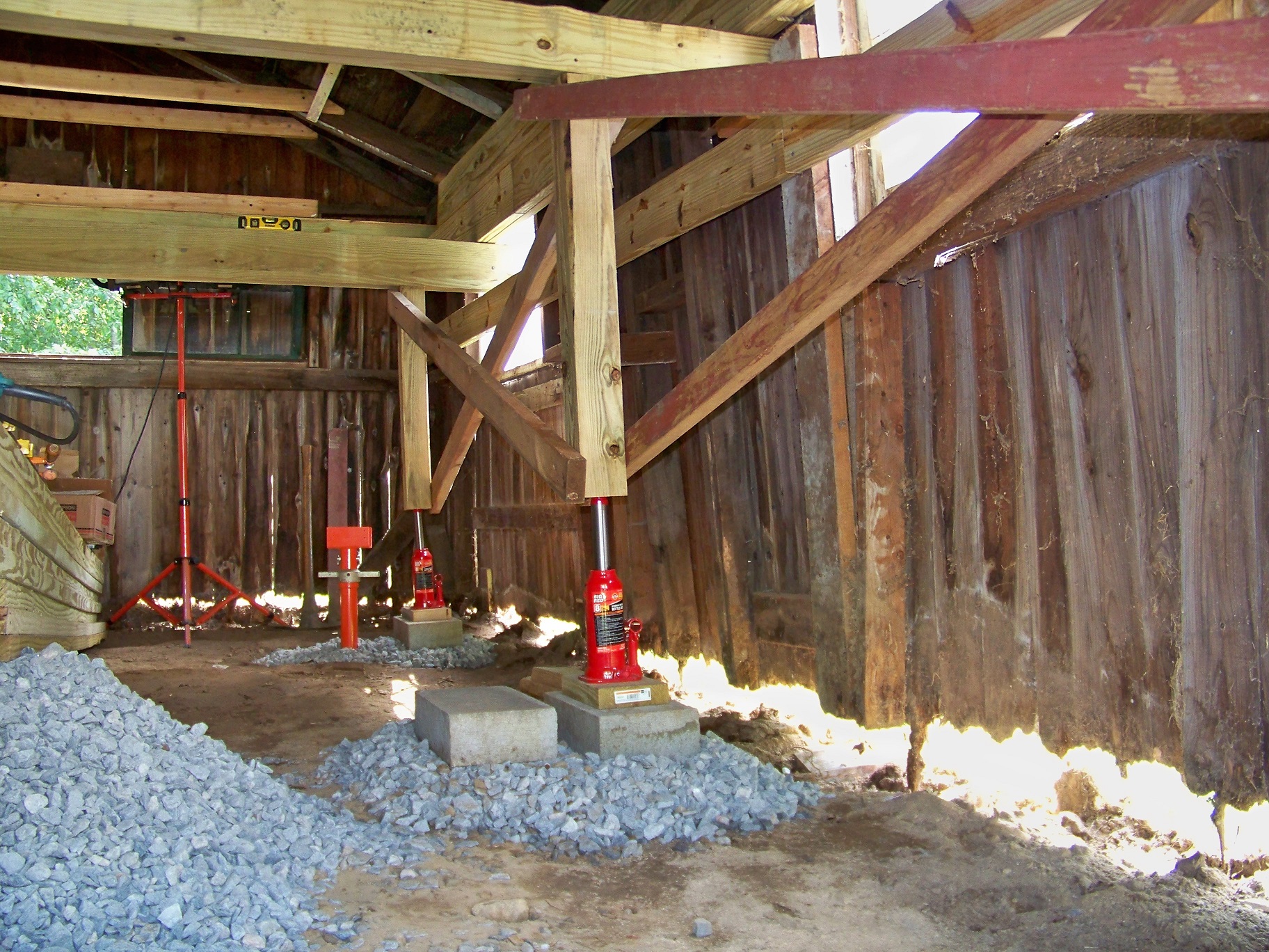

Progress Pics @ 1:30 break:
First thing I've learned is the Ellis Lifting Shores ROCK!!! Way easier and safer than playing with the bottle jacks. Not even sure I needed the center posts that I used bottle jacks on. I got the Lifting Shores with the bearings and I'm very glad I did. Even with the bearings I ended up using a pipe wrench to turn the giant wing nut. I could do it by hand. but it was getting painful.
Second lesson: The $20 Big Red 8-Ton Bottle Jack (linked) works, but the specs lie. Max height is 15", not 18". Package claims 17 5/8".
3rd lesson: If you're not used to doing deep knee bends for 7 hrs. straight (which I'm not), be prepared for some real muscle pain. On the up side, I've lost 11 lbs. since starting this project.

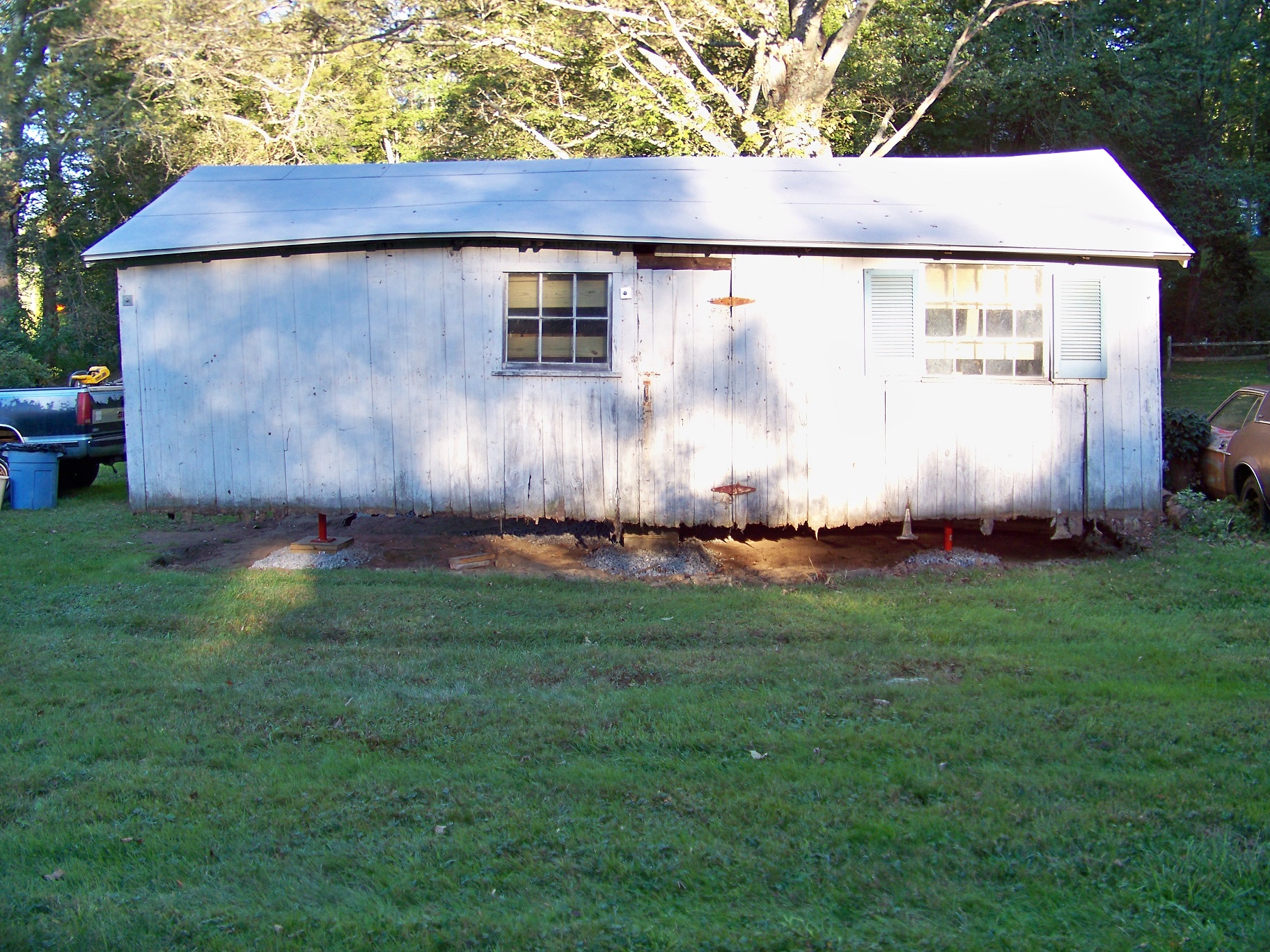

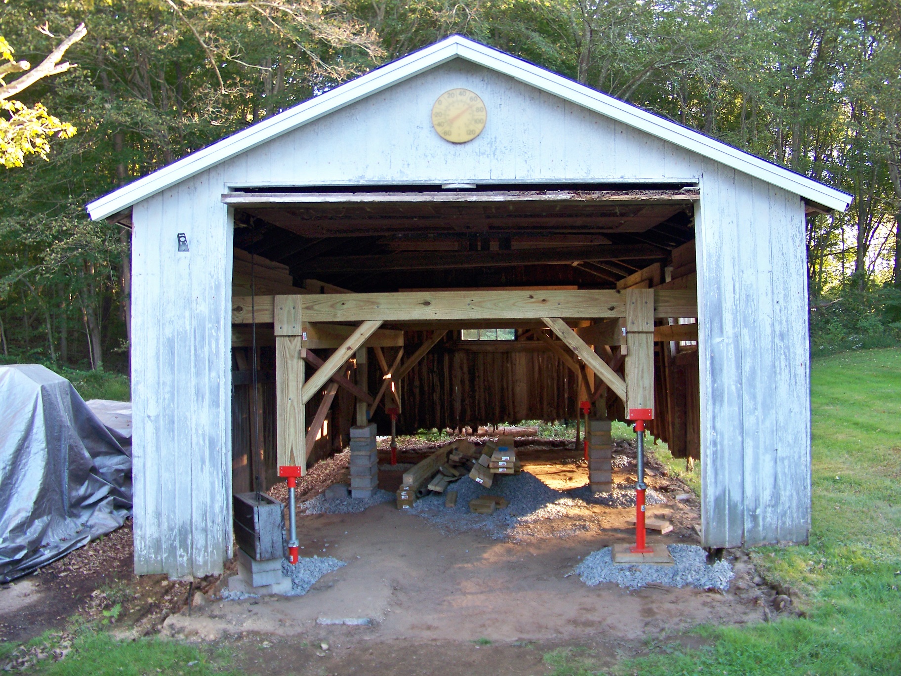

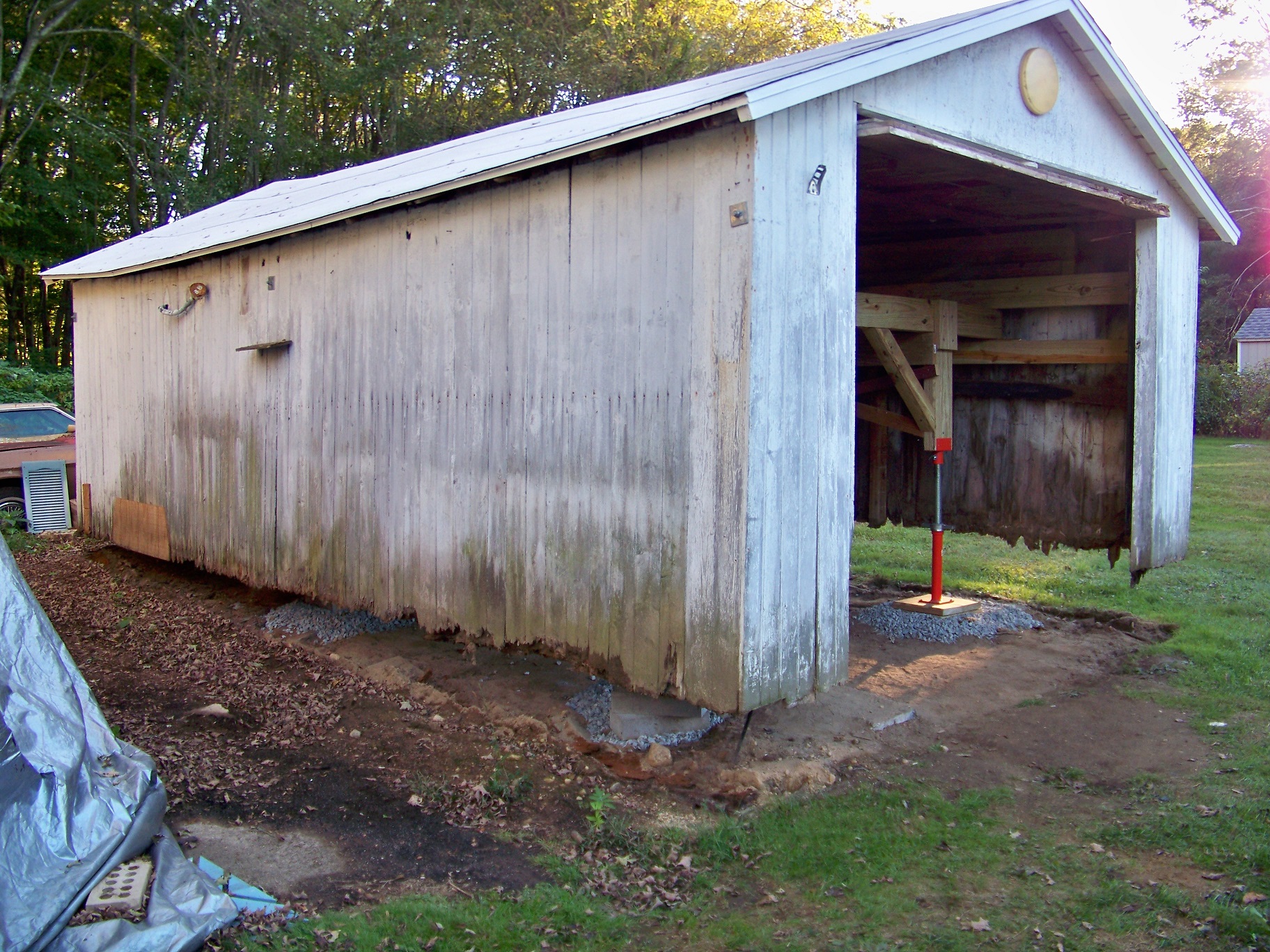

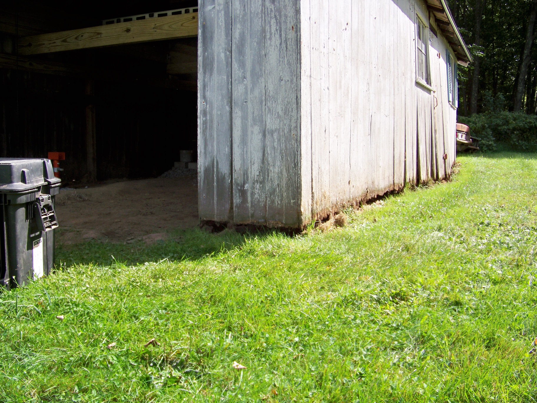

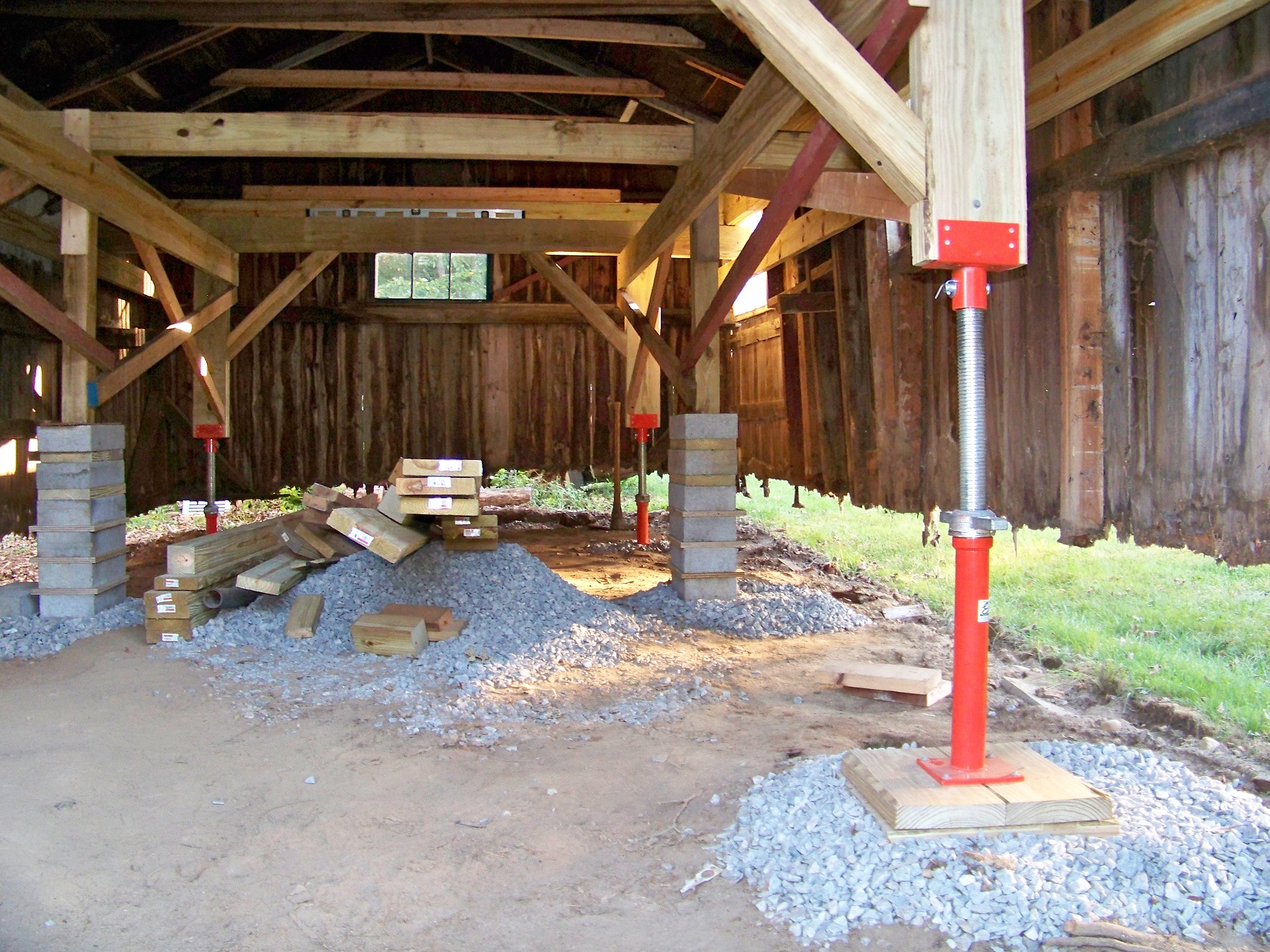

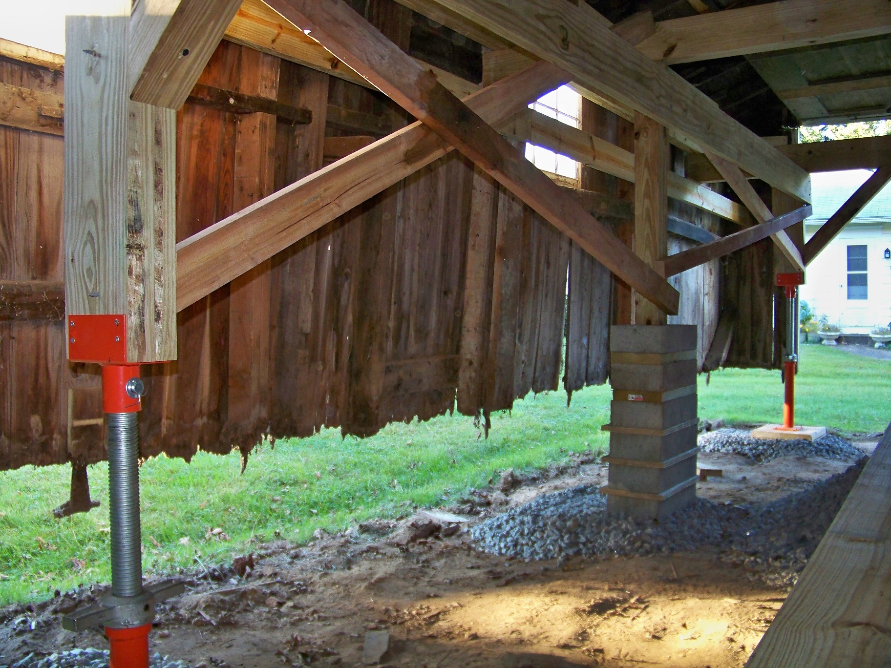

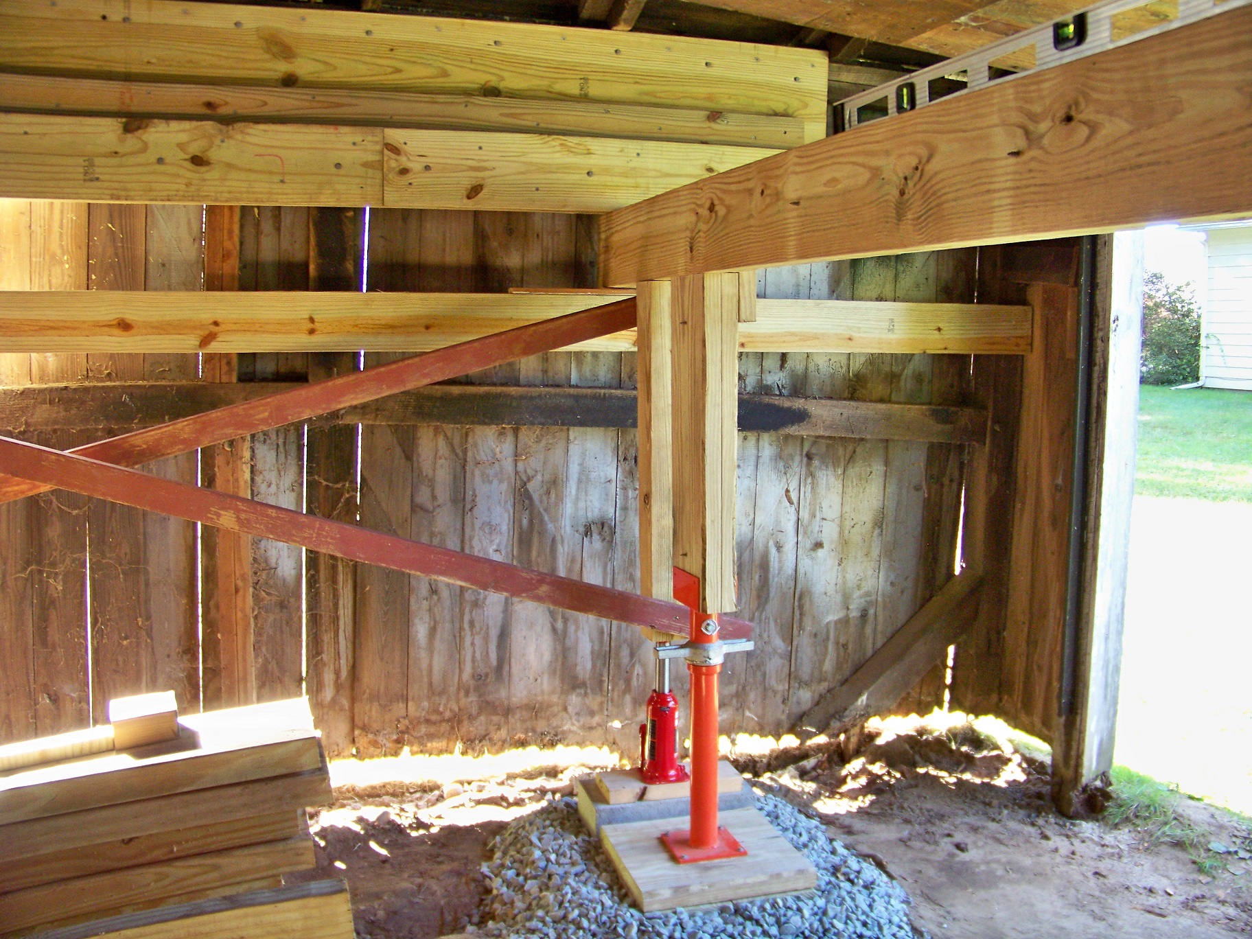

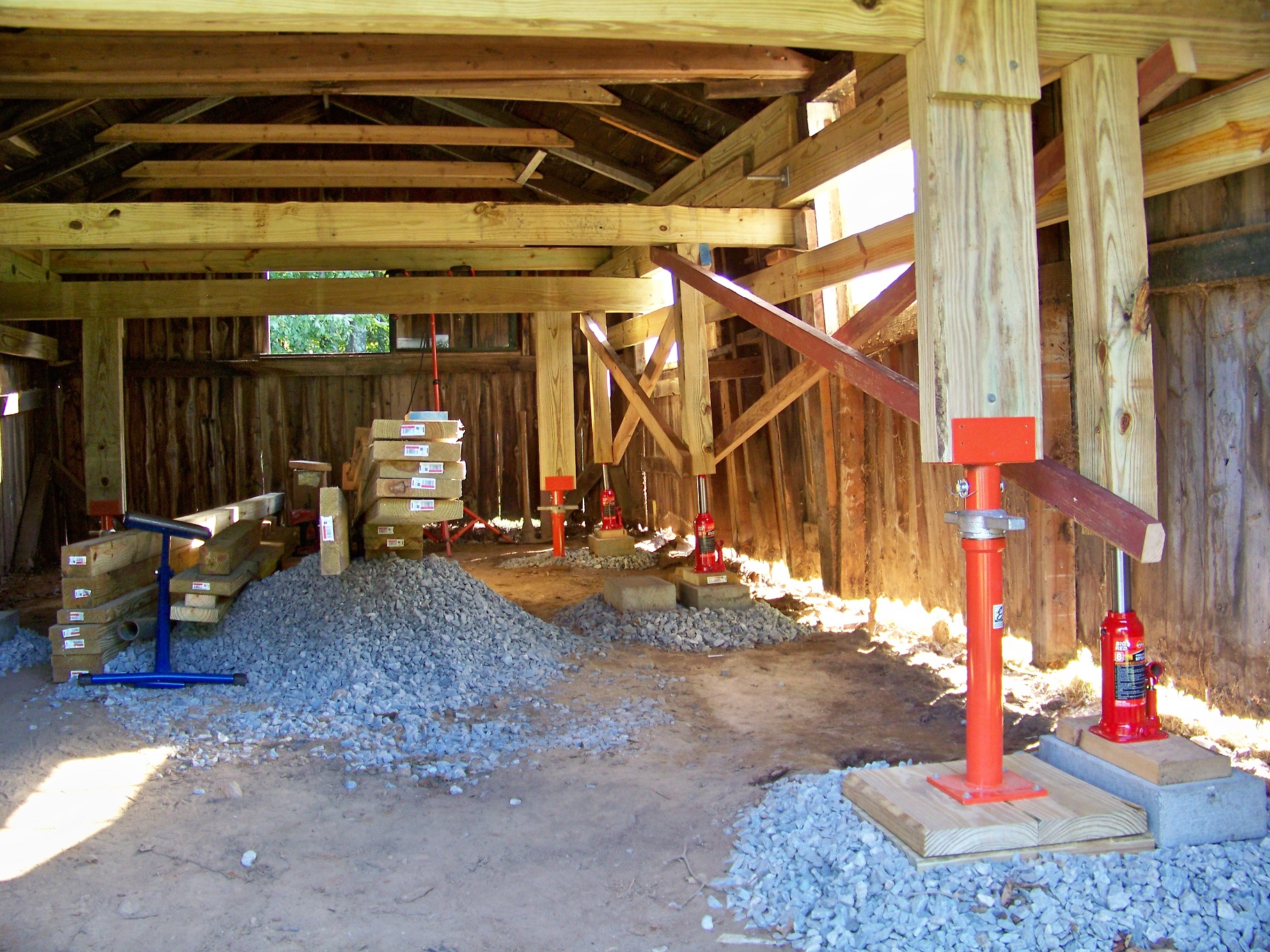

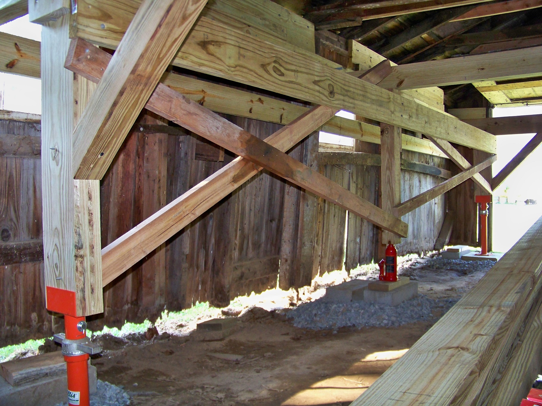

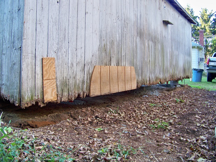

Progress Pics - End of day 5:00pm continued:
The lifting frame and wall supports worked great. No issues. If I had it to do over, I would do it exactly the same way. I was constantly checking that everything remained level in all directions. Though you can't really see it in the pics, large welding clamps are great way to hold a garage door up.
So I saw the culprit making holes and nests today. My best guess is it's a vole. Saw him disappear down a hole, so a took the rake and filled in the hole and stomped on it. 3 hrs. later the hole was back. Not sure how to get rid of these things.
Next step - Cut the bottom off.

lakeroadster - No foundation, that's beyond the scope of this project. Just PT lumber on gravel with a PT wood floor on top. To have a foundation of any kind, I would have to build on another location on the property due to this shed’s close proximity to the septic tank. As soon as we start talking foundations, then it's no longer worth saving this structure.

So what will keep the wind from blowing it over?
It's no different than the prefab sheds/garages that they deliver and drop onto a gravel pad. I've never heard of any of those blowing over - at least not in CT. The only difference between what I'm doing and the way it was originally built over 80 years ago is that I'm putting it on gravel instead of putting it on dirt. It never had any posts sunk into the ground. Here's a pic of the original sill:

Most of the prefab's have floors and floor joist, which add considerable weight for "ballast". Then the contents of the building sits on the floor, more ballast.
I was just curious what your plans were. It would seem prudent to anchor it in some manner after putting all that time and effort into it.
