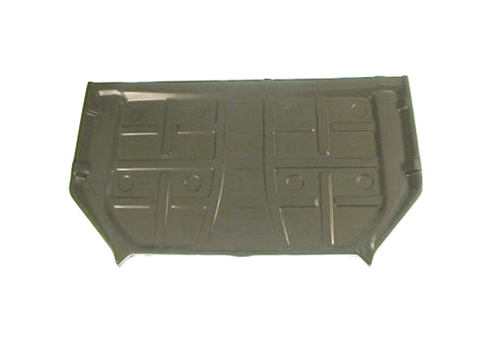

You can use several tricks to stiffen large areas of sheet metal. Pretty much anything with a bend (like bending the edges up to make sides, or putting beads (essentially 'running bends') in the bottom of the drawer, like they do on car floor pans, or aircraft wing ribs, will significantly stiffen the flat sheet metal...
Your other option, is to build stiffeners, which can either be an 'L' shape, or a 'hat channel shape,' to RIVET to the bottom of the panel and stiffen it...
View media item 22347
These aircraft ribs use bending up the edges, beads, and even flanged lightening holes (cut out a circular opening, to reduce material weight and then flange that edge (bend it) to stiffen the part even more).
View media item 20813
The trick with airplanes is to make them as light as possible, and retain the strength. These are a few tools in the sheet metal craftsman's toolbox for stiffening large areas of sheet metal. Pick the one which works for you and conserve materials and costs (use a lighter gauge of base material). You are going to put a drawer liner in there anyway, which will hide some of these options.
