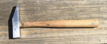

I couldn’t agree more. I picked up this unmarked rusty cross pein with a loose handle this morning. After tightening up the handle, I hit it with the 220 wheel and some Fluid Film and now it’s ready to go back to work.

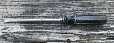

I don't know if anybody else found this out or not, but I found out the hard way that you shouldn't put orange and black handled Rosco screwdrivers in Blaster Metal Rescue (their version of evaporust). I put several screwdrivers in there and all came out fine except this Rosco that cracked up really bad.
Lesser,
I've never had the pleasure of using Blaster Metal Rescue but those pics don't make me feel good about it.
Did you use any heat, making the liquid warm?
Materials used in screwdriver handles were sometimes odd materials, especially in the early days of plastic and other synthetic materials. Maybe the handles already had micro cracks that expanded?
I will say heat is a powerful component to degreasing and de-rusting and I'm now much more careful with it with fragile paint items but I'm a huge believer in it. Evaporust alone can remove paint fairly easily, especially when heated but it also does a phenomenal job when heated.
Something I've been noticing, placing rusting items it a heated ultrasonic degreasing bath can sometimes do an amazing job at removing rust off a tool. It's pretty random with which tool it works on, I would go through the process of degreasing a bunch of new found rusty, grimy and greasy tools in the ultrasonic cleaner to prep for the Evaporust but some came out of shiny and not really needing the evaporust.
In regards to Blaster penetrant, I stopped using it a couple of years ago as the smell totally bothers me and stays in the air in shop for ages after using and makes my hands smell. I now pretty much only use Tri-Flow Super everyday, the stuff is awesome as a penetrant, the Stattett pics above has a coat of it on them to keep rust away; Tri-Flow has been one of the best things in my shop and super happy I found out about it from sewing machine restorers (they swear by it). When I really need a full-on penetrant to soak the impossible for days on end I'll then use SeaFoam Deep Creep, I really like it as well.

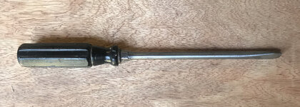

A weird thing I noticed was an artificial grape flavor smell emanating from the cracks of that screwdriver.
Have no idea what those handles are made of but older screwdriver handles with Cellulose Acetate Butyrate or Butyrated plastic can emit a terrible (some say) vomit smell and companies have been known to mix in a pleasant aroma ingredient to offset it. PB Swiss still does this.
Curious to know what you think of Blaster Metal Rescue on its de-rusting performance and ease of use? And if you have compared it to Evaporust?

It worked quite well on rust, about the same as evaporust and it hasn't re-rusted. Evaporust isn't available locally, so on the advice of a neighbor I decided to try this. Here's some before and after pictures: a Plomb PWA cadmium plated 9/16 socket, a 7" vise grip, and a Fuller tack puller.

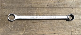

I found this Plomb DBE on Saturday. It went through the Evaporust treatment and was buffed on the 3M 220 disc. I coated it with Fluid Film to prevent future rusting. Sometimes the results of the treatment are almost magical E0F74A9B-7D84-4DC1-8F2A-CA9FD6C72BBB.jpeg77CE67EE-A442-4C28-A162-EF84047022A9.jpeg2D1E327E-741D-465C-A58E-D35A78FD3D51.jpeg

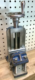

After reading through this thread I decided to tackle this old rusted tight mechanical jackIMG_5182 - Copy.JPG
A little dip in the electrolysis tank (over night) it came apart very easy
After a session with the blast and a bit of smoothing out the casting marks my pile of parts look great

Because of the size of the jack I had to make up a new tank. My 5 gallon home depot is still together for tools but I built this one for bigger stuff and it sits outside my shop for ventilation
I took some all thread and heated it up to bend it 90 degrees then put a hole in the trash can and with a washer on both sides of the can tightened up each rod. Then looped bailing wire around each rod and tied them all together creating a circuit. I attached the positive clamp of the battery charger to the rod circuit and the negative clamp to the jack holding wire and turned on the juice.
(don't know why the pictures are turned on the side)

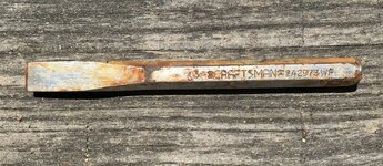

Here is another victory lap on the rust removal front. I've been hitting a hoarder's garage sale, and some of the tools were quite rusty. Below are some photos of the Record A151 spokshave I grabbed to see just how far I could recover something from (hiding under the drill bits again). As you can see, this thing had quite some gross rust, on almost all surfaces.
I didn't even try anything before throwing it into the Evaporust container. Let it soak a while, realized the old stuff was not working, and started with a fresh batch. Used a small tray only slightly larger than the shave, and added another tool to raise the liquid level above the bolts, so I didn't get a bathtub ring on the tool.
Pulled it out after 24 hours, and tried to move the fasteners. The blade adjuster, and the blade holding screw both came loose, the twin blade adjusters did not. I pulled the blade out, used a razor blade to scrape the faces of the blade and the cap, and the working surface. Threw it all back in, pulled it out about 24 hours later, and tried to loosed the twin screws again. Set that piece aside, sprayed it with Liquid Wrench, let it sit a few hours, inverted and repeated. Still not moving by hand, so I wrapped the knurled nut in a piece of scrap leather, and grabbed it with pliers. One moved, one did not. Upped the ante by grabbing it in the vise, still slipped in the leather. Moved to a fresher face of the leather, grabbed it in the vise, and this time it held. Spun it off.
At this point, the cap was pulled back out, wiped clean, and hit the 3M wheel. The blade came out, and got a good wipe down, but the cutting face was pitted, It is as shown in the pictures below. A fresh sharpening is in its future, to see if it is salvageable, if not a new blade will be ordered. You can see the pitting on the left edge in the pic below. The working surface (bottom face) was pretty grossly pitted, and scraping etc wasn't fazing it. I gave it a bit of abrasive work, and it cleaned up to reasonable, 80 grit and 100 micron paper. Not sure if the black will cause problems with the wood, so may have take more metal off after use. Have not simichromed that surface, but the cap was done. All the screws are oiled, and seem to move OK.
Here is as it sits now.
Not perfect, but good enough for a user.
