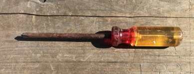

Username sent me a Dunlap Phillips driver today that looked like it had been used as a stir stick for a small can of brown paint. After removing the paint and a little buffing with the 3M wheel, it made it’s way to the Dunlap screwdriver drawer.

Don: nice work on the little screwdriver!!

Don:
Another nice Dunlap piece for your collection. Gotta love those radial brush wheels, huh?
I tried polishing a plastic handle with mine. That was a mistake. The surface heat melted the plastic into a smear.
