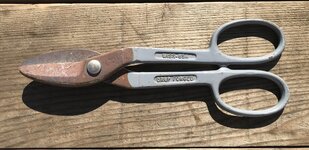

These tin snips that I picked up on Saturday offended me so I worked on them today. Wire wheel first, 3M 220 rotary wheel next and finished up with a 3M roloc disc on my die grinder. Oh yeah, I knocked off some nicks on the cutting surface with a fine file. After finishing I rubbed the bare steel area with fluid film.

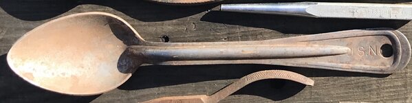

This large USN marked spoon I found yesterday was cleaned up with an overnight soak in evaporust and after rinsing with water, any remaining residue was cleaned off with fine steel wool and a hand wire brush to get into the channel. IMG_9019.jpegIMG_2956.jpegIMG_2954.jpegIMG_2955.jpeg

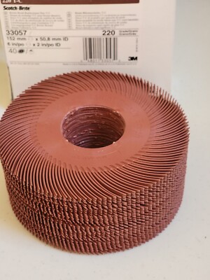

What prices are people paying these days for the 6" radial bristle brushes? I recently set up a 400 grit a friend who was going out of business had given me on one of my old bench lathes, it's great for a pre-polish type finish but what I really need is the red 220. Just don't want to pay $100 for it.
I just looked, the recent prices have gone sky high but Keep searching and stay patient (if you have the time). You can find them on eBay occasionally pop up for $40 but it may take a while, and when they do they go real fast. The killer deals will always come up after you bought one : ) Just make sure your getting the 6" or 7" diameter wheel size, they also make (mini-me) small ones that can look the same so be careful..
The 220 is definitely the go-to grit for these wheels, I love them; couldn't imagine not having one. The 400 is just the icing, but the 220 does most of the major work and well worth it (both of them are).
If you keep them clean and don't abuse them, they last a long time. When they get dirty, you end up using them much longer each time because they take twice as long to do the same job, and this speeds up their wear.
It's like trying to use sand paper thats loaded up.
I recently purchased 40 discs (8 sets) for #220 grit "33213" scotch-brite replacement wheels (w/o adapter mount) for $35. Last year I passed on 8 #220 wheels complete, new in own boxes on eBay auction for $35 total +ship because I now have so many.
Just be patient, create yourself a saved eBay search watch for "3M 220 33213" with email notification to tell you when a new listing comes up. But there a pain to search for because the searches pull up a lot of other products as well. Also search for Bristle Brush 220, Scotch Brite 220......etc.
If you already have an adapter mount, then this is a killer deal below, its the slightly larger diameter ones (7-5/8") compared to the standard 6" size. When Scotch-Brite wheels spin, it does shrink in size a bit with the centrifugal force, so it's just slightly larger than 6" when spinning.
$24 shipped
PS> d42jeep: Keep up the good work!
* Here's one example of using the 220 & 400 wheels, both of these Rockwell-Delta retirement lamps were badly pitted like golf balls, all crusty white from the bad kind of electrolysis, one worse than the other. The scotch brite wheels made for quick work, then used a polishing wheel, and then finished them hand rubbing them with fine silverware polish compound. The Hubble lamp sockets were also done with 440. In fact, all the metal pieces and bases in pic were also scotch-Brite'd
