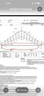

Regarding my scissor truss gable end engineering plans. Is my gable end scissor truss being delivered with a flat bottom piece of lumber on it? It’s being delivered Monday and I’m trying to wrap my head around it. I circled the piece in question.

Yes that is what I’m expecting to do. I just wasn’t sure what that was on the engineering they sent me. It was throwing me off.

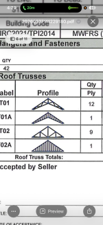

It's not in the truss plan?
If they didn't include one for that purpose, I think you're installing blocking
It is not in the truss plan. We only received center and gable trusses.

mike93lx
Dec 9, 2013
38,398
Richmond, VA
Looks like it's time for blocking.
I'd use the same size lumber as the bottom chord of the scissor truss and mount it, aligned with the scissor truss bottom chord, to the standard truss. Tie in the bracing to that.
The part circled in red is to help the truss designer with layout, it's likely that it should have been deleted from the end drawing.
Someone on the board referred me to this question. I designed trusses for close to 40 years, so I can answer this one for sure.
I realize the trusses are already set as I'm writing this. But others will likely find the thread using the search function, and I want the correct answer on here.
The line you circled is a generic bearing symbol. It is absolutely not a part of the truss.
In my not-at-all humble opinion, this is poor truss designing. The gable truss should have been designed to be structural, so it could support itself until the balloon framed wall was built under it. A gable truss with studs only is not designed to support itself.
SusKatCas is 100% correct in what he posted about how gables with scissor trusses should be framed. If it was a smaller gable - Like 16' or so - It wouldn't bother me. But this one is large enough that it should be framed correctly.
