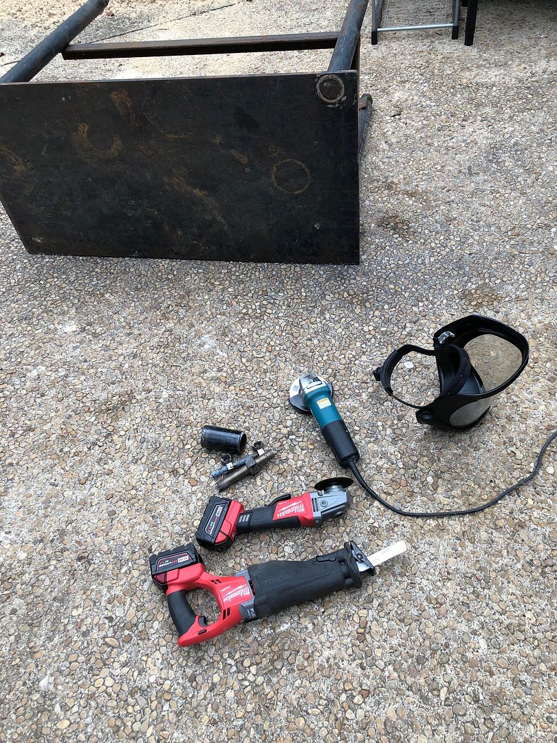

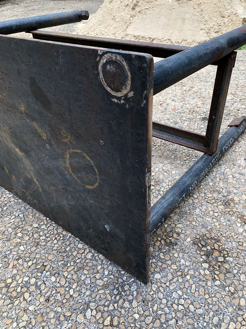

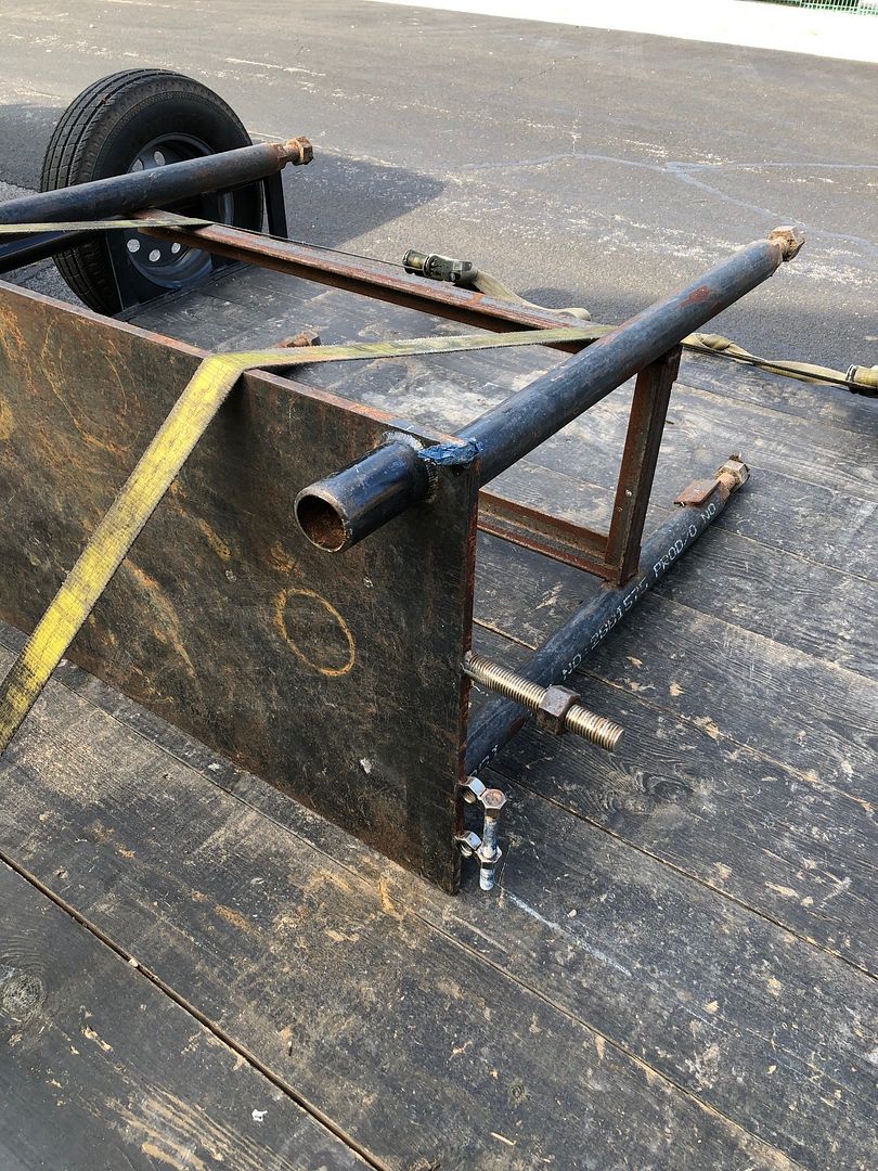

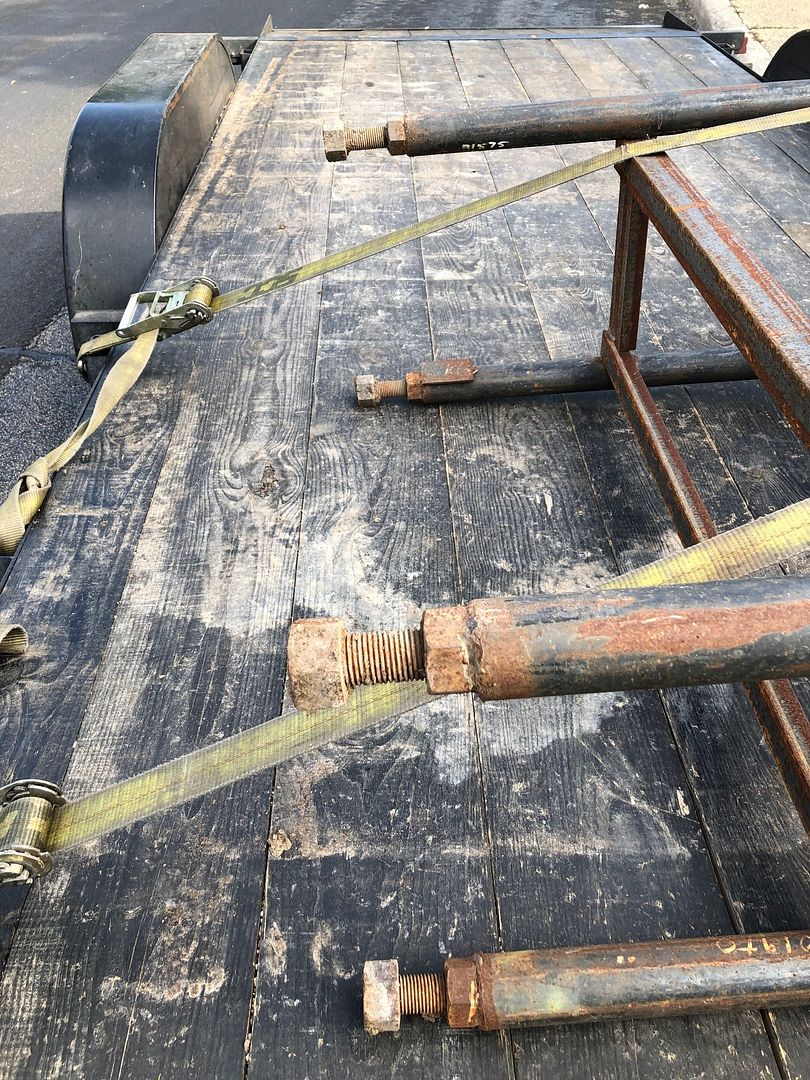

Got the table today, but not the one that I was after. Guy had 3 tables - 2' x 4' 5/8" thick; 30" x 60" and 1/2" thick (he thought it was 3/4 or 5/8 but it wasn't), and a big one with 1" thick top that was out of my price range at $900.
The medium sized table with the 1/2" top was warped/bent. Top had about 1/4" dip in the middle, so I passed. However, the 2' x 4' with 5/8" top was good, so I bought it. And took home a nice vintage Rock Island vise with the $ I saved.
One issue - it's 41" tall. I'm 6'4" so that's not a big deal, but I'm guessing folks were sitting on stools using this bench.
What do y'all think?

Personally, I like tall benches. I'm about 6'1" and have built all of mine around 38-40". It's nice being able to stand and walk around and not hunch over. When I weld, I like being able to half sit on a stool and have my leg almost straight with a little bend for tig. Not sure what the thing sticking off the top is, prob holder for a mig torch, but I'd probably cut it off personally. But to each their own. If you're happy with what you paid, it should be fine. If you really want to, you can always build another frame if you decide you want something different.

Looks like a solid bench! Too bad the larger one didn't end up working out. As far as the height, I would say just try it out for a while. You can always cut it down later if you're uncomfortable. Personally it would be much too tall for me, but I'm only 5'10". A couple of things that come to mind - you have to lift whatever it is you're working on up to the bench top, if it's heavy lifting that high could be a struggle when most benches are nearly a foot shorter; the other thing I thought of would be discomfort when TIG welding, although you said you have only a MIG anyways. One modification I would make before you begin working - redo the bracing underneath with either a diagonal cross between legs or a single center crossmember longways. Your shins will thank you. And post up a picture of that vise!

Thanks for posting up about those tables. I have been looking at them as well. The one you got was a little smaller than I want, I was going to go look at the medium one, too bad it's bent, but it's not cheap enough to buy and try to fix.
That little one looks like a good table though.
I'm happy with it, but I'll cut off the cup on top and the attachments on the side.
It was 41" with the legs extended a few inches. I screwed them all in; probably 39" now.
