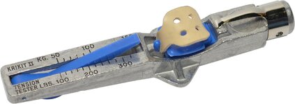

I use a fairly unknown tool called a Krikit belt tension gauge on some machinery V-belts I service.
It can be used on all kinds of belts though.
Here's a Gates rep using one on a bicycle drive belt.
I have never used the phone app he mentions, but it detects belt frequency to determine tension.
Beerhippie
Oct 13, 2023
10,270
Far NE Oregon
I have a plunger-type tension tester. It's a little more accurate than the tried and true "push on with your finger" deflection test.
