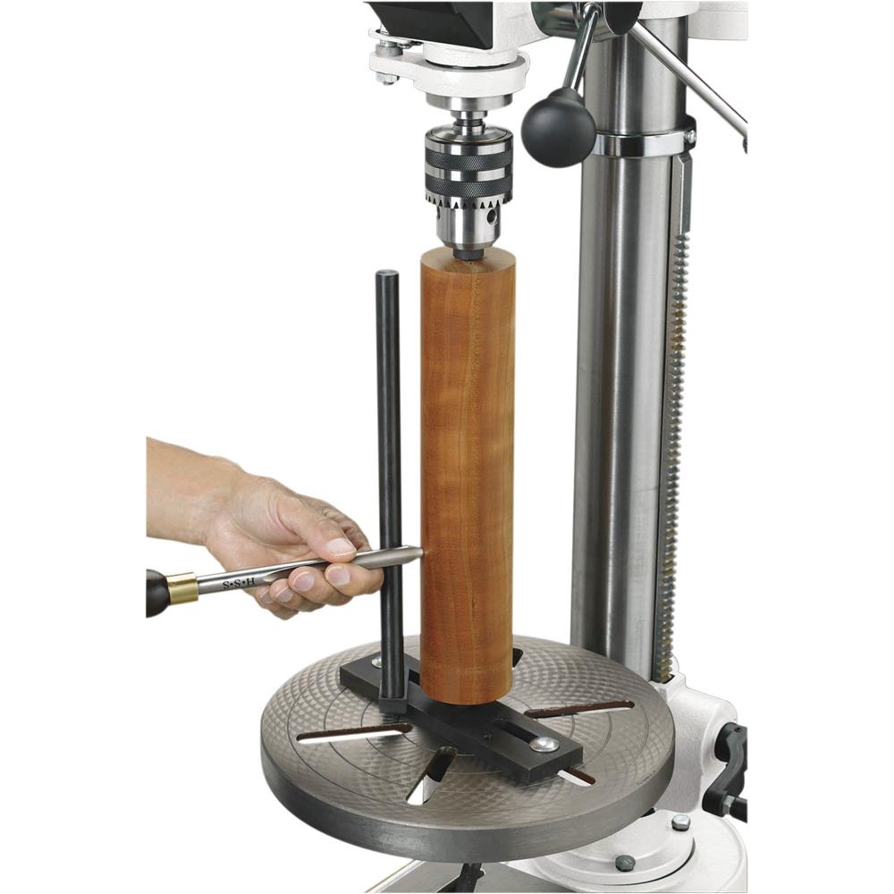

I bought one of these and use it in my drill press frequently when trying to clean up oddly shaped pieces. I dont have a lathe to chuck up dowels etc so i find this help. Used it once on my battery power drill at slow speed did a fair job.
There are also these drill press lathe attachments that could be used with those. They are available from different places.
