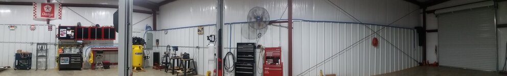

Oldbear
Aug 31, 2011
620
Linden, Alberta, Canada
I'm late for the party but... I use the Maxi-air or whatever brand I bought 5 years ago. I also use truck air brake line (Synflex brand). I can get it in the blue that is close to my original system. The air brake push-to-connect fittings are far better than the ones that come with the airline kits. It allows easy changes to your setup. I have over 100ft of line that goes from my compressor around the shop ceiling with drops and a run through some underground conduit to the old shop too. No issues after 5 years.
