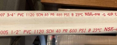

It isn't lore. There are multiple documented by OSHA cases of injuries by PVC. The PVC manufactures warn in all their own literature not to use PVC for compressed gas systems.
PVC work hardens by pressure pulses which are particularly bad in an air system and not so much in a water system(especially a city water system)
With water the psi goes almost instantaneously to zero once the pipe burst(because water is incompressible) where compressed gas will continue to expand and propel shards after it burst
You have made assertations multiple times on this forum and have been shown the literature and proof not to use PVC and yet still push PVC use.
Just because you have not had a failure yet doesn't not equate to one is impending.
I don't know why you have not been banned yet for continuing to push for unsafe air systems.
I'm not "pushing" for anything. This is probably the third? topic on air lines that I've ever commented on here. Over years - ETA 7yrs. Yet somehow you choose to mischaracterize my behaviour. I'm not the person insisting on only one point of view. I'm not even saying PVC is the best material or the only material to be used.
And frankly 'appeal to authority' - especially OSHA, given its fresh abuse re COVID - is one of the weakest methods in Rhetoric. THE weakest form of argument is to call for someone to get banned / silenced. And you've gone and done both.
Your statement re water vs air is deliberately misleading as it infers there is not a continued pressure source re water.
I'm observing the rated / stated mechanics of the material.
My compressor tops at 200psi. The emergency blowoff trips sooner. 150? 160?
3/4" sched40 is rated at
1/2" sched40 is rated at 600psi
So I'm operating at half or 1/3 the rated pressures of the PVC. Why is that an issue.
I'm also pressurizing my system only for the period of time I'm actively using it. So frankly industrial or commercial incidents and OSHA have very little relation to my residential working environment.
You're NOT observing the "rated / stated mechanics of the material". You're FAR from it. PVC is NOT rated for any type of compressed gas, period.
It's an issue because PVC is rated for those pressures when carrying non compressable LIQUIDS which do not store energy, unlike compressible gases, which do store energy and become a bomb when (not if) the PVC cracks.
Tommy
Everyone is born ignorant of the facts, and we learn them at some point. I can see someone (ignorant of the facts) thinking that PVC is safe from your charts. You have posted charts and burst ratings multiple times. Anyone can search "PVC" with "rayra" as the member and bring up results showing that you have continuously pushed the viewpoint that PVC is ok and post multiple times the pressure rating chart but neglect to post that the manufacture doesn't recommend compressed gasses. You even post a picture of the PVC pipe in your last post with the pressure rating neglecting the fact that the manufacture doesn't recommend for use with compressed gases
You still don't understand fluid dynamics and compressed gases vs uncompressible liquids. Water has zero pressure when it leaves the pipe, just some momentum due to its weight, and the water behind it has only 40 psi, not 125-150 psi of air and expanding multiple times its volume as its leaving
For flow / fluid dynamics, anything much larger than the QD orifice size gives little benefit. Your tank size is more important, in that regard. So it is readily possible to use the smaller piping with the higher burst rating to assuage any system pressure concerns.
This is false as well, pipe has friction losses, from both the walls, the fittings, and the restrictions. Its easy to see in long hoses.

Thanks Firebrick for an eloquent response.
The problem with PVC is its ductility - when it fails, it tends to shatter. On the other hand, materials like copper or steel tend to bend. So, if there's a crack in a PVC pipe bits can fly off, while the material in a copper or steel pipe around a crack will just bend and it will stay intact.
I've personally witnessed what happens when PVC used for air lines fail. I was in the next room when a fitting spontaneously failed; it sounded like a bomb going off, and there were sharp shards of the fitting embedded in the walls. Fortunately no one was directly in front of it when it happened. It may be rare, but it does happen.
