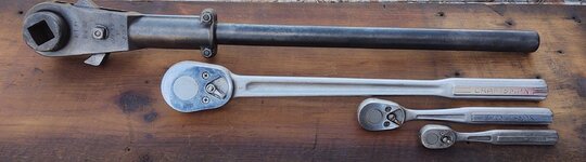

Anyone with information on this ratchet? It is a 37" long 1.5" drive reversible ratchet labeled "No. 2.0.S.B.B. Wrench" made by Lowell Wrench Co. out of Worcester, Massachusetts. It appears quite old but I am not sure how old so I apologize if it isn't an antique.

Four.cycle, thank you for the welcoming and for the links to the wonderful resources. I greatly appreciate it! I have downloaded them to have on hand.

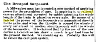

It's funny you mention cranking. I ran across an article from the Railroad Gazette written in 1888. It describes a new method of adding power to train car propulsion by somehow using a cable connected to all the train car axles. The power of the locomotive is now transferred to all the car axles putting everything into motion at the same time. They called it the centipede system. If I'm understanding this article correctly, the special tool used in this process was a "ratchet." I'm only guessing you would use the ratchet to crank the axle cable tight, which I suppose would require a heavy duty ratchet. Found this article on Google Books while searching for R&B Co information. Does any of this make sense to anyone? Maybe this ratchet could have been used for this cable process?

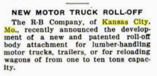

I am not 100% convinced, but this is worth checking out...

By golly Lugz, I believe the mystery is solved. I searched R&B Co every way possible except R.B. Co. The Google Books search is obviously very type sensitive. I see the one add you posted describing the use of a ratchet, so this has to be it. Pretty interesting setup on how to load & unload a heavy load on a truck. Now I'll be on Google Books all evening checking this out. Another ratchet mystery solved. Thanks! Appreciate the help.
30,748
That was from a couple different articles, both in the 1919-1923 range.
Here is one.
But I highly suggest you search Google Books on the term "Roller Bolsters Company Kansas City". Many ads and articles, including the history. You will enjoy reading about it. The company was an offshoot of a lumber company. They invented the loading/unloading system for themselves, for their own use. But it was so popular and so in demand the lumber company started a second company just to make and sell them commercially.
