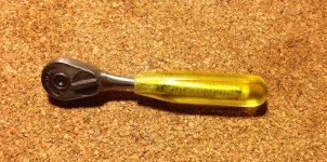

Here's my attempt . Kinda lame but its my 1st one.
Baby Cornwell with yellow plastic.
Handle was a standard screwdriver . I filed the ratchet handle to 3/8 diameter and made it hex shape to keep it from spinning in the plastic handle under heavy use.
Drilled the plasric handle 1/32nd undersized and filed it to shape. Felt most comfortable with the top n bottom flat and the sides rounded.
Now it's bigger than standard issue metal handle but smaller than the hard plastic ones that can be bought and that's just right for me.
Final polish this week.

I didn't like the last one so I took a 50's Craftsman screwdriver that someone trashed and made another.
Just clamped it in my vise, drilled the hole a little deeper and filed. A lot. A little sanding and done.
Liking this color a lot more. Sort of a 'bladder infection pee yellow' .
