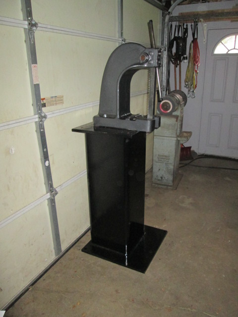

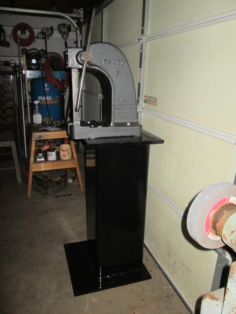

Picked up this Famco 3-1/2C a little over a year ago from a online auction.
Haven't gotten around to tearing it down & cleaning it up yet, But hopefully I'll get to it this summer.

that's impressive. I think I like the stand it has as much as the press. is that all one piece or can you move it around in a few parts if you need to?

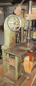

That’s a nice looking press Doug. I picked up a Famco 3 1/2C a little over a year ago also. I have not cleaned mine up either, but honestly I don’t think I am going to. I love the patina, it feels like it somewhat tells the story of its many years of service.

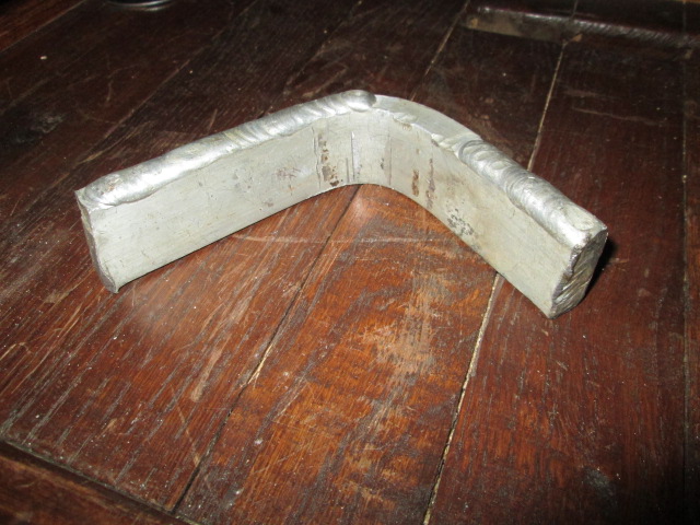

that's impressive.
Yeah it's amazing what leverage can do!
In the compound mode it's rated at 8 tons, Here's a 1/2" X 1-1/2" scrap piece of aluminum I bent with it trying it out.
It does come apart Base/Press/Top all disassemble.
All together it probably weighs around 500lbs.
Your press looks nice also! That ships-wheel probably works good for light pressing needs. :cool:

Drives: I got lucky on this one. The ships wheel is an original Famco option.
[dwal: That ships-wheel probably works good for light pressing needs. ]
The Ships wheel is not supposed to be used for leverage, even though it sure looks like it should be. The problem is that it is only mounted on the shaft with a set screw and a slight divot in the shaft. No key way or flat section on the shaft. I think the previous owner must have used it for leverage though because it is a bit stuck on the shaft now. I am going to need to use some persuasion to get it off.

Ship's wheel was used for broaching keyways. Much quicker than using the lever and easier on the operator.

Mike: Thanks, I had to Google that and watch a short video, non-machinist here :dunno: I am thinking that a previous owner must have pulled pretty hard on the ships wheel and created a burr on the shaft.
