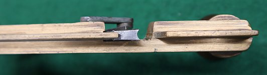

An interesting bronze plane. No markings. The skate on the bottom is about 1/8" wide, 3/8" high and 9" long.
Thinking this plane was used after a 1/8" wide slot is cut into a piece of wood. The cutter has a Tee shaped set of scooped cutters.
This would leave a slot with a hollow at the bottom. Perhaps used for canvas or screens stretched and a cord pushed into the slot until it hits bottom where it could expand.
Anybody know for sure?

Old tool guy
Apr 13, 2023
3,629
So you’re thinking like a t-slot? Wouldn’t the chips clog up?

Can the cutter be moved to the side, so it would cut next to the center guide? Set up higher & to the side I'd wonder if it would cut beads on cabinet face frames prior to mitre work & assembly.

I'll try to explain again. There first has to be a 1/8" slot before this plane is used. The cutter then only has to move the shavings from the side cutters up the slot. I tried it once on a piece of soft pine. It worked, but wasn't fun. Today instead of a cord they use a more rubber like strip that compresses.

Eric Brown: Judging by the the fourth picture you attached, the plane you posted would cut a bead. It may have been based on or inspired by the 1878 patent by Justus Traut. It doesn't look like a commercially produced plane but it was well made. I think the T shape of the cutter may have been to provide relief. It's possible that there was another cutter that would have cut a 'hollow' that would match the 'round' or bead. It is a lovely plane that may well be one-of-a-kind.

Definitely not a one off. I have seen others like it. I still think it was used to stretch either canvas or screen wire in a frame.
