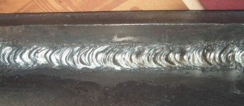

OK, I know you are supposed to start threads like this with a good example but this is all I've got. I'm taking a class at the local CC. Using a Miller XMT with 6010 rod. I am starting to get the hang of it, but still a long way off from looking good or being strong. So let's see 'em...

try closing your eyes and listening for the bacon sizzle.........amazing how much that one litle trick helps, ay least it did for me..........and when the frustration sets in, take a break and get some water..........never could get the hang of overhead proficiently and now that i am disqualified from welding at work [ long story of politics] , i haven't picked up a stick in years and honestly don't miss it...........now what i do in the privacy of my own personal world............

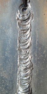

These are not meant to be poster work but to demonstrate technique. You can see in the second pic someones improvement with the second try. The 3rd pic was showing how the operator can stack the fill right in the gap.

Here are 2 more, one 11 and the other 18. overhead, high magnification shows every flaw but one can get the idea for making it stay where the operator wants. The 3rd pic here was to demonstrate that the plate could be nearly melted thru while the welder kept control and stacked all the melted metal in the joint. Pic 4, old rod, rusty old plate on a truck frame or something, 1 big ole fat stringer, all of these welded in the position shown. Pic 5. 6010 on a crack repair to a truck bed.

I am with Stump, I like it cranked to get fluid. The butterfly look is good for learning technique. I was headed to a little job last summer, thought I might have to test, I took 50 or so rods, run a dozen each day starting on Sun, took till Thurs to get to where I was driving it vs it managing me, ha. I hit a ceiling in that time frame.
