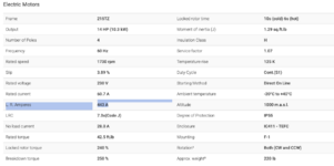

I have a possible future project. We have an old Lodge & Shipley lathe at work that may come home with me. We have 3 phase power at work to operate it, but not at home. It has a 20hp induction motor that can be wired for 220 or 440. I have a 200 amp service in my shop. I dont need any variable speed for the motor as the gearbox goes from 24-2000 rpm, just a way to operate it. I built a small (3hp) rotary converter years ago to operate some woodworking tools that works fine for that. I also came across some things called "digital phase shifter converters" that are rated for 20hp and reasonably priced. I am sure the lathe has never used the full 20hp when in use at work. It has a HP meter that barely moves when you turn it on to work with it. The other option would be finding a single phase motor to replace it with but that would be a lot of work. Also looked at building a static converter, even with it being derated I would still have plenty of HP left. Ideas?
20hp single phase (DOL start) is a LOT of inrush.
here's a single phase 10kW/14hp motor:
i don't think your neighbors will like it (if you can even start it). dirty napkin math says that's 632A inrush for a 20hp 1ø motor.
FWIW, if you wanted a NEW VFD to run a 20HP motor, hitachi recommends doubling the amperage rating of the VFD (1.73x) for the motor if you're going to single-phase the VFD (so you don't burn up the inlet diodes).
pricing for reference:
a couple seconds of acceleration ramp time and that inrush comes down to running amps, especially unloaded.
depending on the motor and intended use you might be able to get away with a 30HP drive, output stage isn't an issue here (already oversized by 50-100%), just inlet.
but if you planned on using full capacity of the motor for big work, I wouldn't want to gamble on the diodes being happy overloaded.
gregs
Mar 16, 2007
1,646
When I built my shop I ended up having to change my electrical service. So I ended up with my own pad mounted transformer and a 400 amp service that I split 200a to the shop and 200a to the house. I need to look at the transformer to see what its rated for.
I ran across this, dont know if its anything to even consider.... Seems to be other brands available of the same thing. I definitely wont need the full 20hp ever. The lathe does have a clutch, so when it starts its not driving the complete gearbox.
I am going to do some hunting around on marketplace to see what a rpc might go for used.

With a 20HP motor your best bet is an inverter. Soft start/ramp up will give you the lowest inrush, a 40HP idler is going to need a pony start and may end up costing more outright. The motor is what 55 amps at 240/3 that is just shy of 100 amps single phase. I would check with your utility about that before you get too far into this, that is a big load on a residential service.
gregs
Mar 16, 2007
1,646
Your saying to use an “inverter” which I think is the same as a VFD? Motor plate calls out 51 amps @ 60cy and 53 amps @ 50cy.FD2D75DC-03CB-4604-B46D-662A4E5FECE5.jpeg
