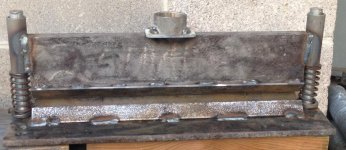

Mr_fixit
May 24, 2008
1,221
Rustylvania
I couldn't find a press brake that fit my press. So I made a narrower version of one a friend had.
