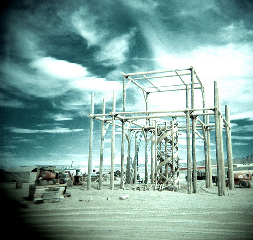

I welded a custom brace for the bottom of each stair. It could have been so simple... I nearly killed the volunteer cutting out stair treads when I found out he was not making them all the same:lol_hitti
27' double helix.

Took barely a fraction of a second to know where that was without ever having seen it before. It's been 11 years since I was last in the dust. I do miss the amazing things everyone builds out there. Nowhere else like it.

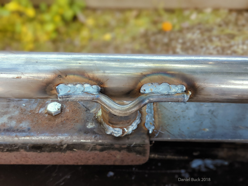

They are garbage, yes. Just calling a spade a spade. Trailer i build i slot cut plate then double sheer a bolt for holders
That's what D.O.T. told us we needed when I upgraded the chains on all our custom built trailers, and NOT to weld the chains on. The two factory made trailers we recently got, have those little shaped bars as above. I found that a bit odd. They seem like they would be good for tie-downs as in the photo, however.

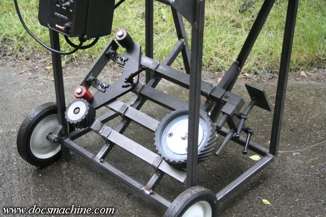

I showed the stand I made for my 2 x 72" belt grinder back in Post # 5616:
I just added a rack, as planned, to the open bottom section to hold the extra tooling arms:
Came out nicely, and still holds them securely even when the cart is kicked forward to move it around like a hand truck. Plus the extra ballast down low adds some stability and makes it feel more "solid" in use.
