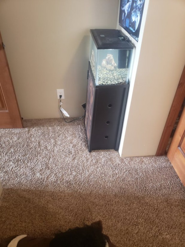

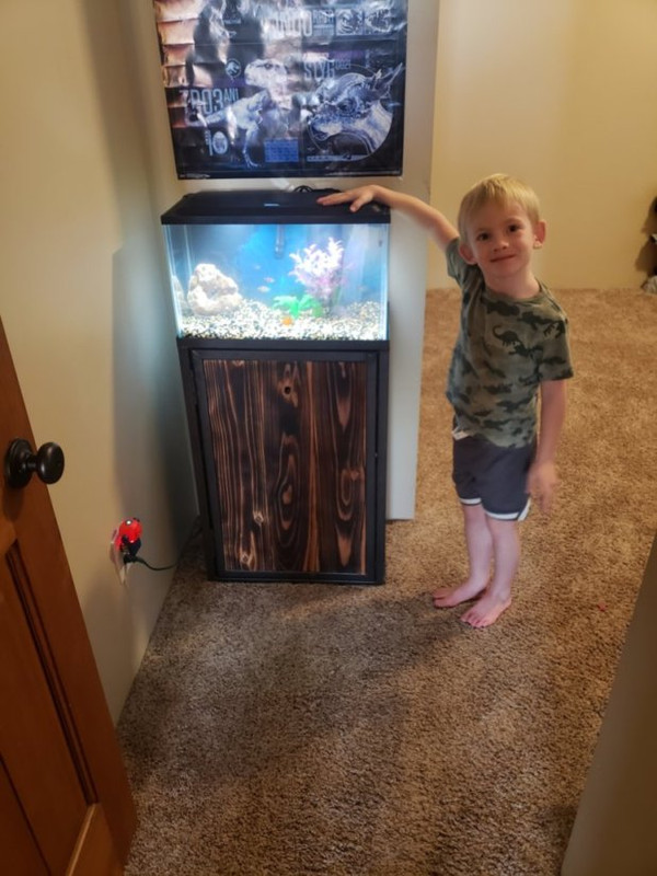

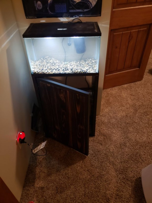

We had this little 10 gallon fish tank than my son has been bugging my wife and I to setup but we didn't have a stand. I looked at how much a stand was for one of these little things and couldn't do it.
I didn't take any pics of the build but I think it turned out pretty good. Also gave the wife a reason to try that burned wood look she's been wanting to experiment with.
The front "legs" angle out so the kids can't tips it over and yes those are dimple died sides lol why not!

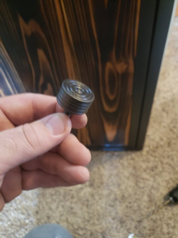

Turned this little knob out of aluminum for the door and painted it to match.

x--just the right height for your son.
That was actually quite an argument between him and his little sister. I ended up splitting the difference so that he was eye level with the top and her with the bottom.
I bet he loves that tank! I know my kids are infatuated with fish tanks when we see them.
Yeah it was a hit. After we got fish in it, he stated that it was like a dream come true.
