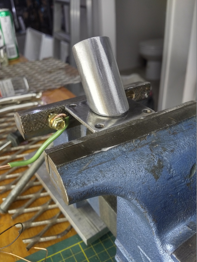

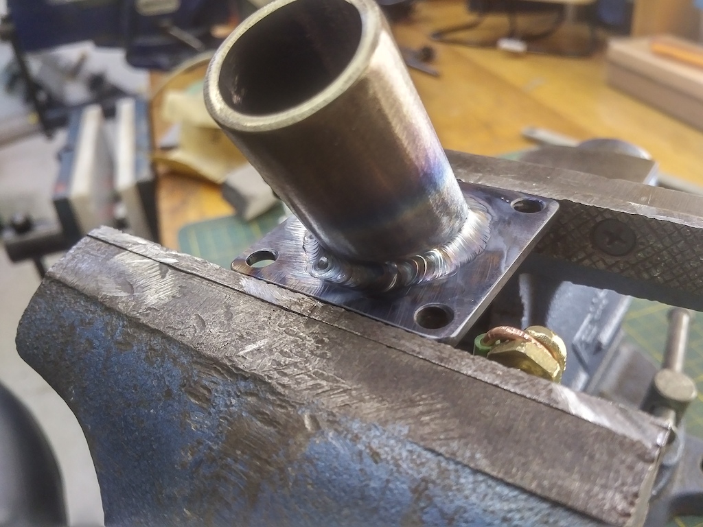

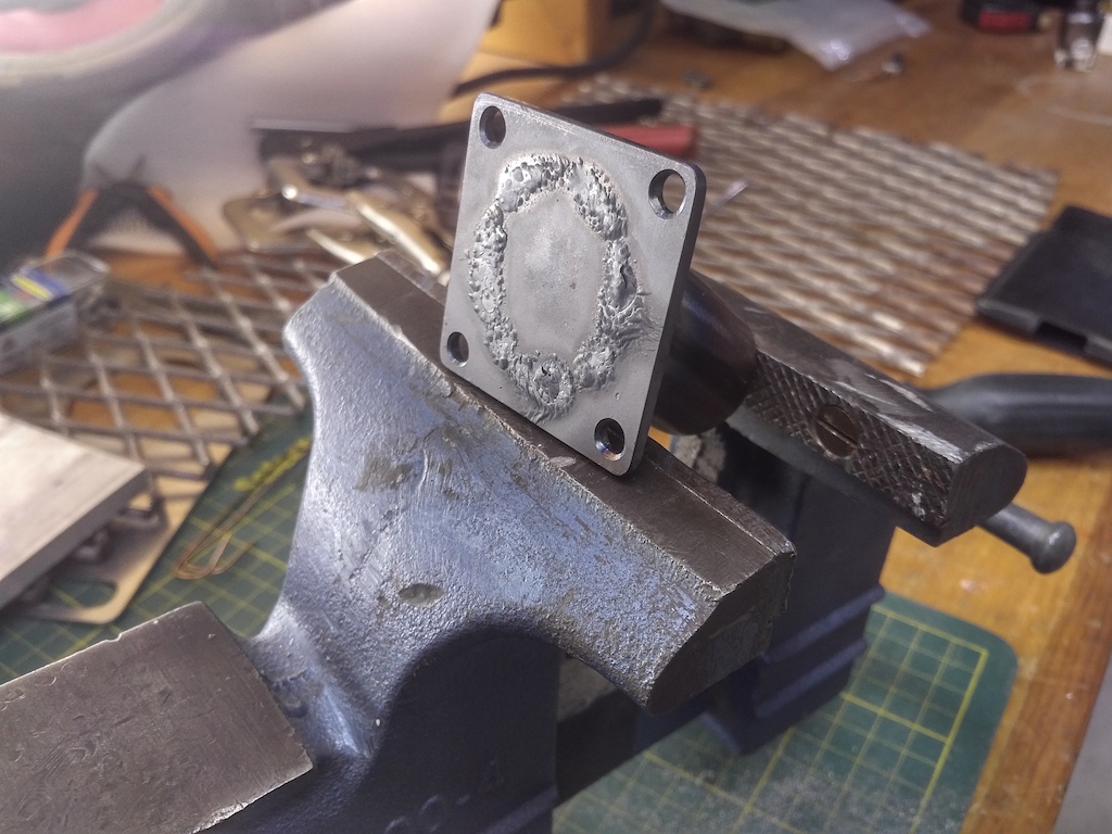

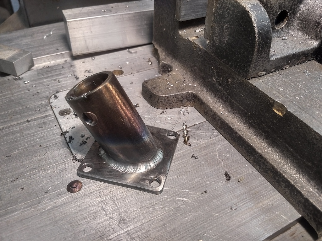

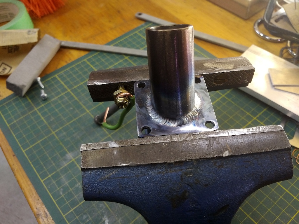

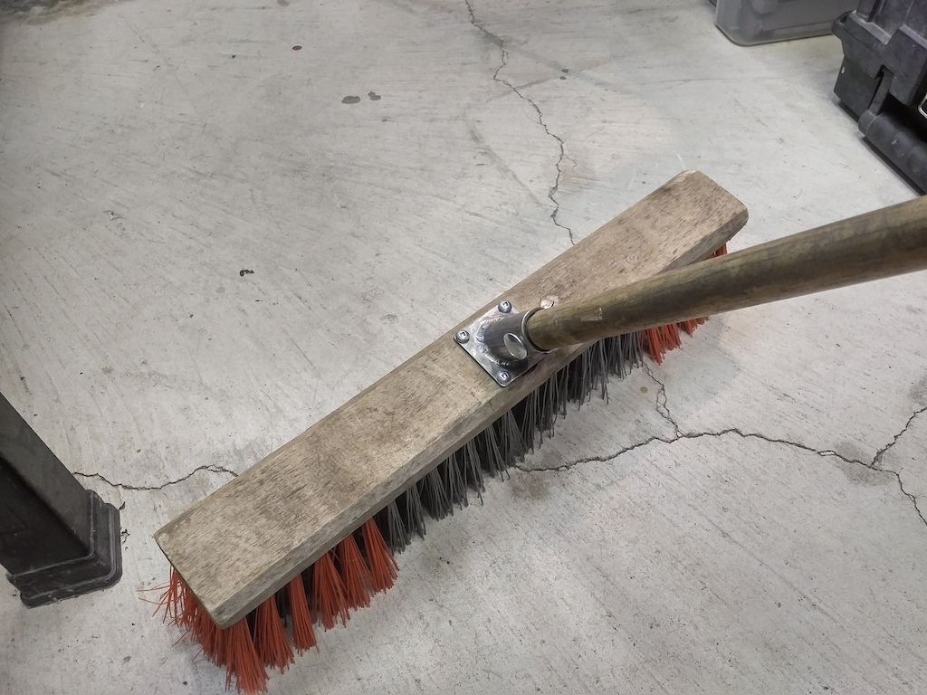

Last fall my broom handle broke. Wait, that's not accurate - the Chinese pot-metal threaded doohicky broke, rendering my broom much less useful than before. So, I made a replacement using bits from around the workshop, because why buy it when you can make it? 11ga plate and 3/4 SCH 40 pipe.
I got the main bracket done today and started to bend some repurposed flatbar straps to triangulate the broom head like a heavy-duty industrial broom. Was running 120 amps and pedal to the metal with 1/16" filler rod. Had to go down to a #6 stubby cup with over 1/4" stick-out to get into the deep valley. I can glue metal together all day long, but I am not a fitter/fabricator by any means, I'm surprised how flat it came out.
Fun fact: since my TIG machine is in my basement I don't have a dedicated weld table and I noticed that my "mobile" cheapo vice was missing a jaw screw and since the only screw I had that matched the thread was way too long I decided to make it my ground point - worked great!
I think it got enough penetration for a push broom :D Didn't bother to clean the mill scale off the back side and it bubbled-up. One tiny bit of burn through so I think I had the heat dialed in nicely.

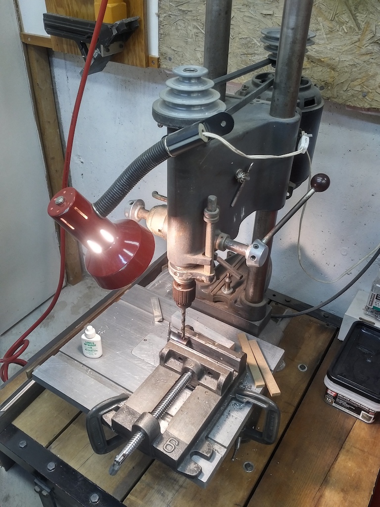

Next was time to drill a cross-hole and I had a 5/16-18 carriage bolt and wing-nut to secure the handle. My "drill-press" is a 1950's Shop Smith 10ER set-up in vertical mode. Really need to find or make a speed reducer. Filing that hole to square was an exercise in patience since the pipe only allowed for about 3/4" stroke on the file.
There you have it! The longest post ever about a tiny little weld project that isn't even done yet :pimpflash
VR6ix, sadley this is where it starts, first it's the broom handle, then a wall hanger to put the broom on, then a new boot scraper and before you know it you have a one or two welding project a day habit. Guys like me fell down the hole really bad and cant go a whole day without welding something.
Great fix on the broom sir.

I’m going to mentally file that broom handle fix so when my Chinese pot metal threaded handle breaks I can fix it.
I think we all know it will break it’s only a matter of when...:lol_hitti

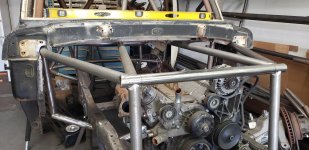

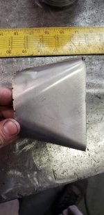

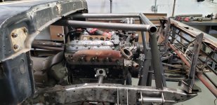

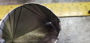

Started on a 3" exhaust tube to rectangle turbo flange adapter today. a nice 12 bends per half to get it from rectangle to round. Luckily it's common in HVAC so I found lots of examples online to draw it and cut it out on my Plasmacam cnc plasma table. Also got the engine cage started on my 1968 Ford Prerunner Project.

You should check out Ron Covell’s YouTube channel, he just did a series called rollation where he showed how to form exactly what you just made.

Is that for a T4 or T6 flange? Very creative way to go about doing it.
Happy to see you're back at it and looking forward to seeing more of your work:beer:

Thanks for the kind words gents! :beer:

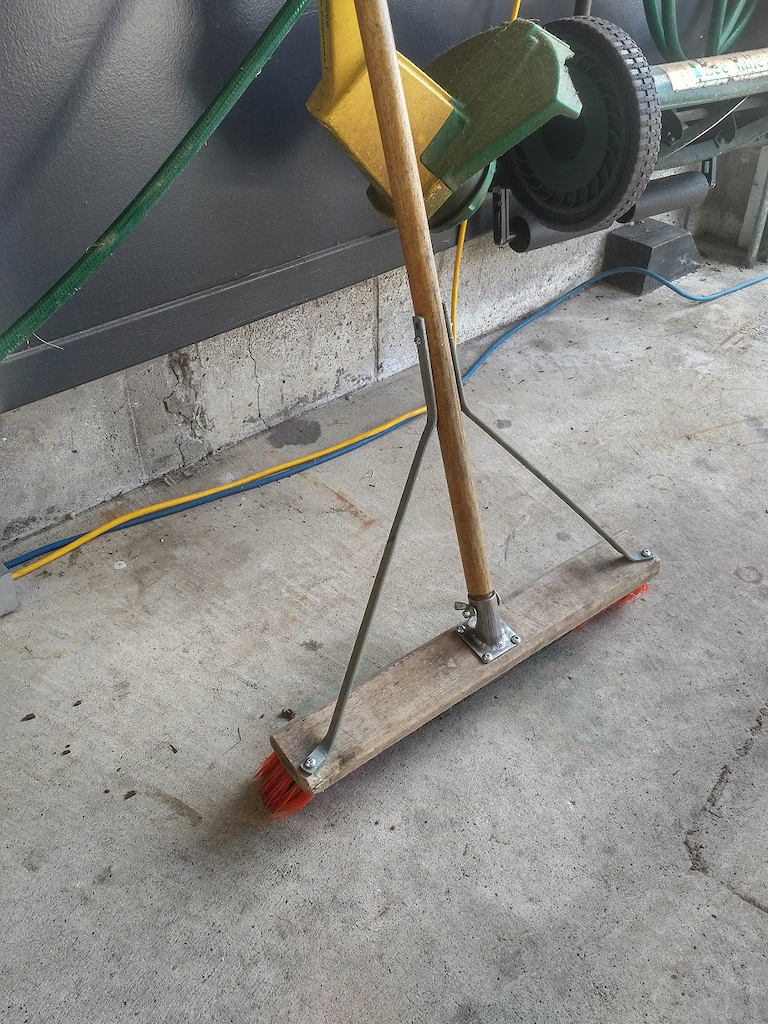

Here's the silly broom project update. It was based on the same idea as heavy-duty industrial brooms, but fabricobbled in my basement. Trying to bend the outriggers was a pain in the ***, so many compound angles and then trying to mirror-image the other side, I just wanted a broom that works!
Re: ground screw on vice... I don't have a welding bench. I have a couple wood benches, but they don't like welding projects so much. I've got a little scrap of expanded metal that I use as my welding platform for small jobs and hang it off the edge of the bench so things don't start burning. For this job I wanted to use a vice to reposition the main weldment multiple times and as I set-up I found the missing jaw screw and thought - "gee, why not just grab a screw that fits and ground off that?" There was zero good reason to do so. It's a cheap China vice so no worries given.
Up next is a grinder & paint, to make up for the welder I ain't! Will drill another screw lower-down from the first one as well. It makes the broom heavier and if i were to do it again I'd use aluminium instead, and make a clamping collar instead of drilling thru the broom stick for the outriggers up top - that might be the new weak-spot on this set-up.

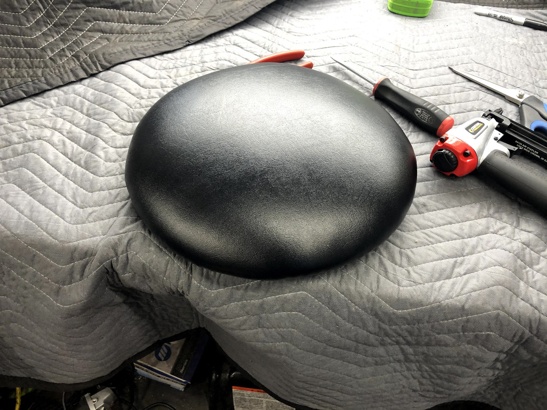

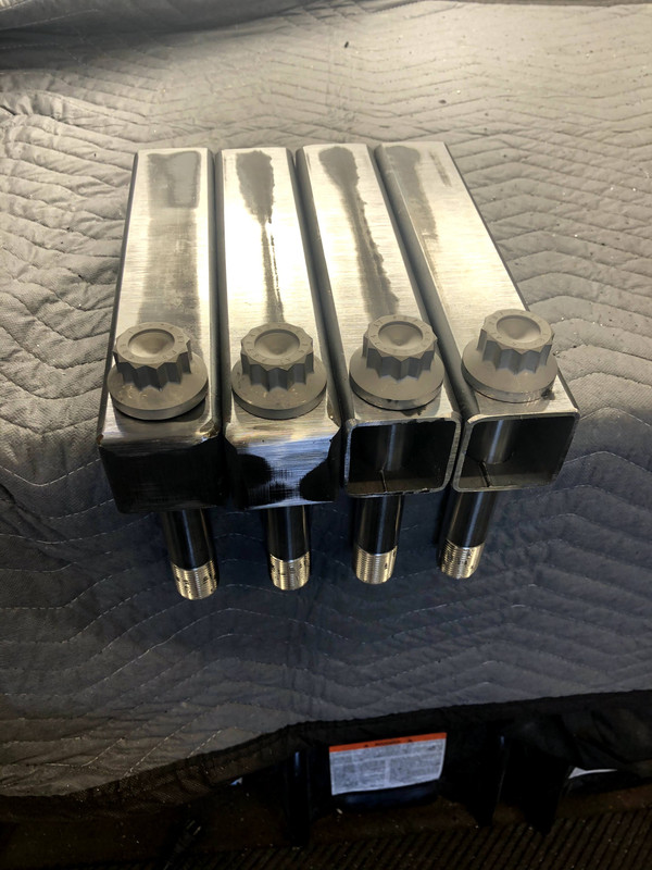

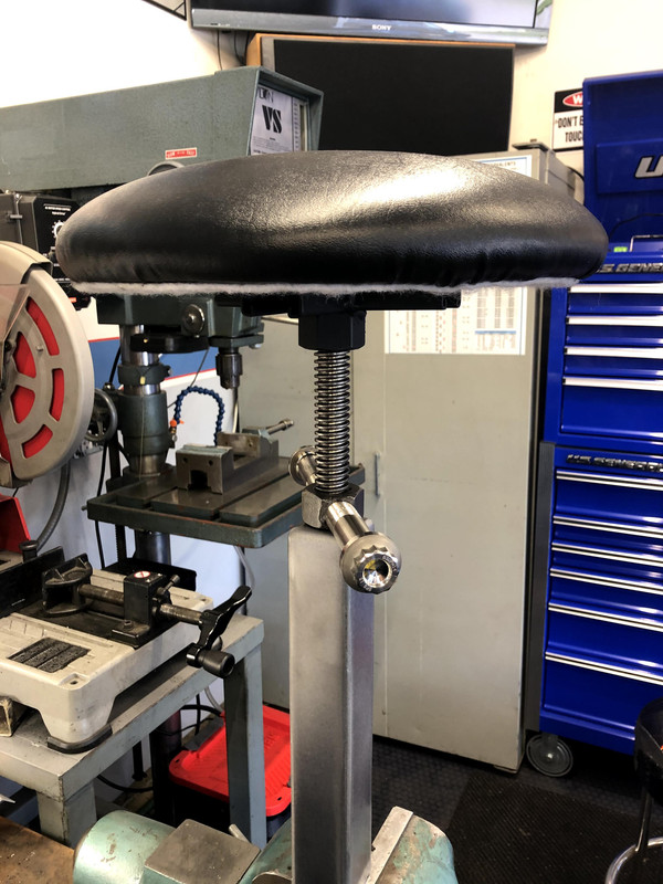

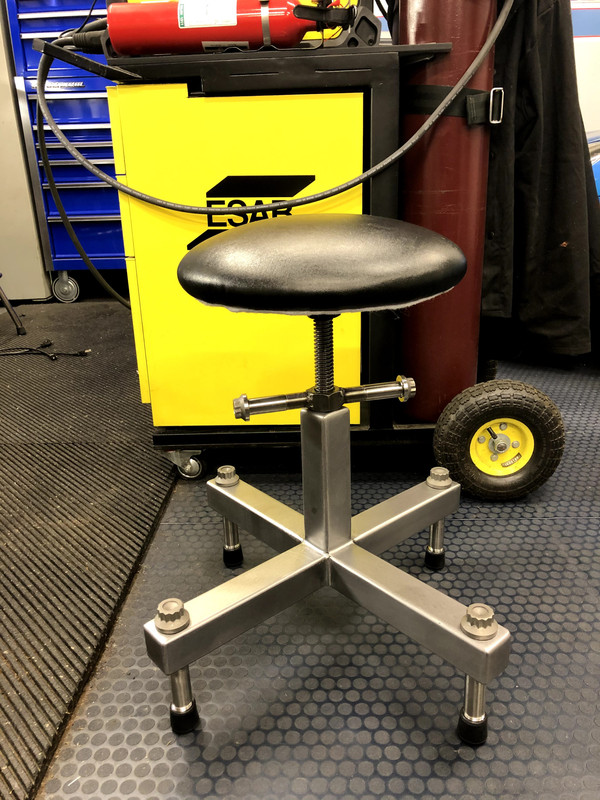

Shop stool I worked on over the last two weekends:
The seat height is adjustable between 20"-30" on a 1" acme screw. There are two acme nuts in the vertical tube to keep the shaft movement to a minimum. All the tubing is 12" pieces that are 2"x2" 11 gauge. The bolts are aircraft engine mount bolts 1"x3' on the jamb nut and 1"x6" on the legs

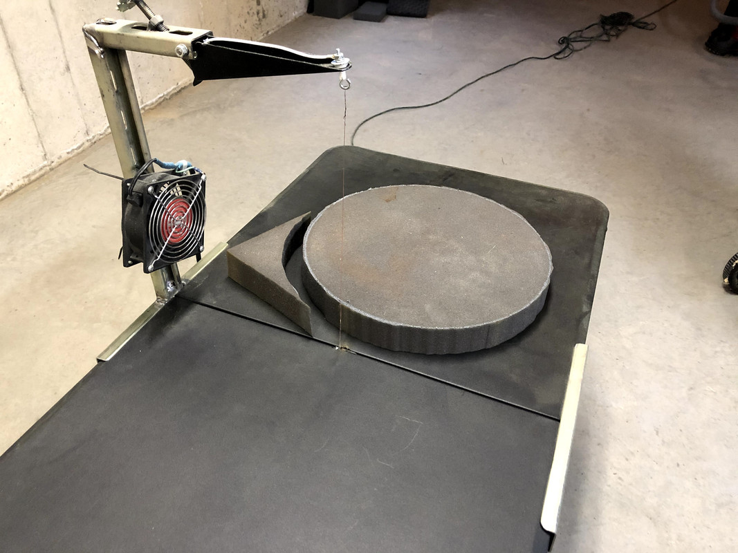

Ditto on stool. At first I thought that was a wire cutter powerful enough to cut steel plate then moving down to other pics realized it was foam.
