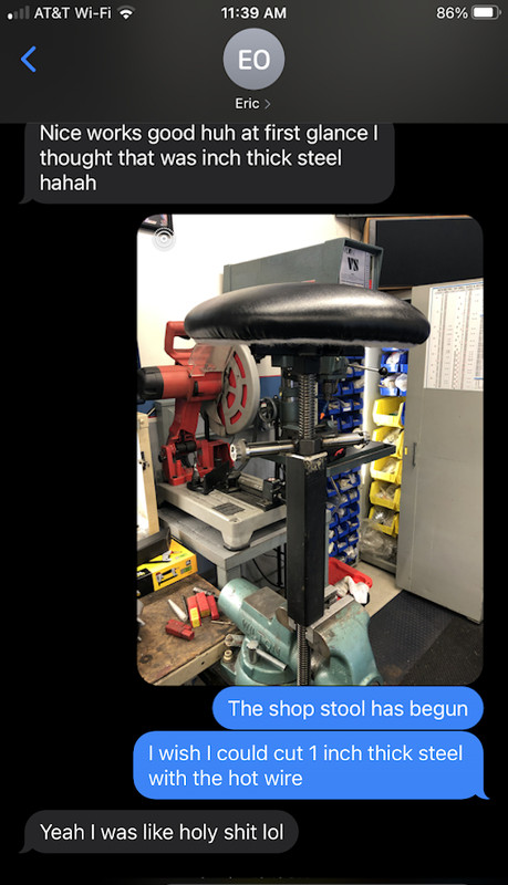

Thanks for all the feedback everyone, there is something satisfying about making something useful from a bunch of random pieces.
its funny because the two people I texted pictures of this to, both thought the foam was a piece of steel as well.

Add me to the list of people who thought you were cutting steel with a hot wire......
Also, I wish I had your 12pt hardware laying around!

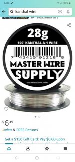

I bought a folding card table from "The Walmart" and made the framework out of some spare Unistrut. The wire is Kanthal commonly used in everything from heating elements to vape pipes, because of the latter it can be purchased for around $7.00 for 25 feet. I have been using the same piece of Kanthal for five years its very durable. I used some small eye hooks with nylon grommets to attach the wire and I just attach a battery charger to power it. I zip tied a small 110v fan to the upright to blow the smoke away.

Me too! I was like dafuq until I saw the hot wire.

I use a long knife to slit the foam along the cut line and slide the Kanthal through the foam. The Kanthal is twisted on the ends and just slips through the gap in the hook and its quickly tensioned by the wheel on the top.

The wire I use has a shorter life span or I run it too hot.
I power mine with a small transformer and have an inline power switch built in. I do like the fan idea.

Honch I used to work at a place that had a "Hot Wire Cutter" for High Density Styrofoam and that used 0.023" Dia. Stainless MIG wire, any experience, observations, or pointers you'd care to share on this? Harry

When I built the cutter four years ago, I strung the Kanthal on it and it and I am still using the same piece. I don't even know where I put the rest of the roll, so sorry but I don't have experience with anything else.
I was going to use 0.020" stainless safety wire, but my son had bought the Kanthal for some college project and never used it. I believe the commercial cutters use NiChrome wire. The Kanthal is corroded and gums up easier than it did when I first put it on.
I'm sure there is all kinds of math with wire resistance, length, optimal temperatures and power sources that could be done, I just used stuff I had.

Harry, I think you meant .023 mig wire - besides Kanthal, you could likely use stainless mig wire - it typically has over 10% nickle and a couple other elements besides iron. Nichrome heating wire issimilar, as is the positive electrode in type K thermocouple wire - that wire can withstand 1100 degrees C, so should hold up fine. If you find some type K wire, the yellow insulated wire (positive) is Chromel, about 10% chrome. That's the one you would strip and use for a hot wire cutter... Steve

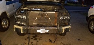

Here's a few of my fab projects. A sign I built, the bumper I made "fab on the fly" no drawings. I'm currently rebuilding my Silverado. So far I have new stainless floors, new rockers with stainless inner rockers, new cab corners. Starting tomorrow I'm replacing the leaf springs, custom hangers, new shackles, extending the frame, plating and reinforcing the frame and building a custom flatbed

Here is my progress on my truck rebuild
