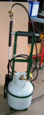

I have completed way too many fabrication projects to mention but here are a few of my favorites.
A receiver hitch for my lawn tractor
A cargo carrier for the tractor hitch
A stand for my slightly customized Horror Fright H/V bandsaw
A bicycle repair stand
A rack for the front of my '72 Raleigh Sports
A "mobilizer" for my weed burner
