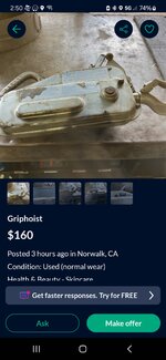

Used those griphoists one summer when I worked construction, moving a floating dredge around.
Very useful once you get the hang of it.
I've wanted one for a long time, but they're crazy expensive. Even used and beat up they show up on ebay for between 500 and 1,000. This one popped up on OfferUp for $160 so I figured I would roll the dice. It was used by a pipeline contractor, and you could tell it had been down in a trench. When I opened it up, it definitely has some mud in it where it had sucked a muddy cable in the inlet, but when I got it all cleaned up, it was still in amazingly good shape with almost no wear. I regreased everything and reassembled and it's as smooth as butter.
