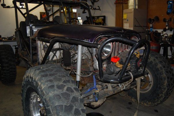

hackster
30
Some great stuff on here, I just wasted an entire evening reading through the 11 pages of cool projects.....I am an amateur fabricator on some pretty fun projects.
Here is the last build from last winter. The toyota started as a 2wd daily driver that would not run or pass emissions here, got it for a steal from a co worker.
Start....
Front end work is just about done
That bed is going to get destroyed....might as well build a new one now.
