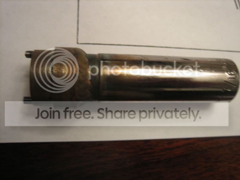

I'll play too:
A tool I made from a craftsman socket, some round steel bar, and a gage pin. It's used to engage a propriatary nut.
