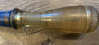

Ok here is one for everyone to chew on. Received this in the mail today. I personally have never seen this set or even this logo. Have any of you tool guys ever seen this set? It’s now one of my favorites
Ok, here is the other half of weirdness

That's a cool logo, can't quite place it though .. but the expression "Craftsman Vanadium Steel" puts it in the 1931-1933 time frame. So it was after the early Craftsman "Chrome Vanadium" tools of 1930, but before the "Craftsman Vanadium" sub-brand from 1934 to 1941.
AA

I wonder if that is pre-1927 Craftsman before Sears bought the rights to the name?
If only to get things started, I will say that I don't think this punch set is early Cushman Company, Inc. (Champaign, Ill.) 'Craftsman' or Marion-Craftsman Company (Conneaut, Ohio). The color scheme and font seems inappropriate, for one thing, but more importantly, I think they were way too early for vanadium steel and compositional 'Vanadium' branding.

The tools themselves are not the typical coated vanadium stuff and the long c punch and chisel sets were the mid to later 30s. I’m thinking mid 40s. But who knows. The font definately looks early.

That Fount is still Long C era. what is the "not as old" thought?
I associate pointy top "A"s as older than flat top "A"s and assumed they were pointy during the Long C era. I'm not very good with those details. Care to guess the age of this tool, based on the font?
