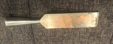

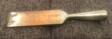

Found this "long C" Mortise Chisel buried in an old top chest I dragged home earlier this year. Curious of the code BP, and even more perplexed by the fact that I found this with green electrolysis discoloration on it. When scrubbing it down with a scotch bite pad I apparently have taken off some of the top layer finish to reveal a copper cladding underneath. What gives? Any experts know the what's and why's to this?BP1.jpgBP2.jpgBP3.jpg
Provincial
Sep 21, 2011
6,881
Near Salem, OR
Yes, copper is the base coat for plating. Copper, then Nickel, then Chrome is the high end of plating. Chrome over Copper was a later development that was used where the product was not exposed to weather and was not expected to be very long-lived.
In Chrome-over-Copper, the Chrome layer was probably extremely thin because it was a cost-saving process. It makes sense that the Chrome went away and left some of the Copper behind.
O
39,423
It's likely what you scrubbed off was nickel plating - not chrome. Chrome would resist, unless its peeling off (with razor sharp edges...)
Nickel can easily be re-plated. I know a couple of guys that do it on a table top basis. Plan to do some myself...
I remember reading somewhere that the BP code was Union, but I can't find it. I did find these chisels listed in the Sears Catalogs from 1934-54. They changed the model number in the mid 30s, and during WWII and until 1947 they were high polished. And from 1948 to 1950 they were Vanadium steel, different handle design and chromed. From 1951-54 they went back to a high polished finish, and another different handle design.
