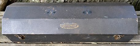

Is this logo just prior to long C? It’s on a socket box finished with burgundy japanning intead of crinkle blue paint. Maybe for C-series sockets?
