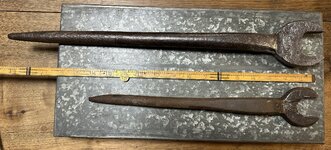

A trio of earlier Williams Spud wrenches. All marked Brooklyn.
(Williams called these offset style STRUCTURAL wrenches while the straight ones were called CONSTRUCTION wrenches.)
My daddy was an ironworker out of local 1 in Chicago. He worked on the Sears tower. He called them all SPUD wrenches.

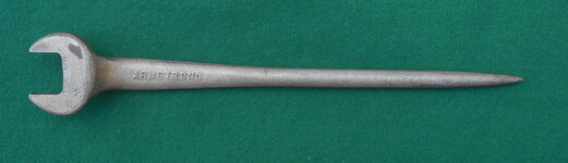

Armstrong model 906B Spud Wrench
marked "1"
milled opening size is actually 1-3/16"
oddly, the 1935 catalog shows it as having a milled opening of 1" (I was not able to find it in any other catalogs.)
marked "HARDENED" on opposite side just below gullet

30,859
marked "1"
That's a couple hairs larger than the differences all my spud wrenches measure between nominal milled opening and spec, but I am going to assume it's the rough nut clearance thing. If you look at the annotations at the very bottom of that table excerpt you attached, you'll see a caveat to that effect. All vintage catalogs have a similar caveat on their structural and construction wrench pages. Some catalogs are much more explicit. Williams, for example, says something about the actual openings being larger by some fraction. I can't remember how many 32/nds off the top of my head, but the difference you are measuring between the opening and the marking and the catalog is probably planned. If not, maybe spread from use, or a little of both.
