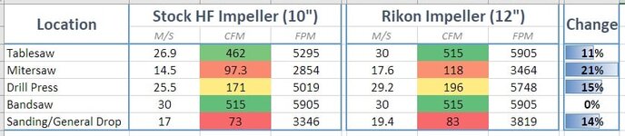

I’ll be running 4” flex line from the bottom of the blast to each tool, so I’m thinking I will move the gates down a few feet to use up the cheap PVC and shorten the lengths of expensive hose required.
