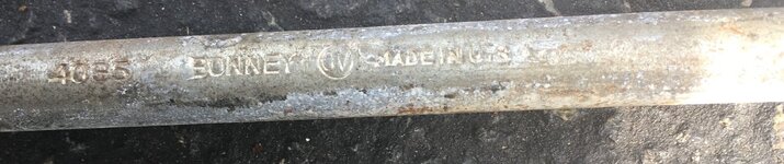

Bonney 4085 1/2 speeder. How rare is it? Saw it in a pile of rusty tools and it followed me home for a $1
Oxidized, covered with some paint - will see how it cleans up...Bonney4085_1.jpgBonney4085_2.jpg

I'd say drown your pain in some $10 wine and use the tool. lol
CV puts it pretty far back. How do the handles spin? Usually on speeders I find in the wild the handles are frozen or really crunchy.
Go easy on that.
If you usually clean up tools with wire brush or wheel, try a small spot outdoors first. Wear respirator protection, gloves. If it gets real shiny easily, STOP. It looks like cadmium to me. Toxic dust. I’m suspicious when I see blotches of red-brown rust (instead of orange) and no flaking chrome.
If it doesn’t shine up immediately, but does improve, it might be nickel plate.
Bonney trademarked “CV” as a wrench alloy in 1922. They started making sockets and drive tools in 1927. The use of alloy was disrupted by restrictions during WWII, but may only have applied to the finish on drive tools.
[R/W, Lugz?]
They did renew the trademark in 1943, but since Bonney had two other trademarked alloys, and the caché was fading anyway, I don’t think they bothered to resurrect it postwar.
Unfortunately, the catalog illustrations are not reliable for dating specific styles, or the ribbed grip might pin it down. Judging from font style of the stamp, my guess would be late in the CV era. Maybe specifically 1945. Just a guess. I’ve been studying the stamps on the sockets, and haven’t really scrutinized the drive tools, because I have fewer examples.

Thank you, Bonneyman and LesserSon.
The middle handle spins very well. The top one spins with some resistance (though I tried only slightly after I brought it home - it might need several complete rotations).
Thank you for warning as well, LesserSon. Will be very careful cleaning it. In general I now always clean the tools under the running water, wearing goggles (took few splashes to learn) and gloves.
It will now reside for 7 days in the garage (COVID precautions though we are opening up)
