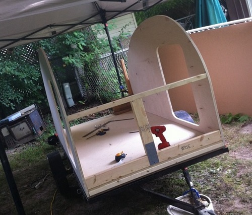

Teardrop Camper -- Structural Thoughts
I'm thinking about building a small teardrop trailer to pull behind my car for camping trips with my kids. (I know a pop-up camper would offer me more space, but there are a few things about teardrops that work better for my situation.)
The basic design of the teardrop goes back to the 1930s, and usually involves a converted utility trailer with a wood-frame structure built on top of it. Like this:
Then it gets skinned with aluminum sheet, and sometimes even the homebuilt ones come out looking pretty cool. The back usually opens as a hatch for a basic galley setup.
So that's all well and good -- and tried and tested. But these things often end up weighing close to 1500 pounds. And they also sometimes have weather-related problems, over time. I think part of the problem is that they tend not to be garaged. And they're made with wood.
I would like to make one that's much lighter. And I'd like to make it with no wood at all, and as little steel as possible.
To that end, I've been looking at material samples and testing adhesives with them. Right now, I'm thinking about using Aluminum Composite Panels (which is basically polyethylene Foam Core sandwiched with aluminum) for the walls and ceiling, and corrugated (polypropylene) plastic for the floor. I'd like to use aluminum to connect the floor, walls and ceiling, but I'd like to avoid (as much as I can) a traditional frame for it. And I think I can do away with a lot of the reinforcement typical in an open utility trailer's bed, since the box structure of the camper would provide strength for the floor.
I'm also considering using foam EPS or XPS insulation sheets, adhered to the aluminum composite panels -- both for insulation from cold and heat and also to further strengthen the panels. I will probably use 4mm corrugated plastic for inside the sleeping cabin, since I can cover it with self-adhesive vinyl and make it look like anything I'd like (and hide the wiring and such).
My concern is making a structure that is strong enough -- which is to say it won't pull itself apart under high-speed pothole impacts and the constant vibration and other stresses of being towed.
On the one hand, it seems like the monocoque aspect of the design should be pretty strong without much reinforcement. Using structural adhesives to create uniform adhesion along all the juncture points will distribute stress pretty broadly. And the way the leading edge of the structure curves as one piece from wall to ceiling seems like it would be creating a fairly strong unit, along with walls both fore and aft that will provide more lateral strength.
So in doing my materials/adhesive tests, I put together a toaster-size box that shows my current thinking. The square tubing frame piece along the top edge is one of the things I'm wondering about. I know that it's a stronger shape than L-shaped angle stock. But I wonder if using 1-1/2" angle stock might be better than 1" square tubing, considering the big picture of the whole structure.
Right now, I'm supporting the corrugated plastic floor with angle stock running along the walls. My thinking is that the trailer supports the walls, which in turn support the floor and ceiling. But the floor itself doesn't need a huge amount of support.
Here's the walls and roof:
And the floor being glued in:
And the whole thing, albeit without the front or rear sections.
I don't have much business making structural engineering decisions. But that doesn't stop me from trying to figure this out -- hopefully with the help of some guys who actually know the stuff.
The forces the thing will be subjected to seem primarily to be a lot of vibration, and then some pretty hard lurches in being towed. I'm going to have the tongue and axle be steel, because aluminum will crack if it's flexed too much. But everything else I'd like to be plastic and aluminum.
Any thoughts?

You're way beyond my expertise in construction materials (I have none), but having owned both a 5th wheel (27') and a regular (23') travel trailer, I can comment on your requirements..... IMO, a teardrop like you are planning is only fit for 2 people. I don't see how you are going to accommodate sleeping arrangements for all 4 of you. A teardrop is also fairly inefficient as far use of space is concerned. Sure, it's more streamlined, and gets you excellent fuel mileage with your tow vehicle, but square off the shape and you get A LOT more usable space. You need something more like this:

Jack, I built an enclosed trailer using the above method and draped it over an Angle steel frame [flange up to get the floor lower]
I used furniture tubing and glued alloy composite signboard to it [ the pre-finished type ]
The biggest issue mine had was it was too lightweight for a large trailer [ the wind made it unstable when towing empty ]
What you are building is a true "monocoque" structure which is very strong.
You won't need any bracing in the sides only around the rear hatch
Go and buy a "Harbor freight" gear driven ring roller for about $75-00 and get a machinist to lathe the rollers for 1/2" furniture tube.
http://www.harborfreight.com/catalogsearch/result/index/?q=ring+roller
This will help you get the corner frames rolled evenly
Glue the sides and the top to the frames using "Simson ISR 70-03" Urethane adhesive and use either Clecos or countersunk pop rivets to hold it until the glue cures.
Cap it with thin aluminium angle and glue this as well.
You can never have enough clamps.
I did a thread here building a car hauler where I used the same glue to bond diamond plate to the frame [I've never had a failure with it ]

A traditional teardrop, with an airfoil, would compliment the 911 nicely, during lap times .. :D
Not discounting your desire for a teardrop style, or the build challenge, but .....
... Looking at the model you're building, I would suggest forgetting the curves and stay with squares and angles.
This is a little, light weight jobby, I drag all over the place.
Its on a steel chassis no stronger than one of your HarborFreight, kit trailers, with a timber frame cabin, 8' x 6' x 4', plus the 2' high poptop.
Factory designed/built, for onroad use behind a small 4cyl vehicle ... max weight 750kg.
It normally has a lower stance, but I remounted the axle under the springs for some offroad clearance.
Way more versatile than a teardrop can ever be.
A build material worth looking at - is stuff called MonoPan, A euro product I think ... Becoming common in the caravan and truck body industry down here.
Google will bring up some aussie DIY caravan builds detailing using it.

I'm thinking about building a teardrop using Klegecell (foam) covered in epoxy and fiberglass cloth inside and out. They build boats that way, and think of the beating a boat can take. Never a problem with leaks, either. Not cheap, though.
I designed mine with a seam halfway up, all the way around. I'd put a hinge at the front, and make it so you could raise the back up for standing headroom when parked. Canvas panels would fill the gap when opened. In nasty weather, I'd just leave it in the closed position.

Jack a lot of the strength comes from the front and rear bulkhead making it a box essentially. The galley bulkhead adds side to side stiffness. If I were to build another teardrop I'd do composite panels and use aluminum angle and/or sealed wood 1x2s for structure where needed hidden inside away from the weather. Making it all out of wood is not a problem if you spend the time and money to put a layer of fiberglass cloth on the outside. Makes it waterproof.
There's a guy on the tnttt.com forum that made a teardrop from 1" corrugated cardboard with fiberglass on the inside and outside. Very strong and super light.
Steel frame and all wood body on mine. I should have fiberglassed it but could not afford it at the time:

Re: Teardrop Camper -- Structural Thoughts
Jack,
This is exactly the little mind exercise I did a while back, for personal entertainment.
Like you, I was thinking, "What if the ceiling, wall and floor panels were a sandwich that provided insulation, exterior waterproofing, interior finish and also structure.?
My first thought was panels that had a foam core with either a plastic or aluminum face on the outside and a plastic face on the inside, all bonded together.
Then I wondered if there was a foam panel that had a skin that served all three purposes. Never did the research.
I thought of other difficulties. How do you connect the wall and ceiling panels? And the wall and floor? Do you have mechanical connections? Are they continuous? Or do you bond them together chemically or with a glue or heat?
And the floor panel. It needs to have different characteristics, as the loads are different.
I planned for the floor panel to be load bearing and structural, such that it did NOT require a frame under it. But you would still need a way to transfer the loads from the trailer and it's contents, down into the axle and wheels/tires. Perhaps a plate or plates that go over the mounting points to the suspension and are bonded to the floor panel.
I also wondered about the comparatively heavy steel springs, axles and wheels and wondered if lighter aluminum components were available. I looked into the configuration where a trailer is connected to the tow vehicle with two hitch points and then only one wheel is mounted under the trailer. This would reduce running gear weight.
I also thought about larger wheels and tires. Something like motorcycle type ones with just a few hard spokes.
Then I got to thinking some more and wondered if you could use carbon fiber in a mold, to create the shell in one complete piece and then spray coat the inside of it with a foam insulation whose skin would be the finished inside surface. The shape would be completely curved and streamlined for strength and wind resistance.
You could even embed solar cells in the skin.
Then I was thinking that this would be an enclosed tomb, just as the teardrops are, and I hate being that enclosed, especially at a campsite with a view. So some consideration needs to be given, in the design, for expanding the envelope of the trailer, once it is set up, with fabric and screened extensions and windows. Slide out and fold out and push out parts of the shell that would expand the usable space and open it up in good weather and take advantage of cool breezes but still shade it from the sun.
And then I got so lost in thought, that I completely lost my way....
Just a thinkn'!
Bill
