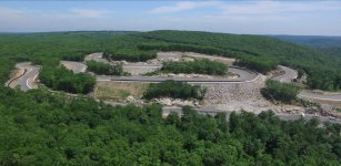

Re: Kind of a cool part-time job
I was retired, but then they opened this road course real close to home. It has the steepest vertical grade of any road course in North America. There is 510' of overall elevation change. It is like a roller coaster. I'm now on staff as a consultant. Palmer Motorsports Park, Palmer MA.
It is my new home away from home. And yes, I became a member as well.
Just as you, I'm a pretty lucky guy. Enjoy!
The 993's, BMW, GT3 and Yamahas get regular exercise, often with only one or two others.
Wish we had a skid pad.
Have a great fourth!
