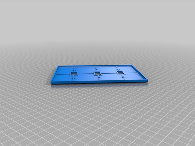

I have a problem that I believe this forum can solve quite easily. I’m on the tail end of an extensive remodel of the main floor of my home. Part of the remodel Required me to move several electrical outlets. What has transpired is that I have placed two three gang electrical switch boxes side-by-side.
This is where the need for a solution comes in. I cannot find a six switch cover plate that spans two 3 gang electrical switch boxes. The spacing between the third switch and the fourth switch is greater than the spacing between the other switches. I have tried connecting 23 switch cover plates but that did not work.
Would it be possible to 3-D print a six switch cover plate with wider spacing between switch three and four for a reasonable amount of money. I believe I assume correctly that using a CAD program It could be designed quite simply but that is a comment from someone who knows nothing of 3-D printing.
What are your thoughts?

Sure, you could make a printed switchplate. It would have to be done on a resin printer, cause the FDM printers leave a lot of layer lines. The printing should be cheap enough, less than a day's pay, but it's the CAD development time that would kill you.
When I need a switchplate like yours, I just take two switchplates, scribe the difference, and belt sand the meeting edges til they match. It takes a couple minutes and switchplates are cheap. I don't join them, I align the switches properly, and the screws hold the plates in place quite nicely.
Thanks much,
Griff
Printing a continuous, one-piece, 6- gang cover plate would require a printer capable of handling that size. My printer is limited to 230 mm. Others may have bigger printers. On a printer like mine, you could print it in multiple segments and join them, but if you go that route, why not just take two 3-gang cover plates (like @kaymccampbell suggested) and cut and join them, rather than doing the same with 3D printed segments.

Even someone with no experience could make an account with tinkercad, go through the tutorial, play around a bit then load up 2x plates from the link and cut/copy/paste for the right spacing in the middle.
A lot of local libraries now have 3d printers you could check yours, or simply find someone to print you the file. Agreed if you have to pay for the design it might exceed its value.
With white filament it would likely look good enough as is as long as it's sliced well and the printer is setup correctly but you could always lightly scuff and paint if you want it perfect
