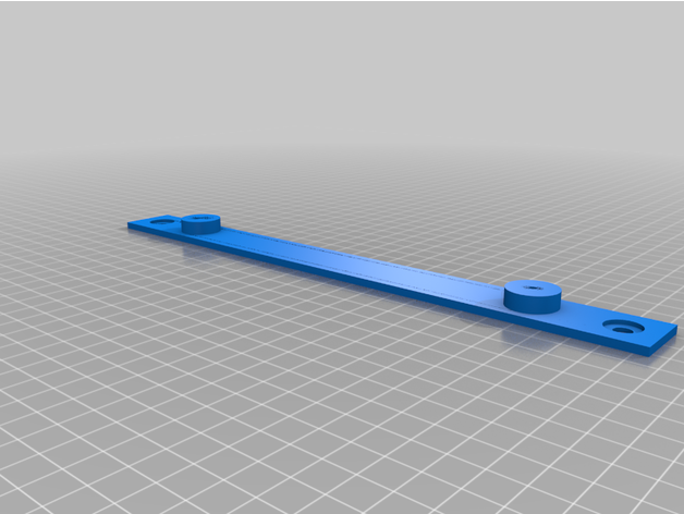

I'm moving all my networking gear into my office/spare bedroom. Thus far, the users of the spare bed haven't been really appreciative of all the blinkenlights, so I got one of those fancy Leviton "structured media cabinets" that fit between stud bays and close up with a venting cover.
I didn't realize, but there's a whole ecosystem of consumer-grade networking gear that you're supposed to be using in order to leverage the peg-mounting system. I wasn't really that interested in re-buying all my stuff, so I bodged up a parameterized adapter that will accept the Leviton push-lock pins, and pop up some blocks for #6 screws so I can use the wall mounting bosses on the gear I already own.
Bridge in place with the push-lock pins:
Holding up my D-link switch:
The way I made it makes it easy to customize 1) which holes in the enclosure you want to use, and 2) how far apart the wall-mounting bosses are. So, I made parts to hold my switch, my PoE switch, my router, my modem, and my cable amplifiers. All that's left in there is the patch panel and the UPS, but those should be fairly easy to work out.
