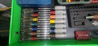

Just to follow up on my previous post about my nut driver tray... below is the current print. I did it in two pieces, tabbed it so that its both aligned and gives an additional stregth member when gluing, did some embossing plus put a mariana trench in it to make it easier to grab the tools. My only gripe at this point is that the embossing details were a bit less detailed than I wanted because I didn't bother to slow the print speed down for that part, but that got me thinking. Going forward, I think I will start just leaving a spot in the basic build and print the embossed pieces separately so that if it doesn't come out as clearly as I'd like, I can just reprint the embossed plate and insert it.
I'll post the STL file if there is any interest. Its not quite as clean as I'd like, especially compared to some of the works of art that others have posted here, but I don't do this sort of thing for a living. lol

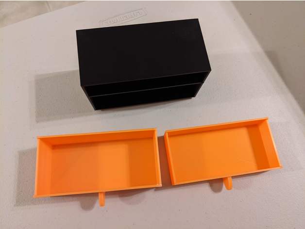

And since y’all are showing off your stuff, I figured I should offer up something as well. This is a tray I am building up for a set of Craftsman nut drivers I had rolling around the tray. I’m just piecing it together right now to make sure I have all the dimensions correct but will reprint it in fewer pieces and emboss the sizes on it for a final print. I wish I had a bigger printer but I am getting pretty good at splitting print jobs and rejoining them at this point. I will probably reduce the height slightly on the final version but it’s easy enough to grab the tools as-is.
I have that same set. Here is my solution.
