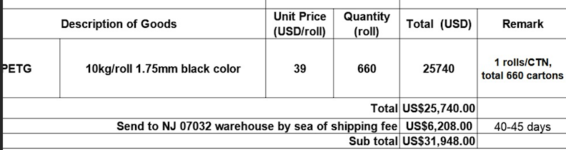

anndd major shift. buying at these quantities I can shift over to ABS and get made in USA 5kg spools for under 6 a kg to the MN facility. gona burn thru this and going 100% made in USA ABS for all products.
edit: assuming this supplier has UV stabilizers in it.
Is your primary 3D printing business the tractor cupholders? How long have you been at it? Seems things have really taken off for you.
