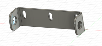

thats the wire bend: same plane. nothing fancy. table bender will work fine to make them:
laser cut/bent bracket mount. self tapper into the cross beam. lock it into place with a collar. slots to level it off with all the flex in things.
