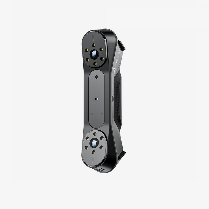

I got bored the other day at a family gathering and went down the rabbit hole of scanners....somewhere along i took the path of buying one...unsure yet if it leads down a deeper set of bunny tunnels or back to the light.
Ended up with a Creality Otter which is their mid level, ordered direct from Creality as they were cheapest. Also considered the Shinging 3D Einstar which is their entry level but the PC requirements were a lot higher and my CAD machine is a desktop on the 2nd floor which isn't super conducive to scanning larger stuff in the garage. Should ship this week but unknown when it shows up
As we're all honest in this circle of tool and gadget whores anonymous, it's bought as a toy. I don't have any business needs for it or any immediate projects that require it, there are some potential projects i could see trying it out on....but after a couple random projects I'm sure I'll be trying out their person scanning feature to generate printable files of the family
Good luck with it, I'm sure you'll be happy with it. My initial tip with the software is it use the setting (small medium large) that corresponds to the smallest features of the part you're scanning. If you are scanning a large part that has small features, the small setting works best in my experience.
Feel free to message me with any questions
Appreciate the support! Will be posting my progress somewhere here as I get to learning it
