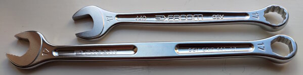

To expand on my post in the arrivals thread...
Facom 441 XL OGV Grip wrenches
These have a special design on both ends to better grip damaged fasteners, and are also fine for normal use although they are 6 point. Comparison of the 17mm on such a fastener shows the ring end has about half the rotational play of the standard 440, but the open end actually has half more. Also known as I believe Mac RBRT, USAG X-Grip, and Craftsman Overdrive.
Rotational play test (mm) at 15cm (6") on a lightly damaged 17mm brass fitting:
440 (OGV, 12pt)441 XL OGV Grip (6pt)
Ring end106
Open end, tightening1220
Open end, loosening1323
Notice that the open end is oriented differently on the 440 vs. 441 relative to the angle direction of the ring end. I believe this is to complement the limited positions available on the 6pt ring end for use around obstacles, specifically in the loosening direction. It does seem to work out that way in practice.

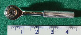

30,038
^ If I am not mistaken, the Proto J4752F is manufactured in Italy.
Exceptionally nice little piece of machinery when properly lubricated. (y)
Fedwrench
Dec 9, 2007
14,974
Valley of the sun
You are correct, proto round head palm control ratchets are made in Italy. COO isn't stamped in the ratchet. The made in Italy is on the part number sticker stuck to the plastic bag the ratchet comes in when new. Great ratchets!! Although, I find the 1/4 version pretty thick headed. :beer:
KnurledNut
Jan 28, 2011
8,384
n/a
Mine was the same way.
