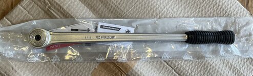

Last year I bought a Facom 1/2” drive set on a deal. This one. Didn’t need another 1/2“ drive set, and didn’t really want more 12 point sockets, but couldn’t refuse the price!
Like many European sets, it only came with a regular length ratchet, inadequate leverage for the sockets included.
So I recently treated myself to an S.154 long ratchet to add to the box.IMG_2309.jpeg
Absolutely lovely tool.
This pattern dates back many years.
The design is fine tooth and the finish matte, but a very fine matte, almost a satin.
The design was sort of superseded by the “palm control” series (both are shown below, in 3/8 drive) which had the free wheeling pad, a polished finish, a different grip, and a slightly finer mechanism.
But Facom kept the originals in production, and I’m very glad. I think that both the mechanism and the finish have had a bit of an upgrade, compared to the older examples, and the result is a rugged ratchet with a very smooth mechanism, for a very reasonable price.
I paid the equivalent of just $56 for this, delivered. A comparable Snap On would currently cost me the equivalent of $266

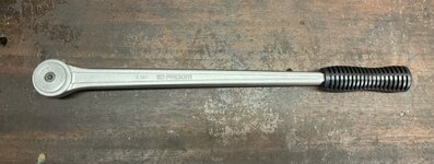

I purchased the Proto J4752F recently and am somewhat disappointed with it for a couple of reasons. First, it has significant back drag. Maybe this can be improved with the proper lubrication. As received, it is lubricated with a gray grease (moly?) What other lubrication is suggested? Interestingly, the info paper included with it suggests lubricating with oil, not grease.
Second reason for disappointment is that the ratchet cavity is significantly off center. This should be obvious in the front & back pics below.
I have a number of that style of ratchet, albeit all Facom, rather than Proto.
I think the accepted wisdom here (which I agree with) is that coarse tooth ratchet’s need grease, and fine tooth need oil. I only ever had one of my Facom ratchet’s (3/8” drive) apart. I re lubed it with light oil and it has been fine. I don’t remember seeing any evidence of grease.
The off centre broaching is unacceptable. I have never experienced that and I would return it. My only comment, is that all my ratchet’s are Facom, rather than Proto.
Historically, Facom have had very good quality control, and I have never received a bad Facom anything. However, I have always thought the same with regard to Proto.
