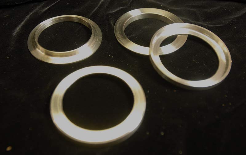

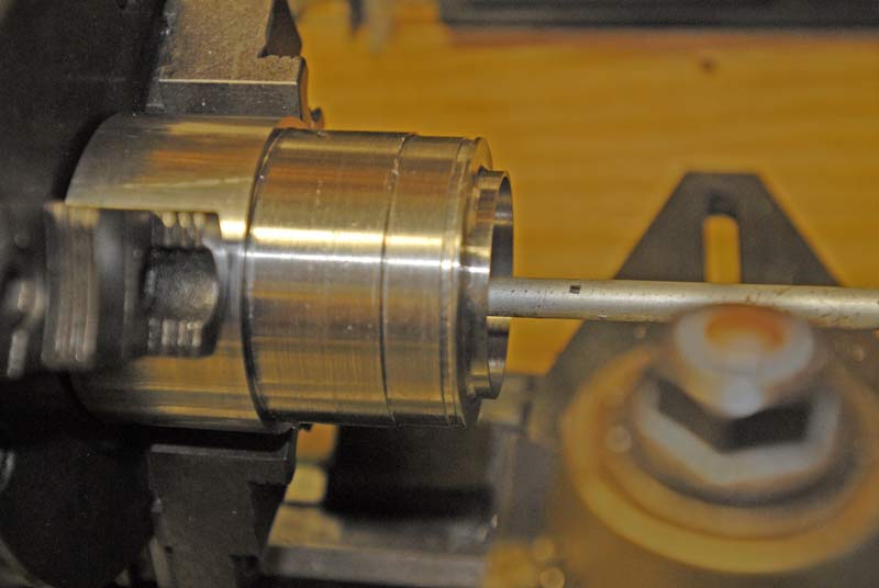

Don't think I posted these. New bearing races I machined from stainless steel for sailboat roller furler. Because wall thickness was only around 0.050" I did all the machining on the bar stock and then parted them off. 2 pairs of inners and outers.
